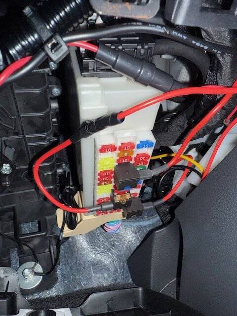

I bought the Viofo wire kit. I used the add-a-fuse and ran the cable down over to the passenger footwell fuse box. Works great. Parking mode works and the big plastic footwell covers the fuse box just fine without needing to smaller black fuse cover.

I ran into the same issue. Same camera, same-ish truck. (24 trd or) I have the hardwire kit that I'll use instead. Can you tell me which sets of fuses you tapped for remote and continuous power?
*Also, I've read add a fuse won't allow the cover to snap back on. How did you get around this?

Here you go. The little black cover can’t go on but the big black plastic cover still does and no way to hit the fuse box with your feet with it on. It all works great.

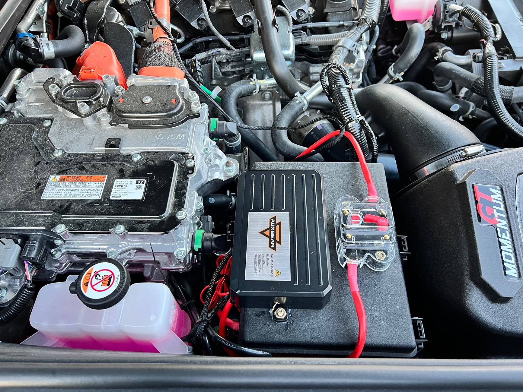

An update on what I ended up doing. I have a hybrid sport. And I installed an auxbeam on the passengers side fuse box tapping into the 12volt feed there and the body ground beside the fuse box. Inside the fuse box is only one good aux power to tap into which is needed for the Auxbeam. I then ran my dash cam wires using an inline 5amp breaker to the Auxbeam 12 volt and the ground to the Auxbeam ground post and then I tapped into the auxiliary power cable that ties into the Auxbeam. I did have to go through the firewall. I’m very pleased with the install. This is the 3rd way I’ve had it installed and I gotta say for me this is the best. I don’t have any pictures of the install but here’s a few of the Auxbeam and you can figure out how I tied in the rest with the pictures if anyone is curious just send me a message

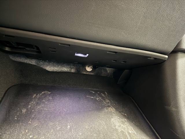

Interior fuse box, under the glove box on the passenger side:
• Red (constant 12V) → F39 DOME, 10A
• Yellow (ACC) → F38 P/OUTLET NO.1, 15A
• Black → chassis bolt
No need of an expensive adapter.
