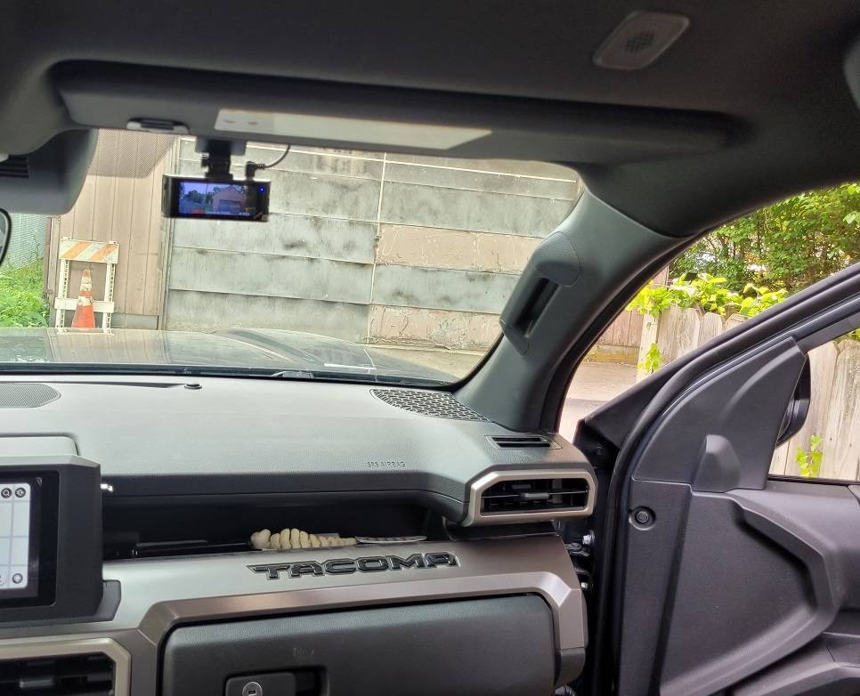

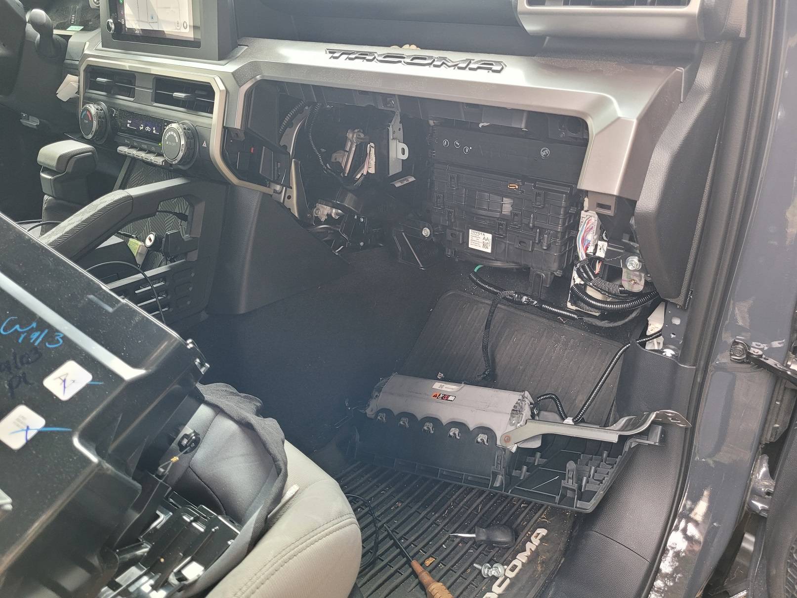

I have a Blueskysea 4K Dash Cam. Pulled the glove box out to run the wire up the A pillar
2024 Tacoma Dash Cam Solutions for 2024 Tacoma 20240606_173527
2024 Tacoma Dash Cam Solutions for 2024 Tacoma 20240606_175255

@ambit I'm impressed! So I guess you wired to the fusebox right? Did you have issues putting the plastic covers back on over the fusebox?
plugged into the cigarette plug adapter, you can just barely see it. black/white thing by the tic-tacs. Right past the fuse box didn't even consider it lol.

A question about running wires down the A-pillar. Where do you bring the wire across the pillar? It looks tempting to use the seam at the top of the windshield, but won't this interfere with side air bag deployment? If not this seam, where do you run the wire? If you do use that seam, is airbag interference a concern? Thanks.
