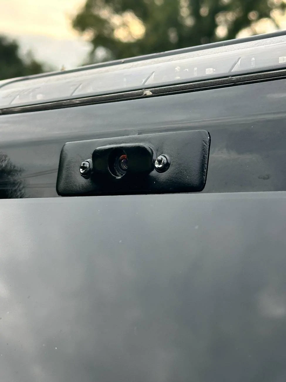

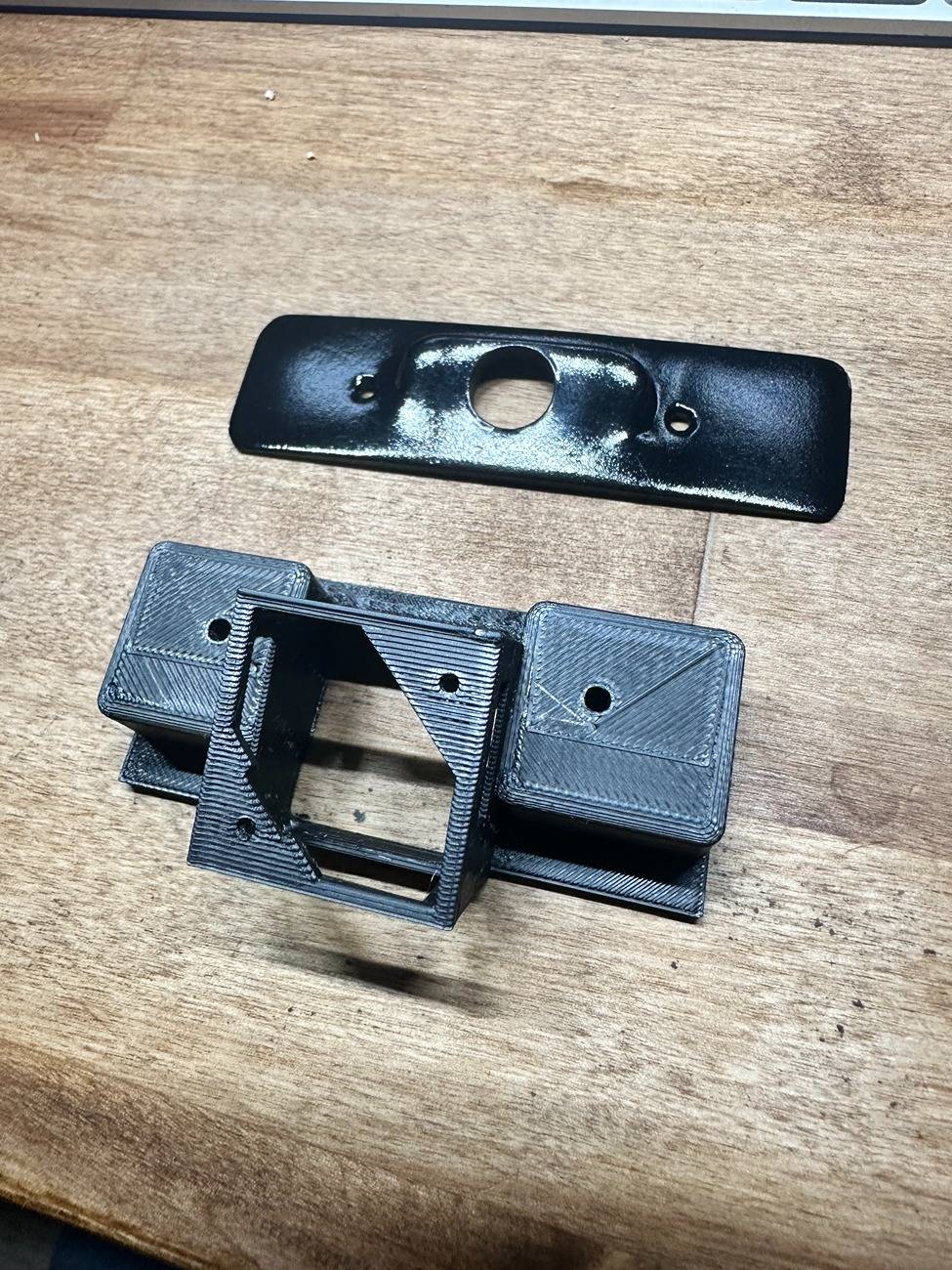

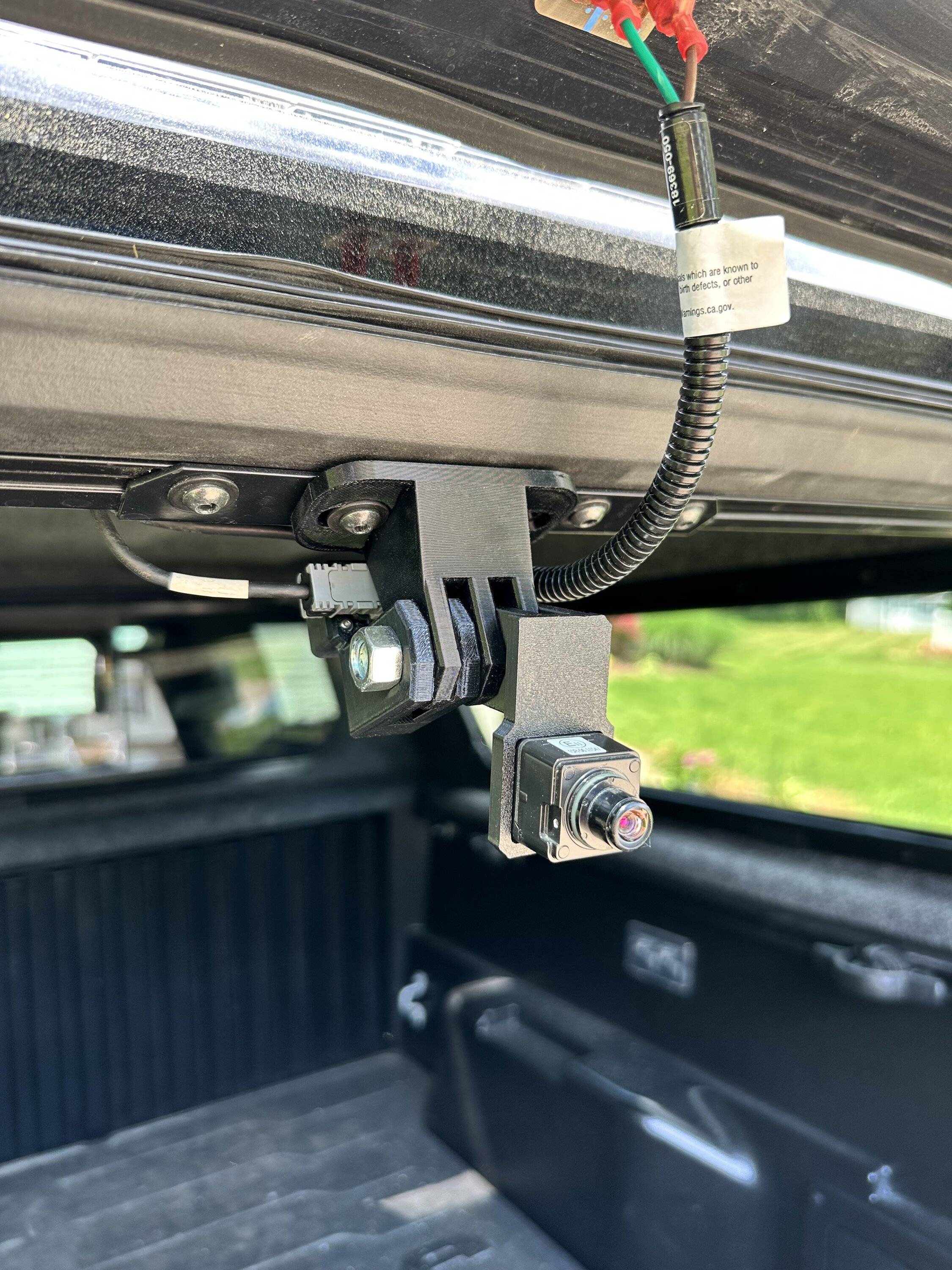

I had trouble with the relocated camera when it was on the bracket and pointed through the rear window of my Truck. It wasn't heat so much as it was the jostling around. I since did a permanent hole through mount on my cap. I'm working on a more robust design, but this has been great. I designed and printed these on my 3D Printer
2024 Tacoma Digital Rearview and Bed Camera Relocation with my Topper on 2024 Tacoma IMG_1323
2024 Tacoma Digital Rearview and Bed Camera Relocation with my Topper on 2024 Tacoma IMG_1329 2

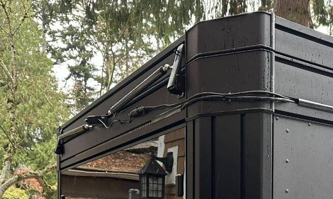

Here's a GIF of the camera overheating issue, gonna contact GG Offroad today, but posting it here if others see the same issue.
Here's how mine looks on the outside (using the stock external mount they provided, bolted onto the t-track, I didn't have any vibrating / bouncing issues).
2024 Tacoma Digital Rearview and Bed Camera Relocation with my Topper on 2024 Tacoma {filename}
would you be willing to share the file you 3D printed with me? I need to redo mine. I’m having awful flickering. I can dm my email or if you can dm the file. Would really save me.
