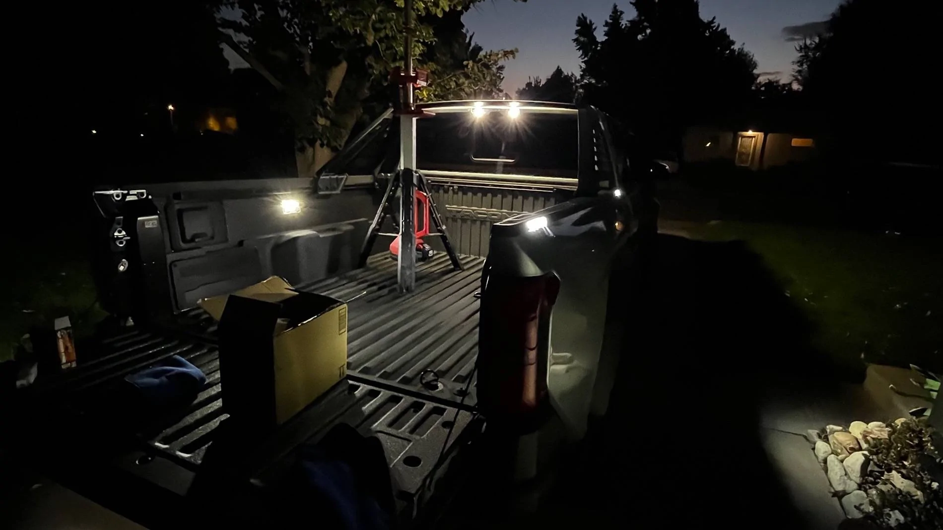

Worked late into the evening on an initial carbon nano ceramic coat and ran my bed scene lights for a couple hours and got to thinking about these cargo lamps on the rear cab spoiler: my GFC is window-less, decided to go full-alloy plating; another thing to try & keep clean that gets absolutely loaded with haze & dirt.... As a result of my build specs, thinking I'll disconnect the 2 diode emitters when I do my rearview camera relocate.
Anyone know if the 3rd brake light on this cab spoiler can be nixed without error warnings, etc?

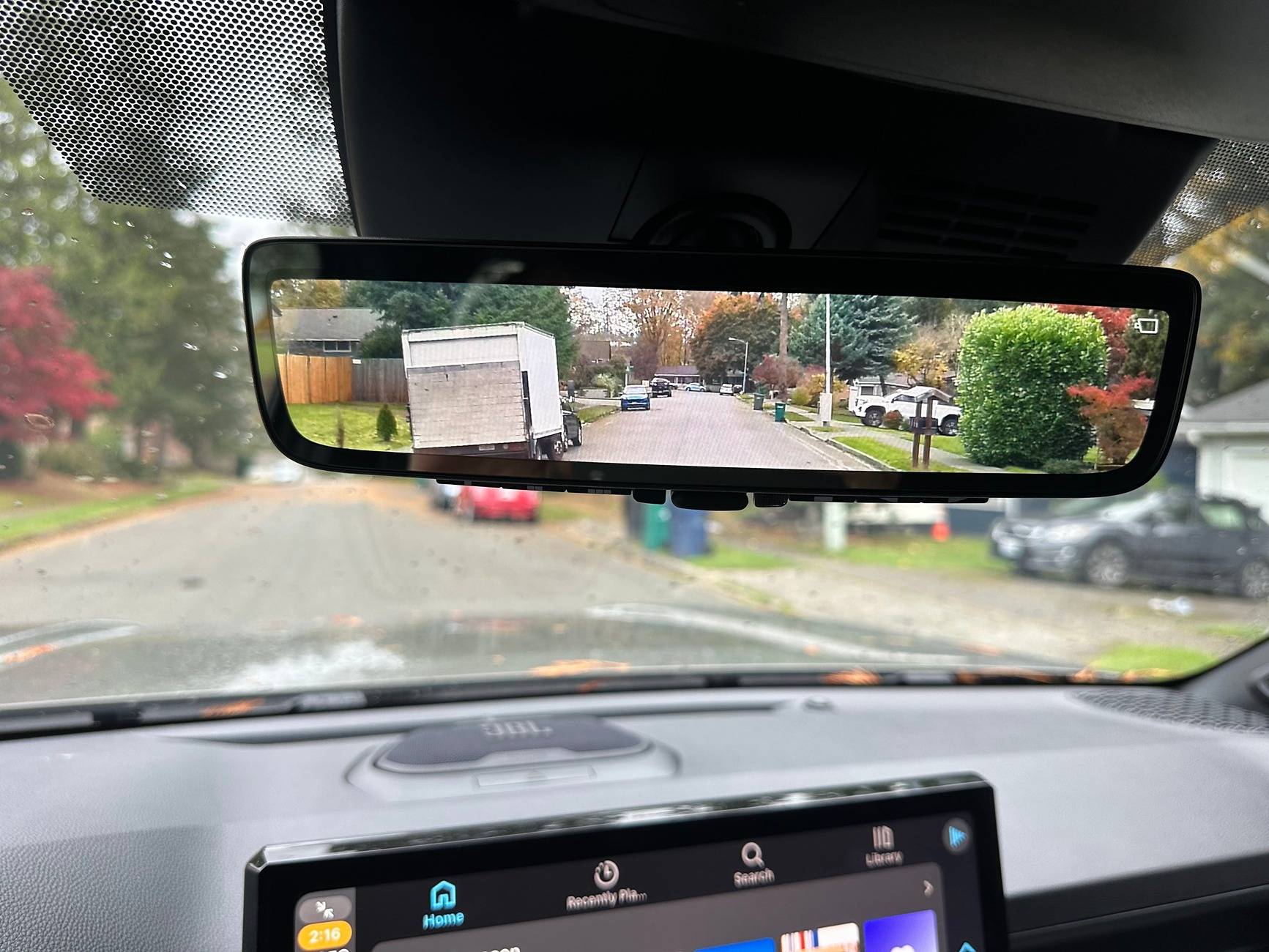

I just completed installing my redirect! Their YouTube video was excellent. I've got a great view now regardless of having my Tune M1 camper on!

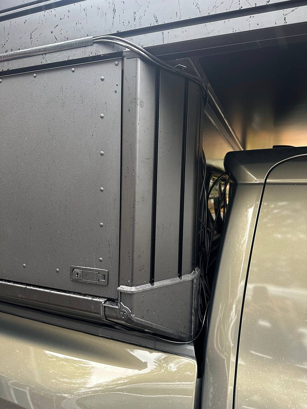

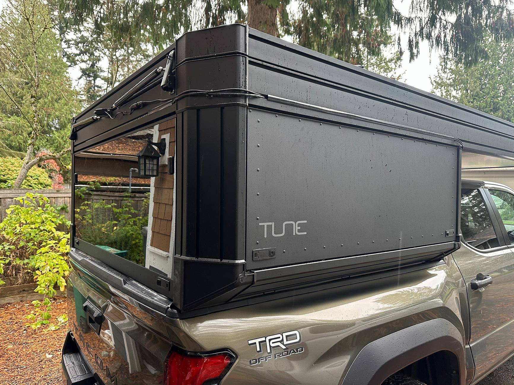

When redirecting, instead of routing the cable under the car, I decided to route it out the side of the rear fairing. There's a weatherstripping gap that fits the cables pretty well, and since I'm mounting it externally anyways, wrapping it around the edge of the camper shell seemed easier than going back inside the car and then under and then up!
2024 Tacoma Digital Rearview and Bed Camera Relocation with my Topper on 2024 Tacoma IMG_7180

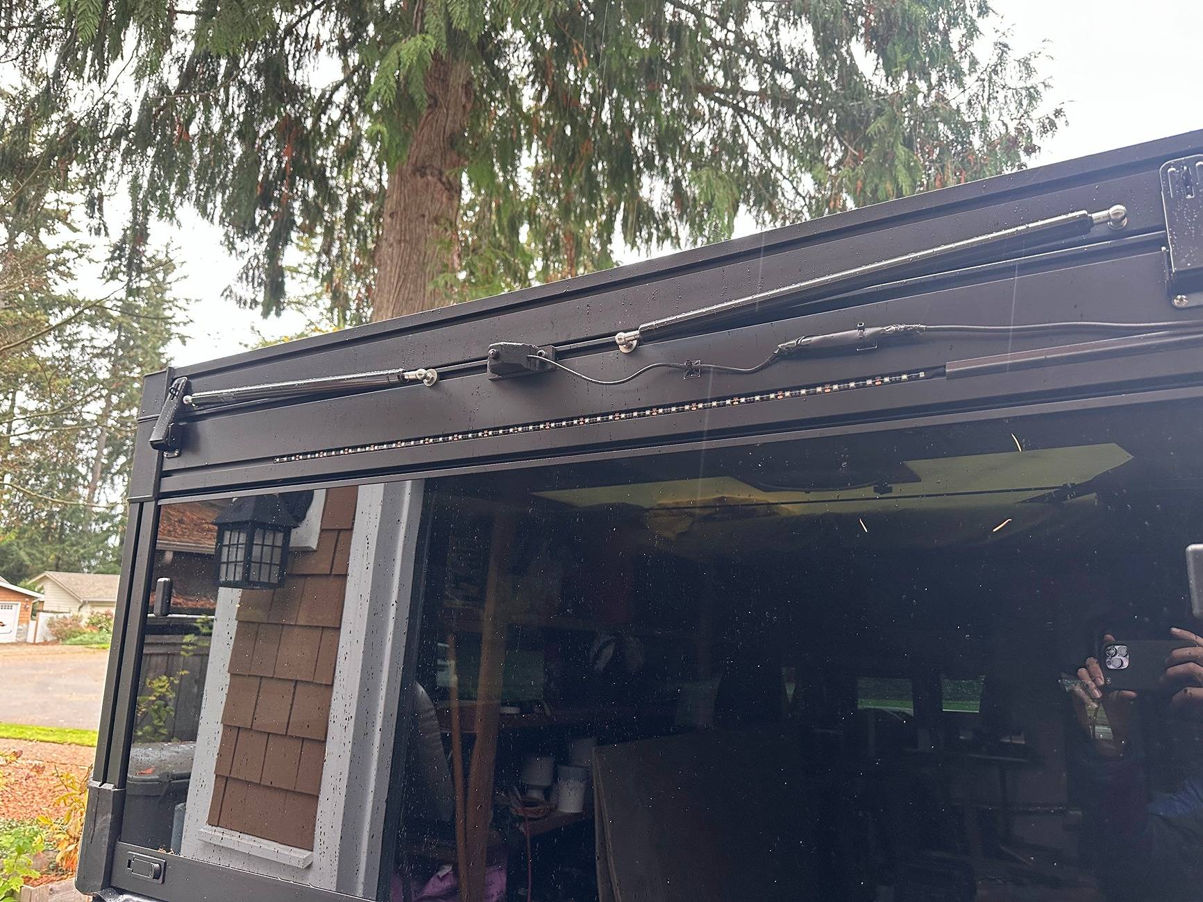

The upper cable is the camera (and third brake light). The lower cable is my makeshift "bed scene lighting" (wired to a LED light strip on the underside of my camper).
I then wrapped it all the way around to the back and mounted it on the t-track! The only annoying thing was that the cable is too long, so I ended up with having to coil a bunch near the rear window, it's mostly hidden, but eh. The other annoying thing is how big the connector is to the camera, about 7" away from the camera, so most likely somewhere that's visible.

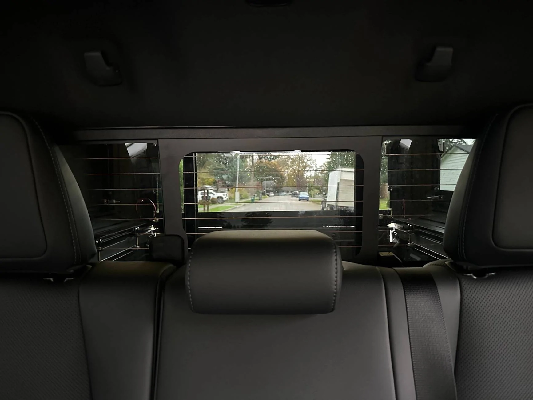

I didn't bother redirecting the truck bed camera, and it can mostly see inside my Tune since I have the rear window (the top is a little clipped, but good enough).
Super glad I did this! When cars or obstacles are really close behind, the camera feels a little weird since it's so much further back (it was already set to the furthest out zoom setting from stock to my surprise). But when you're driving, it feels pretty normal!
