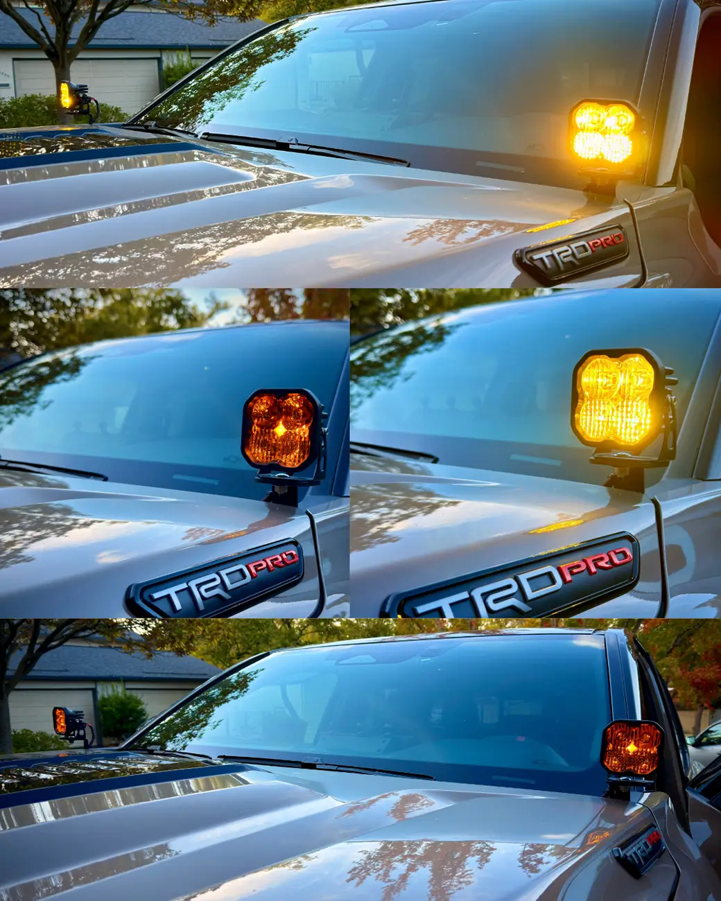

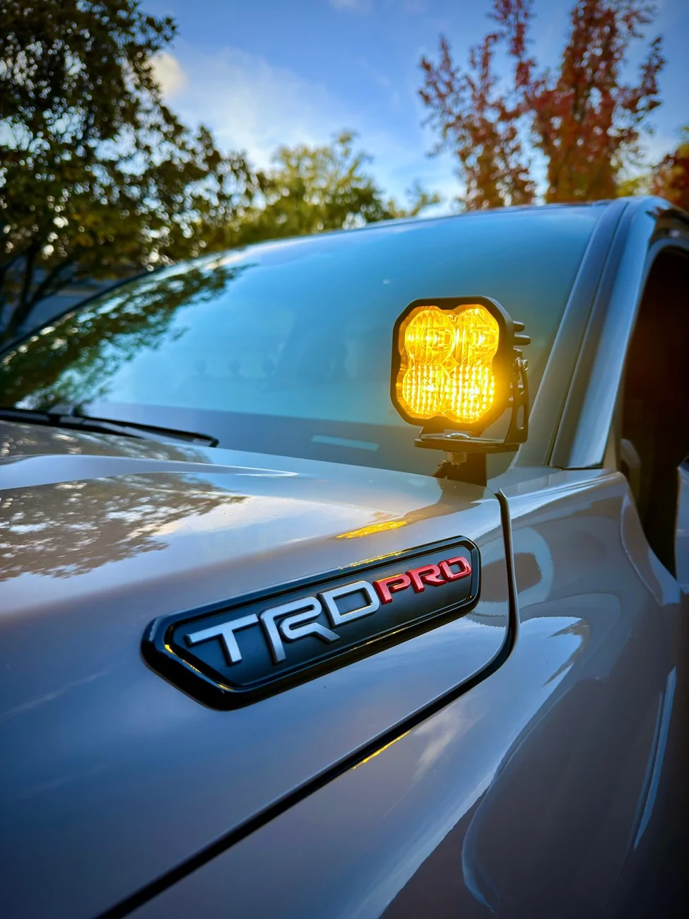

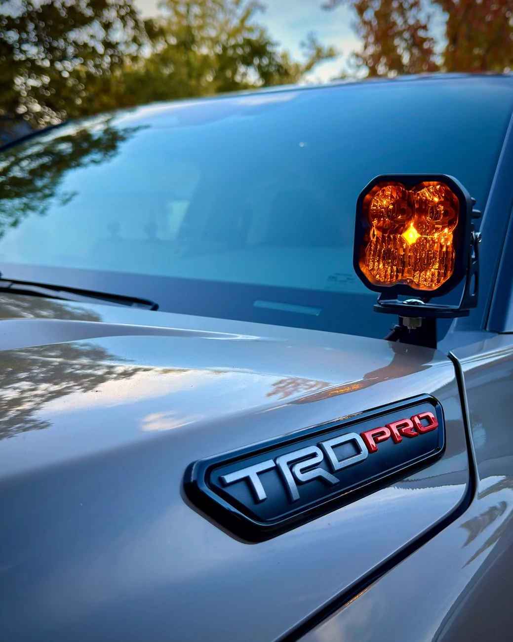

Really happy with how these @Diode Dynamics SS3 Pro Amber lights turned out.
Backlit amber is my favorite and the amber light itself is super bright.
Wired into OEM Aux switches and still cleaning that whole thing up. Backlight is on Aux4 and main is Aux3 right now. Aux 1&2 I plan to save for the light bar.

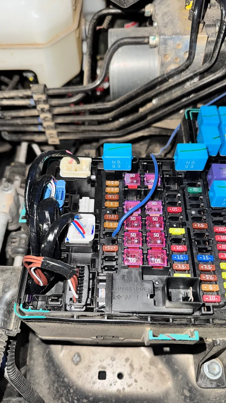

If you pop the cover off of your fuse panel, you'll be able to find a live connection to plug your backlight wire into. By doing this, you can save the AUX4 location for something else. It's what I did for mine.
That would be ideal - right now I have Aux 1 for the main which is overkill.
Aux 2 is backlit
Eventually Aux 1 will be my light bar and Aux 2 Ditch and aux 3 bumper fogs added in when mu C4 goes in.
So do your backlights just come on with DRLs?

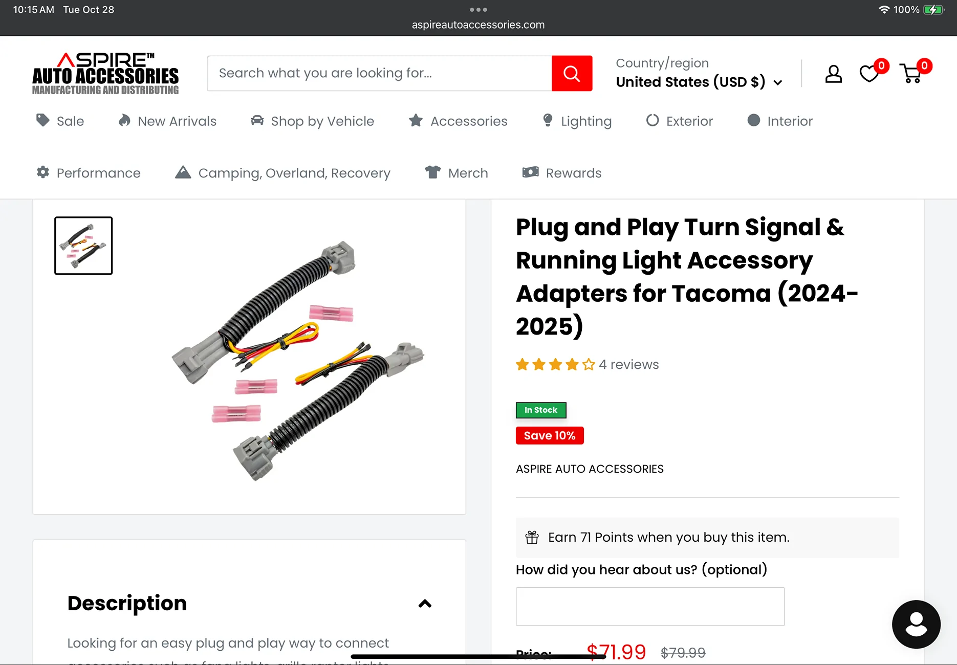

You can get a set of these for backlights.
