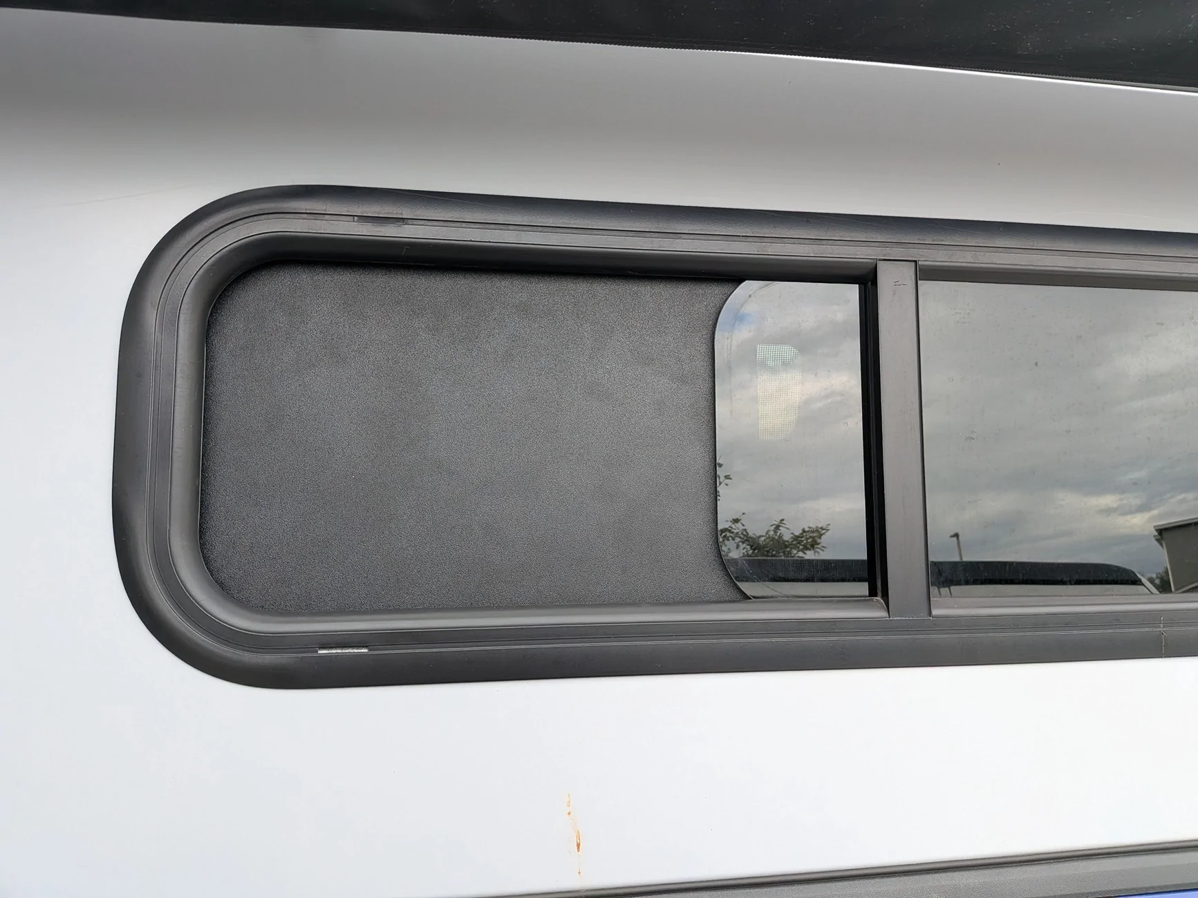

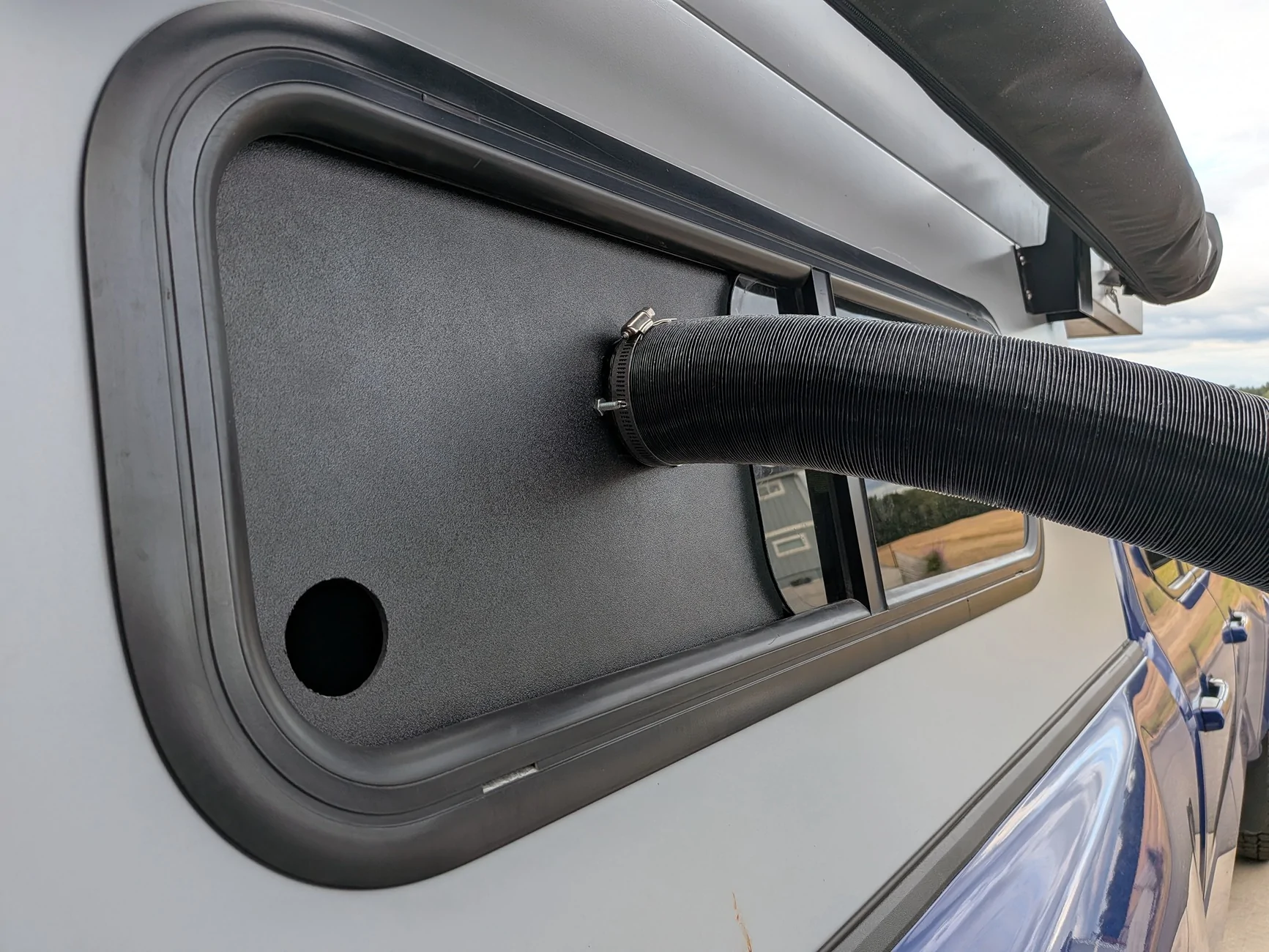

Couldn't really find anything to fit the slider window on my topper, but want to do some cold weather camping in the fall and don't want to drill a hole in the topper.
I used a 12" x 16" x 1/8" sheet of abs, 3" vent, couple screws, and I'll put a grommet on the lower hole for the power cord to the Ecoflow when it gets here. Cost less than $20. Seems like it should work just fine, but I'll let you know if I die.

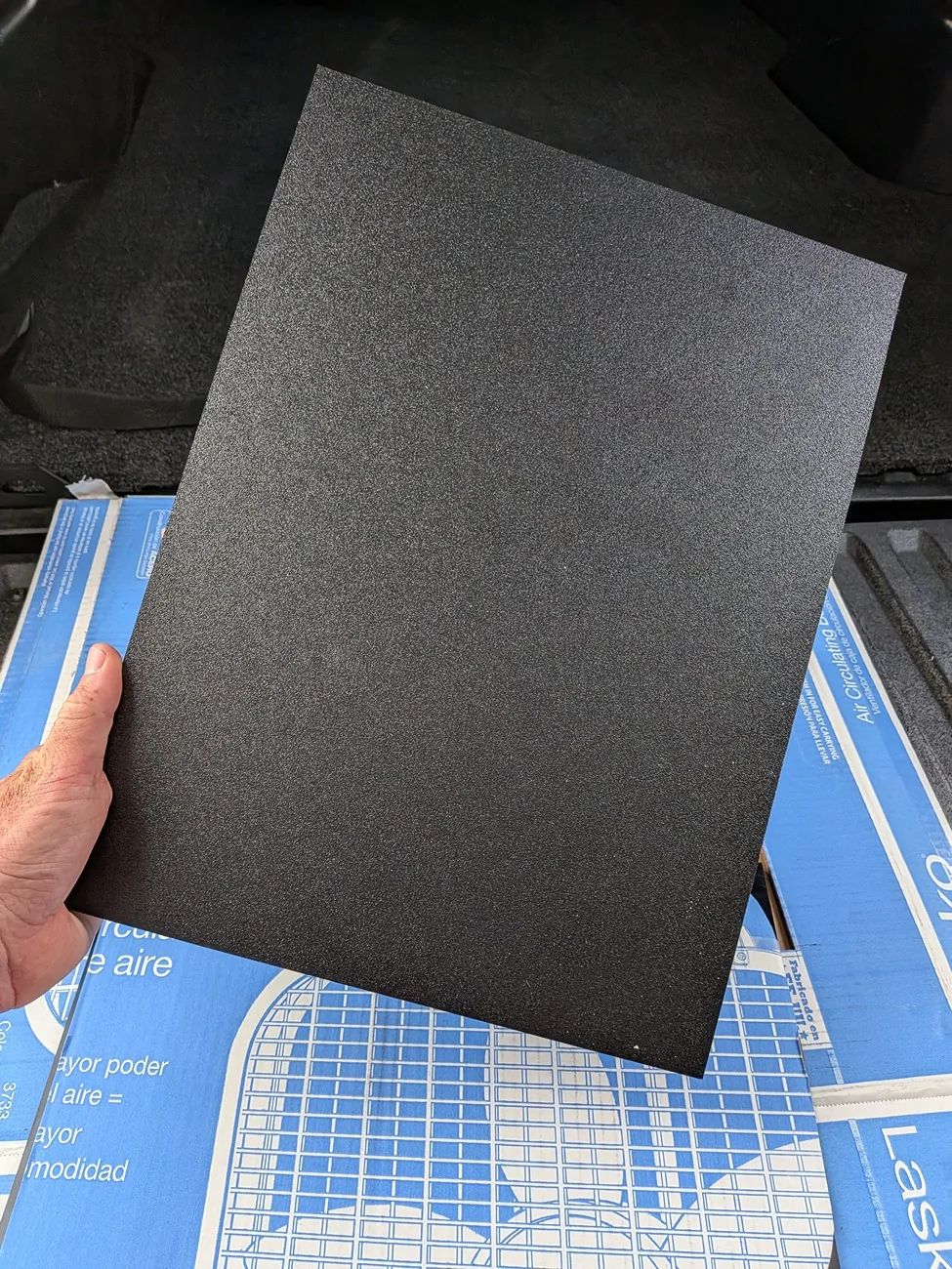

ABS sheet
2024 Tacoma DIY Diesel heater window port 5695

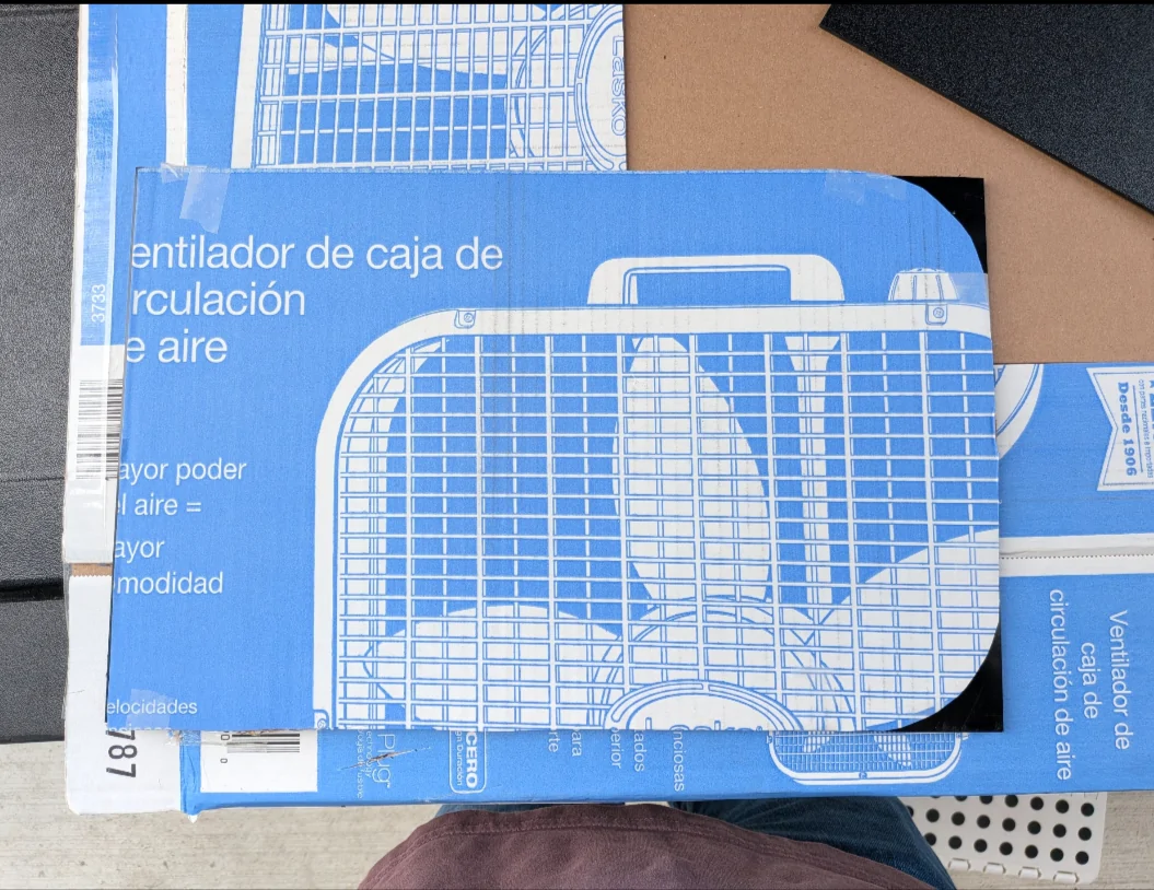

Cardboard template
2024 Tacoma DIY Diesel heater window port 5708

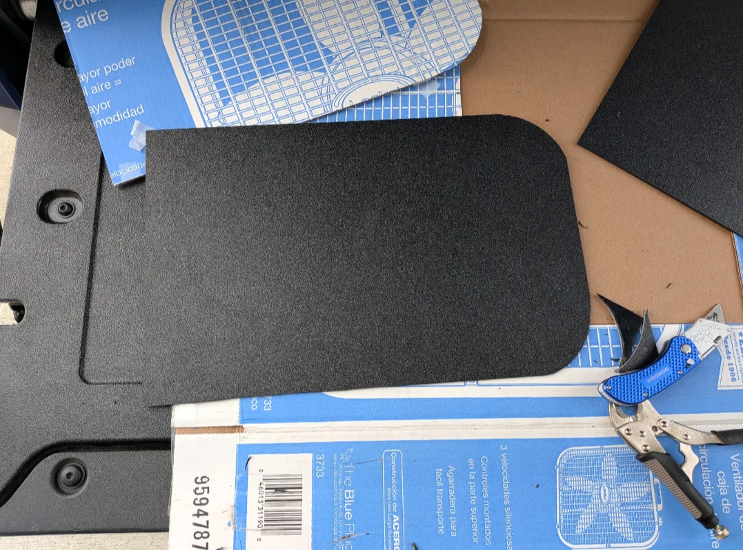

ABS cut out
2024 Tacoma DIY Diesel heater window port 5709

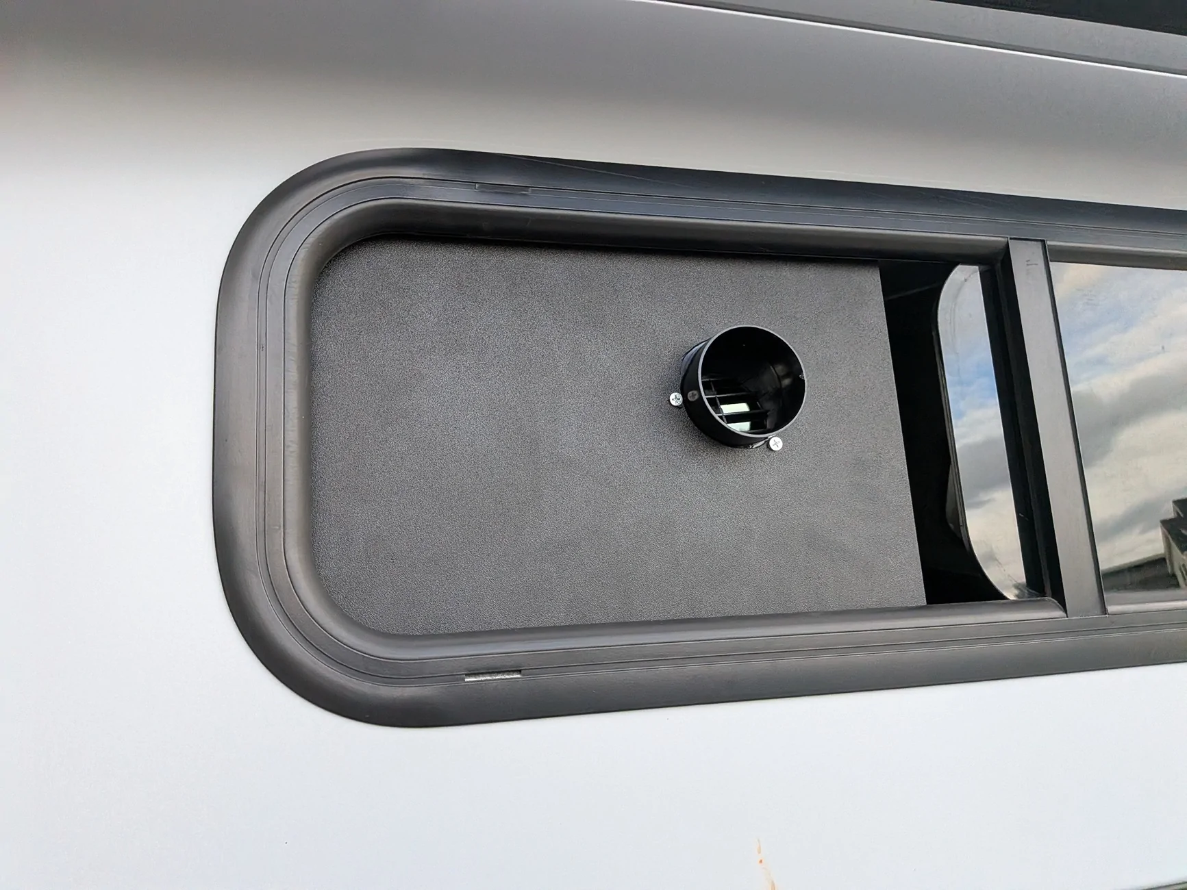

2024 Tacoma DIY Diesel heater window port 5698
3 inch hole with vent installed (screws backwards here)
2024 Tacoma DIY Diesel heater window port 5701

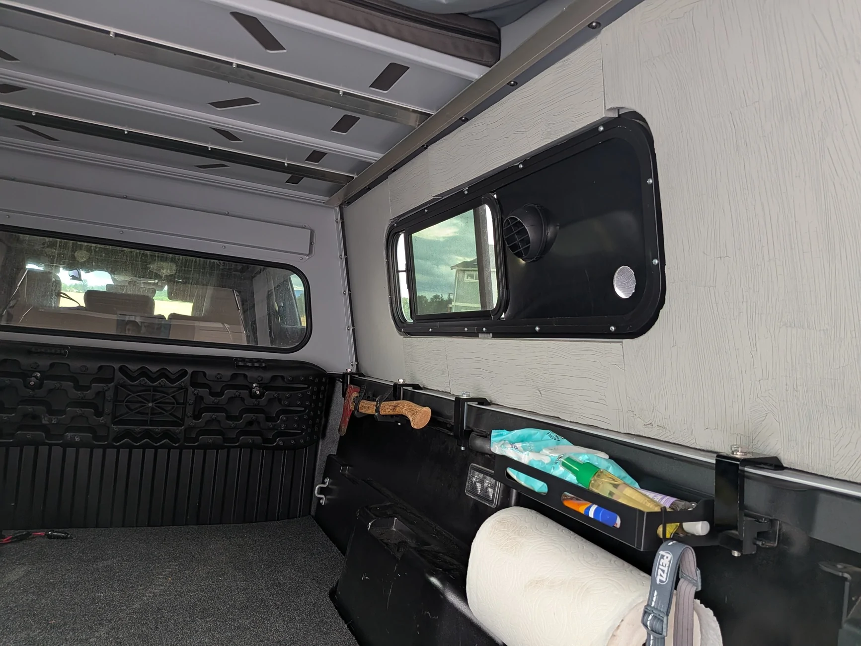

Ducting attached with hole for power cord grommet (will pickup shorter screws).
2024 Tacoma DIY Diesel heater window port 5702
2024 Tacoma DIY Diesel heater window port 5703
