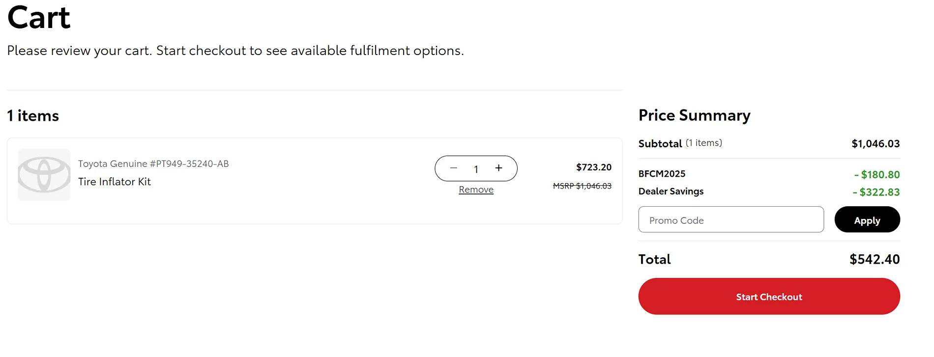

FYI this kit is on sale for $540 + free shipping at my local dealer this week for black friday.
25% off stacks with local dealer discount. about $500 off.

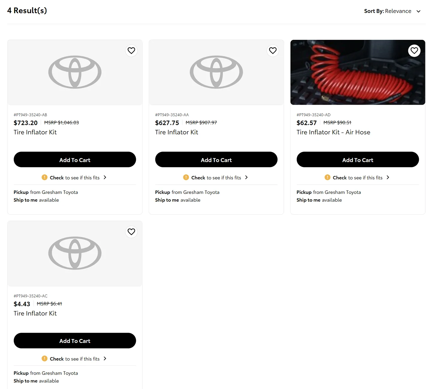

It looks like Toyota pulled the complete kit off their website so we can't get it with black friday
PT949-35240 is gone lol
Just checking into this today with the site wide deal. The individual parts aa+ab are way more than the previous combined part.
Interestingly many other parts departments are showing PT949-35241 as the replacement for the basic 35240. So now I'm even more confused.

Bummer, really wish we could figure out the right part number. Getting that for $5XX would be a great deal.
