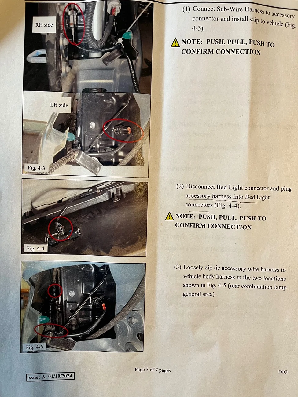

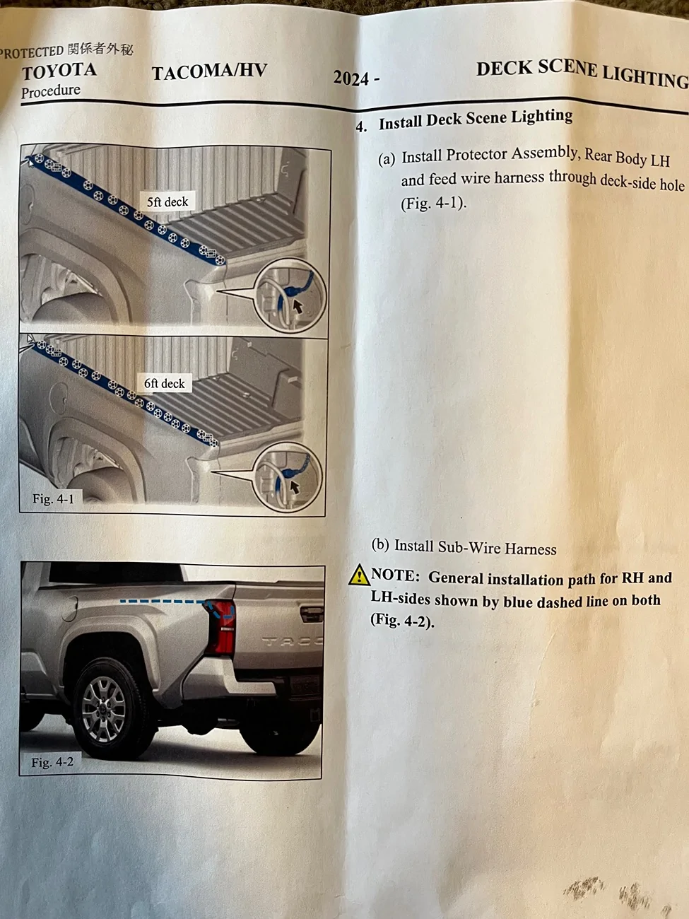

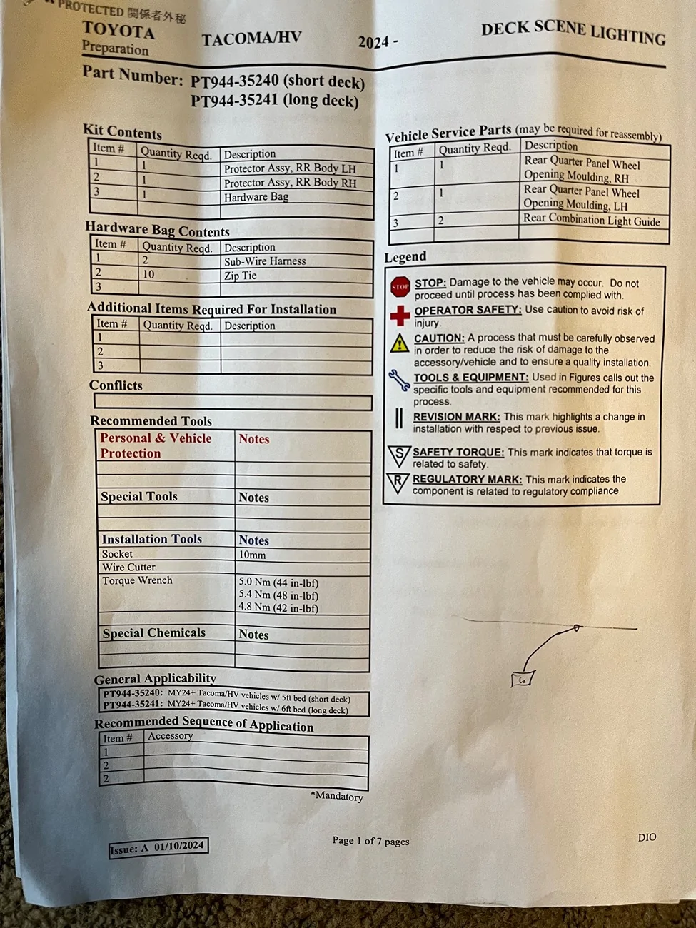

no pics sorry. But here a couple of photos from the install package.
The wiring comes off the back of the bed & feeds behind the taillight then to the bed light, both sides.
You need to remove the taillight & the bed light.
