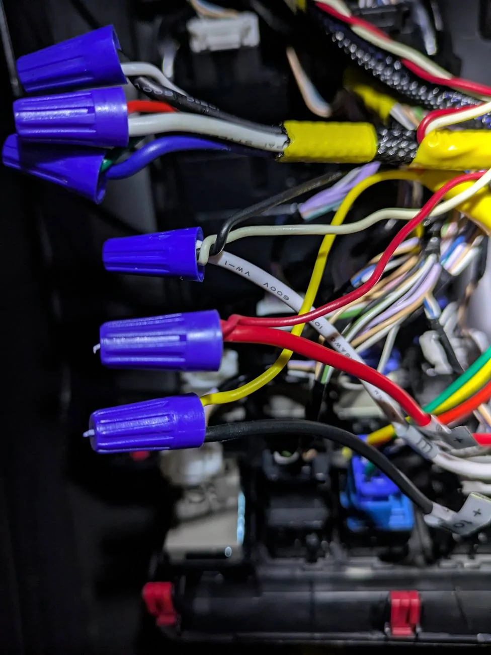

Wiring connections for the dash switch (done in order of the switch wire harness):
PurposeSwitch Wire ColorSource Wire Color
Illumination negative (ILL-)BlackWhite (factory)
RelayGreenBlue (Diode Dynamic harness)
GroundWhiteBlack (Diode Dynamic harness)
PowerRedWhite (Diode Dynamic harness)
Illumination positive (ILL+)YellowBeige (factory)

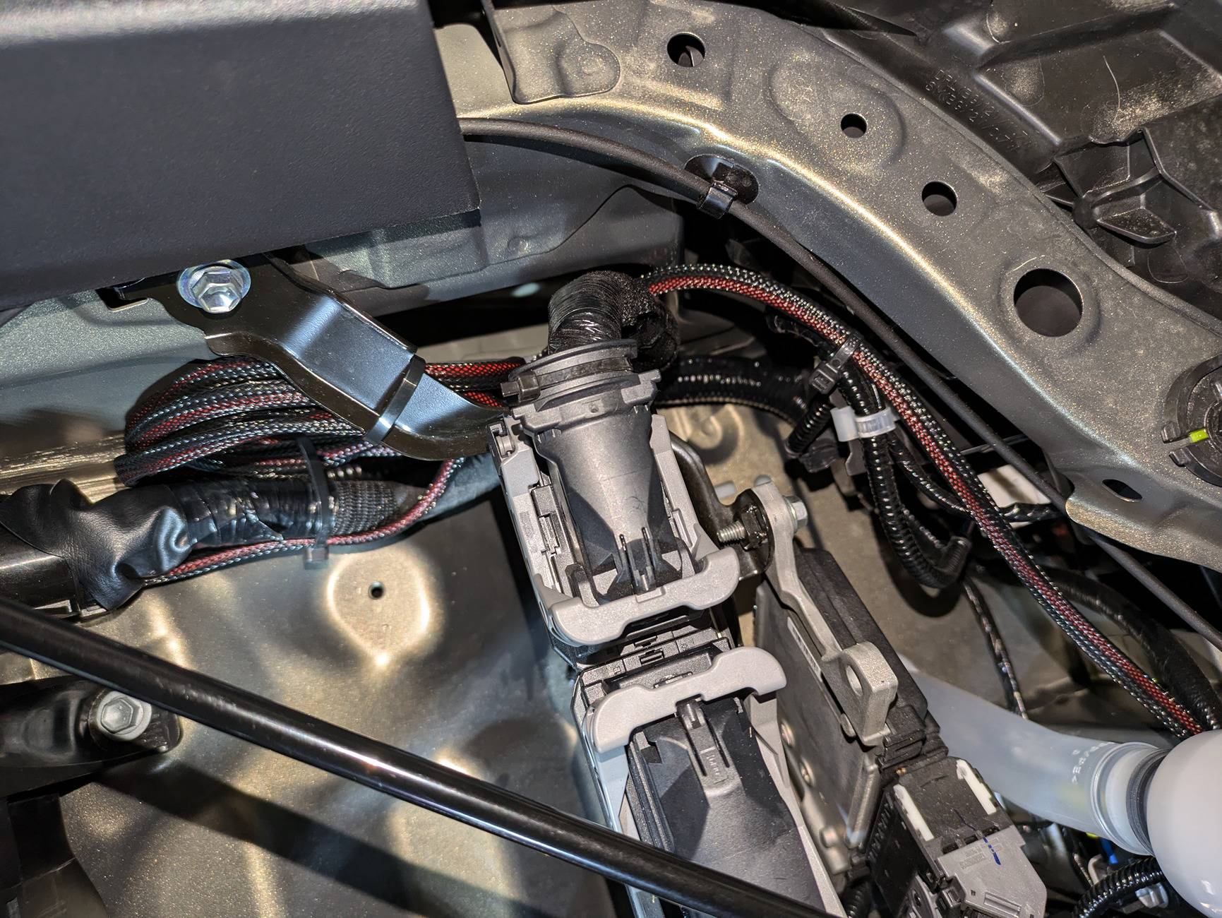

  • Yes, I have the "factory AUX" plugs, but none of the associated wiring/relays/fuses. Believe me this was checked first.
  • Illumination tapping: used an approach that was successful for me in the past when vehicles let you swap out head units (remember those days?). Solid 20g (or 22g) wire push inserted into the back side of an existing plug until it seats deeply serves as a "tap" without any actual alteration to OEM wires. a bit of electrical tape after keeps them from being able to work loose (stripped ends around about 1/2" or 1cm long).

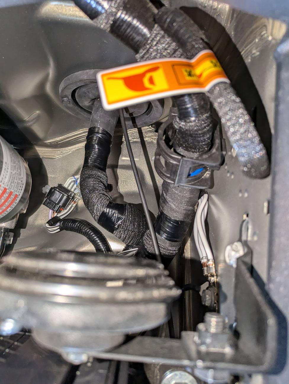

  • I snipped the end off the secondary nipple through the firewall gasket using side cutters (it takes some work to get them to it). There's a line molded on where to cut to get past where it's solid. The interior opening is the exact size needed for the DD wire harness (once you slyly remove the plastic plug temporarily).
  • If you use a very small flat bladed screwdriver, you can press the hold-tab within the white plug fitting to release each of the brass blades and be able to back them out, thus allowing you to electrical tape them into a small point for getting through the gasket hole without over-sizing it.
  • I took a very specific approach for my wiring because I knew this was the only "AUX" I intended to add and I wanted it water tight without adding a lot of extras that I never plan to use. You may opt for simpler or more complex depending on your end goals.

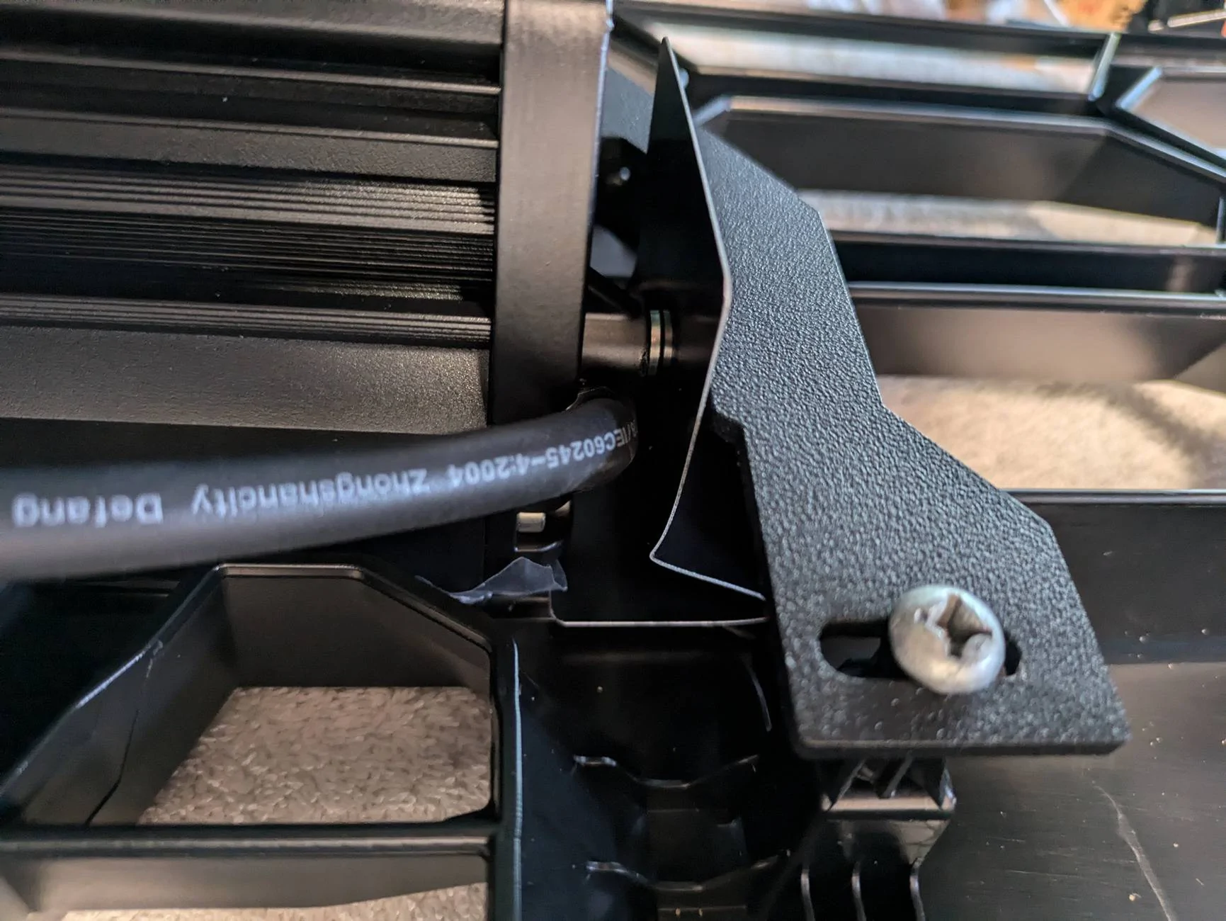

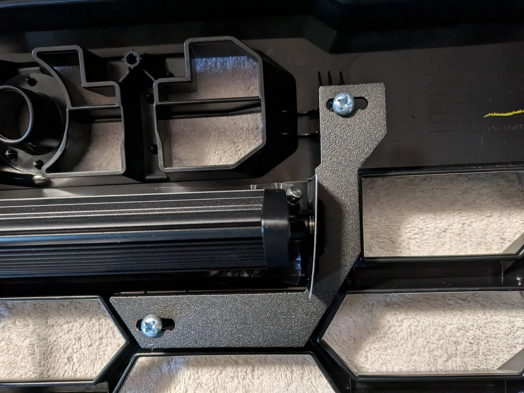

  • I took a ton of measurements for the grille bar opening, minimum edge on back, maximum edge on back and spent weeks brainstorming approaches for taking care of the approx. 1" or 2cm gap on either side of the light bar and the grille cutout. I ended up on a solution of using thin, highly bendable, anodized black aluminum. I was able to get a 5pc set of "cards" off amazon for a couple dollars. Then it was painter's tape, a bench vice with non-marring pads, and a high speed drill bit. Bent the card one direction approx. 1" or 2cm from the short edge, then approx 3/4" or 1.5cm further bent in the opposite direction. Then dry fit to mark where to drill for the bolt pass-through. Bends where then manually manipulated to form the target shape, with the goal of mild spring-like tension to hold it flush to the grill face. Once everything was set in position, needle nose pliers were used to twist and tweak alignment and pressure.
Steps I took:
  1. Fabricate grille gap closures
  2. Install light bar to grille so that light harness went to driver's side
  3. Install grille to truck, route plug up and strap to secure on grill mount point near washer fluid fill
  4. Fully disconnected battery (negative and positive) and let everything drain for a few minutes before the next step

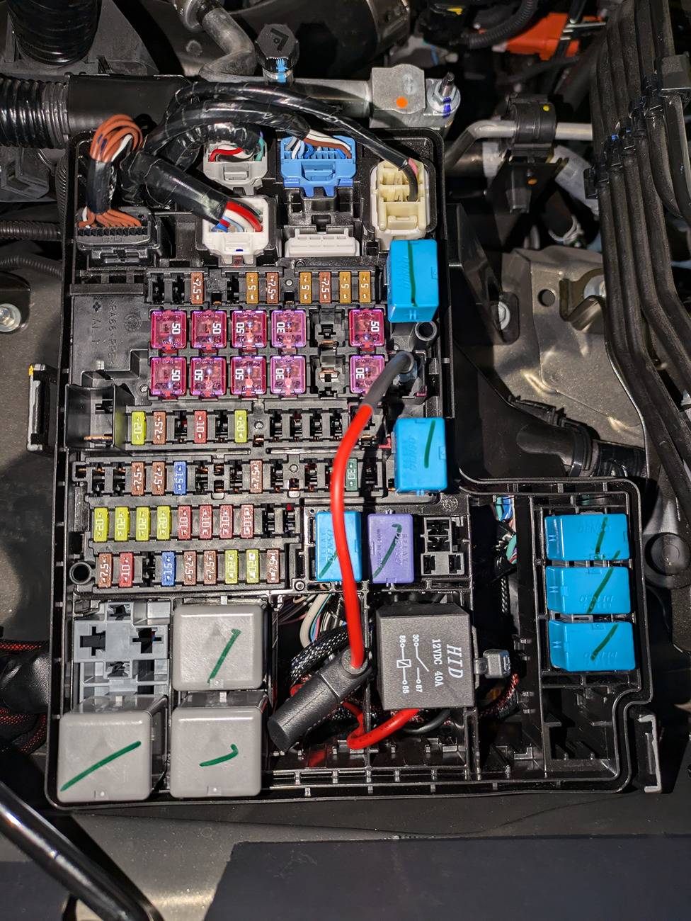

  5. Opened the driver side engine fuse&relay box and removed the sub-harness coming in on the front center corner (disconnect the five plugs, then double tab to release the harness and fold it out of the way)
  6. Removed the four mounting bolts from the F&R box, and cut each of the two zip ties on the wire harness ports on the front and rear of the box
  7. Used zip ties as "extra hands" for getting all NINE (9) snap tabs released around the F&R box. There are two on the side wall, two on the front, one on the engine side, two on the cab side, plus two very fragile reverse tabs on the cab side harness port. I worked them one by one pressing them in and sliding a zip tie in place to keep the tab from re-setting until I had everything released-ready
  8. Gently lift up and lean towards engine. NOTE: you won't be able to move this as much as you might want. It's TIGHT, but really just needed about 2" of clearance on the sidewall side of the box to work wires through the harness ports
  9. Strip the wire guard wrap off the DD harness leg that contains the power and ground wire taps
  10. Remove the metal mounting bracket from the DD relay, it'll just get in the way
  11. Feed grille side of wire harness down through vacant bay in the F&R box and work it out of the front facing harness port
  12. Feed the grounding wire tap down the same slot and out of rearward/cab side harness port. Keep it as clean and direct as possible to give yourself maximum length, you'll need it
  13. Now feed the plug side of the wire hardness down through the same slot and route through rearward/cab side harness port
  14. Pull slack of each cable all the way through so that you have just enough slack left to pull the relay connection up a few inches above the F&R deck (yes, your power source / hot line will be loose and not run anywhere yet
  15. Tuck all wires inside the F&R box into place and make sure your new runs are in the channels and not about to get pinched
  16. Re-clasp the upper and lower box shells together, make sure to confirm all nine points are latched again
  17. Put new zip ties on each harness port to secure properly
  18. Bolt the F&R box back down, re-attach the sub-harness, plug sub-hardness plugs all back in (at this point, you're back to "factory")

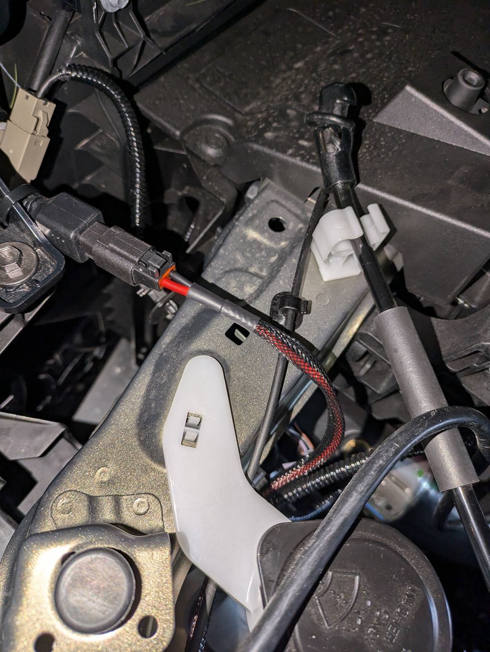

  19. Route the ground wire tap under the brake master and you'll find a factory grounding point on the sidewall just past it on the cab side. The DD hardness wire is the perfect length for reaching this location, but will not make it to the factory point closure to the firewall grommet. I used a mid-length extension to be able to reach the bolt and loosen it enough to slide the out-of-the-box (OOTB) blade into the stack and tighten back down. GROUND... CHECK!
  20. Take the red wire tap and cut the OOTB blade off the end. Slide some heat shrink onto the wire, then crimp on a 14g-16g insulated female spade connection. slide heat shrink into place and set. This will be the exact size for a very snug fit (it ain't moving without some plier force) onto one of the unused relay blades within the F&R box. I opted for the one that I felt was the cleanest. POWER... CHECK! (Do note, this setup means your relay has power all the time, even when the truck is off you can turn on your light bar by pressing the dash switch)
  21. For the wire going to the grille light connector, route along the outer wall and over towards the washer fluid fill and secure with enough slack to connect/disconnect
  22. Coil the slack tightly (about a 6" / 12cm diameter) and you can easily zip tie it against the sidewall between the F&R box and the ECU mounted in front of it. Alternative would be cut the wire to remove the slack, re-crimp, and heat shrink. I didn't want the break/penetration point.
  23. slide a zip tie through the back of the relay and work the slack wire into the bottom of the F&R box, use the ziptie to secure the relay from lifting up and moving around. I zipped it to the rail between two vacant bays. Then tuck inline fuse into another void to keep it out of the way
  24. Clip off the end of the lower gasket nipple to expose the pass-through

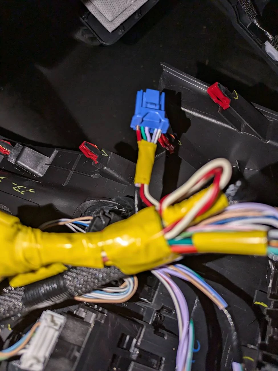

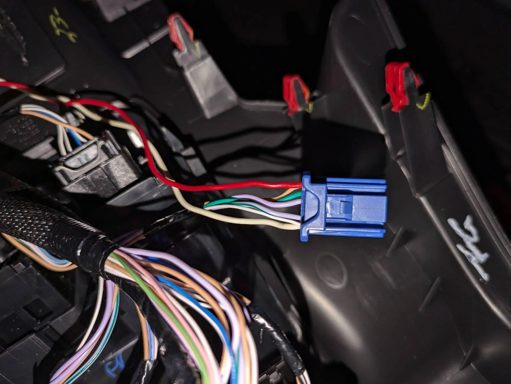

  25. Open up the interior dash sufficiently to access the firewall gasket and switches from the inside (see: https://www.tacoma4g.com/forum/thre...drivers-switch-panel-trim-removal-steps.7138/)
  26. I wanted to take advantage of the OOTB shrink keeping the wire sleeve together, so I used a small flat bladed screwdriver to release each of the three brass blades within the white connector fitting, I then wrapped them in electrical tape to form a point/needle. I recommend wrapping the tape until your past the heat shrink, otherwise the rubber on rubber will fight you. Apply a small amount of liquid soap to lube things up and the wire bundle will slide right through the gasket with a precision fit to the inside of the cab. I opted to pull all the slack through and then cut it off at a reasonable amount of play within the cab

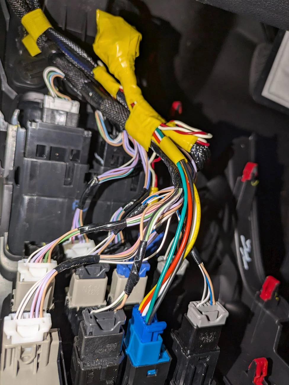

  27. Tap into the illumination circuit. I did so by stripping 2-wire 20g solid bell wire about 1/2" or 1cm and sliding it into the back of another factory switch, then wrapping with tape so that it couldn't work loose. I then brought that 2-wire together with the 3-wire DD harness to have my five (5) wires for connecting.
  28. Connect wires as specified in the table above, wire nut (or crimp), and secure. Make sure you tie down with tape or zips the full path of the wires so that you don't get "random rattle" later on
  29. At this point, you could reconnect your battery to let things power up and to make it easy to test in a short bit. Or, wait until the very end.
  30. There are two tabs to release the switch blank, they are on each side of the plug on the back (where it is tight to the next plug). use a trim tool or screwdriver to release one, then the other. The blank will push out to the front (dash face)
  31. Insert your new grille light plug from the dash front, push until you feel it seat securely
  32. Plug in the switch harness, finish securing any loose wires

  35. Tape/seal the wires passing into the gasket on the engine side

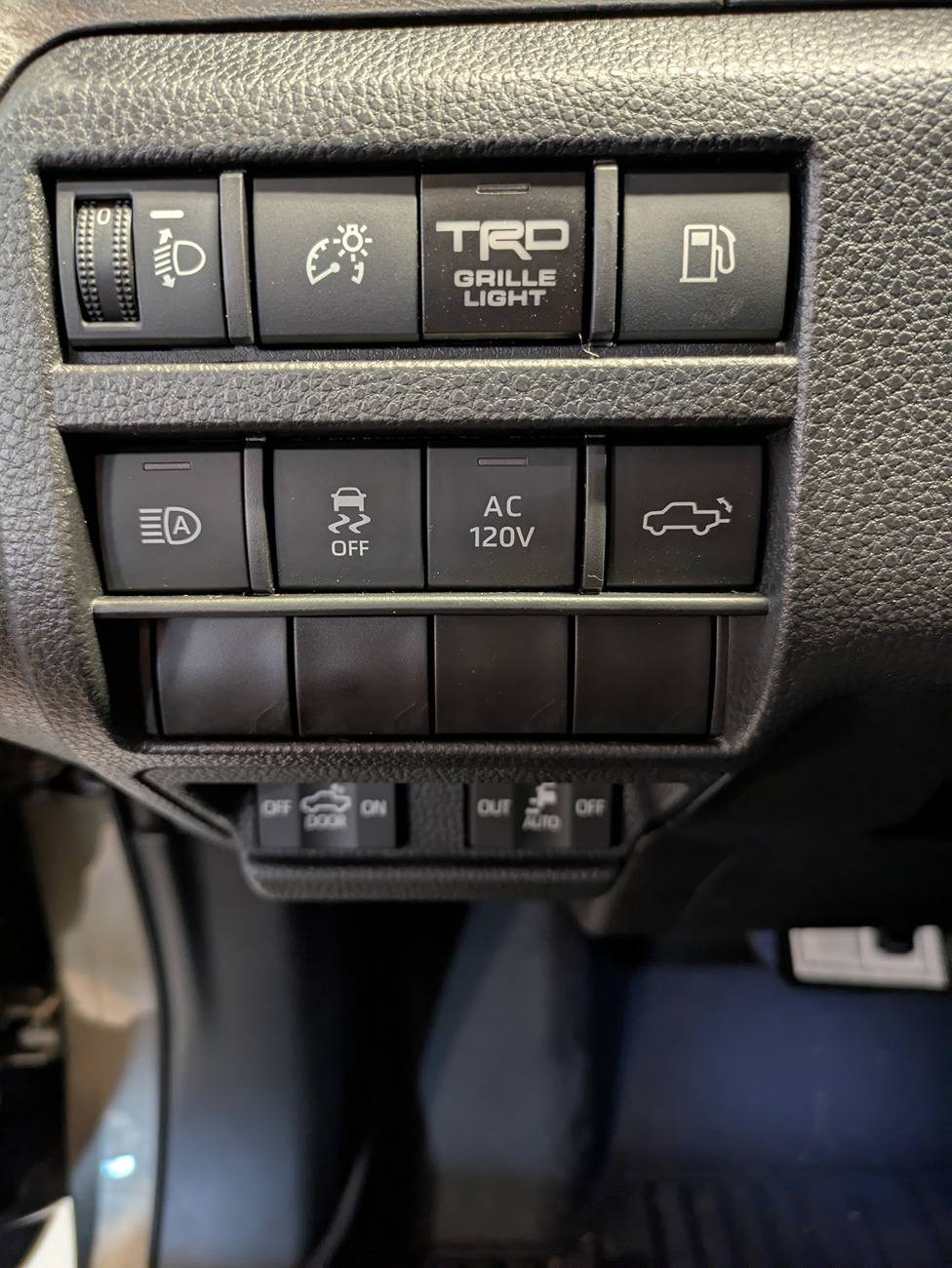

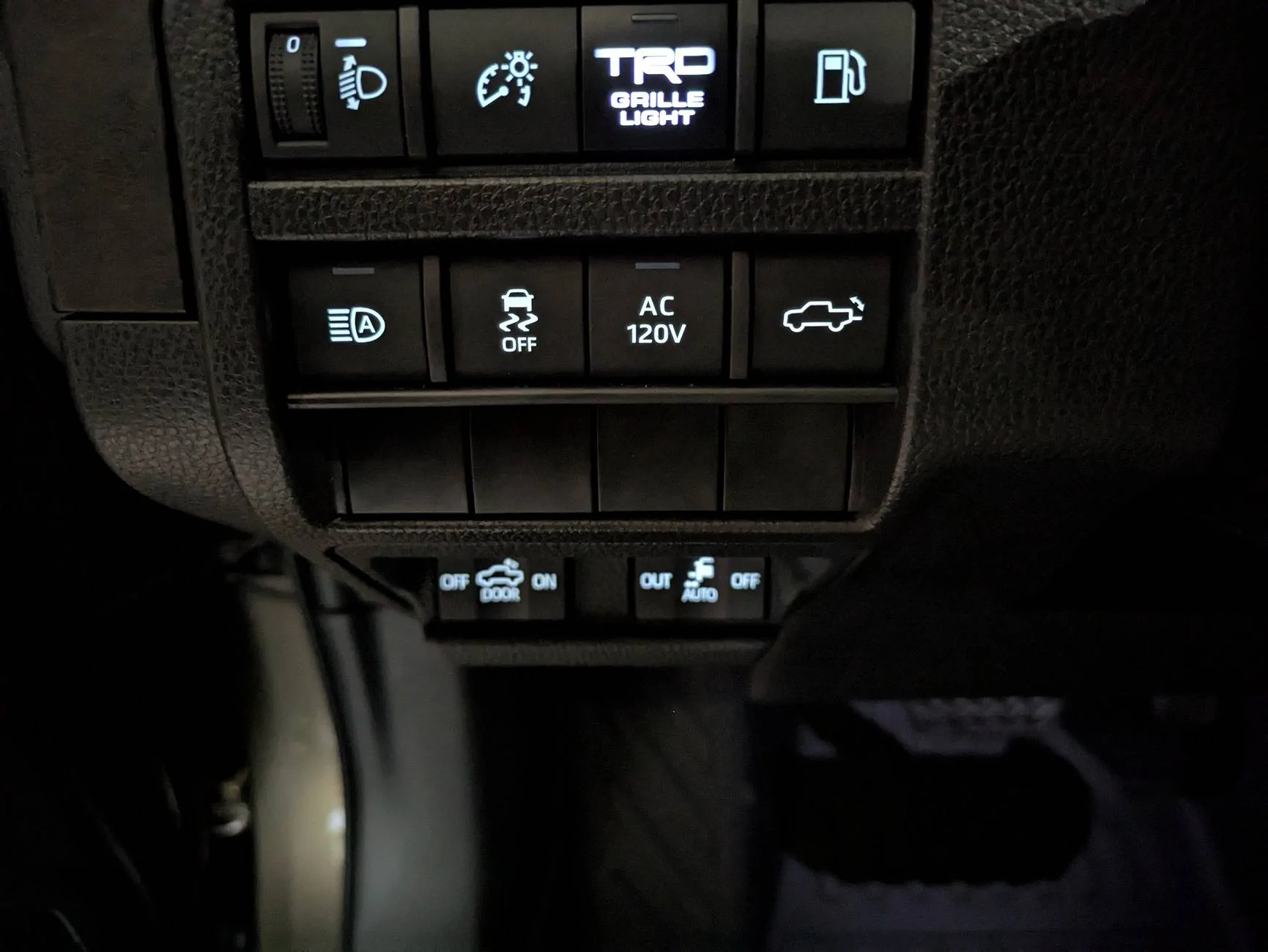

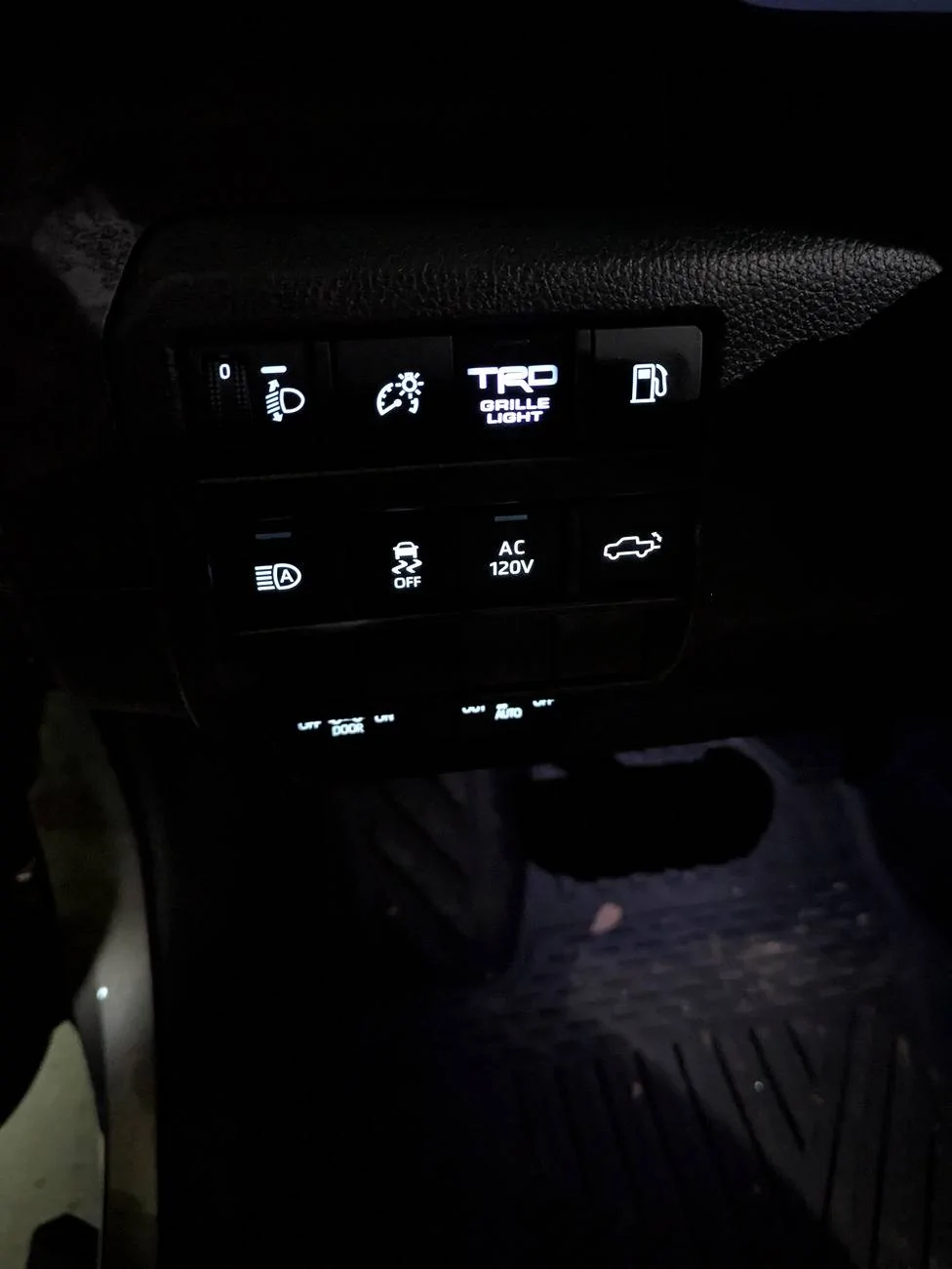

It was bugging me that the Rave Off-road dash switch was so much brighter than factory. The illumination color is something both Rave and Cali could have done better with, but both don't match, so equal offenders.
I bought an RV DC 12v dimmer control off Amazon and installed it online on the illumination circuit. The control box is only about 2" x 2" x 1" once you pull the knob and remove the mounting face plate. I then wrapped and zip ties a piece of foam wrap around it to pad an minor rattling and worked to position it such that if I want to adjust in the future I only need to pop the decorative and "secret compartment" trim pieces to access the knob. Once all wired together turn dash lights on full and adjusted the knob until I felt like highest two dash setting we roughly equal (just different light colors). When you see how low you set the dimmer, it gives understanding here on how both companies really dropped the ball on "matching the OEM" and didn't even try to calibrate their light intensity. Toarch the upper brightness levels there's an every so light flicker at the very lowest setting but I'm okay with that. Others might opt to set the dimmer as low as possible without flicker and then let the brighter steps be what they will be from that point. Some new photos added in support.
Dash switch - no power
2024 Tacoma DIY: Heritage Grille + Diode Dynamics 18" light bar on a vehicle without factory AUX 2024-11-16 14.08.03
Dash switch illuminated. Notice, brighter and slightly whiter than OEM.
Still contemplating if there is an "easy" way to throttle the illumination power to it so that it would dim down closer to OEM ones.

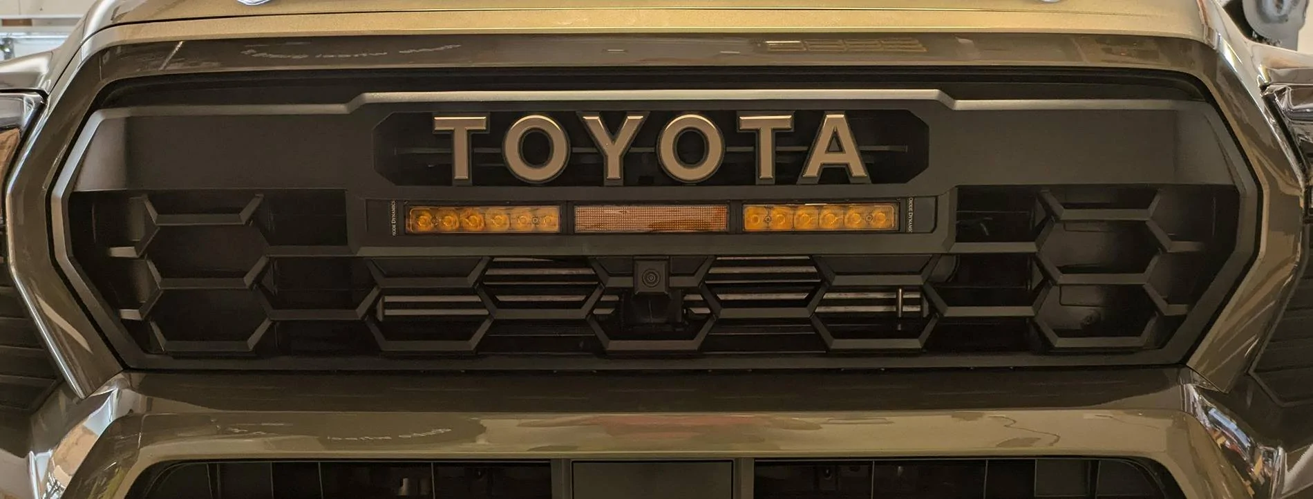

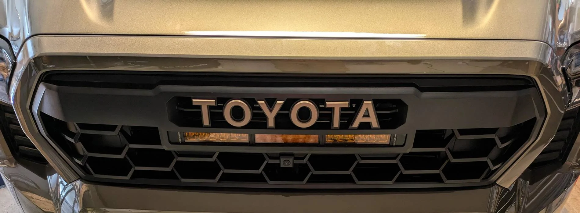

Completed Grille Appearance
2024 Tacoma DIY: Heritage Grille + Diode Dynamics 18" light bar on a vehicle without factory AUX 2024-11-09 14.49.39a

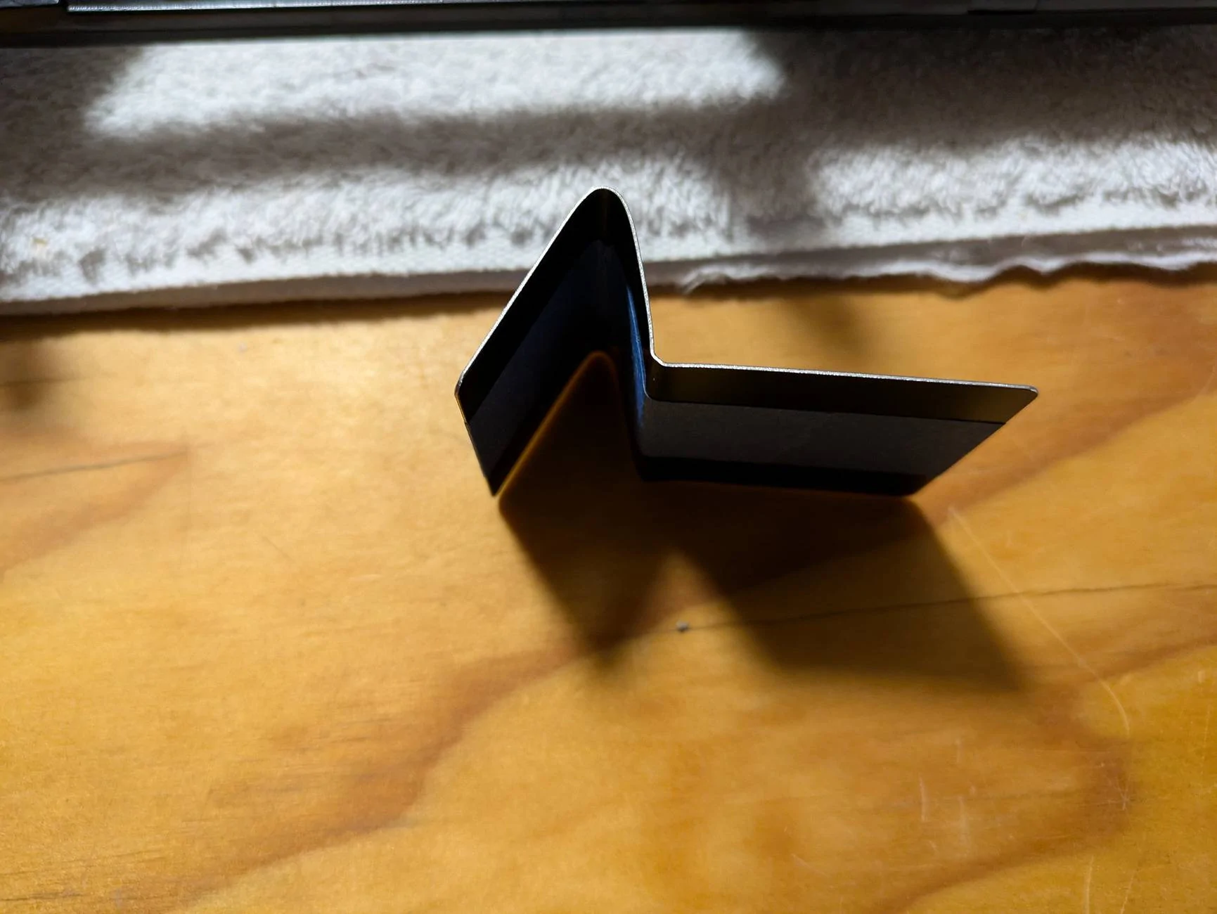

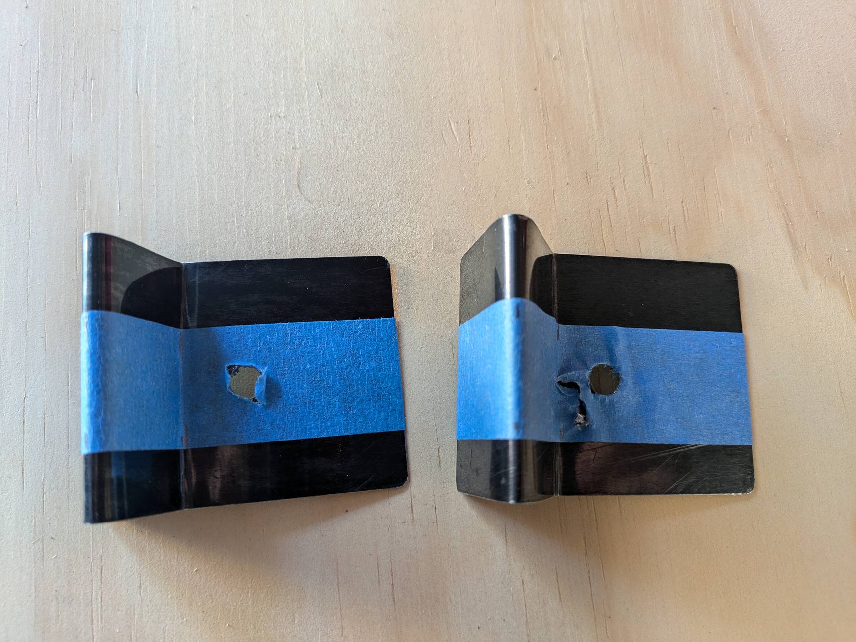

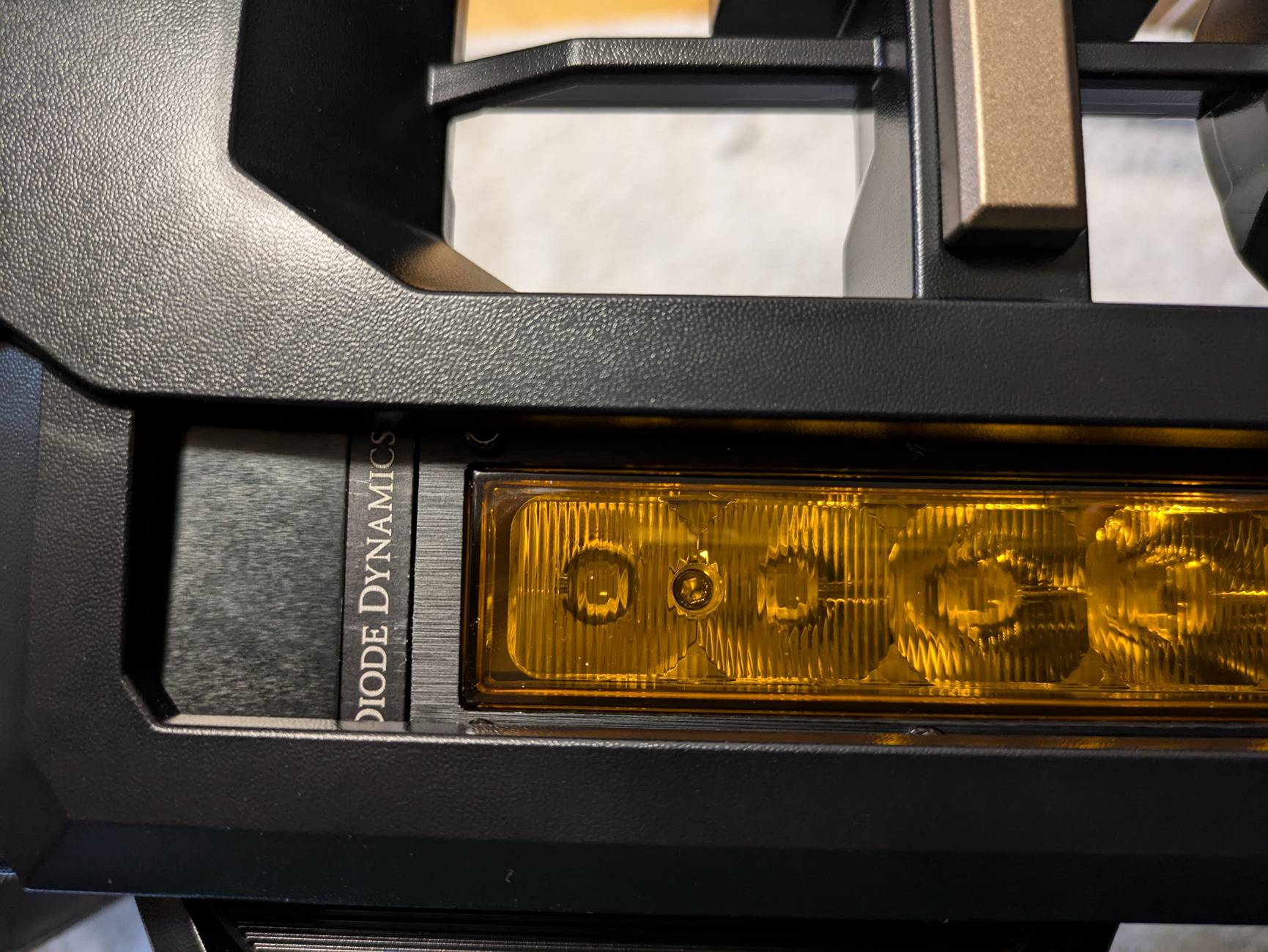

My custom side-fill spacers made from the anodized aluminum cards
2024 Tacoma DIY: Heritage Grille + Diode Dynamics 18" light bar on a vehicle without factory AUX 2024-10-17 18.46.24
Side-fill in place, setup is washer-lockwasher-card-lockwasher-bracket-lockwasher-nut... yeah, I don't like things to move once I tighten them down.
2024 Tacoma DIY: Heritage Grille + Diode Dynamics 18" light bar on a vehicle without factory AUX 2024-10-18 17.42.52

Tapping the back of another plug for illumination. If the wire doesn't insert and it's 20 or 22 gauge solid, try a different position within the "cell". It's finding the spot where it slides past the crimp on the connected wire, then it'll tuck in nicely.
2024 Tacoma DIY: Heritage Grille + Diode Dynamics 18" light bar on a vehicle without factory AUX 2024-11-11 14.20.46
Close up of side fill from the face
2024 Tacoma DIY: Heritage Grille + Diode Dynamics 18" light bar on a vehicle without factory AUX 2024-10-18 17.59.20
What the side fill looks like from the backside straight on. The extra wing is no longer than the depth of the lighting unit and doesn't impact anything. keeping it was both less work and extra insurance in case I needed to shift the bolting hole.
2024 Tacoma DIY: Heritage Grille + Diode Dynamics 18" light bar on a vehicle without factory AUX 2024-10-18 17.43.19
Extra cable between Relay&Fuse box to light bar coiled up and zipped cleanly out of the way for any servicing. Second option would have been to pull it backwards into the F&R, cut the wire and protection wrap, and re-crimp.
2024 Tacoma DIY: Heritage Grille + Diode Dynamics 18" light bar on a vehicle without factory AUX 2024-11-11 13.14.32
Everything inside the cabin taped up and secured before closing up the dash
2024 Tacoma DIY: Heritage Grille + Diode Dynamics 18" light bar on a vehicle without factory AUX 2024-11-16 14.04.46
Another close up of how the aluminum card closes the gap. I'm extremely happy with how it came out. it rests against the final indent of the DD housing and so it has a very small "lip" that it rests against to help keep it lined up.
2024 Tacoma DIY: Heritage Grille + Diode Dynamics 18" light bar on a vehicle without factory AUX 2024-10-18 17.59.25
Picture of what the gap fill brackets looked like before pulling the painter's tape and putting into position. Once in position, needle nose pliers were used to "tune" the fit and alignment.
2024 Tacoma DIY: Heritage Grille + Diode Dynamics 18" light bar on a vehicle without factory AUX 2024-10-18 17.24.45
Connect/Disconnect point routed and mounted to be next to washer fluid fill. One side stays with grille, other side stays with truck, so I never have to worry that I forgot to cut a zip tie should I need to remove the face of the truck again.
2024 Tacoma DIY: Heritage Grille + Diode Dynamics 18" light bar on a vehicle without factory AUX 2024-11-11 13.14.54
14g-16g insulated female spade crimped, heat shrink for extra protection. It's a perfect and very snug fit onto the unused 30-50A spades. They are all 12v constant hot sources. Then folded the tail with inline fuse into one open bay space, while tucking the flex down into the box and using a zip tie through the hang tab slit to secure the relay from being able to bounce/move/rub around inside the F&R box. If I need to service, I just clip the zip tie to lift it higher and out.
2024 Tacoma DIY: Heritage Grille + Diode Dynamics 18" light bar on a vehicle without factory AUX 2024-11-11 14.13.17
2024 Tacoma DIY: Heritage Grille + Diode Dynamics 18" light bar on a vehicle without factory AUX 2024-11-16 14.03.56
Dash switch after dimmer install and adjustment
2024 Tacoma DIY: Heritage Grille + Diode Dynamics 18" light bar on a vehicle without factory AUX PXL_20250101_210410391

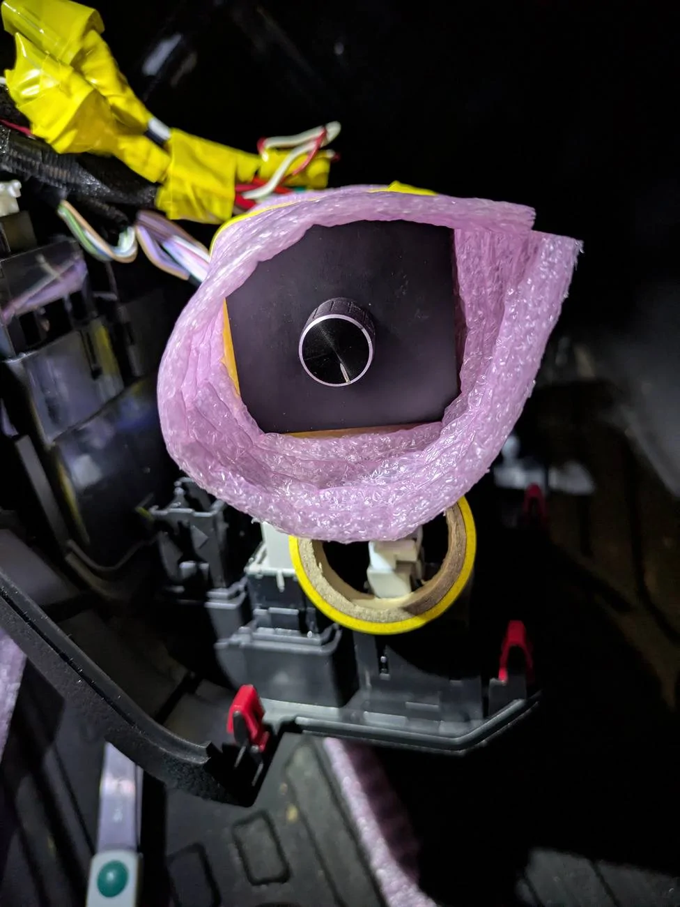

Dimmer wiring:
Beige factory to red, button yellow to black, white to white. The dimmer had labels on the legs making it very straightforward.
2024 Tacoma DIY: Heritage Grille + Diode Dynamics 18" light bar on a vehicle without factory AUX PXL_20250101_203937770
Dimmer module wrapped and without faceplate. To remove the faceplate you pull the knob straight off and loosen a hex ring nut, slide the plate off, the put nut and knob back on.
2024 Tacoma DIY: Heritage Grille + Diode Dynamics 18" light bar on a vehicle without factory AUX PXL_20250101_205609683

What size screw did you use to secure your metal bracket to the plastic grille?
Baltimore
Jul 23, 2024
588
304
Maryland
4g hybrid
Are you referring to the filler on each side? If so that's not affixed directly to the grille at all. It's only through bolted to the light bar mount screw. Then folded/bent with tension to hold position. Hasn't moved at all in 5k miles of driving so far.

Ok im curious, and maybe i need to search the forums but why do people have to recalibrate for OEM grills like trail hunter or trd pro? Is it because those trucks sit higher off the ground than let’s say trd off road?
The grilles have different mounting angles. And technically the heritage grilles want the camera mounted upside down, and these modified brackets keep it upright but at the cost of incorrect default lens angle.

That is a sh&t ton of work but WOW just WOW that is OEM as it gets. Nicely done and thanks for sharing. Now I know I don't want to tackle that :crackup:
