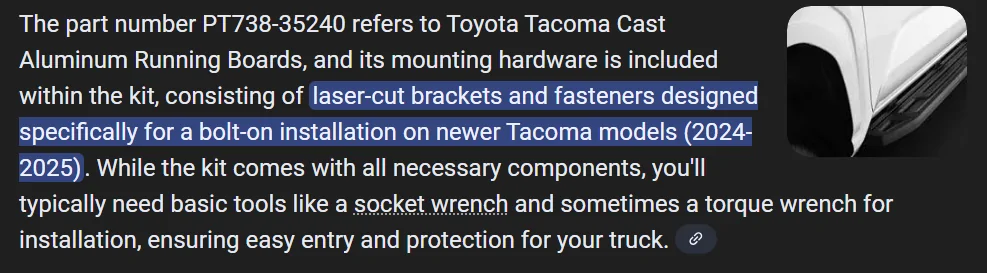

AI seems to think they should come with the required fasteners
I believe the brackets and fasteners are attached but no instructions and no bolts
Please don't post "AI said..." answers. They're often incorrect, as the answer is wrong in this case.
AI is only furthering the enshittification of the internet.
I'm not trying to be a dick, I'm just against the AI BS that's becoming way too common.
I found the PDF of the install manual by searching "PT738-35240 pdf" (see attached). It confirms that no hardware is included and the bolts should be installed on the truck already.
