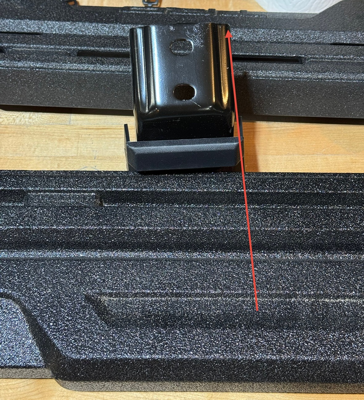

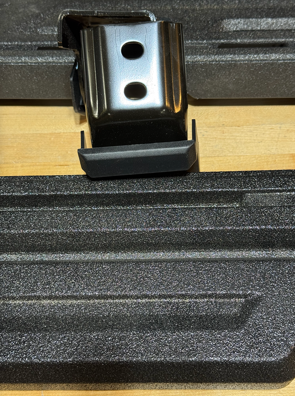

I just received mine for a planned at home install, and all the mounting brackets are angled back. Of course the installation instructions are worthless and do not mention anything about re-alignment, so curious if anyone else encountered this. The bracket holes all appear straight/90 degree so I'm assuming these will need some sort of correction.

I had the same exact issue with mine, all of the brackets were off and a bunch of the bolt holes didn’t line up. After thinking something was wrong and that I’d have to send these damn things back, I realized I was overthinking it way too hard.
Simply loosen bolts holding the bracket to the board itself a little so they can move, then thread all the bolts into the pre-threaded holes underneath the truck, realign the brackets and tighten them once the running board is loosely bolted underneath and then tighten everything up.

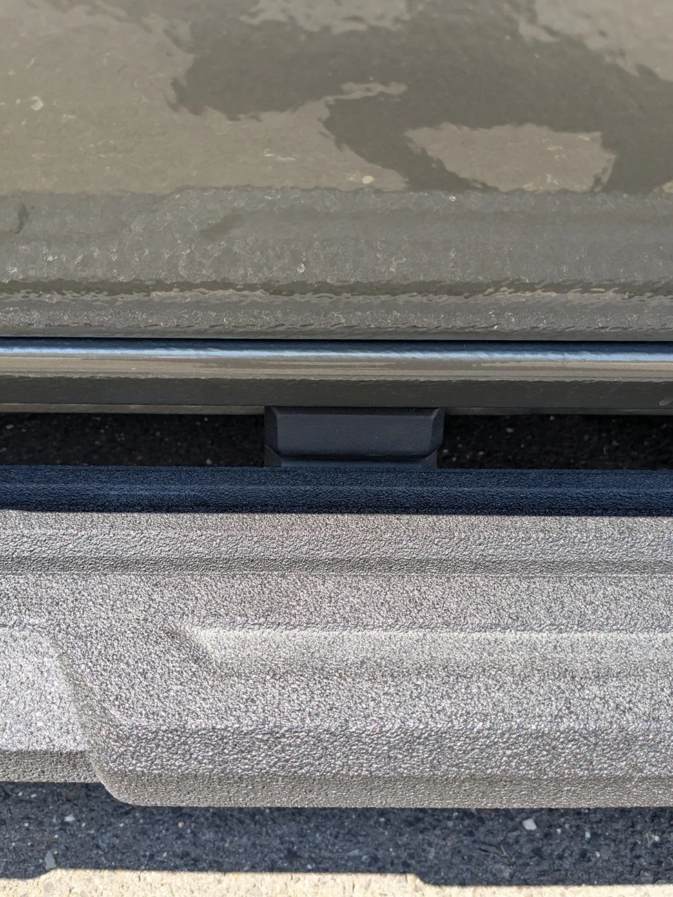

yep, exactly. Mounted them tonight. They look fine. Just the way they are made to accommodate the shape of the truck it seems. It’s wild though because the predator tube step I removed has brackets they are totally straight. ĀÆ\_(惄)_/ĀÆ

Looks great! My truck didn’t come with anything so I didn’t have something to remove and compare with.
