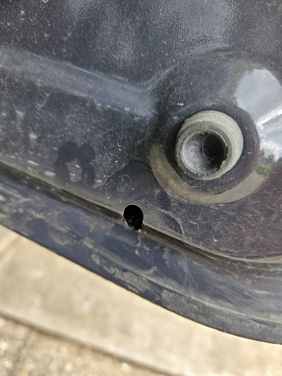

Went to open the passenger side rear door on my TRD Sport and notice a sloshing sound. So I assumed the door drains were clogged, I've had this happened with previous vehicles, no big deal. I then noticed that the drain holes had plastic plugs, pull them out and out came about a gallon of water. I can't reason why Toyota would plug these holes. Has anyone had this happen? I think i'll just pull the other door plugs so the door can a least drain naturally.

Can you take a pic of the other side? (See next post - I found it)
They usually allow passage of water, but provide some sealing against dust and bugs from getting in. Perhaps yours were clogged.

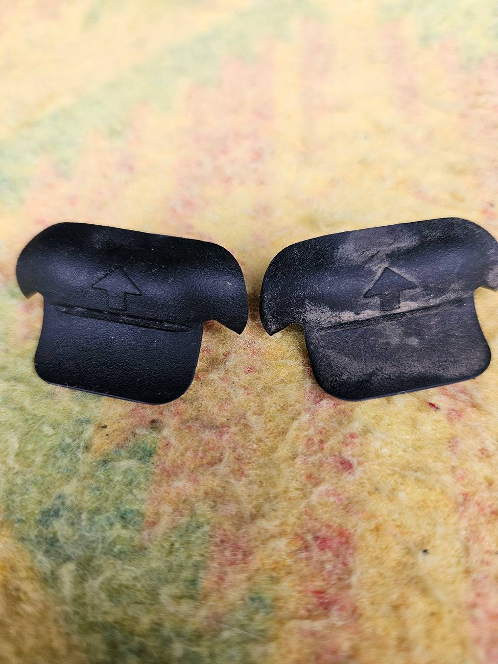

I looked them up - part number 67837-47060.
They are supposed to allow water to drain under them. If your truck is parked outside, either frequent drain cleaning or removal of these covers will probably be needed.

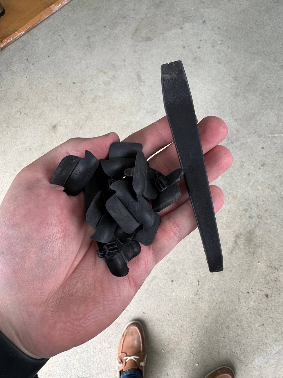

Okay I’m convinced, they’re extremely easy to remove, prying up from under the bottom of the plug

Yeah - good info. I need to check mine and I like the idea of only putting some of them back or maybe not putting any of them back since they seem to get clogged up. I would rather have a little dust in the doors than have the doors holding water.
