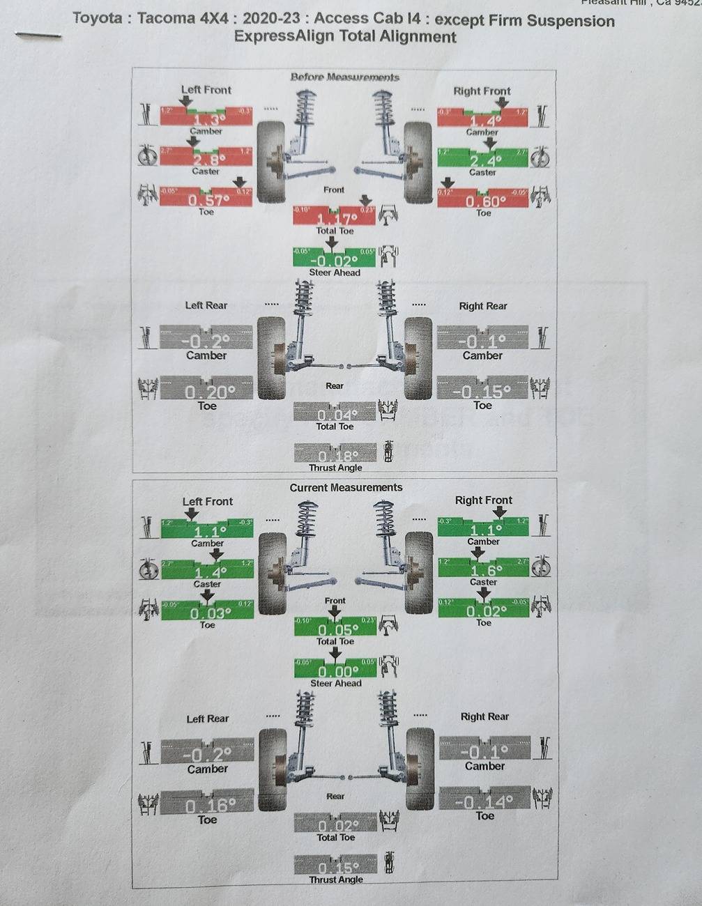

Picked up our 2025 truck from Firestone and realized the print out sheet said 2020-2023.
Called them and seeing what they say. This is obvious wrong right?
Is there any alignement to be done for the rears on the offroad?

I checked on chatgpt and the toe alignment spec is a little different. Caster and camber is the same. As long as they made the toe adjustments to new specs , shouldn't be a problem.
the 4gen is a completely different truck , I'd go back & say bring it to 2024 specs or give my $$ back.
Say the tires burn off due to a wrong spec six months from now ,You think that local Firestone shop is gonna replace them ? ask that question of them & get it in writing if they say yes

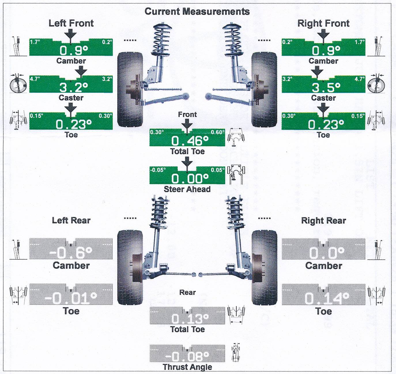

This is what they gave us as results.
Been scratching my head comparing it others I found on this forum.
Hey, were you guys able to resolve that issue? I just put 285 tires on a stock suspension with an independent tire shop, and I feel that it slightly leans to the left, and my driver-side front tire may be sitting more to the left.
this is on stock suspension

Chances are they did that because they haven't updated the alignment machine for 24/25 vehicles yet. My shop hasn't updated either, so I usually will select the newest year for that model of vehicle, go look up the specs for both to compare and align it to the oem specs for the new vehicle. 9 times out of 10, the specs are damn near the same, though.

I just took my 2025 TRD-OR to the dealer for an alignment after doing a lift. The service writer said they had an issue because the alignment specs between 2024 and 2025 were different. Ya, no kidding. They didn't have the 2025 specs and had to track them down.
