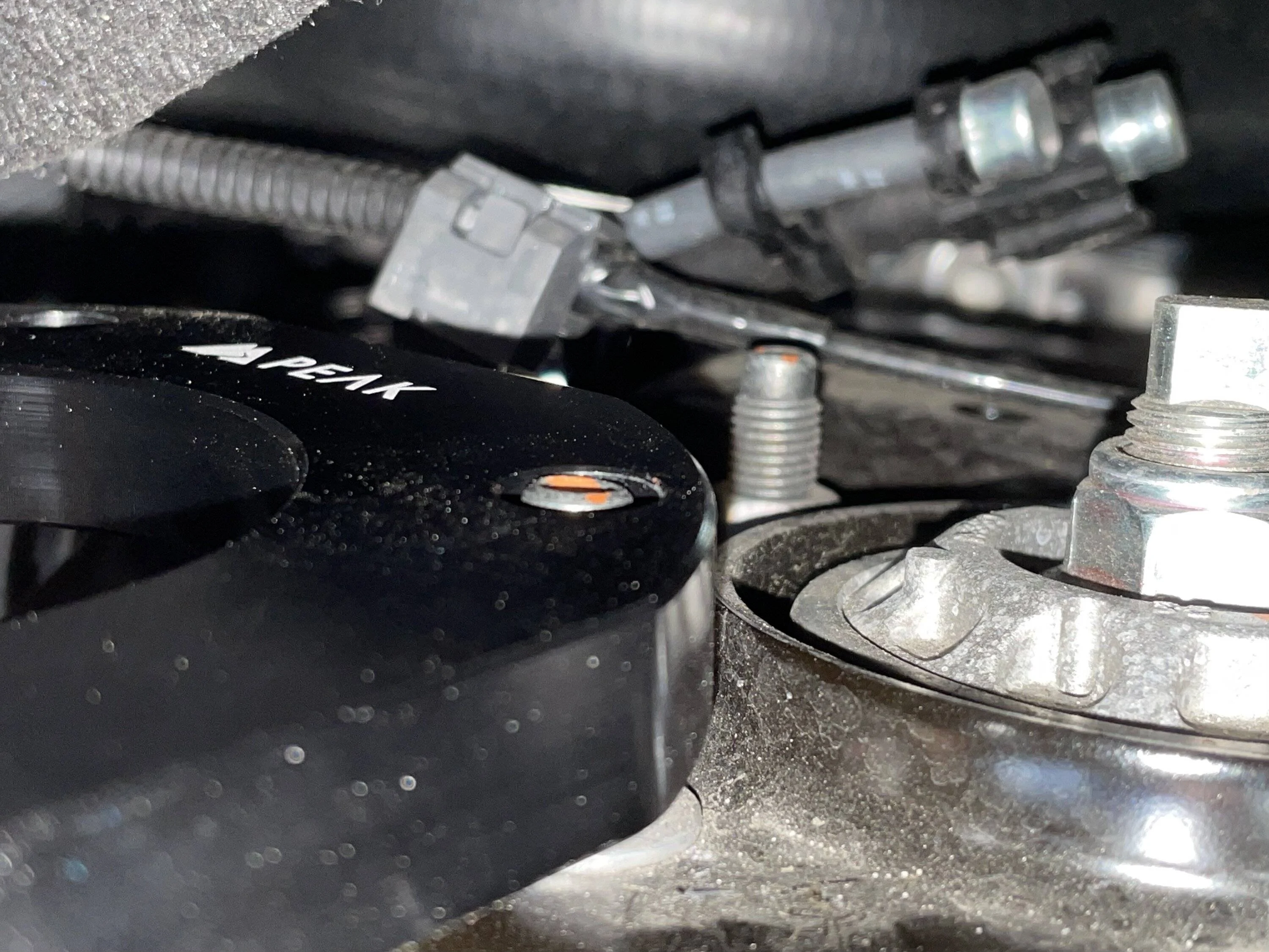

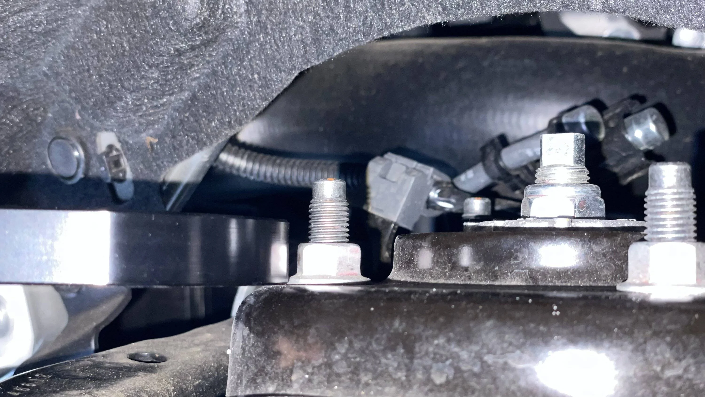

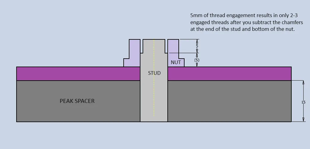

Are you concerned that the top spacer for the Peak kit results in only 5mm of nut thread engagement (losing half the engagement ). The spacer is 15mm thick. The nut is 10mm tall. The stud from the top of the nut is 15mm with the top 5mm unthreaded. This means that after installing the spacer, your the nut is engaging half as much thread as intended.
I bought the spacer only kit and I’m concerned about this. I contacted Peak and they said they’ve sold over 1000 of these kits and haven’t had any issues.

I work with Peak really closely
And its not concerning at all! The rule of thumb for any fastener is 3 fully engaged threads, and there is way more than that despite there not being a stem above the nut. It is nothing to be concerned about, but Peak suspension has addressed it by now including shorter nylock nuts. If you have any questions, they’re really responsive

As far as our top spacer design goes, it was designed with a couple things to take into consideration. The first thing to take into consideration is safety with thread engagement. I understand Michael’s concerns, and we have spoke in length about it, however when it comes to safe operations of fasteners, 3 full thread engagements is all that is needed to be deemed safe, and we have more than that. These are simple, full thread flange nuts that come from the factory, and indeed work quite well. While they may “look” like they aren’t all the way tight, or a concern they can spin off, they won’t. Additionally, as another user stated, loctite is a surefire way to add a little peace of mind.
To further touch on the stud portion, there are no forces at play that would be a reason for concern. The top mount is mounted against and through the frame, with zero play and there’s no lateral forces being exerted on the studs to be a reason for fear. On top of that, even if a nut or all of the nuts would somehow spin off, the shock wouldn’t just fall out of the truck. Even at full droop, the shock would remain in place albeit make a bunch of noise but as far as a safety concern, there really isn’t any.

Thanks for chiming in. I do agree that the risk is low since the strut is captured and there are no loads on the studs. My concern has been more around stripping the threads when torqued to spec (or if a torque wrench isn’t used - over torquing). I was hoping to discuss with someone at Peak on the phone vs email exchanges but never received a phone call. I do still think this is an elegant solution and appreciate y’all bringing the solutions we want to market. 🍻

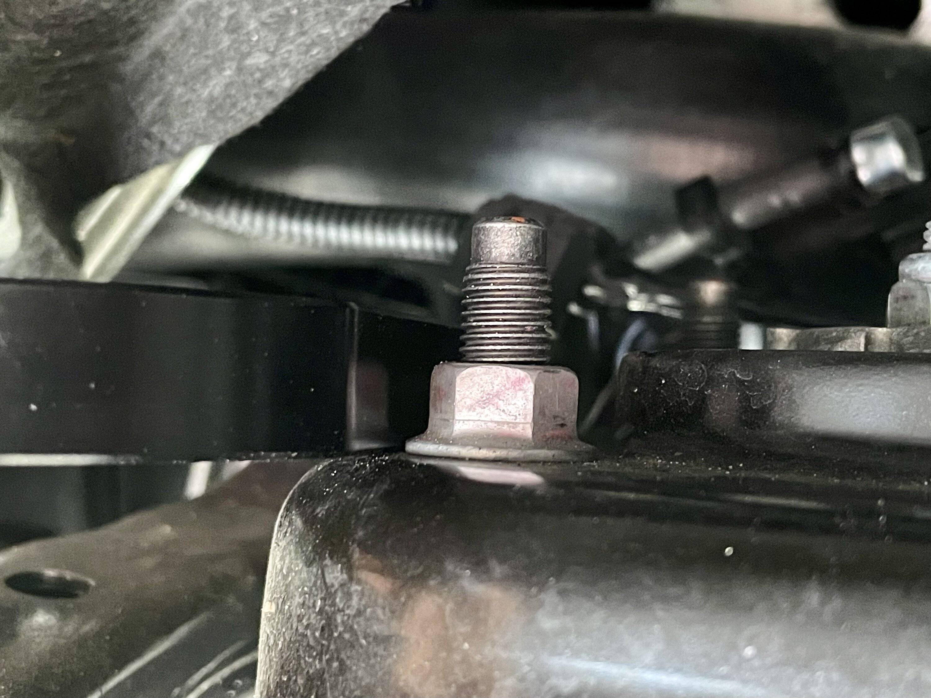

We
2024 Tacoma Spacer Kit on our new 4th gen TacomaTopNuts
have been getting a lot of emails from concerned citizens over the thread engagement, and we have more updates.
We decided that the factory nuts were still the best option because they are fully threaded. As you can see in the photo, the nuts are fully seated, fully threaded, torqued to spec and have minor stud intrusion still.
For some reason there's a belief that you have to have the stud sticking out past the nuts and that's simply not true.
