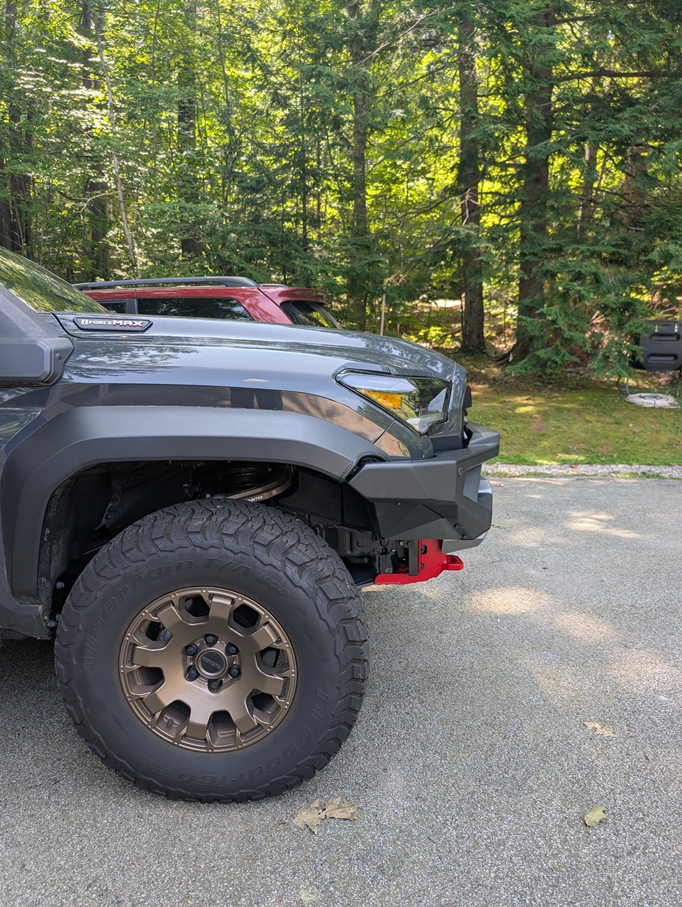

Bro can you post a side picture of the bumper? I can't tell how far it sticks out from the front. I just want to know how tight to the body the bumper is.

That looks so good. Thanks man. I’m getting this. Just gotta figure out some headlight hoops

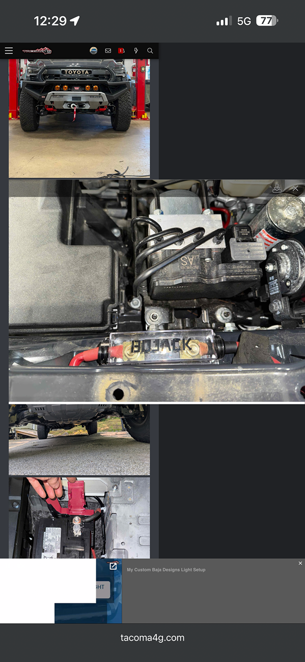

What is that bojack device?

In one of your photos, looks like in the engine bay, there’s a device that appears to say bojack

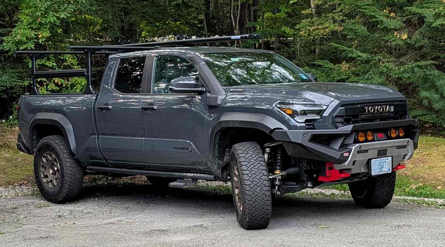

I just updated my original post with info on new front coils and needle bearing replacement, including new pics. Here it is after the break in period for the new front coils. See original post for details.

Have you noticed your turning radius has changed. Like bigger radius
