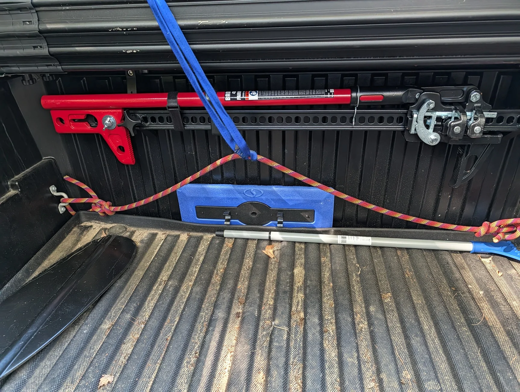

2. Jack mount in bed using OEM rail ($29.99 mounts from Amazon) Pic below.

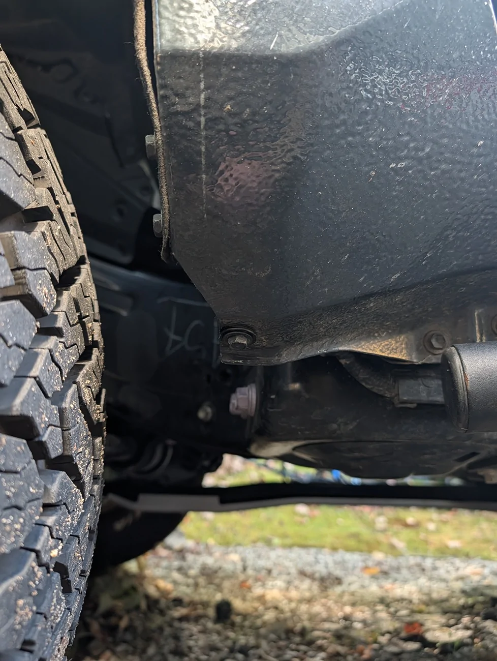

6. Addressed tire rubbing issues. See below for details and pics.
I had a lot of tire rubbing on a recent trip up to Maine where I aired down to drive part of the Golden Road on my way to fish the West Branch of the Penobscot. I got some help from Lewis Off Road again to figure out exactly where it was occurring and address it. Three changes: Removed rear mud flaps, re-routed wiring in driver side front wheel well over the frame and removed shield, and trimmed a small amount from the back side of the front wheel wells at about a 45 degree angle. No more rubbing, even when aired down to 20psi. (I had removed the front mud flaps and crush pads back when I first had the new tires put on - see original post above.)
Here's the jack mounted. Ignore the oar, snow scraper, rope and blue sling. :cool:

And finally, here is the minor trimming.

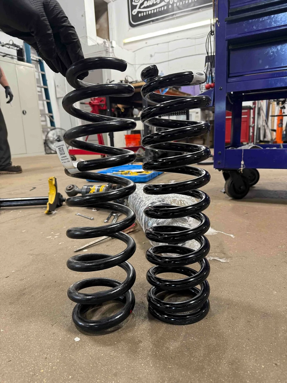

As of early August 2025, I'm currently looking into suspension changes because it just doesn't drive the same with that heavy bumper and winch I added last week. Just when I thought I just about finished! I've reached out to Dobinsons as well as my local 4x4 shop for advice.
Update 9/3/2025
I had the Dobinson 822 coils installed on the front on Aug 25. Also had the needle bearing replaced with an ECGS bearing since the front end was apart for the coil replacement (saved on labor costs). I had to keep my Westcott preload collar lift to end up approximately level (prior to the usual expected settling of about 0.25 - 0.5" in the first thousand miles or so). I've added a picture below of how it sat after installation. Also added a pic of the OEM and Dobinson coils side by side. The Dobinson 822 coil is about an inch shorter than the OEM. I do think my front end now sits a tiny bit lower than previously because I am now getting occasional rubbing that I didn't get with the OEM springs and Westcott collar. Not concerned at this time. I've hit that 1,000 mile mark with the new springs and will see how it goes. New pics are at the bottom. The new springs definitely solved the loss of stability issue I noticed after adding the bumper and winch.

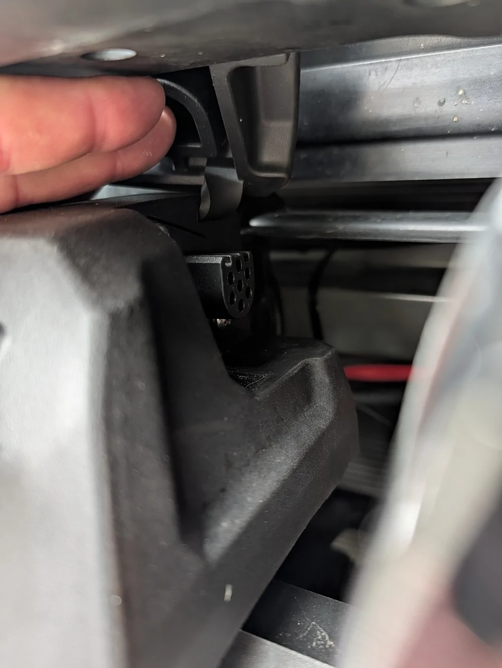

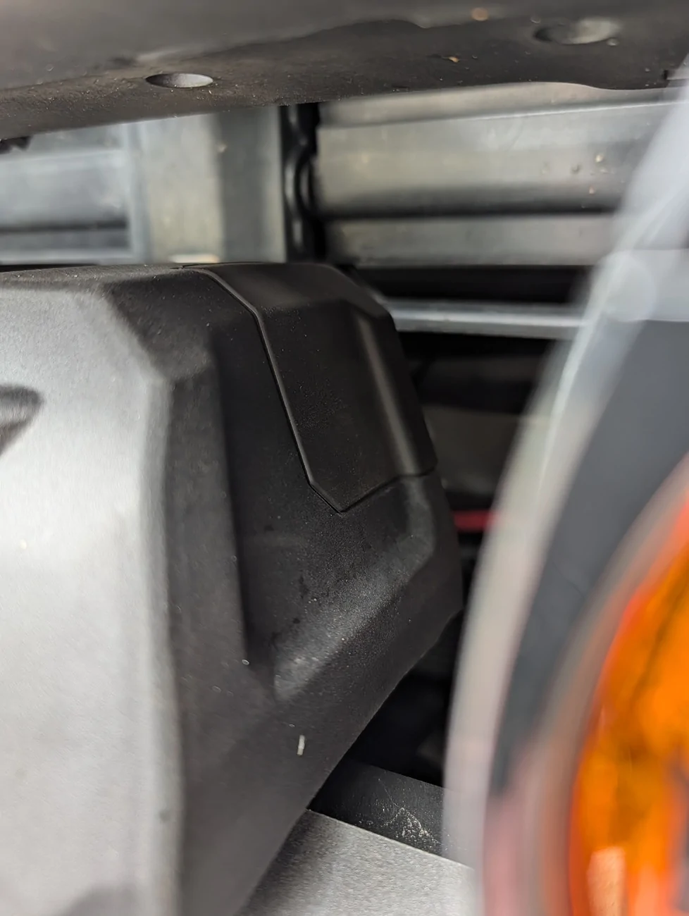

How hard is it the reach the clutch on your winch with this bumper? Or is it even accessible at all?
It is a little tight for my hands with the lights I have installed. But I can reach it.
In addition, I can fit my hand easily between the lights and (relocated) winch control. On this winch (Warn VR Evo 10-S), there is a rubber cover over the port for the wired remote. But I'll likely use the wireless since that is more convenient. Good to have wired as a back though.

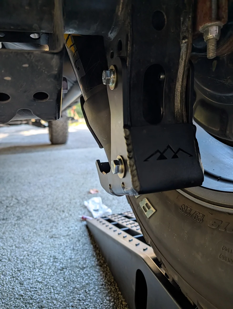

Updates: Completed installations for GMRS radio, ARB rear diff breather, and RCI rear shock mount skids.
Rear view:
Side view:

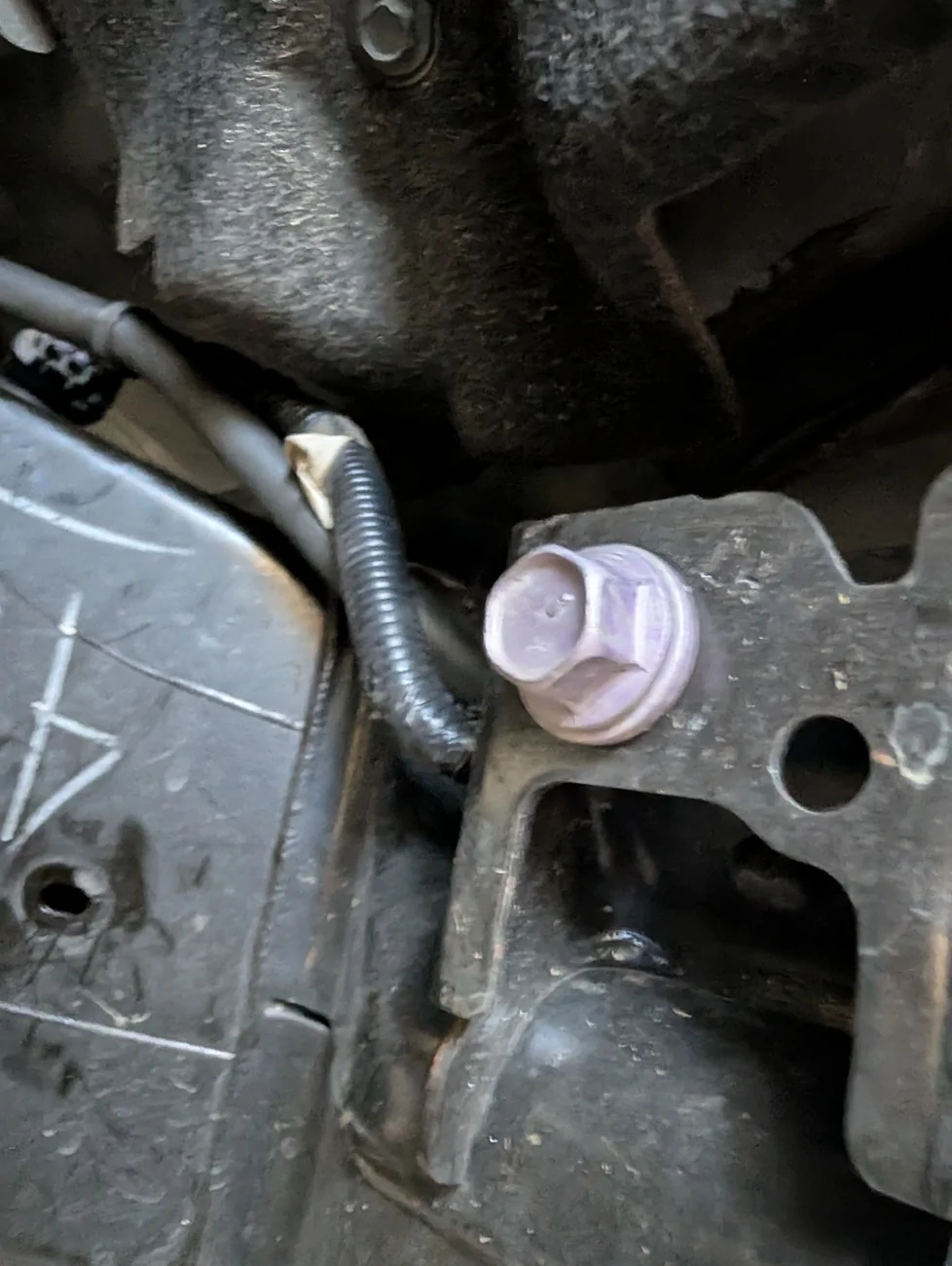

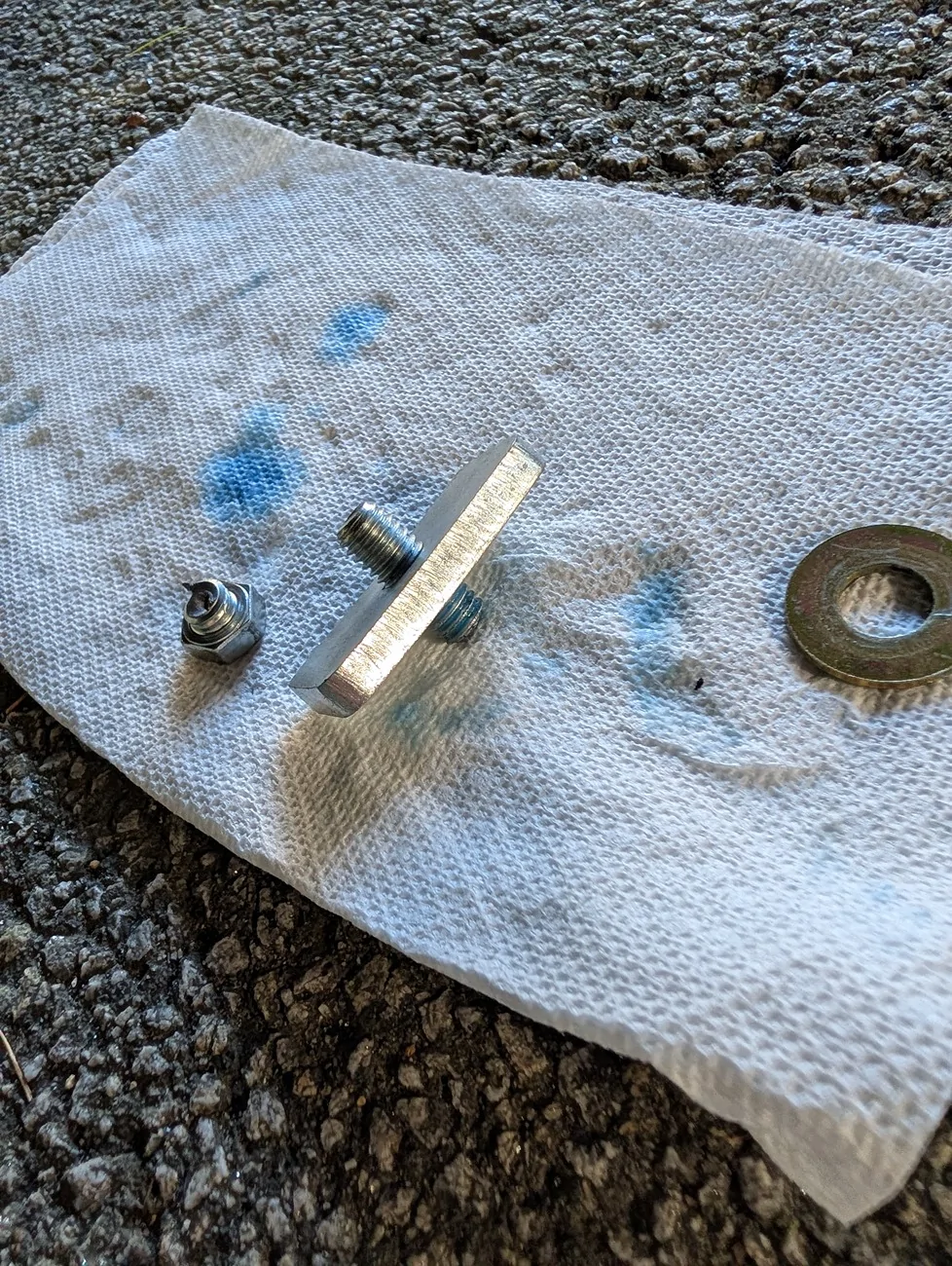

Don't torque those skid bolts to 74 lbs/ft (or maybe get an accurate torque wrench?):

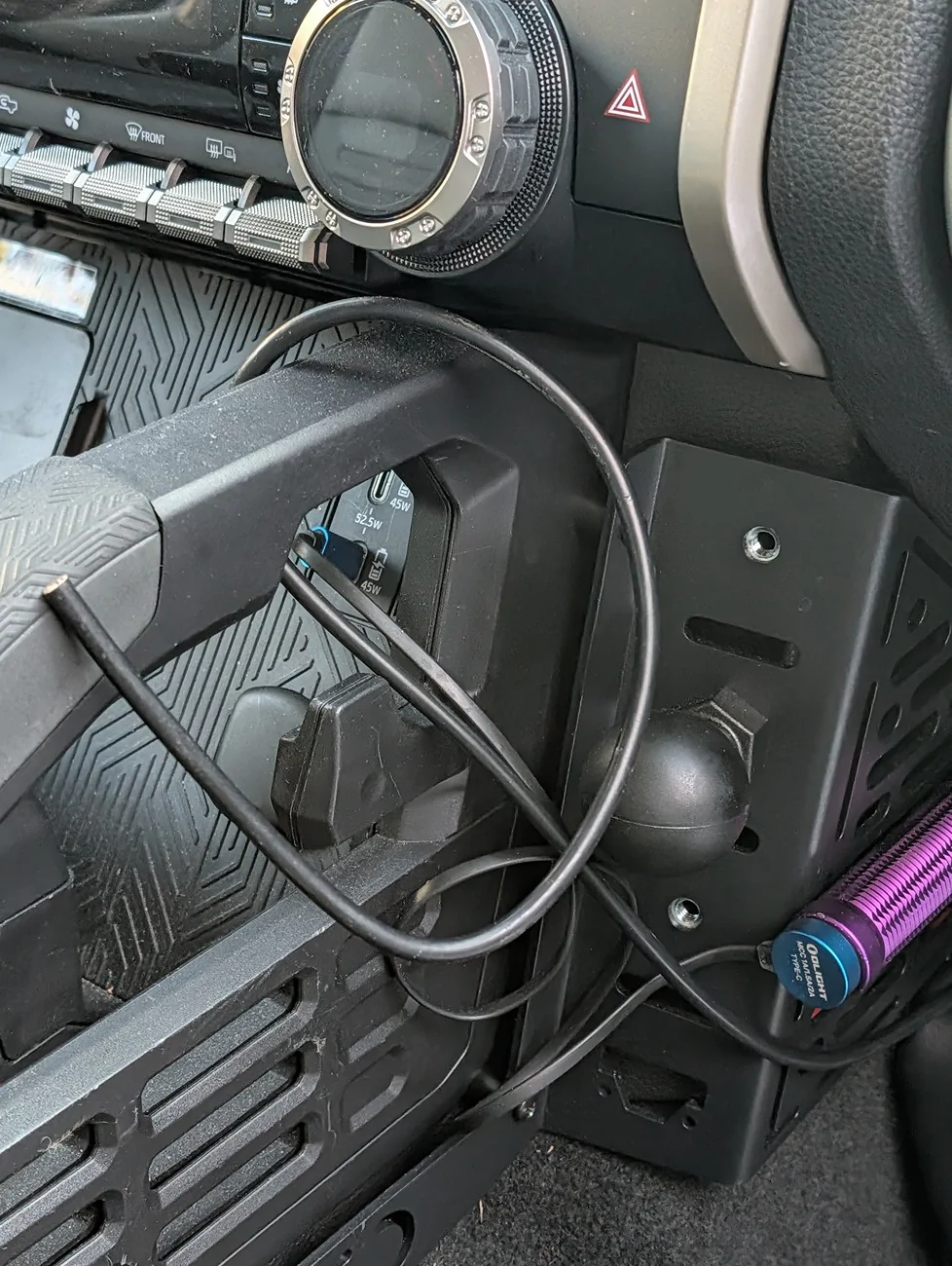

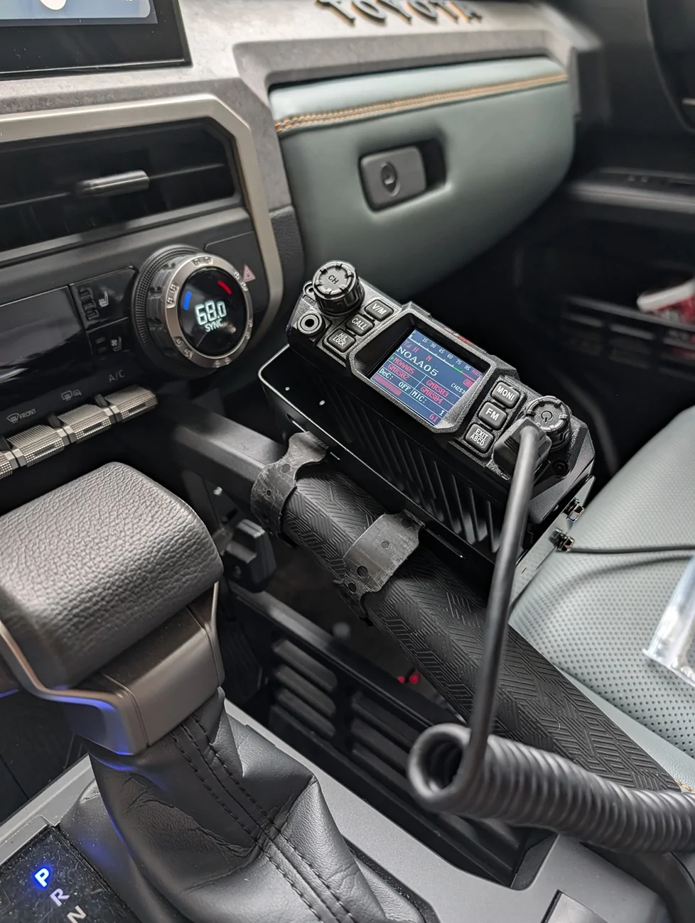

Temporary GMRS radio mount:

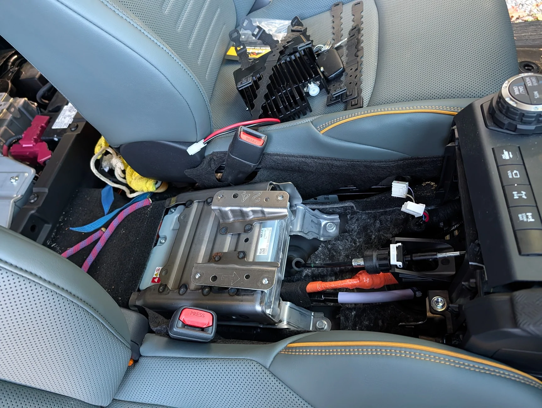

Center console removed to run power wires from battery under driver side rear seat:

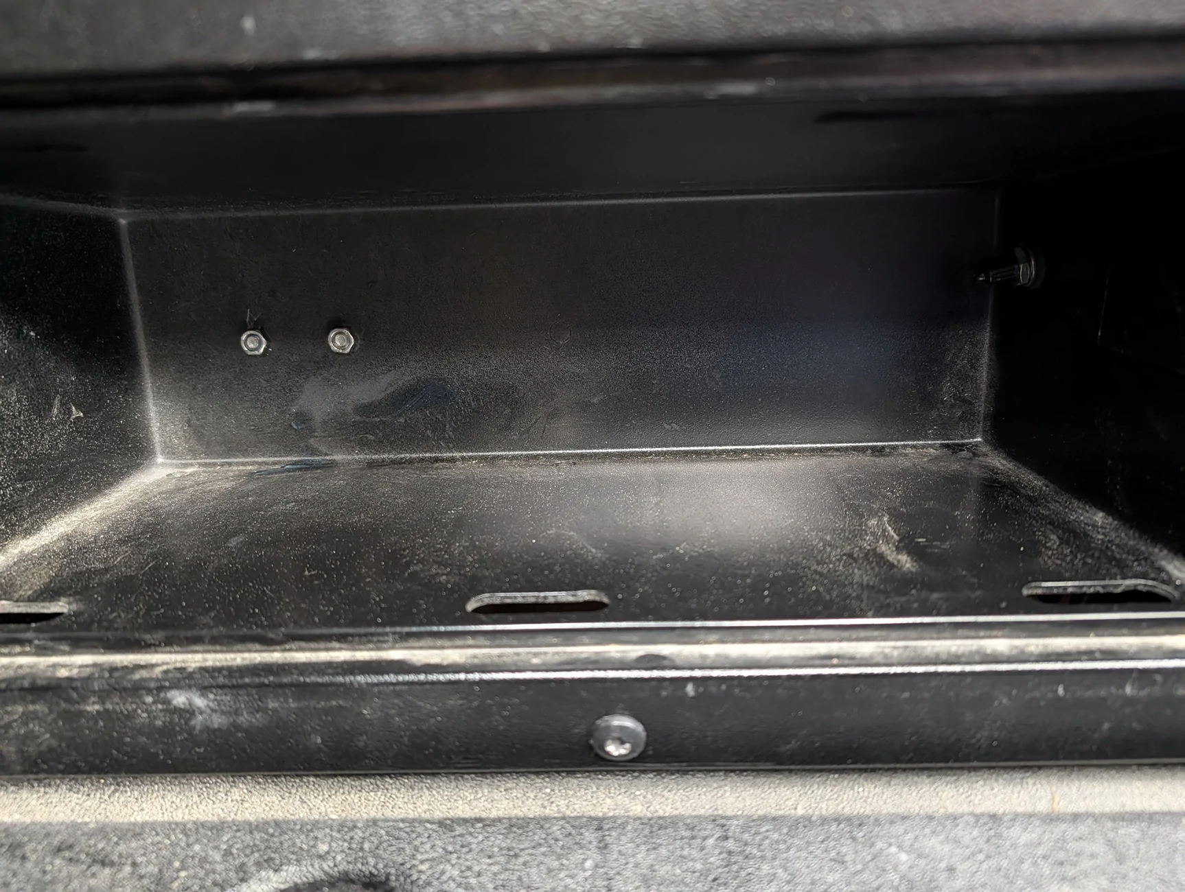

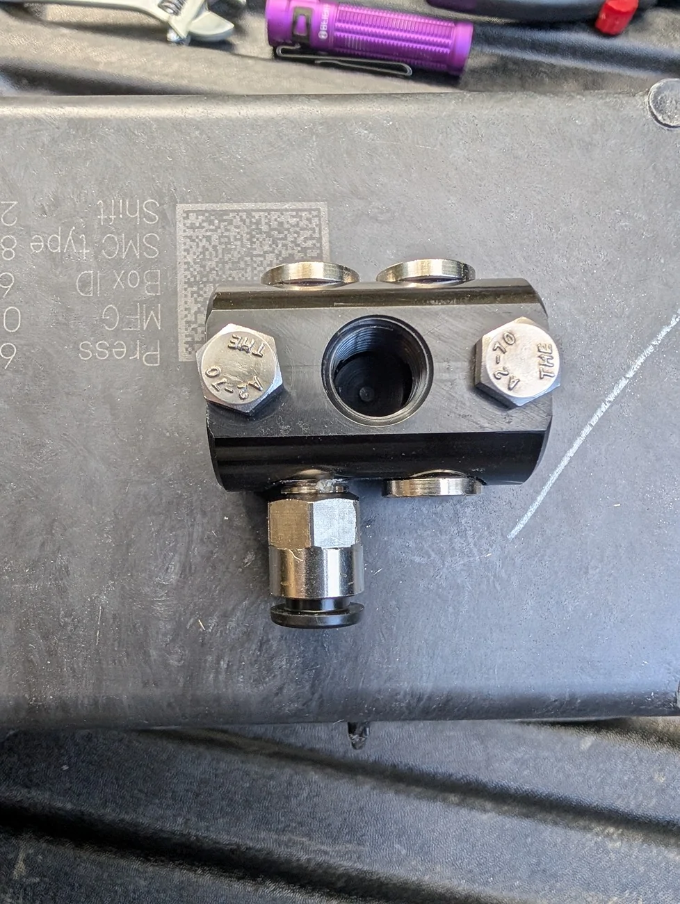

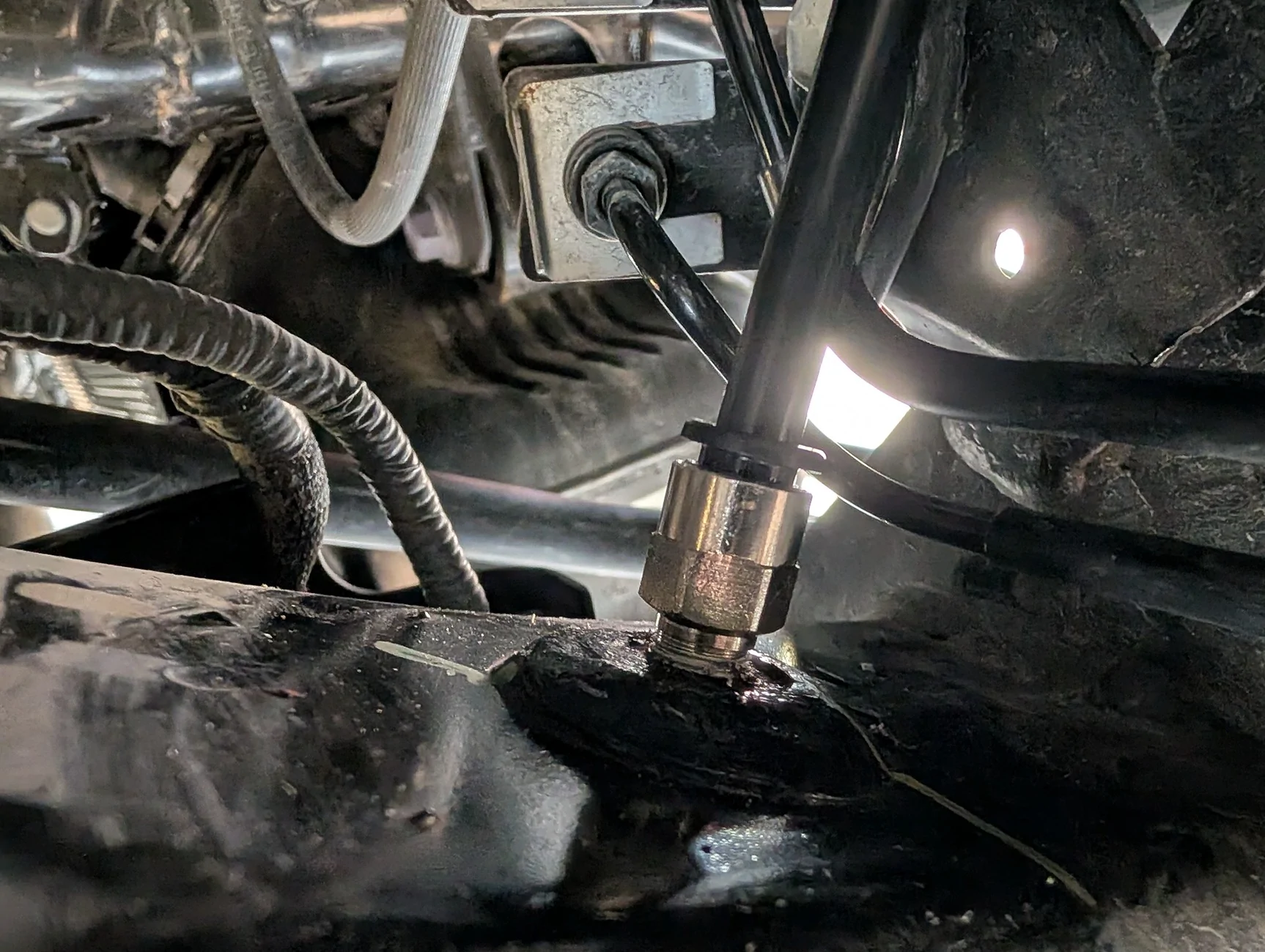

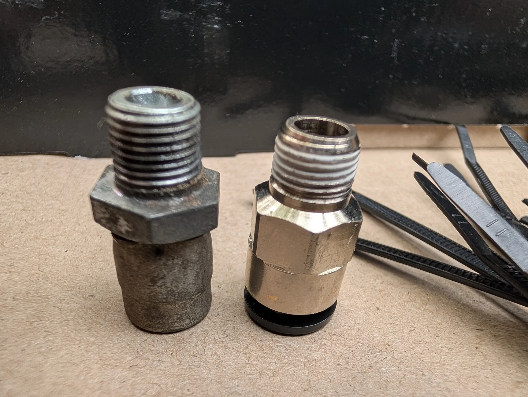

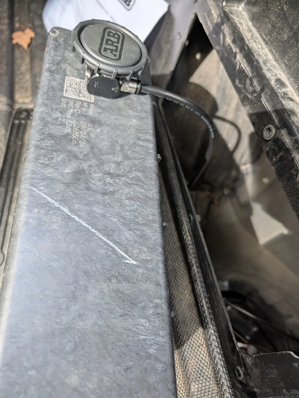

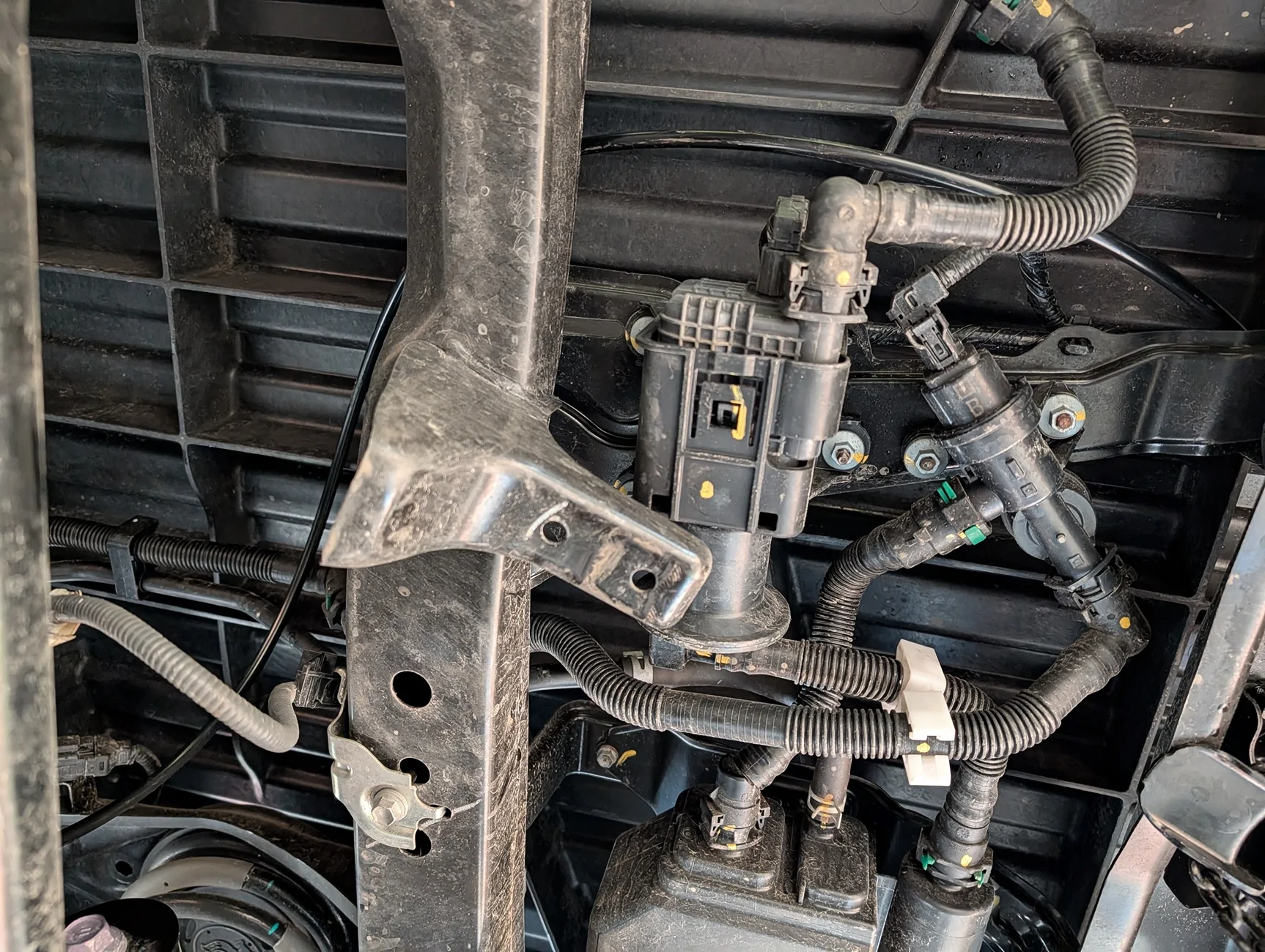

ARB Rear Diff Breather. Yes, I'm aware this was the expensive way to do it vs purchasing the components separately and not using ARB kit. :sunglasses:
I originally wanted to mount the valve in the left rear tail light, but there wasn't a good place for it from what I could tell. The right rear tail light didn't come off as easily and I didn't want to force it, so I ended up mounting it on the back side of the storage compartment on the right side of the bed. This puts it up high and keeps the space in the compartment for the compressor kit. I used some Blue 242 to make sure it stays put. The timing of this mod was perfect because I found myself in some deep puddles on my first trip with my local offroad club this past weekend.

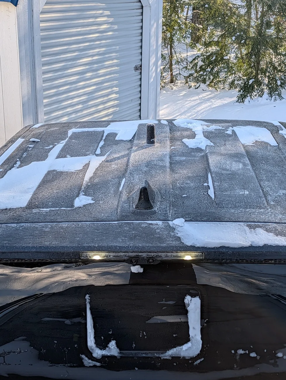

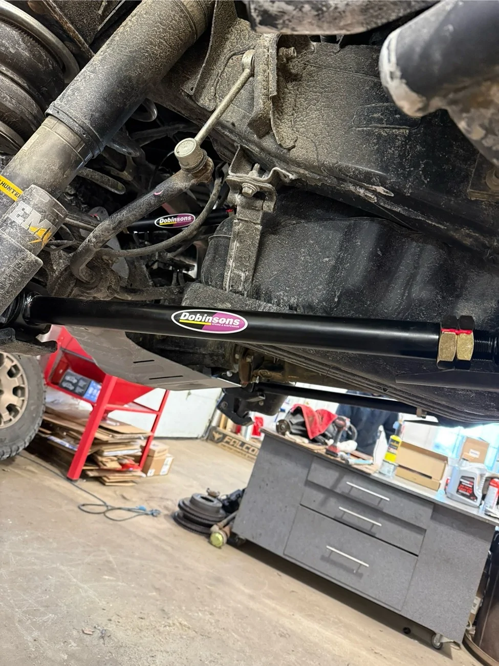

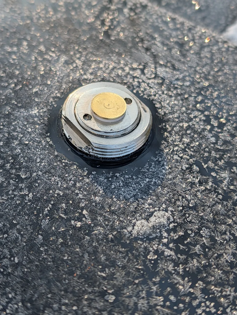

Jan 2026 Updates: NMO antenna mount, more skids, Dobinsons upper and lower trailing arms.
NMO antenna mount: Larsen Mobile Antenna Mounts NMOKHFUD
The labor for this was expensive because of the time needed to drop the headliner ($688 to run the wire and install the mount). I just wasn't brave enough to try it myself with all the tech in this truck. I bit the bullet and decided to have it done when the trailing arms were being installed. An NMO mount in the center of my roof (no rack) arguably gives me the best location for a ground plane antenna for my GMRS hard mount radio (BTECH GMRS-50V2). It also allows me to easily swap from a short stubby antenna that works great for group rides to a more powerful whip antenna for open areas and highways. No pic of this. Not really very exciting. 🤷‍♂️
Before the weather got too cold, I added A-Arm and Rear Lower Link skids from RCI. They were easy to bolt on. I plan to add upper link skids at some point too. And I'm considering replacing the stock plastic fuel tank skid with something better. Not sure about that one yet. I forgot to take pics of the additional skids, so I'll try to remember when the weather is better. It'll be a while!
I had the upper and lower rear trailing arms replaced with Dobinsons. This provides significantly more strength should these vulnerable components take a hit when crawling over rocks. Well, the lower arms anyway. The uppers probably wouldn't get hit. Pics below, if you can see through all the road salt!
This is probably a good point for me to reiterate why I'm doing some of this. I've started to do more exploring to fish in remote areas (mostly in ME) that are far from cell service and where roadside service isn't available. These improvements are all aimed at beefing up the truck to decrease the likelihood of something failing when far from help. I may not always be with another vehicle, though will always be with another person.
I'm considering getting a set of CV axles to carry, though I'll have to find someone who can teach me how to replace them if they fail. I bet someone in my off road club would be willing to help. I'm still thinking about this one. I wish I could just buy one, but my understanding is that these trucks use different parts for the right and left side now. I'm no mechanic, but comfortable around tools in general. Pretty sure I can learn how to do this.

OK, but I warned you. :)
I haven't had a chance to terminate the cable inside yet. Which means I also haven't tested this stubby antenna yet. And I don't have a longer whip yet. Once I have this setup finished and use it a bit, I'll be able to say more about the performance. Probably in the spring.
The ball mount you see in the cable pic is what I use to attach an arm that then attaches to another ball on the radio. It is a large-ish radio, so I only put it in when on a trip.

ooooo I like that. I am concerned about waterproofing but I've been looking to install a mount like that something that won't get in the way of a roof rack (or be obstructed by one). I was thinking of installing it in the spoiler. You keep doing the things to your truck that I plan to do to mine. Great minds.
StreeTaco
Sep 16, 2023
551
721
TN
2024 Tacoma TrailHunter
I installed an NMO on my spoiler.. added the largest sheet of metal I could fit under the plastic. Seems to work pretty good, got my SWR down after tuning the antenna a bit. Running a dual band radio and antenna, but tuned antenna for mostly GMRS use. Headliner was the worst part, but all went back together well.

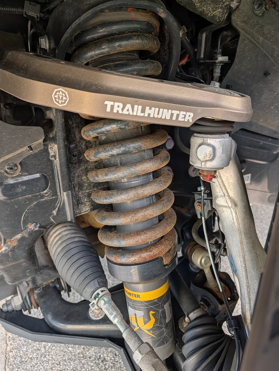

I bought my Trailhunter new in October 2024. In August 2025 I replaced the front coils with Dobinsons to accommodate the additional weight of a new bumper and winch. Three pics below show 1) original stock coil (left) compared with new Dobinsons coil (right) at time of installation in August 2025; 2) pic of Dobinsons coil today showing significant rust; 3) screenshot of Dobinsons site describing their powder coat as "extreme protection against the elements". Not thrilled. Haven't reached out to them yet. Sigh...

Update on rusty coils...
I reached out to Dobinsons and they were very responsive. They are shipping me a replacement set and contributing significantly to the labor cost. I'm happy with the way they responded. Now let's hope the new coils have a better finish on them!
As a related aside, my shop said an alignment should be done after replacing the coils. Dobinsons said it wasn't necessary since the coils were identical. The latter makes sense to me, but I'm no auto mech. Anyone with experience and training want to weigh in? Thanks in advance!

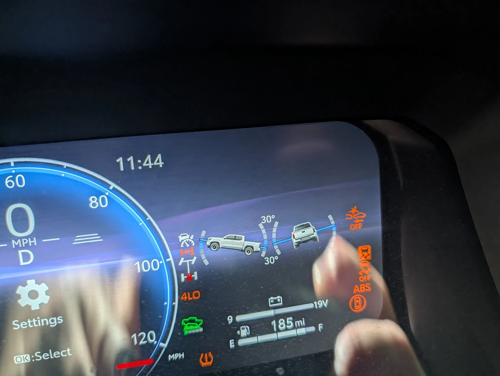

A quick update. I'll add pics of the mods down the road. Some other pics just for fun are below.

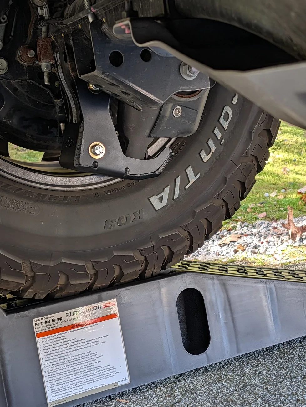

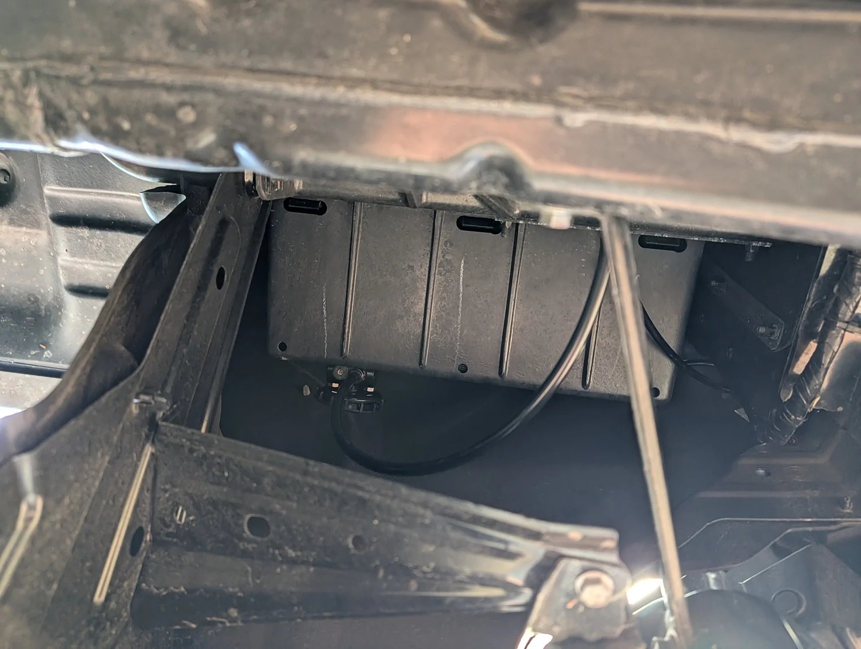

I added the front lower arm skids so both ends of those new Dobinson trailing arms are protected now. I purchased a steel gas tank skid from Cali Raised, but it came in a day late and I didn't have it on for my trail ride recently. I'll get that on next. Two person job.
Fortunately, no damage from the recent ride despite some super rocky trails. The Trailhunter did well again! Made it without needing to pull rope (which is more than I can say for one jeep and an H2). :) Great group ride and I'm learning a ton. So far, I've completed a day long 4WD 101 course, a day long winching course, and I am scheduled for the day long 4WD 102 course in July. My goal is to just be able to gain some skills and not make dangerous/bad decisions when out on the trails. These 3 classes give me a nice jump start. Just need to continue gaining real life experience on the trails now! That's the fun part for sure.
For anyone counting, I've now added a total of 9 skids beyond the stock skids. The only replacement skid among these is the gas tank. That plastic skid doesn't give me much peace of mind!
Here's the breakdown:
Trailing arms (4)
Gas tank (1)
Rear shock mounts (2)
Front A-Arms (2)
