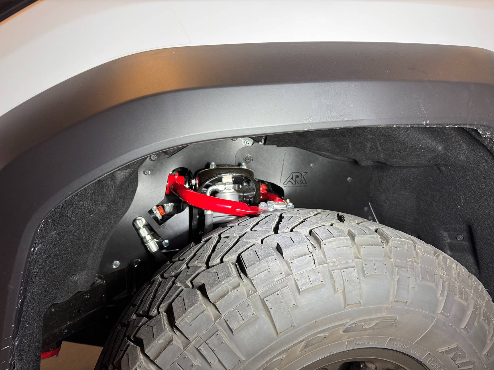

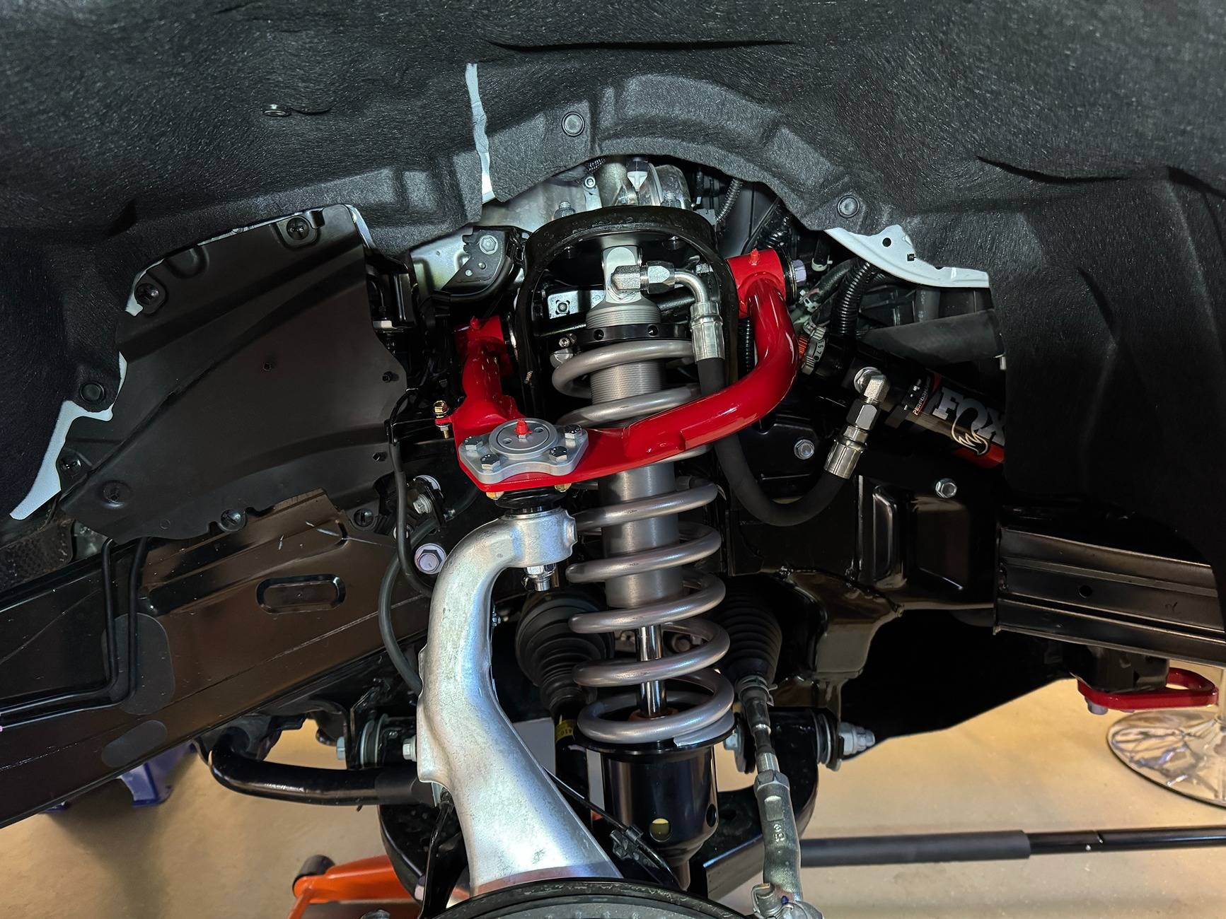

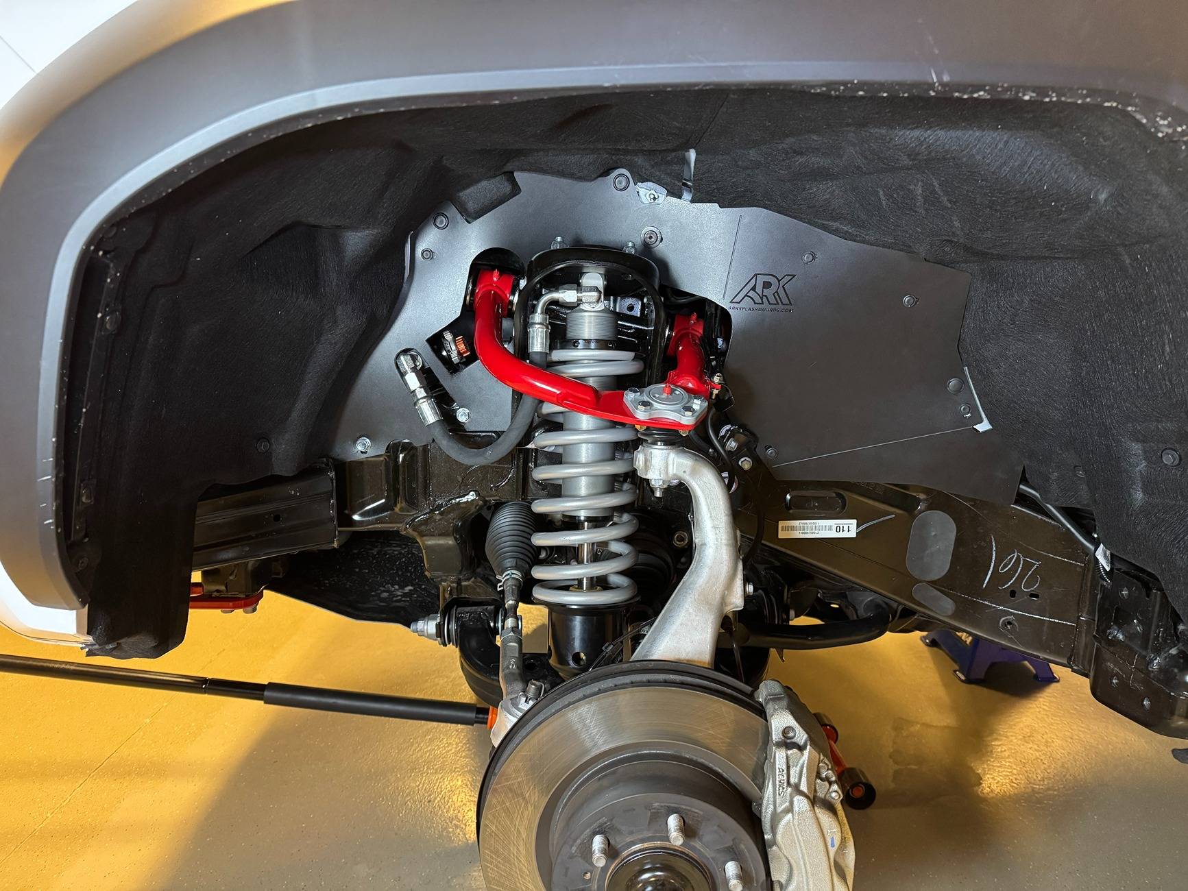

Anyone, who has installed Fox 2.5 coil overs w reservoirs might be happy to know the Ark Splash guards will work with them. They will just need a little modification. I first placed the splash guards in place as best I could. I then marked it with a sharpie in the areas that needed trimming. I then took my time and used a narrow diameter Dremel bit to do my rough cutting. I fit and cut several times until I achieved clearance as needed. I then cleaned up the cuts using a fine cut carbide Dremel bit on slow speed. Finally, I used a heat gun to make it look as clean as possible. Im sure the Ark Splash guards will work with the King 2.5's as well. This mod will help protect the remote reservoirs while still allowing access to adjust your DSC adjustors.
2024 Tacoma Fox 2.5 Performance Elite Coil Overs with Ark Splash Guards installed IMG_1848.JPG
2024 Tacoma Fox 2.5 Performance Elite Coil Overs with Ark Splash Guards installed IMG_1850.JPG
2024 Tacoma Fox 2.5 Performance Elite Coil Overs with Ark Splash Guards installed IMG_1761.JPG

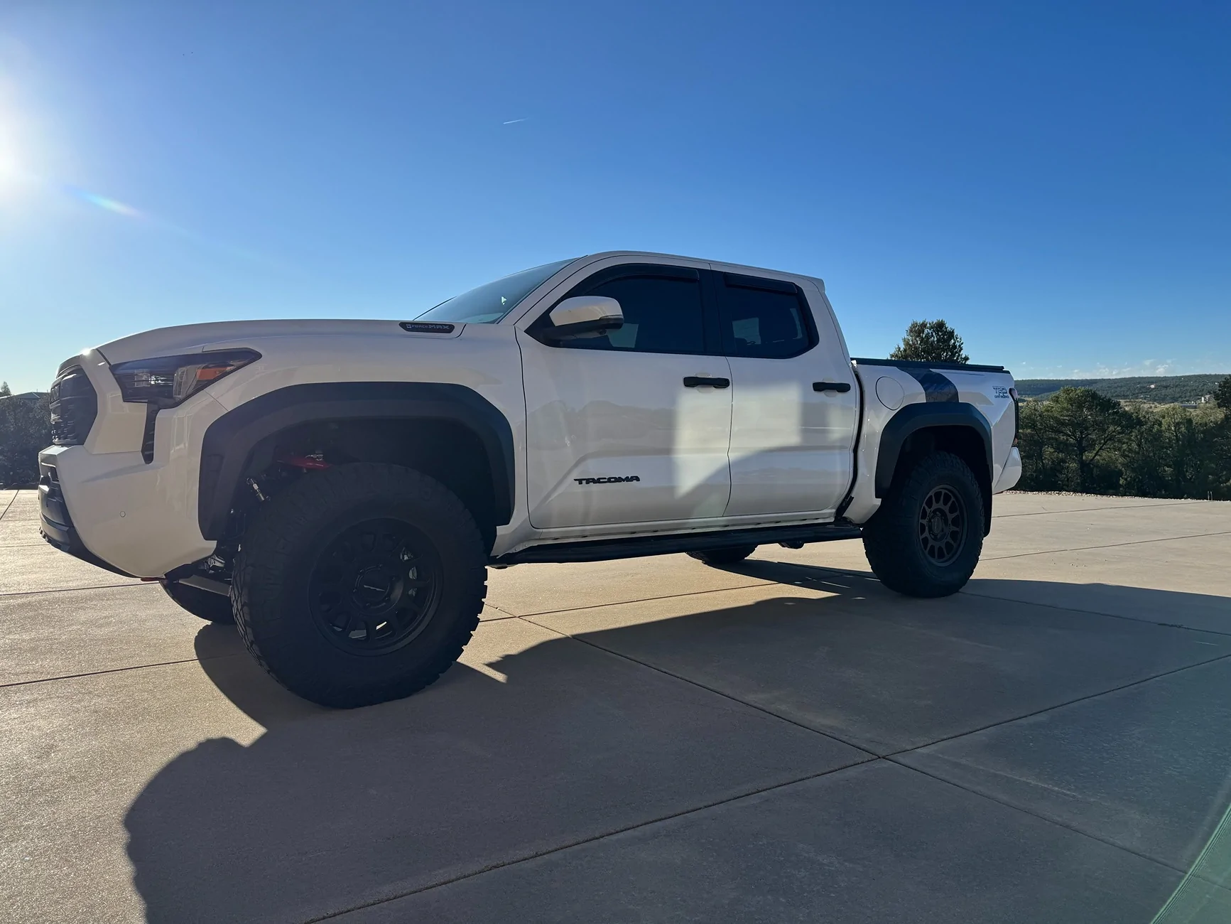

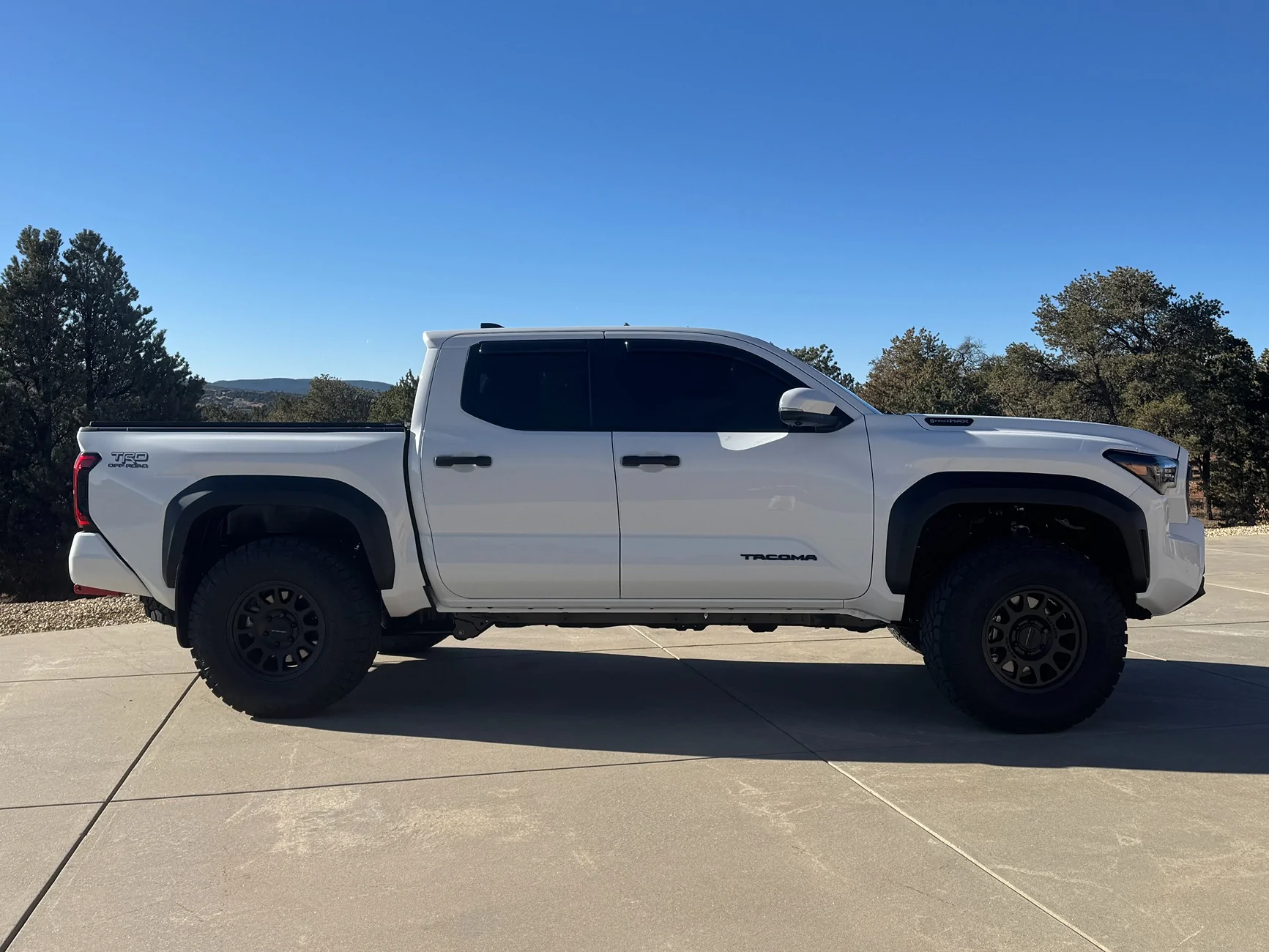

I ended up using the factory specs of 2.25'' of lift in the front and I did not add any springs in the rear. I have about .25'' of rake as it sits now. Unfortunately, I no longer have the measurements of before the coil overs to give you a comparison. Here are a couple of phots though.
2024 Tacoma Fox 2.5 Performance Elite Coil Overs with Ark Splash Guards installed IMG_1834
2024 Tacoma Fox 2.5 Performance Elite Coil Overs with Ark Splash Guards installed IMG_1495
2024 Tacoma Fox 2.5 Performance Elite Coil Overs with Ark Splash Guards installed IMG_2342
2024 Tacoma Fox 2.5 Performance Elite Coil Overs with Ark Splash Guards installed IMG_2343
