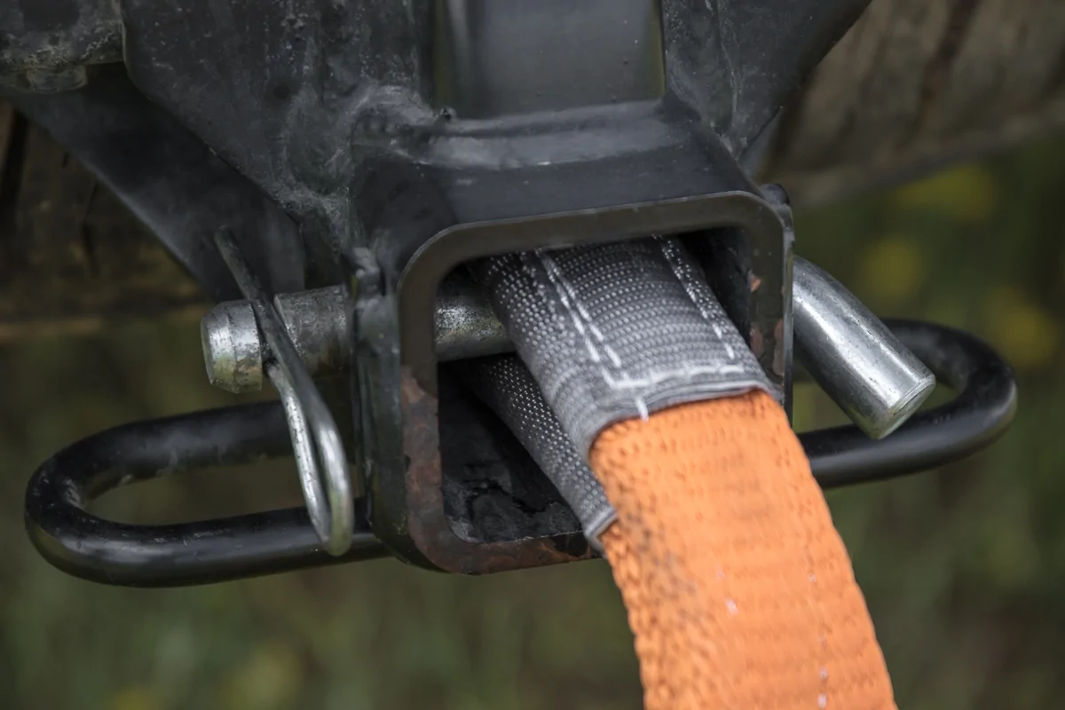

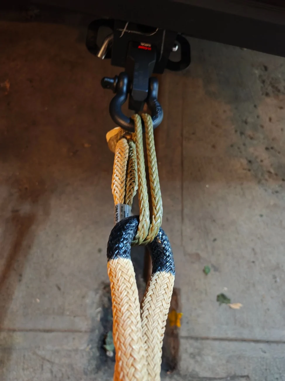

Or just put a soft shackle through the hitch pin in the receiver and skip the D ring shackle hitch entirely.

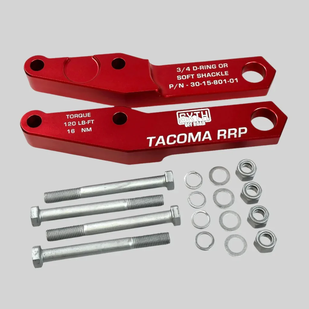

Either way this is way more sturdy than the bolt on stuff... not red though, so not as COOL
The hitch pin is more than strong enough for recovery to be honest. Just use the one that came with the truck.
Considerably stronger than garbage like this:

https://trail4runner.com/2018/04/26/hitch-pin-recovery-point/

But if you use this method an offroad shop can't sell you a drop shipped recovery point for $250 :sadface:
