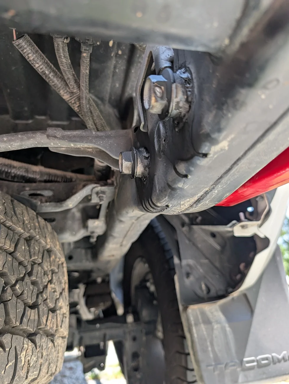

I'm not a welder, so I don't want to hear anything about it. The collars are basic, but get the job done. Highly recommended for the price.
My grandmother used to weld exactly like this. We had to take her welder away and put her in a home.

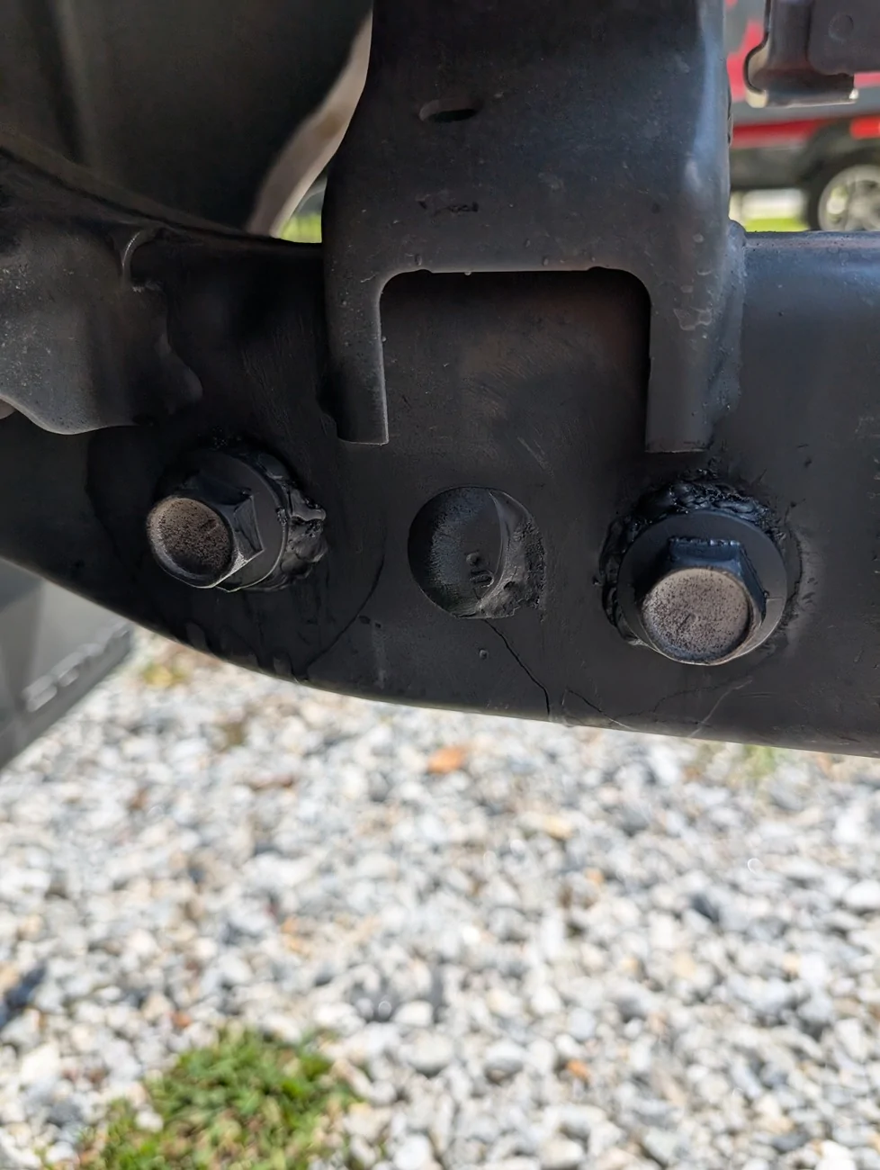

I bought the SXTH Element rear tow hooks and they use two bolts that attach to the Farm Jack access points and the two outer walls are already reinforced.
2024 Tacoma Rear recovery hooks and frame reinforcement IMG_6344
2024 Tacoma Rear recovery hooks and frame reinforcement IMG_6343

Please see my previous post where I informed the thread that I bought a full set of these sleeves from Cornfed for $38 shipped. But, it's your money, do what you want with it.
Daneger
Dane
Sep 16, 2024
Muskegon, MI
2024 Tacoma SR5
thank you for your reply. I did check those out, however, the holes on the frame are two different sizes. Can you please explain how you managed to fill the empty space? Thank you
The holes you bolt through are the same size the larger hold between them isn't used (also shown in the pictures I provided previously)
Did you have to shave down the inside of the Cornfed collars? The ARB bolts don’t fit.
