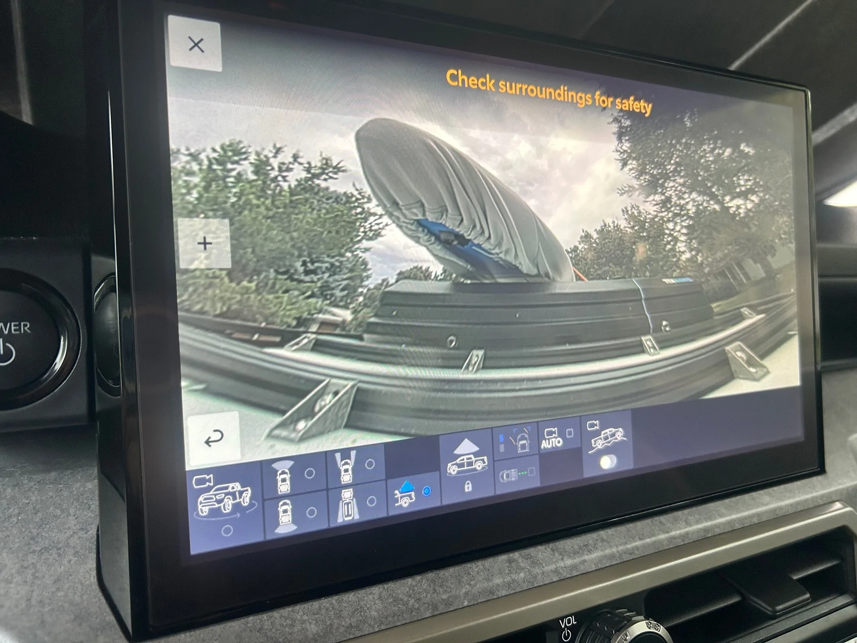

I have the GG off-road kit from back in Oct ‘24, works great and went creative with my cargo cam - routes that to the roof behind my roof rack spoiler…the only complaint is the in-&-out glitching on the rear view mirror display route: cuts out frequently- not sure if that’s from summer heat or what. It’s distracting and royally sucks ass and I don’t use it that much when I otherwise should be
Yeah, that's annoying and you shouldn't have to live with it. Good news is it's usually fixable.
Heat is very likely the culprit. The cable itself is rated well past anything you'd see, but sometimes heat affects the connectors. It can help to unplug and reseat the connectors.
Second thing to check is the routing for tight bends. Anything tighter than a 3-4 inch radius can go marginal in heat even if it's fine in cooler weather.
Third, anything aftermarket wired near the mirror? Dash cam, inverter, hardwire kit. That stuff can inject noise that looks exactly like a heat problem.
Also worth ruling out the mirror itself. Next time it cuts out, aim the AC at the mirror for a couple minutes. If the picture comes back before the cab has really cooled off, the mirror is running hot on its own and the cable is secondary.
Your cargo cam routing up behind the roof rack spoiler is a solid setup, by the way. Curious how the view turned out.
We can always send a new cable under warranty if needed. Let us know!

I appreciate that and yea I think* its a summer time thing in Colorado / winter it runs fine from what I can tell, case in point the roof cam feed is stable no issues. Will journal on performance as we enter cooler temps this fall…
there is a Toyota dash cam next to the mirror hardware, and it works fine under thermal extremes from what I can tell…I know that if I go to Toyota and claim their mirror apparatus is bunk when exposed to the full sun & a windshield shade deflector they’re gonna deny any claim because of the re-route
One thing worth poking at. You said the Toyota dash cam next to the mirror handles heat fine, and I believe you, but a dash cam can work perfectly while still throwing electrical noise onto a nearby circuit. Different failure modes. You could unplug it on a hot day and see if anything changes. However, I agree it is not super likely. Reach out anytime you want to investigate further. Let us know how the fall logs go.
