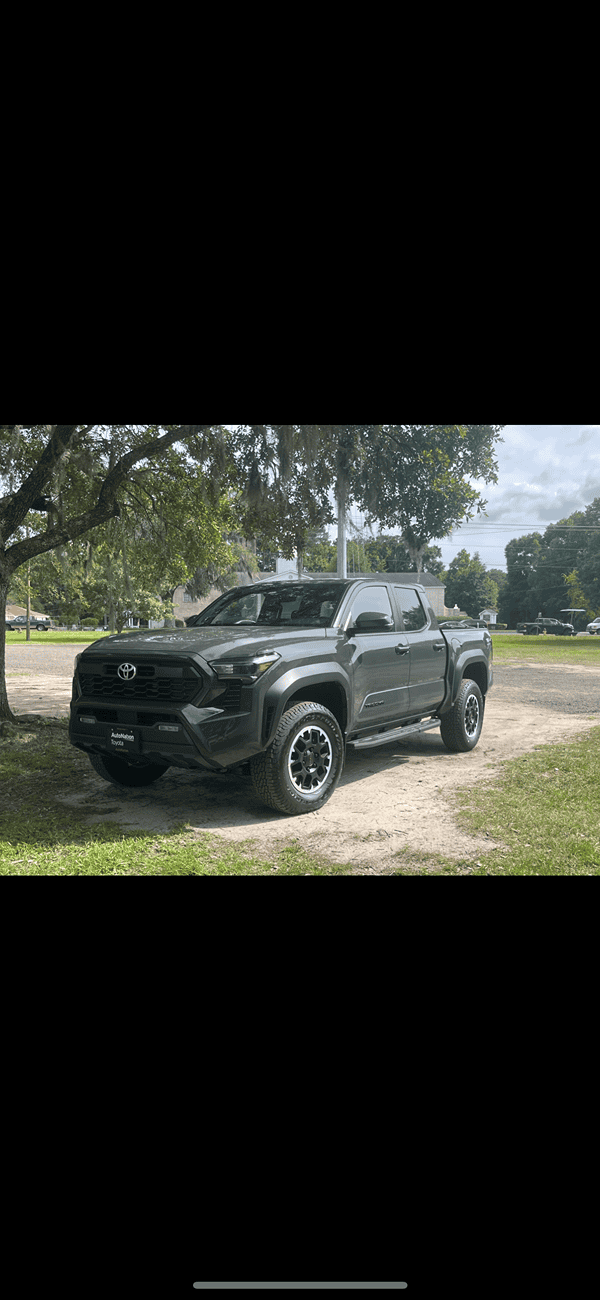

Well brothas, just picked up my 2024 trd off road auto (trd upgrade pack. Moonroof etc.) from dealer today. I brought the truck in with transmission issues about 6 weeks ago give or take. They decided truck did indeed new transmission. They put me up in a rav4 till truck got completed. It was a hassle to initially get the rental which took about 10 days to get into. But just picked up the truck today and it feels good. I’m going to take it easy for a couple weeks for I am def afraid. I forgot how nice these trucks are. It destroys the 2024 rav4 xlt I was in on every level. Trucks amazing I missed her. I’ll keep yall posted on how she does. Feels good to be back
