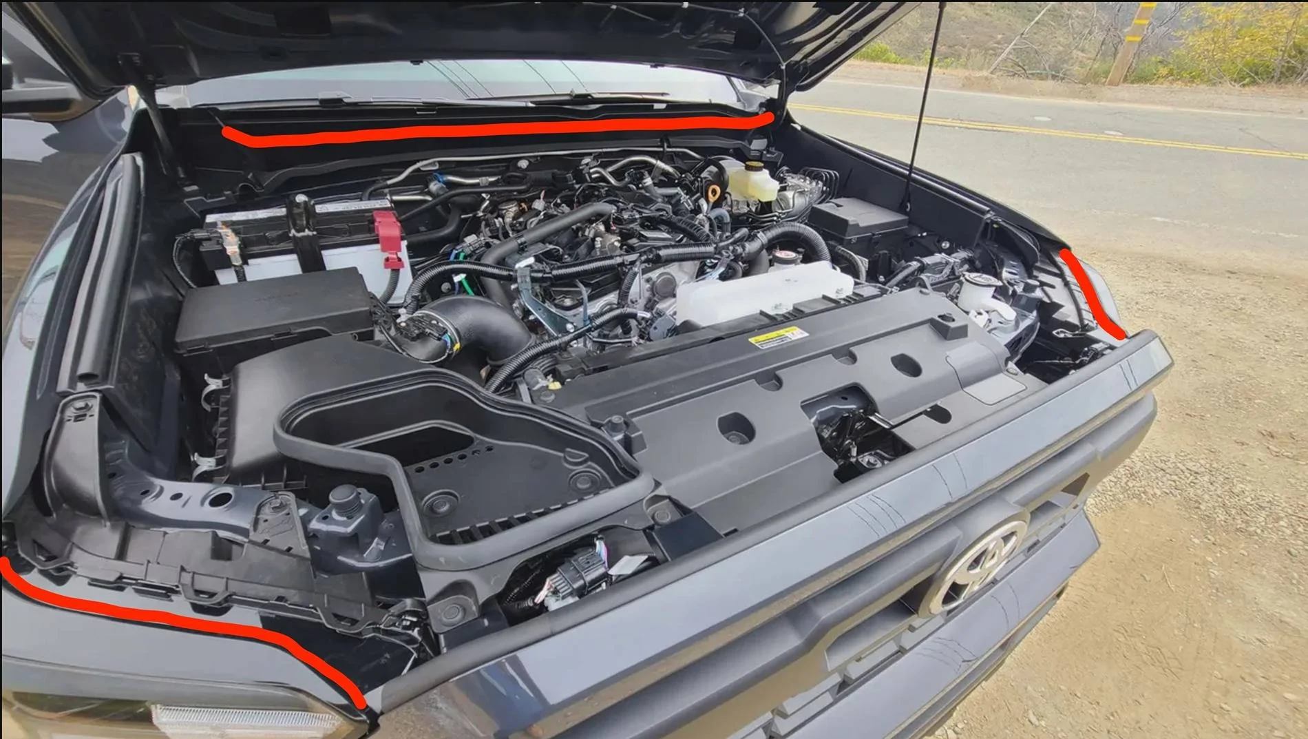

I'm looking to add a bit of weather strip on top of the headlights and along the back of the engine bay between the hood and the "trough" looking plastic. My thoughts are to potentially reduce the amount of dust that collects on the engine before it gets out of hand and maybe reduce the hood flex that everyone seems to be having at higher speeds. Gone are the days of just hosing down an engine at the car wash with all of the electronics on top. My only concern would be potentially overheating components by reducing ambient airflow, therefore allowing higher temps, around a turbo engine. I'm just looking for some thoughts, opinions, or experiences some of you might have on the subject. Pic attached illustrates the areas I'm talking about. (stock photo) TIA

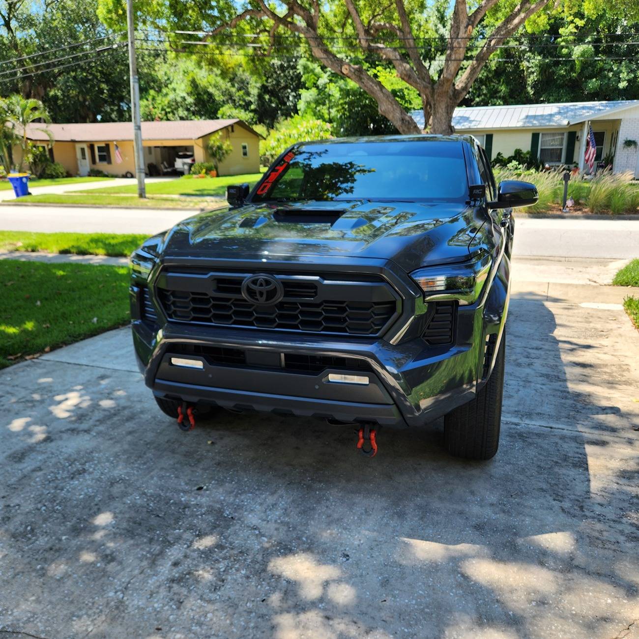

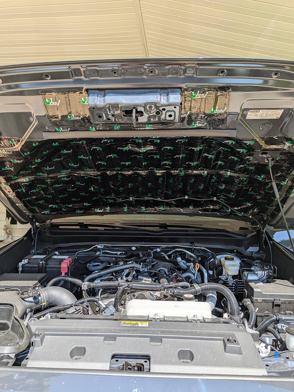

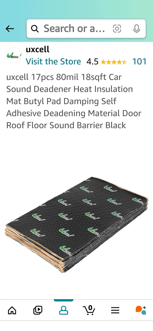

I had the hood tremors at high speed on my 24 TRD Sport 4x4. I went low tech and used some of the black pipe insulation. Cut it up and squished it into the space between the hood sheet metal and the underside piece of sheet metal (through the cut outs of the underside piece). My truck did not have the insulation blanket piece (figured out only Premium models have it). So after squishing the insulation in there to deaden any vibration, I used butylene adhesive sound/heat insulation sheets (Amazon like $35.00) and rolled them into the underside of the hood. I covered all of the holes and brougt it out to where the factory mat normally would be.
TOTALLY stopped all vibration in the hoods sheet metal, reduced some engine noise and (per my Toyota/Lexus specialist) negated any damage that the engine heat might cause, long term to the hood's paint. The hood is significantly heavier now but again only positive results! FYI, I live in Florida and the sheets are as stuck as they were went I put them on a couple months ago.

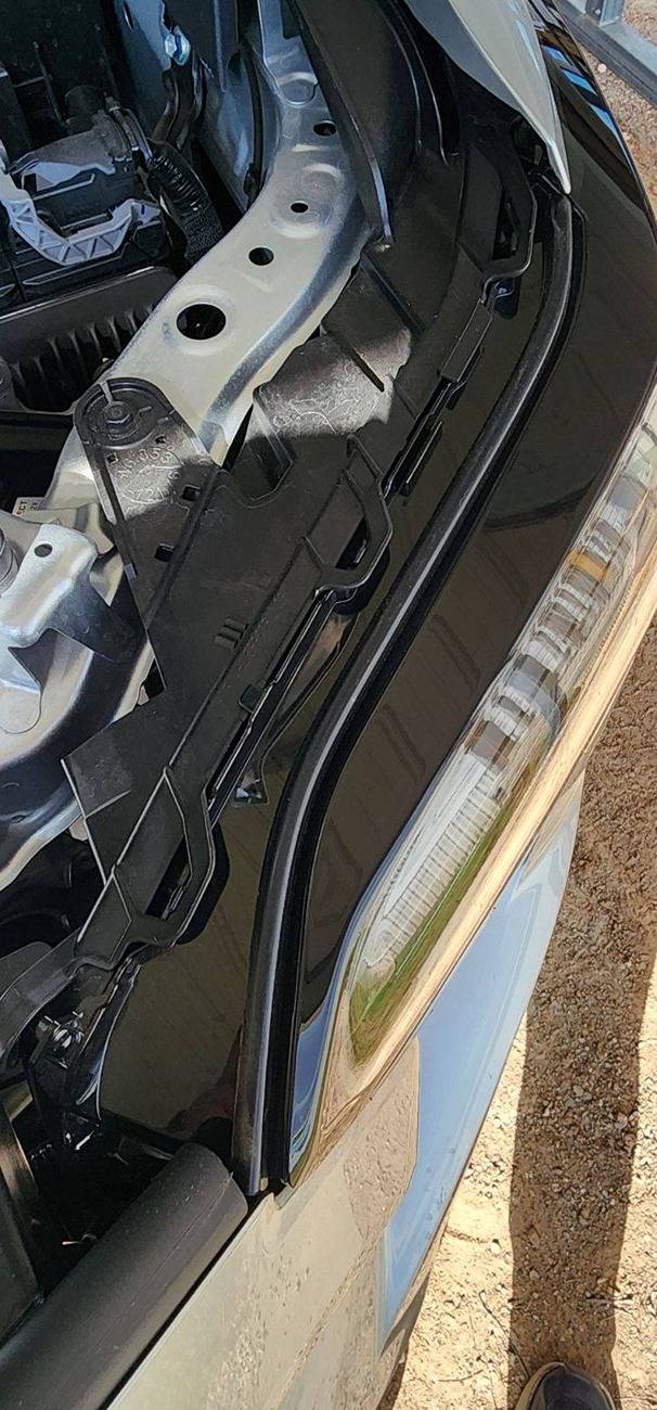

Back on topic. Trying to put weather stripping along the back didn't work out at all. It looks like the plastic there is already against the hood and when I put an extra layer in, it just pushed it out. It is pretty pliable already. I did also put some on top of the headlights more to finish filling the gaps than anything. I think it looks pretty good so I'll leave that. @TacoJay, I'm digging the idea of some kind of support between the skin and the brace of the hood. I may try your pipe insulation idea and stuff some in there since mine does have the factory insulation and it'll never be seen. Good talk, guys!
