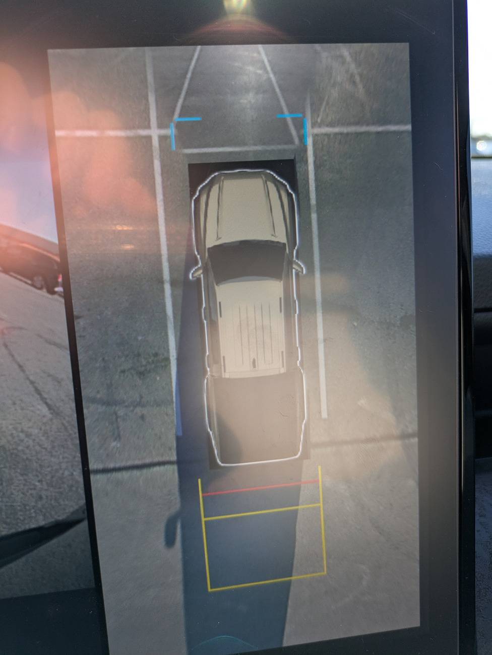

I adjusted my front camera via the on board diagnostic service menu. I adjusted it +165 while parked in a place where there were lines and it all lined up. Although for some reason the view adjustment button is now greyed out and I can’t access it anymore.

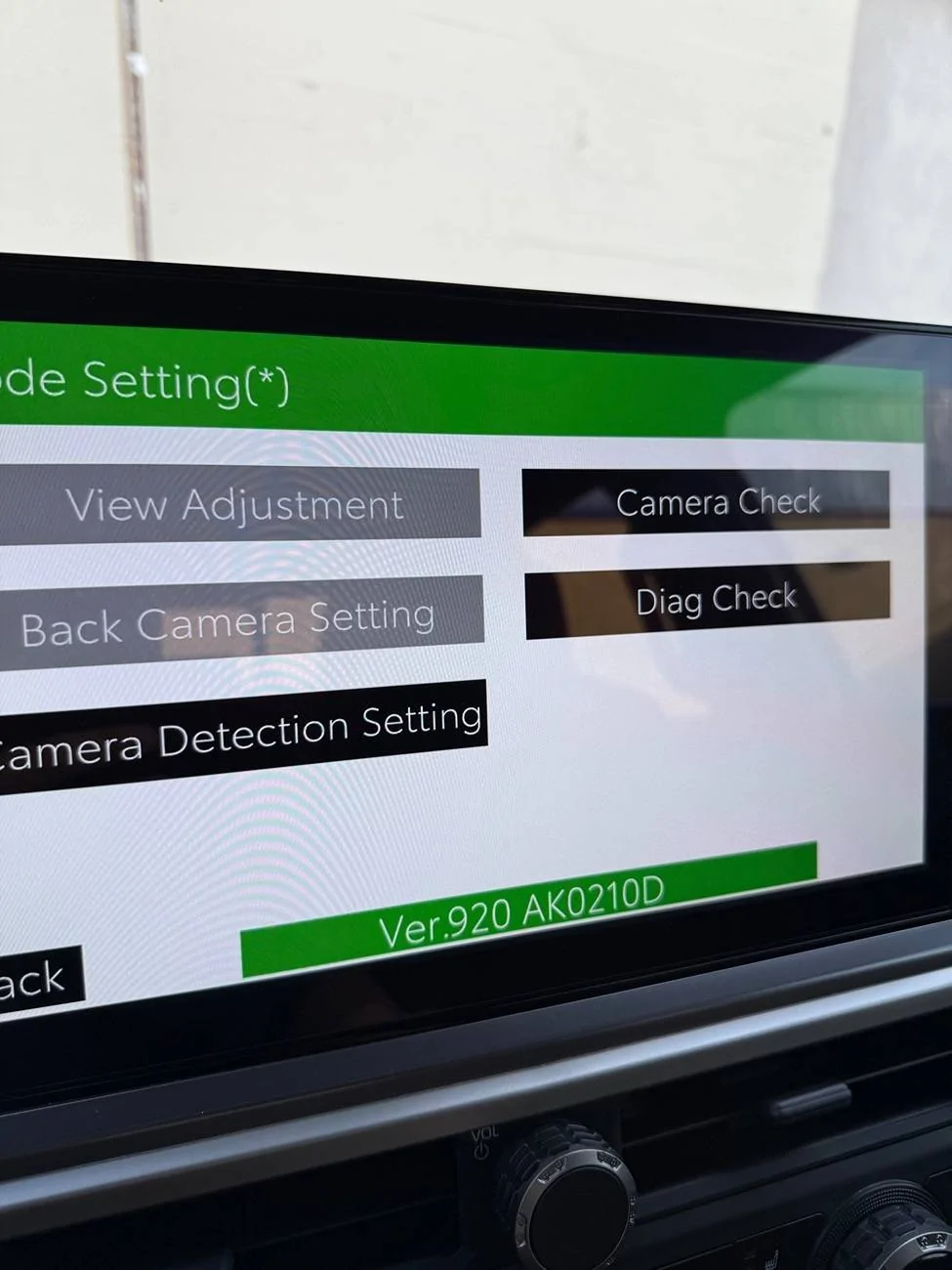

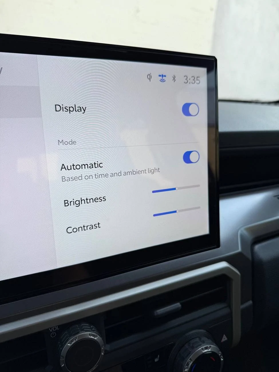

Key on engine off - turn audio off - turn display off - swipe right 5 times swipe left 5 times.
Function check - Canera settings - View adjustment.
Make sure to park where there are plenty of straight lines in front and around your car for alignment purposes. Do the adjustment in one shot or don’t save.
Mine is greyed out because I already made an adjustment. So do it in one time.

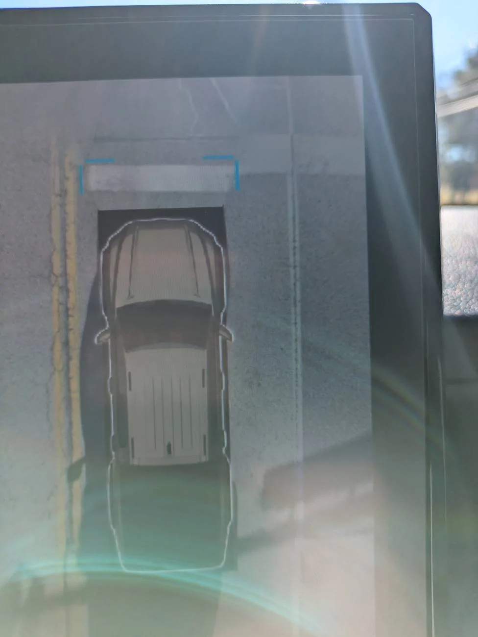

Sounds like I might need to access this adjustment menu to fix my front camera line up. Shows "short" since doing the change with Rave bracket.

The angle is different so you need to adjust it plus (or minus) by quite a bit. That will bring it back in correct alignment.

+165 and it aligned in my case. Only save it if you’ve gotten it aligned. You get one save.
