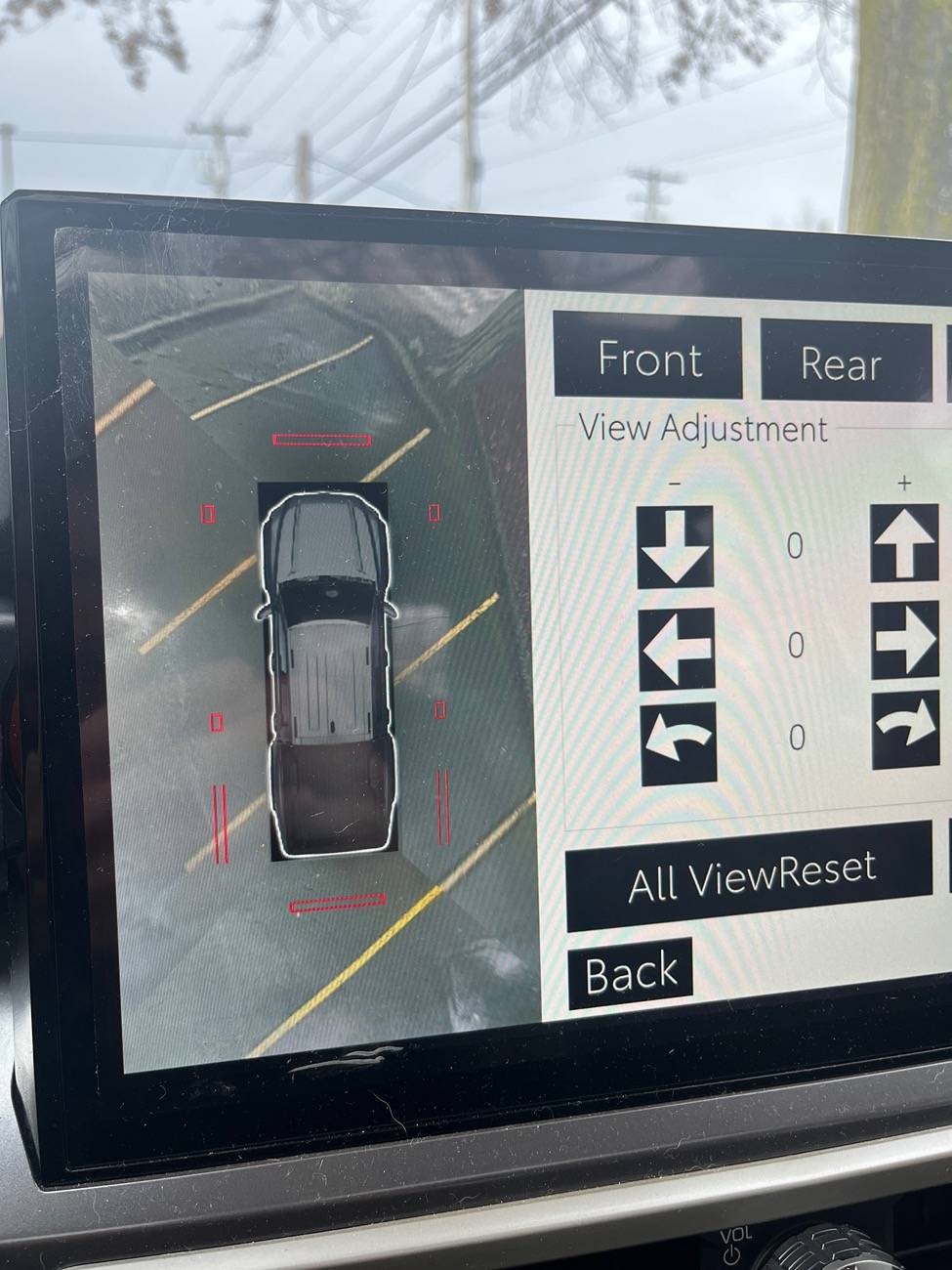

Yes. Park where there are lines so you can check alignment.
I have a Limited so my OEM grill may be different than yours. I am planning on using the 3d printed file that Gurvy522 uploaded, which I assume is near identical to the Rave bracket. Do I need tech stream or is all this adjusting able to be done by me in the infotainment?
Also, you previously mention you only can save once. What happens after that? How do you do it again if you ever need to?
You should be able to get back in alignment with this in vehicle settings. The in vehicle settings allow you to adjust up and down. The amount of adjustment up or down will depend on your car. It is for fine tuning in case of misalignment due to manufacturing variations. Kind of like how you can adjust the different video position adjustments on a computer monitor.
After the one save you will need to use a tool and reprogram the camera system If you want to adjust again.
So take your time in a spot with plenty of lines for referencing.

I adjusted my front camera via the on board diagnostic service menu. I adjusted it +165 while parked in a place where there were lines and it all lined up. Although for some reason the view adjustment button is now greyed out and I can’t access it anymore.
Once you adjust and save it, you need to reprogram the circumference monitoring system again to readjust it.
I used the bracket but didn’t flip my camera (rave style) because I didn’t have a way to change the camera to upside down. I think the problem with that is the camera is not symmetrical so it ends up too skewed-exactly like gurvey said…. This can’t be a matter of adjustment, I gotta do what he did and physically flip it a tech stream it.

I installed the Heritage Grille with the Rave camera mount and just went ahead with the +165 front camera adjustment and am very happy with the results. It finally looks like it did pre-grille swap. The option to make camera adjustments is greyed out and I'm not seeing a way to access it again, but I'll say that the convenience of having the camera look normal outweighs the possibility of needing to change it again.
