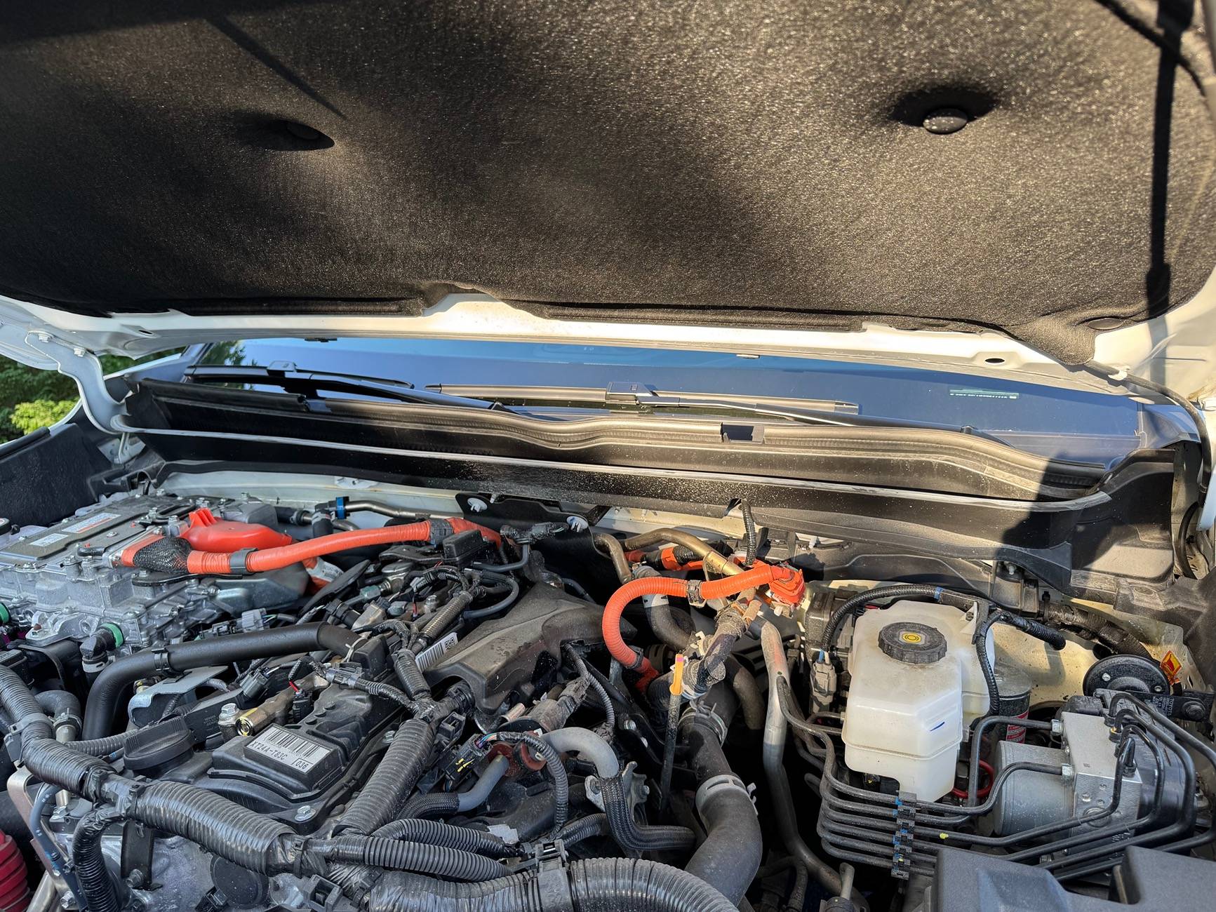

So I got to solve the hood vibration with the help of a member ordered this and installed it no more vibrating hood.
Here is what it looks like installed, got it from Amazon.
Automotive Door Weather Stripping 10Ft Car Door Rubber Edge Trim Seal Strip Gasket with Top Bulb Easy to Install for Car Bus Camper Boat RV Truck Doors and Home Applications

I see a lot of people doing this, but no much on the results. Does it eliminate the hood shake?
2,285
2,950
Yes I can tell you with a positive results the shaking is gone. That was the point of the post.
Thanks. I knew that was the point of the post but most people talked about how they were using the weather seal but not much about it stopping the shake.

I'd say about a 75-80% improvement over no seal, I may extend the drivers side and see if that helps more, it shakes a bit still but you REALLY gotta be focusing on it to the point it would be unsafe to be driving

I’ll edit my other post with the length of the new drivers side piece I put on, something to note, if you don’t grab and pull the exposed metal rib out it’ll leak rust down into the drain below which could cause future ugly issues, but I went from an 8 1/4” piece to a 13 1/2” piece it looks a bit better
