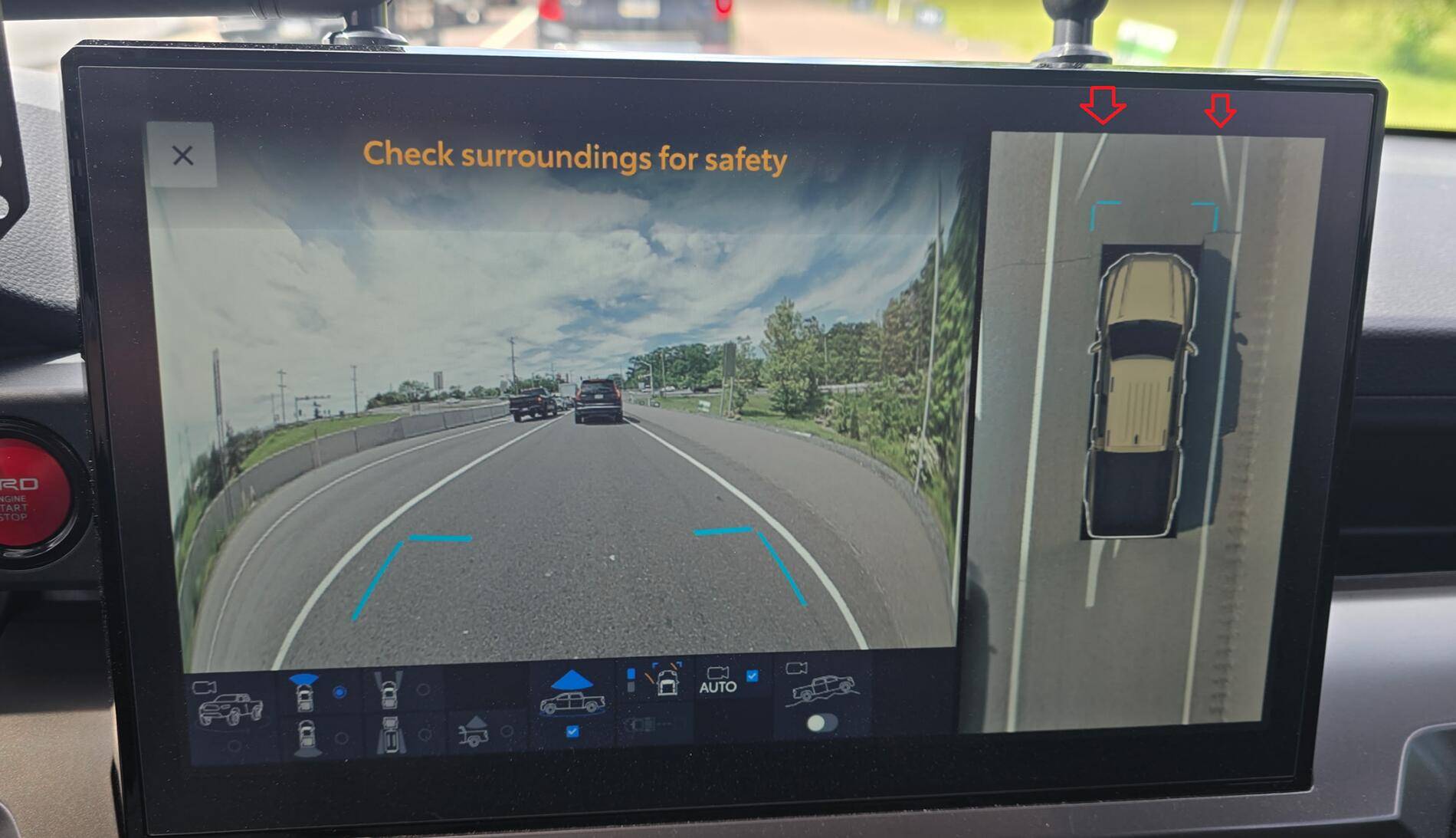

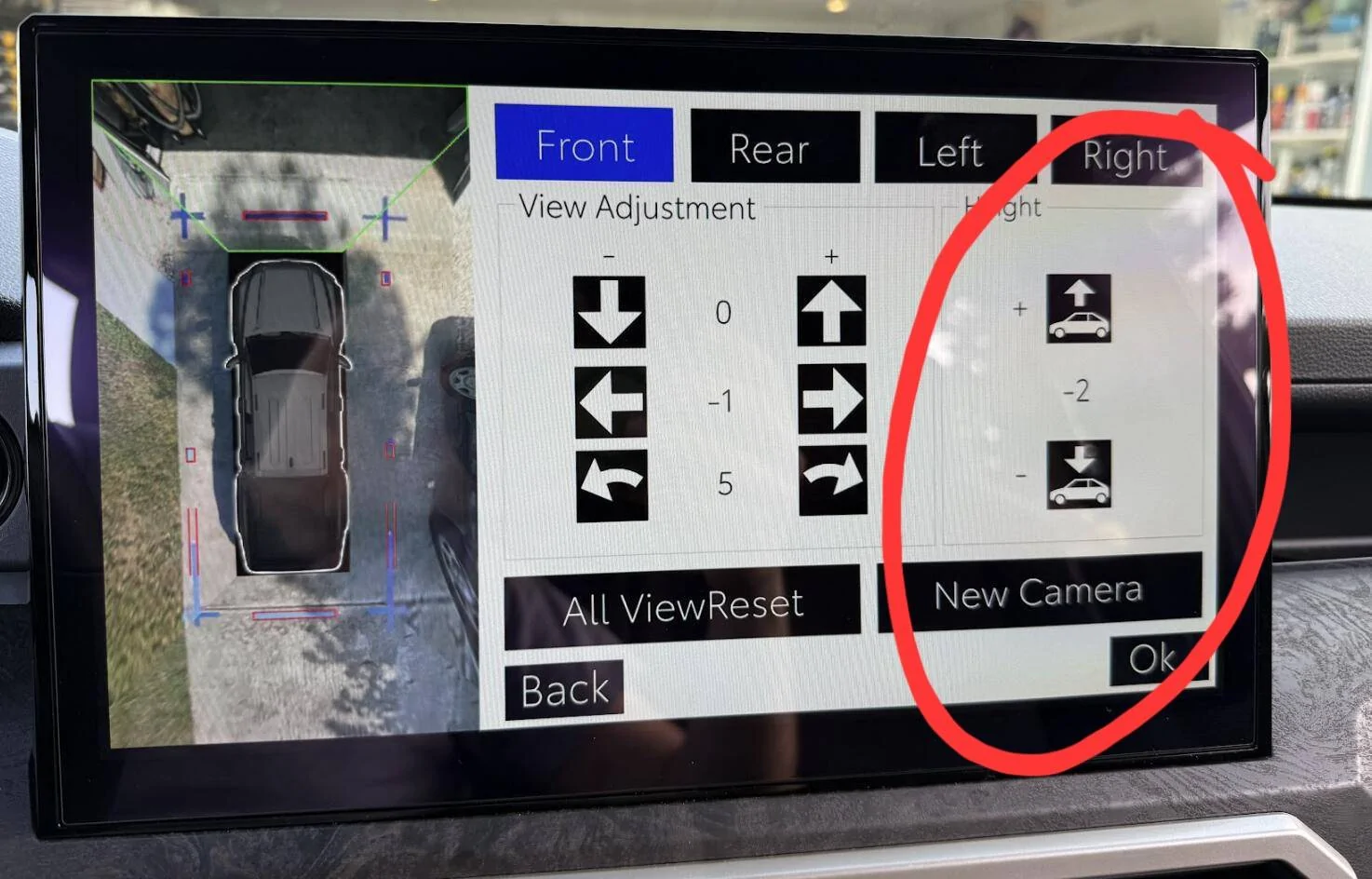

I'm being annoying. But just to be perfectly clear.
What I have circled in red is where the +160 up to +165 change that people are making correct? As in not those other values on the left side of the screen.
No, that's the lift/height adjustment that will zoom the camera in/out.
The adjustment you want is the up+ arrow that current reads zero. You'd send that up to the value.
That said, if this is a live image of your vehicle, your crosses look pretty aligned already.
Take note that if you're working any of the cameras, what the left side UP DOWN LEFT RIGHT arrows do changes... it's all about the installation angle of the camera. so even in the tech instructions they tell you to play with each direction to understand which moves the camera in which direction, then make the necessary adjustment accordingly.

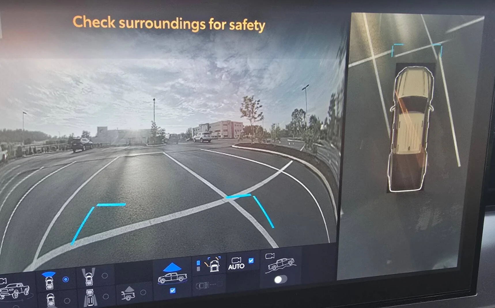

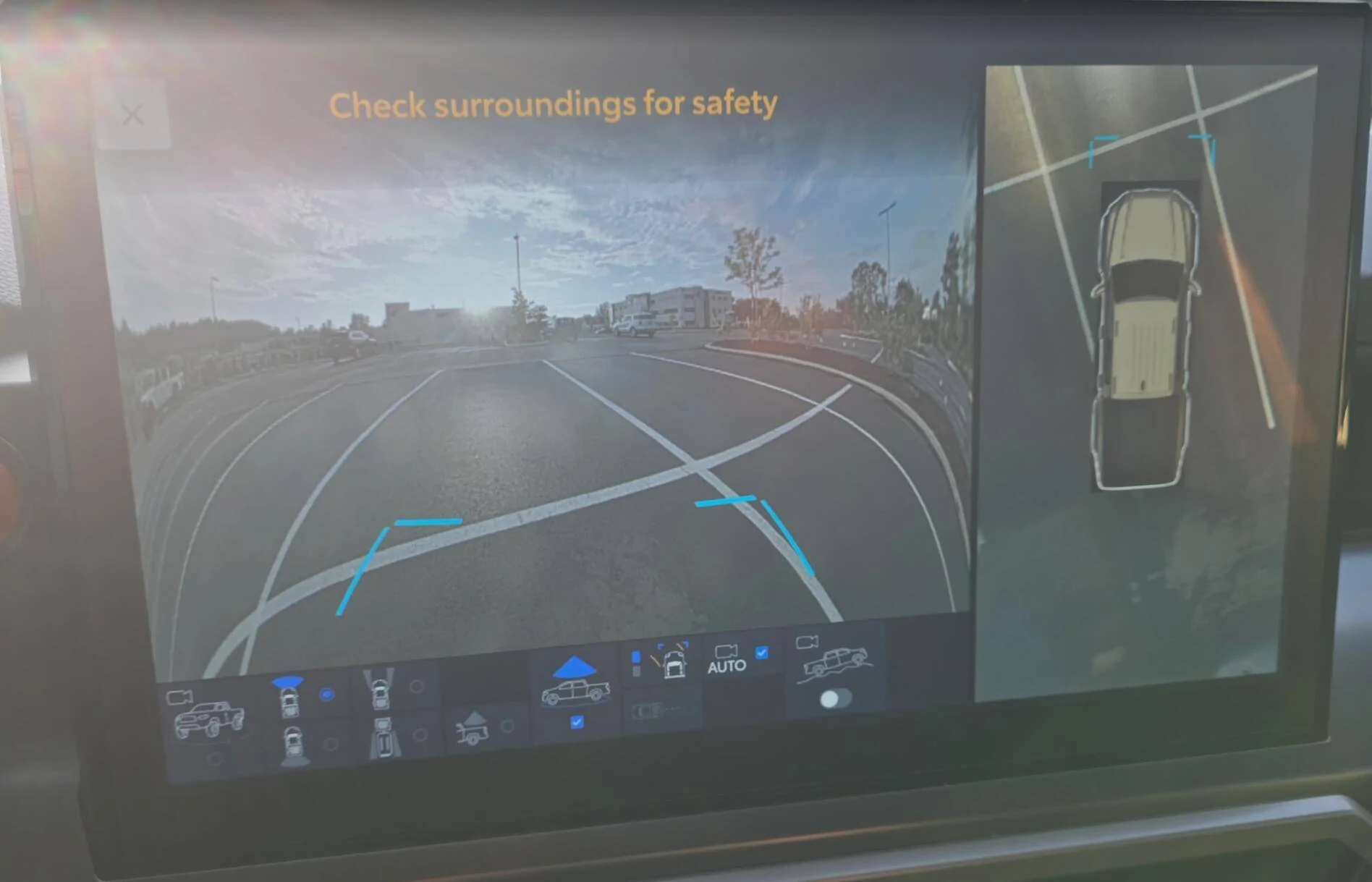

The image i showed above, is actually the image supplied on this threads original post. I was just using it for context of my question.
I did the grille swap to TH\Heritage grille from RAVE and used Gurveys camera bracket. Im guessing by doing that thats why these lines here from the front camera arent lining up straight on the overall image? So I was trying to get clarity where on that diag screen i actually put the +165 adjustment.
Correct. If your lines aren't matching, or when you roll up to a stop stripe, the image is broken/misaligned from the edges to the middle, this is the adjustment you need to make. For me, since in order to not lose the guidelines I had to set up the entire lines and crosses, I went ahead and adjusted all the cameras for better total alignment. Which also then, if all the blue alignment markers fit within the red target boxes, allows your blue and yellow line guides to be available.

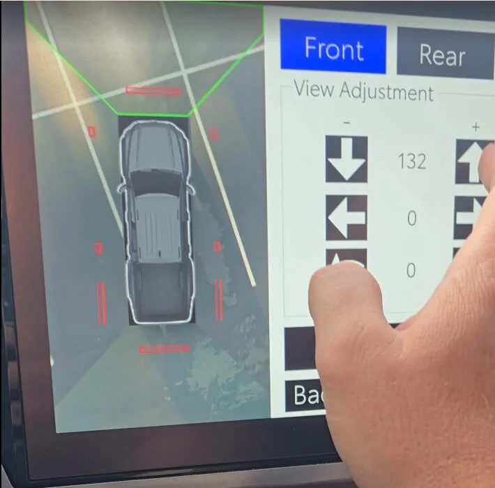

Around +130 to +132 seemed to be the sweet spot for me.
BEFORE(heritage grille installed + Gurvy bracket)
2024 Tacoma How to recalibrate your 360 Cameras 1750424749073-n2
2024 Tacoma How to recalibrate your 360 Cameras 1750424775965-cy
AFTER adjustment (+130)
2024 Tacoma How to recalibrate your 360 Cameras 1750424803956-gf
2024 Tacoma How to recalibrate your 360 Cameras 1750424860917-h6

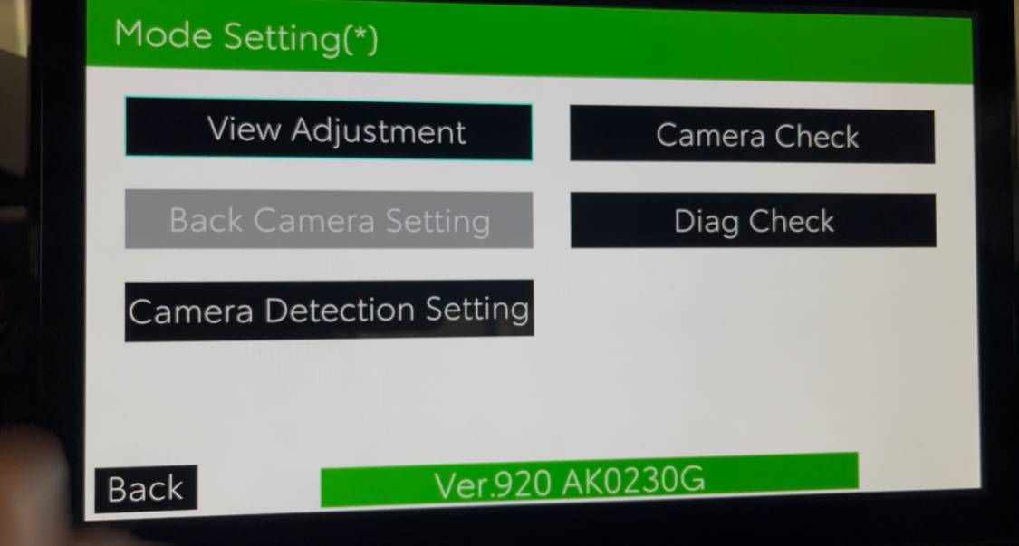

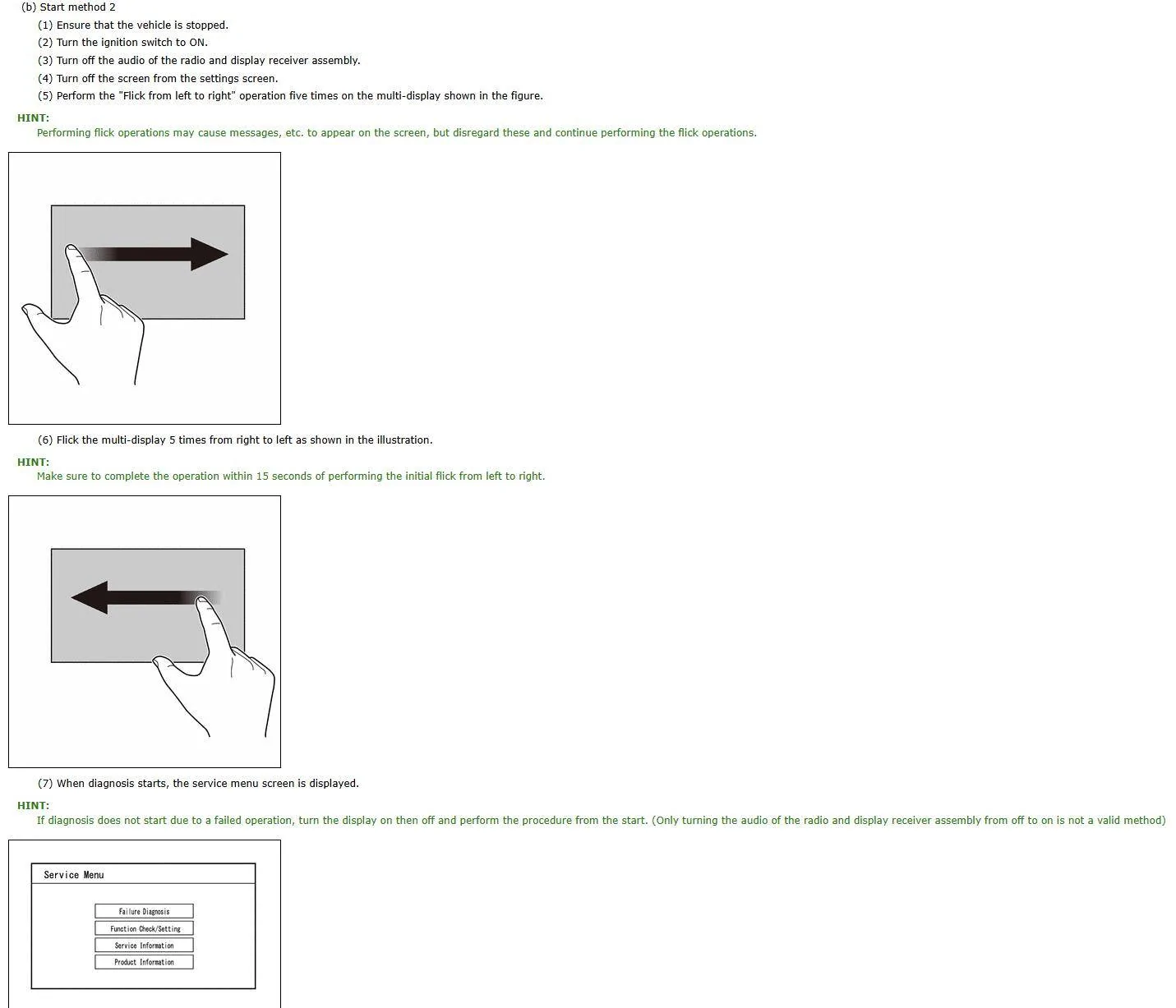

So a few weeks ago I went down the rabbit hole on how to re-calibrate my 360 cameras after I swapped my Limited Grill for a Heritage Grill.
To calibrate your cameras, it's actually fairly simple. You can do it all on your radio infotainment screen.
Steps to access the Calibration Menu (service menu):
1. Get in your truck and close all the doors and windows. From my testing, you cannot access the Service Menu if a door or window is open. Once you access the Service Menu, you then can open a door or window.
2. With your foot off the brake pedal, double click your stop/start button to access Accessory Mode
2. Wait until the infotainment (radio) screen boots up
3. Turn the volume all the way off
3. Go to Settings > Display > Screen > Turn off Display
4. Okay so here is the hardest part. You have to swipe left to right 5 times, and then right to left 5 times. Your screen may display "Touch to turn screen on" while you are swiping, but ignore the message.
4a. It may take 1 or 2 tries to get this to work. If you mess up, you just have to tap the screen to turn it back on, then turn it back off in the settings. Then continue with step #4 again.​
5. If swiped correctly, you should see a Service Menu pop up.
6. Navigate to Function Check > Camera Settings > View Adjustment
6a. If an option is greyed out, just hold the desired option for appx. 5 seconds and it will let you select it.​
7. After selecting View Adjustment, select Next.

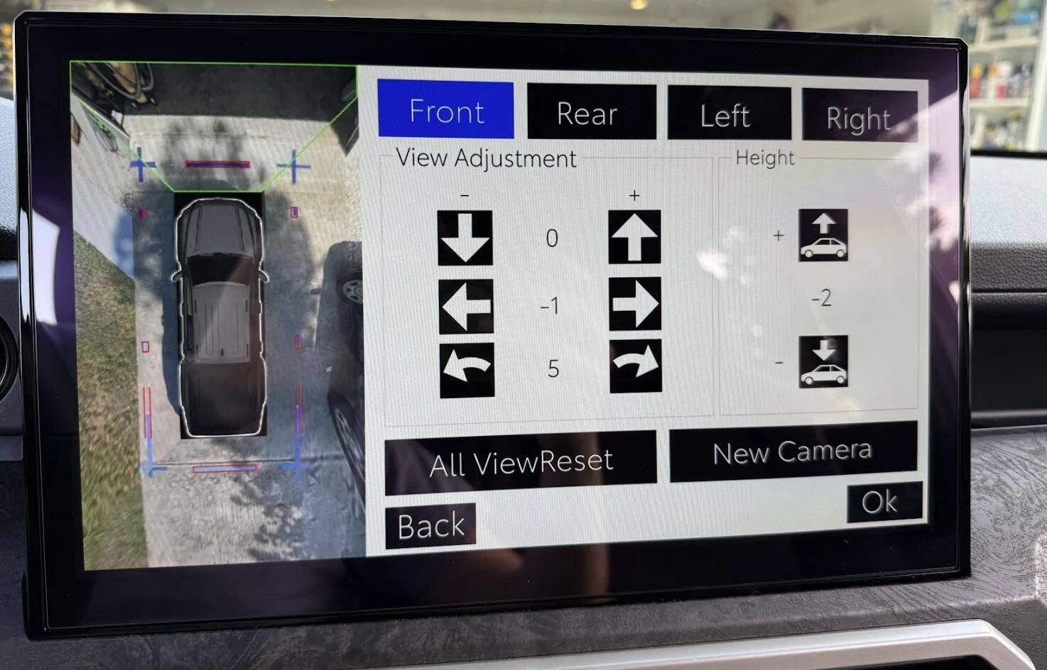

8. You will now see the birds eye view of your truck where you can make adjustments.
9. After making your adjustments, select Ok.
10. Once it completes saving, click OK and you can exit the Service Menu. The next time you start the truck, it will ask you to complete service mode and just choose ok to complete.

- I don't think it's possible to get the cameras aligned 100% perfectly. I got it like 95% good and I was happy with the result
- While adjusting the cameras, where both cameras line up and meet in the image, there is no blending effect of how they mesh together. Once you exit the Service Menu, and start driving, the normal 360 camera view adds a blending effect to where the cameras mesh together to hide some of the imperfections of misalignment, so don't worry if the service menu doesn't look 100% perfect.
- If you are only looking to realign your front camera after swapping grills, you can follow the above steps (change the front camera angle to +165 should get you close to spot on, adjust + or - 1 until you get it perfect).

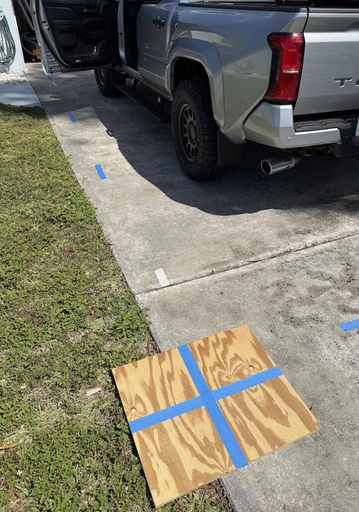

If you are looking to do a full recalibration of all the cameras, I have attached the official Camera Calibration Procedure from the Service Manual that I found shared online. This procedure is very in depth, and honestly probably not recommend if you are only swapping your front grill camera (I believe other forum members were able to change their front camera calibration to +162 or +165 to get it adjusted correctly) With my tailgate camera also being misaligned from the factory, I performed this calibration to get everything dialed in. It did take some time, especially settings up all the tape.
The official calibration procedure of laying tape down in precise locations was time consuming and very tedious to get all the tape lined up perfectly. Honestly, I think if you just take a 2ft x 2ft piece of wood or cardboard, put some painters tape on it, and move it around to each corner of your truck where your cameras 'mesh' together in the view, it will work almost as good. I've saw someone else mentioned they just went to a parking lot and used the painted lines.
Tape laid out per the Service Manual Procedure
This was as close as perfect as I could get it. It's not perfect, but I was happy with the results. Much better than how it came from factory. The adjustment values in this picture are not accurate, as each time you save, the value returns to zero.
Using wood instead to save time.

How do you know if your camera needs to be calibrated? I swapped to an aftermarket grill and checked my cameras and all seem fine.
TRD_OnRoad
Dec 3, 2025
New Jersey
2024 Toyota Tacoma TRD-OR
I can’t speak for ā€˜aftermarket’ grilles, but the OEM TRD Pro and Trailhunter grille camera brackets are angled differently than the other trims (slightly more upward facing). It’s obvious in the corners of the front camera view where it meets up with the side cameras and looks a little warped, especially in the 360° view.
Recalibrating the front view fixes the issue. Saved me a lot of time not having to go to the dealership. If yours looks fine, then the grille you have probably has the same bracket camera angle I’m guessing.
