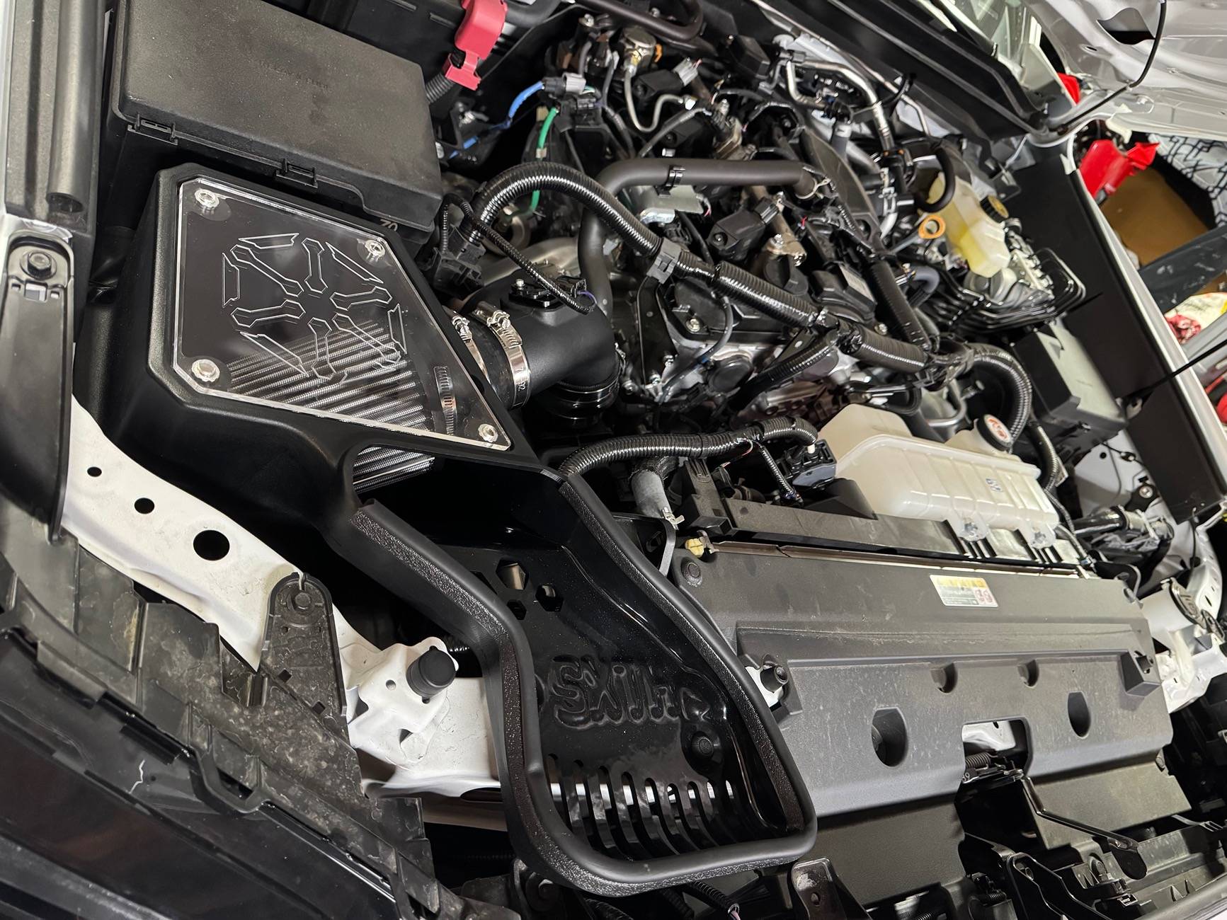

i skimmed through this thread but this intake looks interesting. Anyone have any info or thoughts:
SxthElement
Looks similar? And it’s available now! The only thing I don’t like is the magnetic lid?? Not sure how it’ll hold up off road?

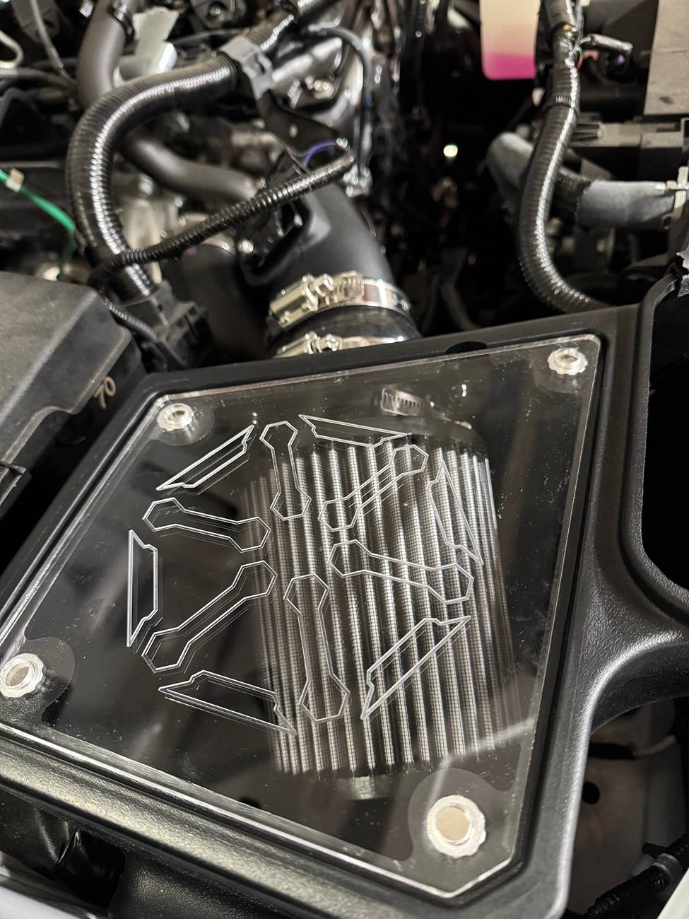

Mine has been shipped and will be here Thursday. Shall keep this thread updated.
I'm interested in your opinion. My only concern is that it would allow splashing water like in a huge rainstorm the ability to saturate the filter element. Looks like a straight shot right in to the element through the large opening. I would probably add a mesh door flap that extends down 4-5 inches to collect any water on it while still allowing the air to flow normally. I mean, it would certainly cause some turbulence, but imho, probably worth it. Hard to tell though without having one in my hands.

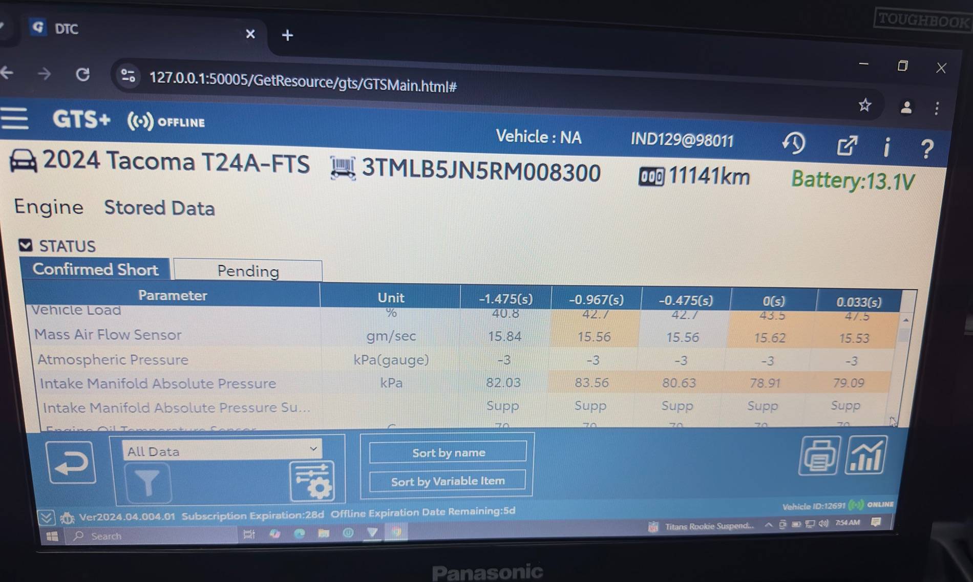

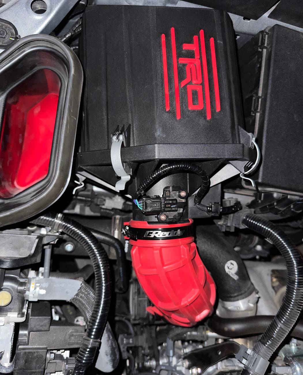

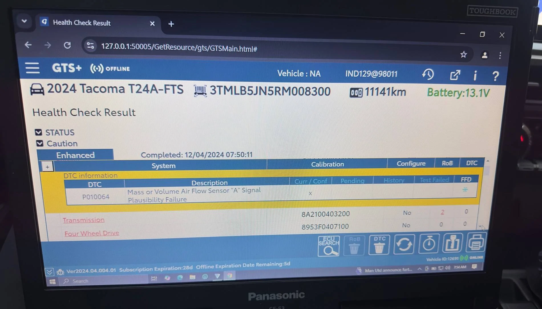

Per my 2024 Tacoma non hybrid I’ll share that I’ve been trying to run the trd pro air intake and I’ve experienced nothing but issues with the MAF sensor..
P010064 mass volume of air- too much
Lean bank 1 reduced engine power
Drive start malfunction
Traction control turns off
Secondary collision break system malfunction.
dtc will remain with the trd pro air intake can clear with gts+
As soon as you remove and reinstall the stock intake all this clears itself…
I’m curious now with a couple of these aftermarket air intakes per Stillen and HPS performance? Ive asked about this if customers have had any issue considering this has been problematic on my behalf and of course they’ve said they have had no issues….

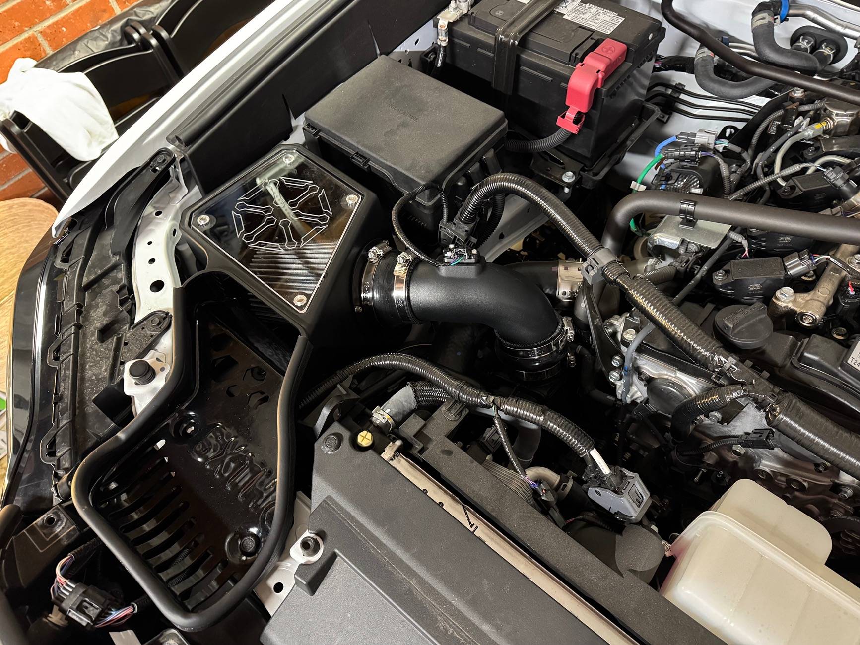

This thing (SXTH Element) sounds great. Plenty of whooshing air and turbo noise. If you're not about that, it’ll probably bother the hell out of you.
Got a road trip tomorrow to the mountains. Will get some sound bites
The magnetic lid for the air box is pretty trick as well
Dude I’m having same issues on my hybrid version and had to go back to oem. I have to pick up my truck tomorrow and will talk to parts department to take this part back. I’m upset that I used vin to obtain this part and was confirmed it would be plug and play with no issues.
