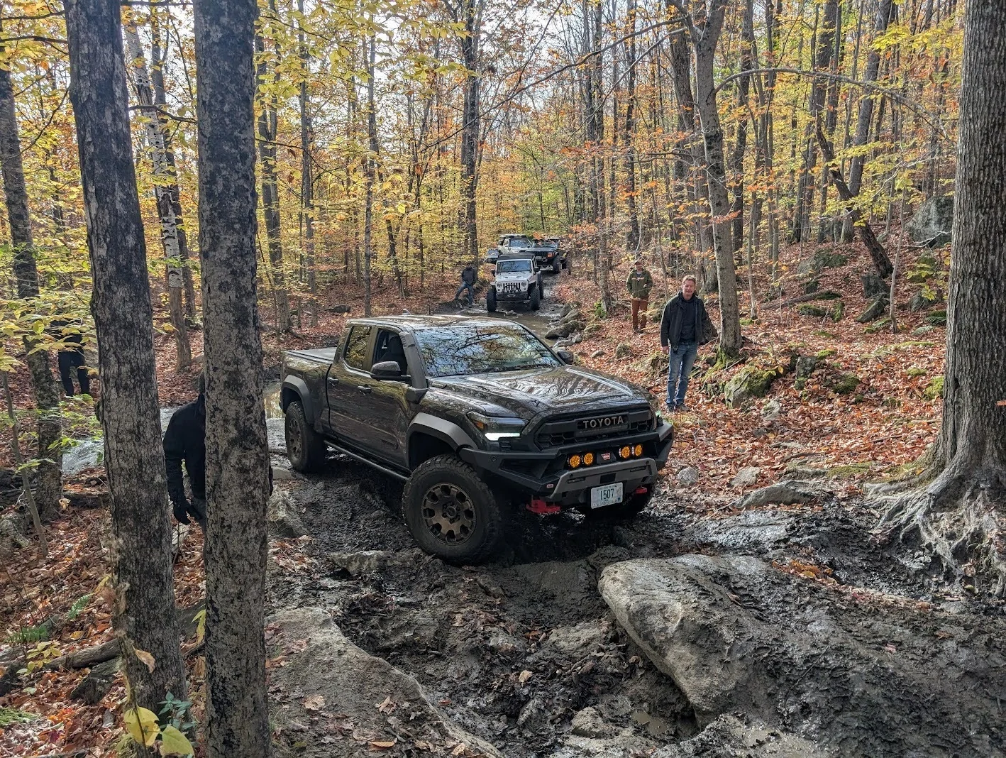

But has anyone ever done any hard wheeling/off-roading with 35s? I need to know before I make the jump. How bad is the rubbing going to be on a +25 wheels and a 2 inch lift. If you have a picture of the front suspension fully loaded, even better!

I love 'em. Not really sure how to describe the feel... We're in different trims too, so may not be the best comparison. For me, they get the job done. Big upgrade from the stock 33's. See my build thread if you want more details on the fit, but again... different trim level.

I have a TRD Off Road and a 3 inch level kit from Ironman. 3 inch in the front 1 inch in the back. I'm using the stock suspension and stock rims. I have 35 inch Mickey Thompson Baja Boss(255/85r17). No rubbing ever and I'm off-road a lot. I have one wheel dangling and the other side is compressed regularly. Never an issue.
