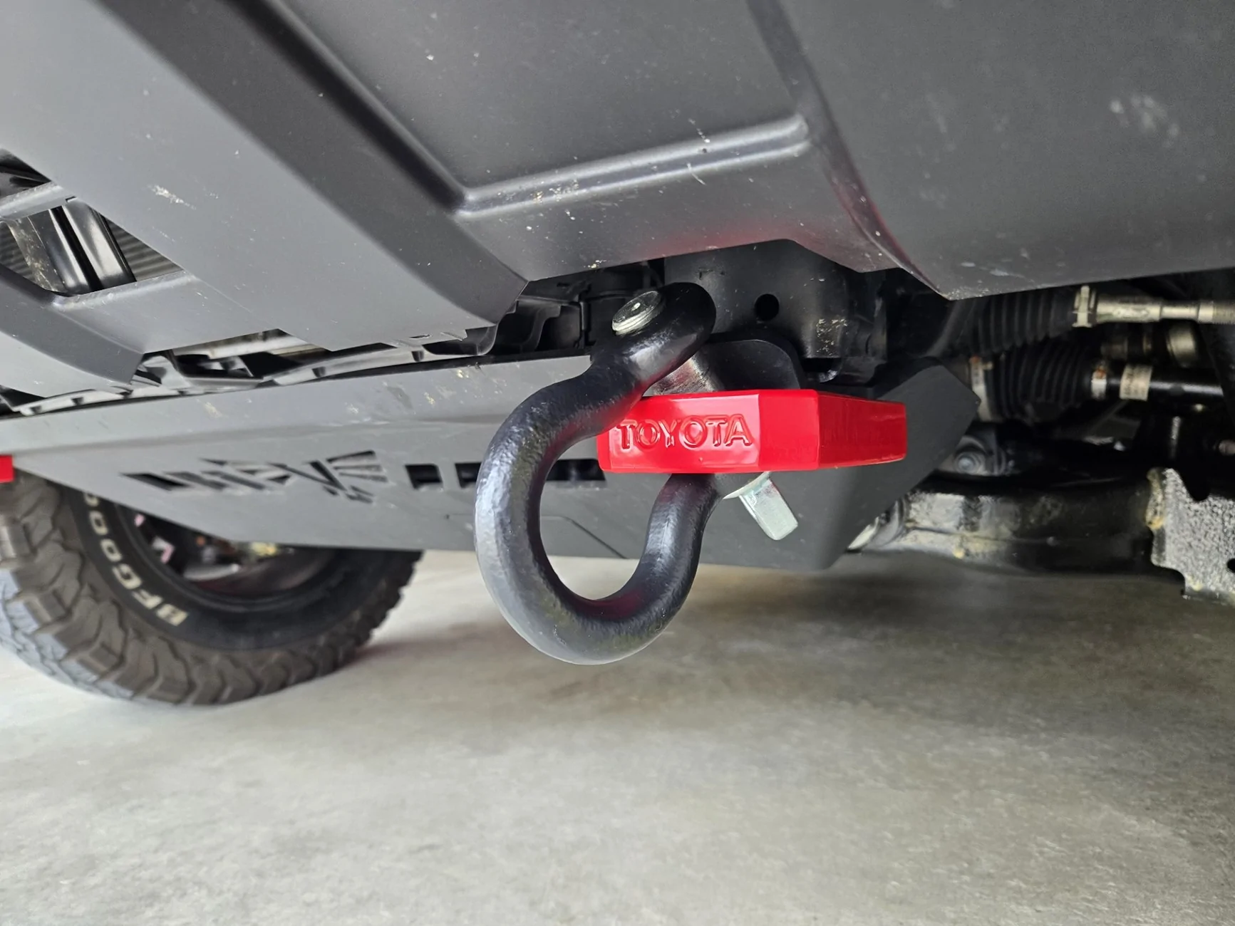

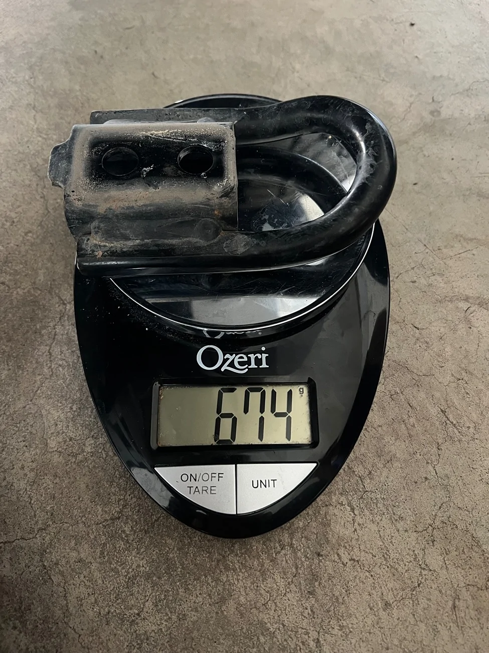

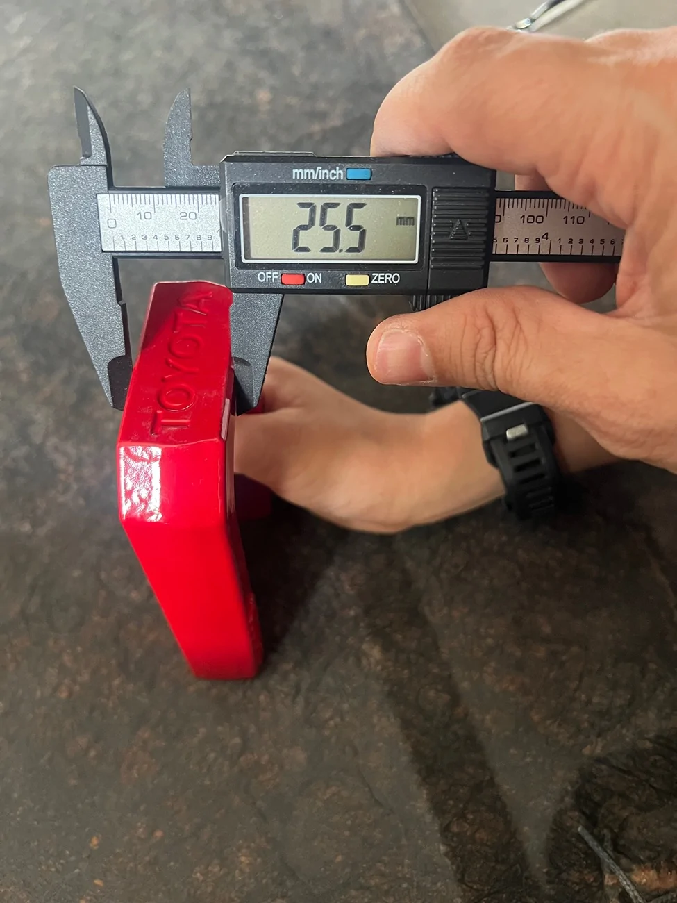

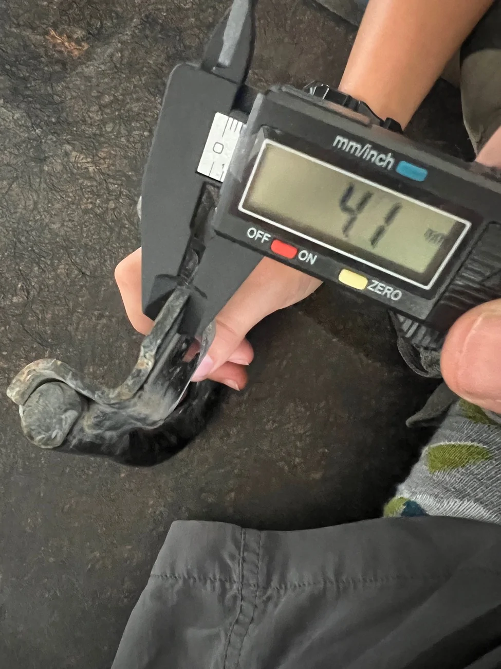

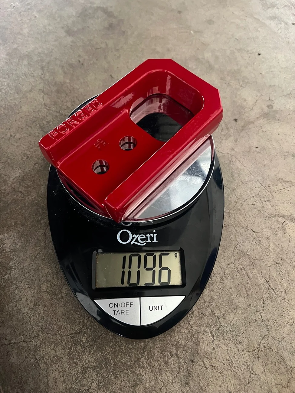

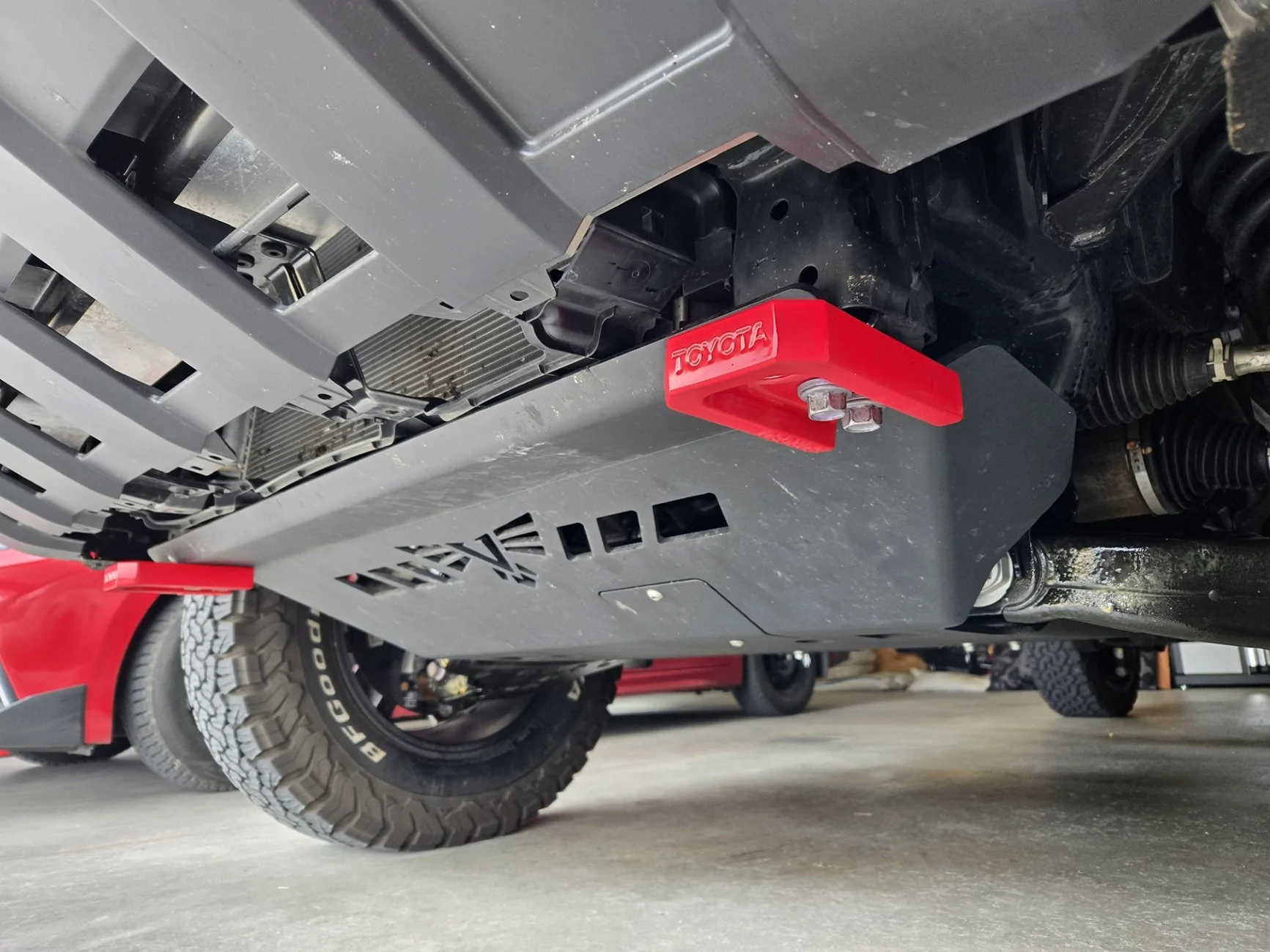

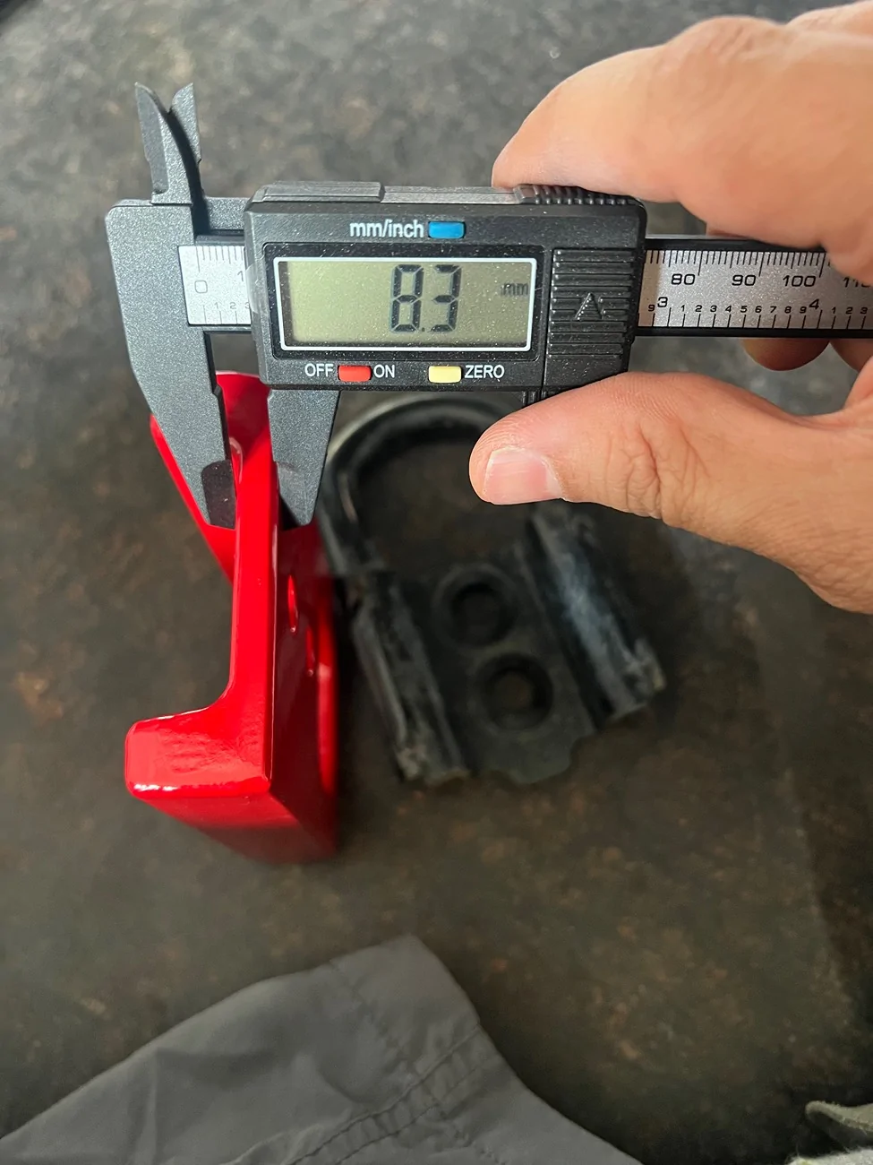

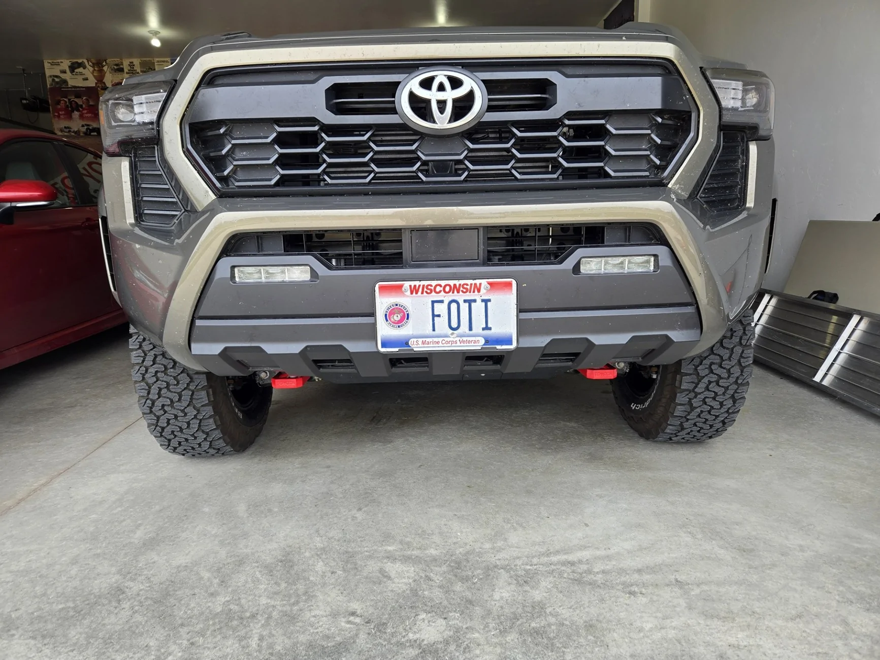

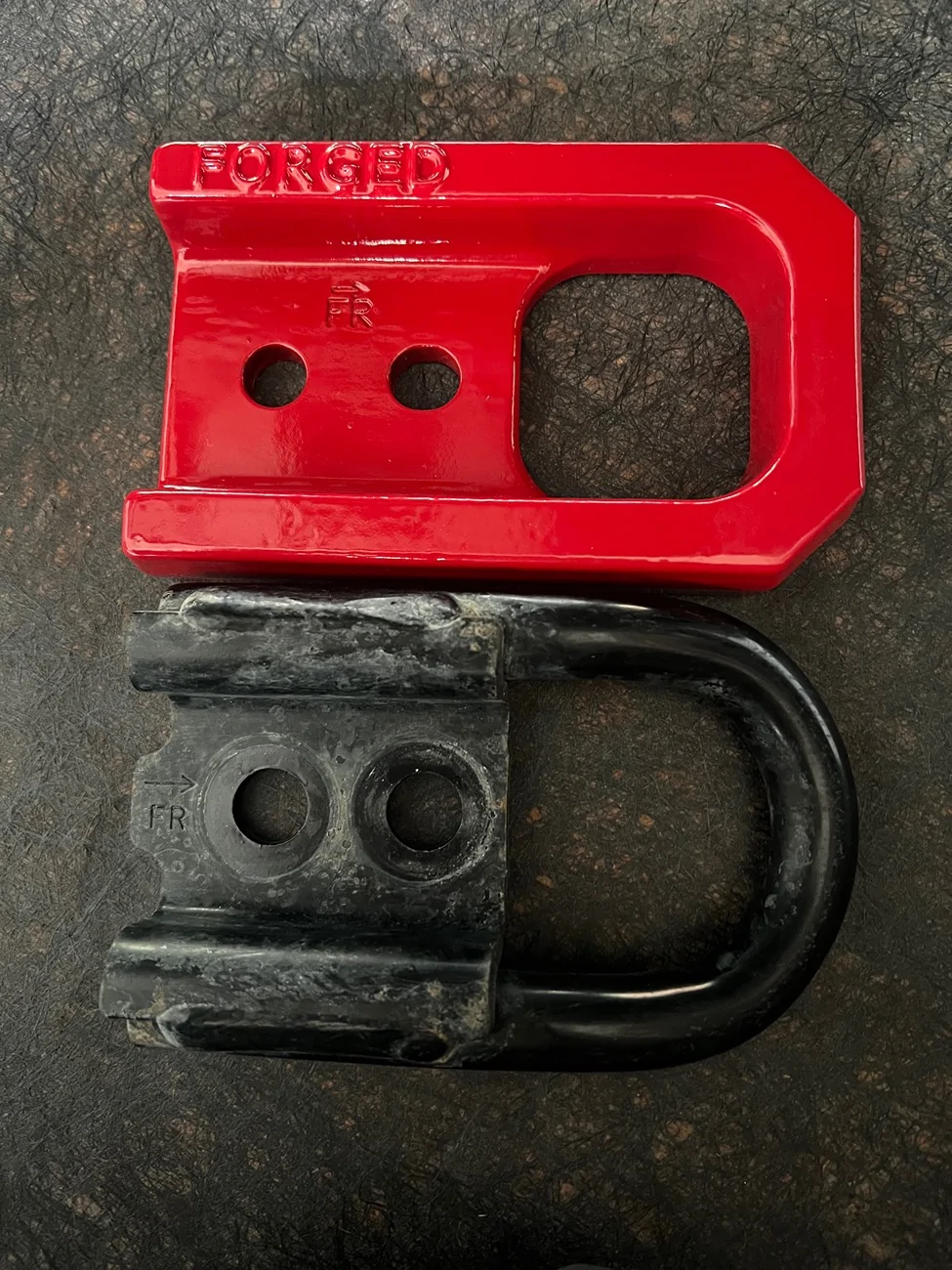

For anyone interested, I took some measurements on the new OEM red tow hooks and compared them to the OEM black ones. In terms of weight, about 1 pound heavier each. And thickness is 1.6x to over 2X thicker at the thinnest point. Torqued them to 75 lb ft.

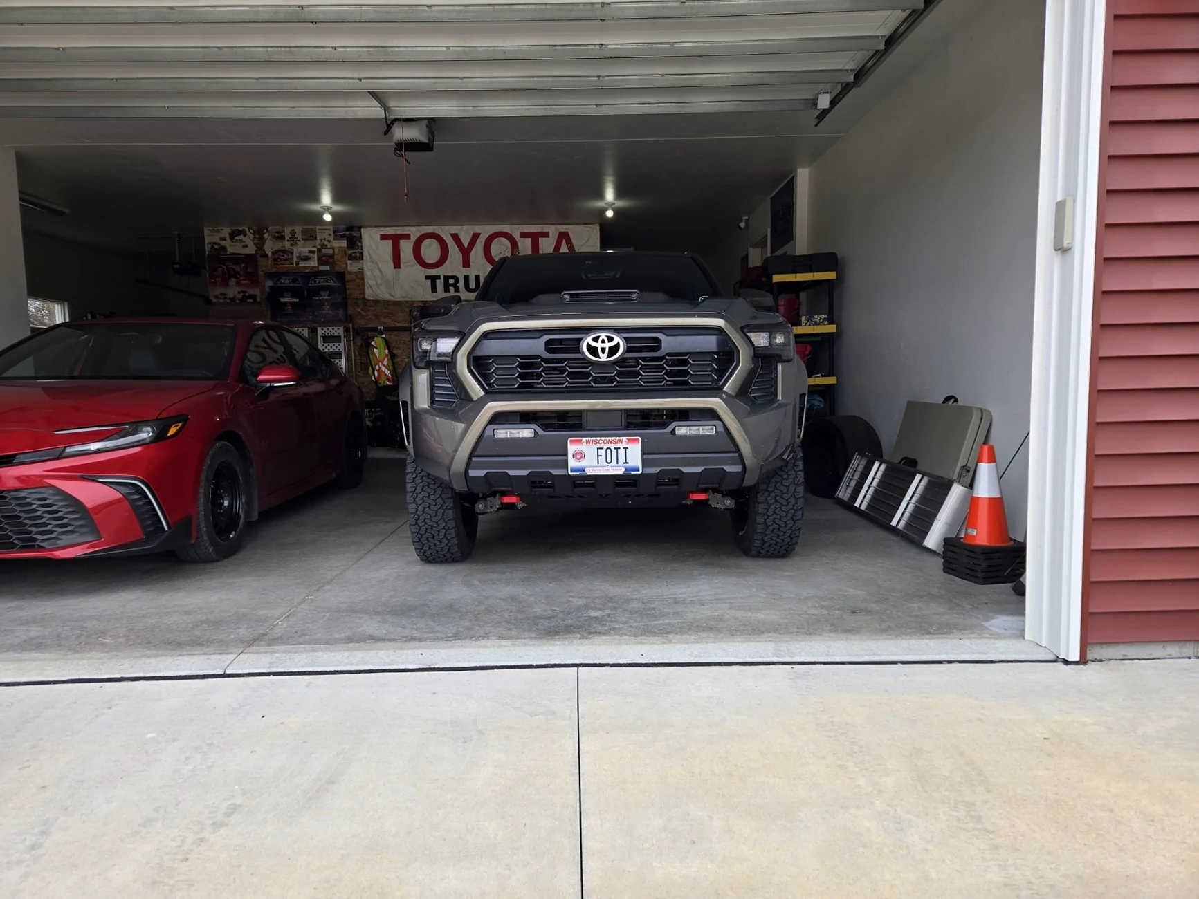

Just ordered these from elmhurst, they look good in red, ill order the high dollare ARE ones for rear next, and with our snowfall they will have some use , can always tug somboy out of a snowbank
