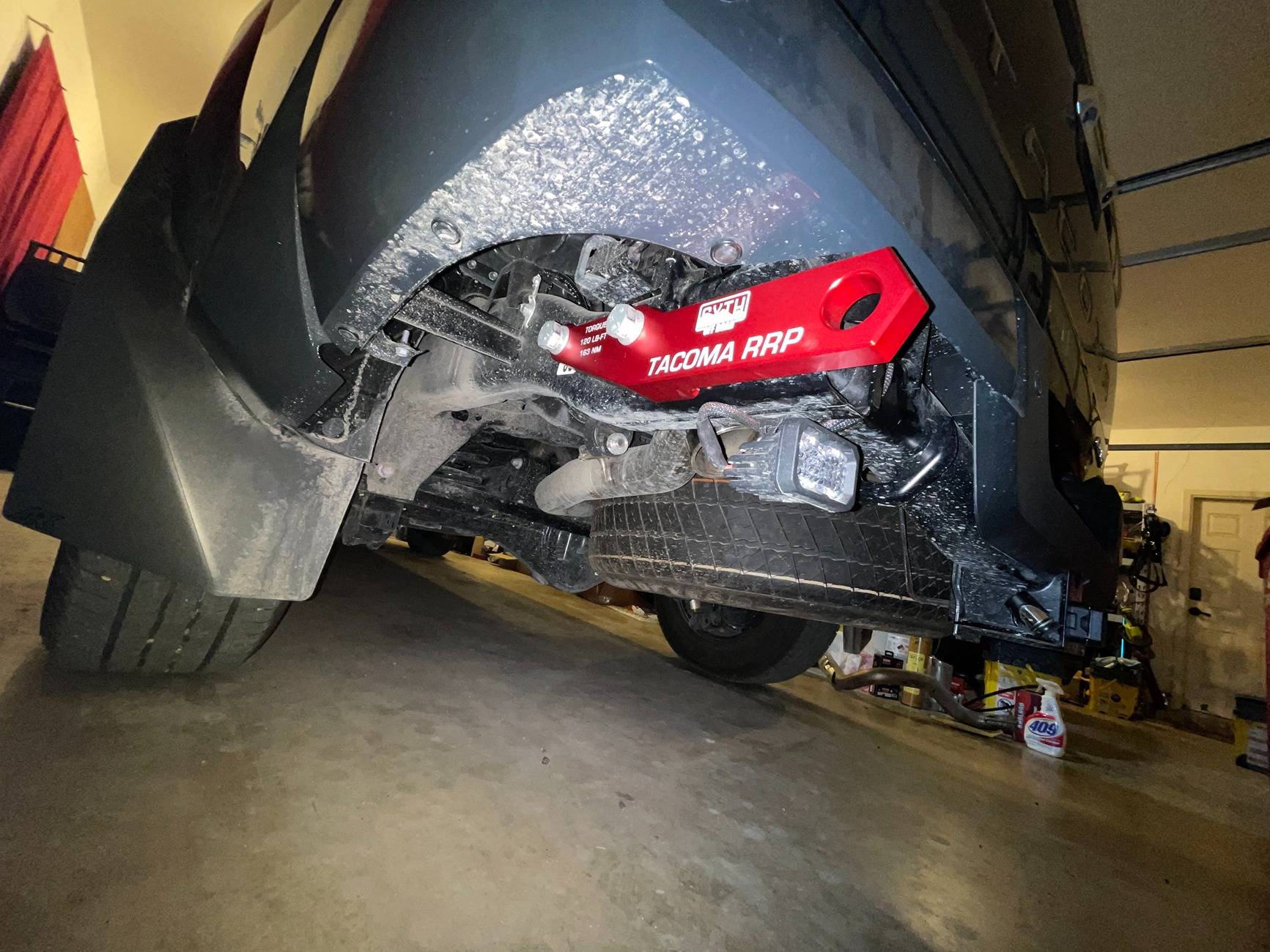

I have a 2024 Sport and I added a RCI crossmember so that I could add a OEM skid plate. The OEM red tow hook hits part of the crossmember and I had to crank down the bolts to get it to sit flush. I think I was at about 70ft lbs. it looks straight and flush. Has anyone encountered this issue?

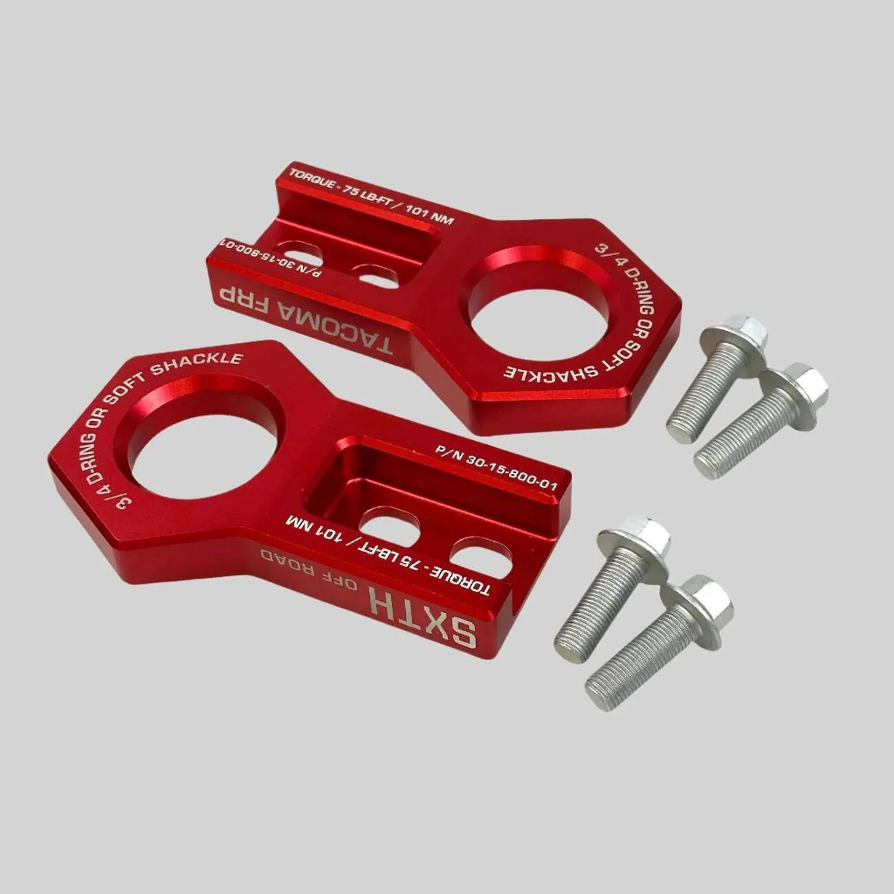

75 lb-ft. is the torque spec for them. Guess they needed to be at spec. torque. ?‍♂

I've taken mine off and on several times at the 75 lb-ft. spec. Even Sxth Element marks theirs for 75 lb-ft.

I agree that the factory hardware doesn’t seem to be the best. I rounded off one of the nuts when doing the exhaust delete. Given that it happened during removal and not tightening, the torque spec wouldn’t have helped me though. My “solution” was to order these front recovery points so that I could get free shipping on a replacement nut. ?

I've ordered and received their CAI and the rear recovery points. I haven't a clue why you are having issues with your order. I feel their products are high quality, so your issues are unexpected.
