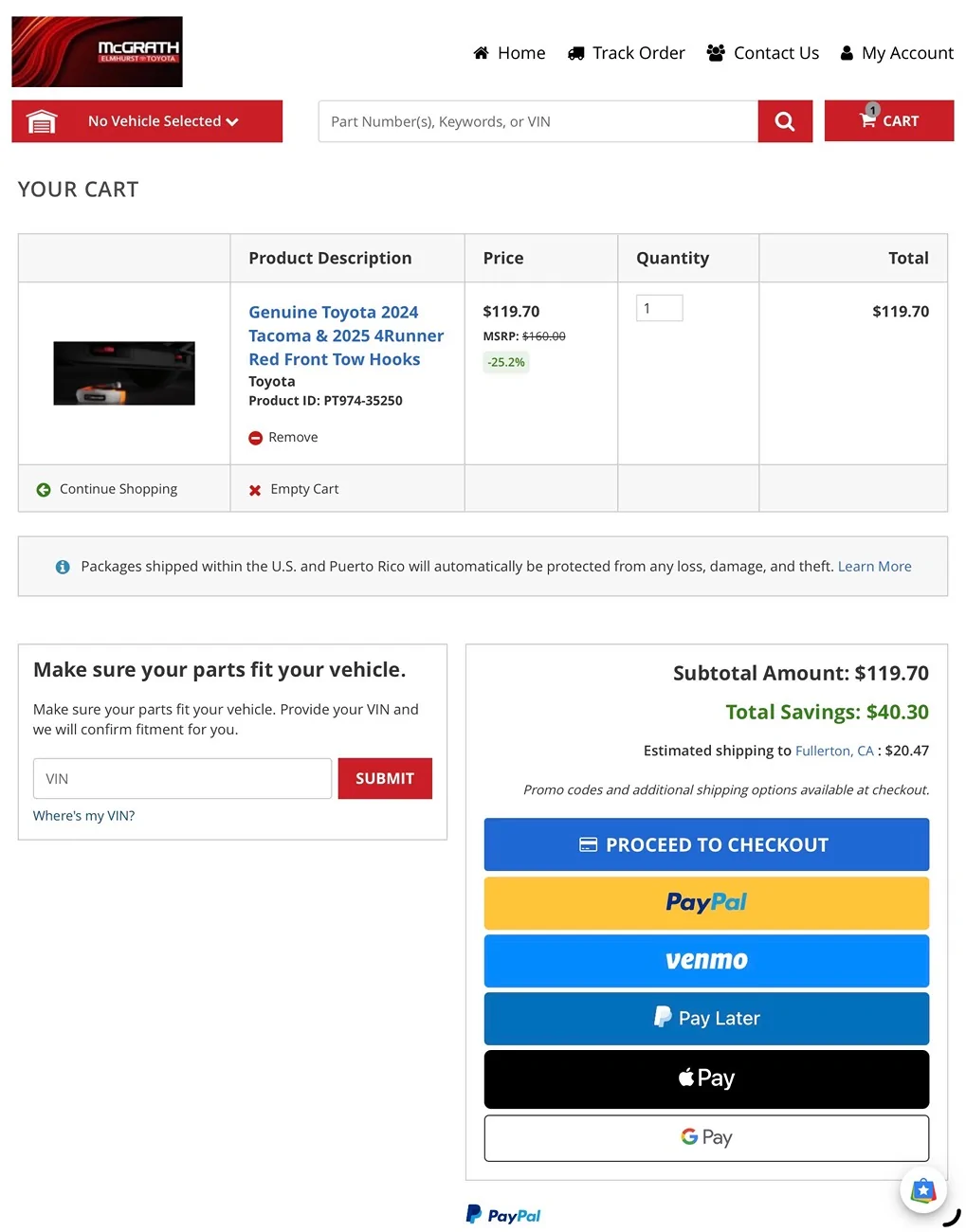

Internet shopping is strange. When I go to McGrath Elmhurst the same part shows $123.90 and you show $119.70. I put it my cart and it changed to $134.43 before shipping and tax. It will be interesting to see what @tacorancher comes up with, although any of those prices beat the outright theft he was quoted.
It says over $75 free shipping - will test it out when they have in stock all the parts I need so I can get it all at one time - much appreciate the tip.. this could be the only place that doesn’t rip off its customers

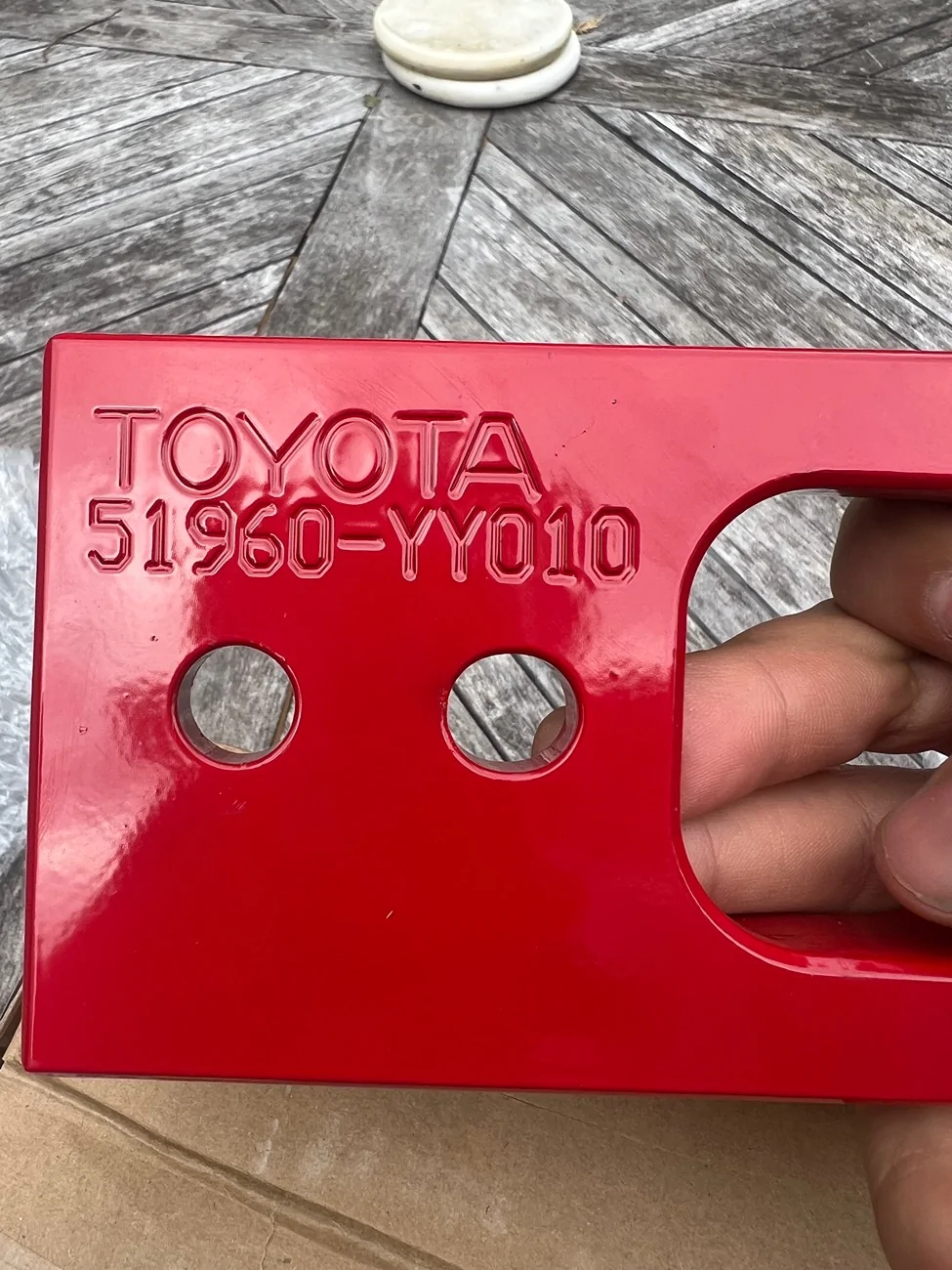

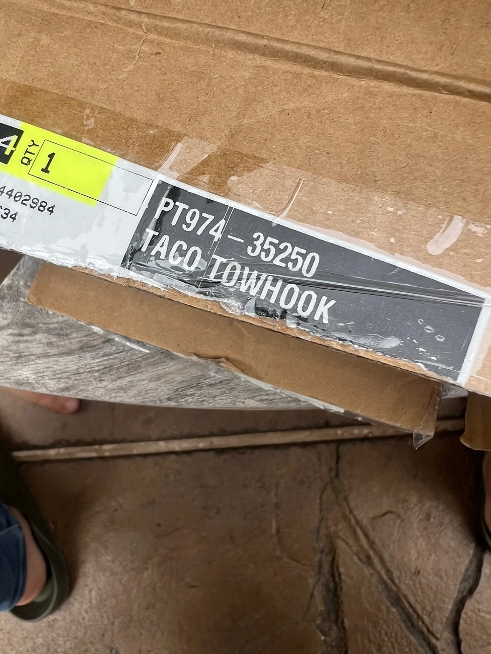

Just picked some up for $161 in Houston - cheapest I’ve seen.
Oddly they’ve got a number on them that doesn’t match the actual part number.

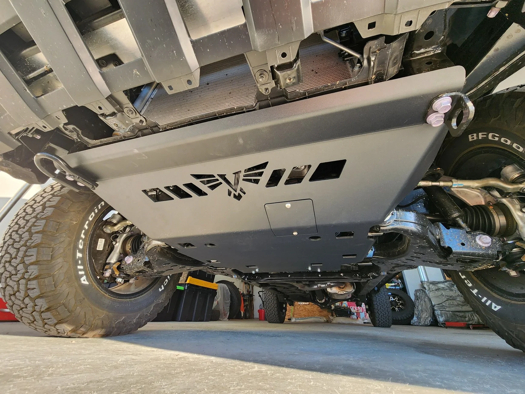

They should work with Victory front plate...

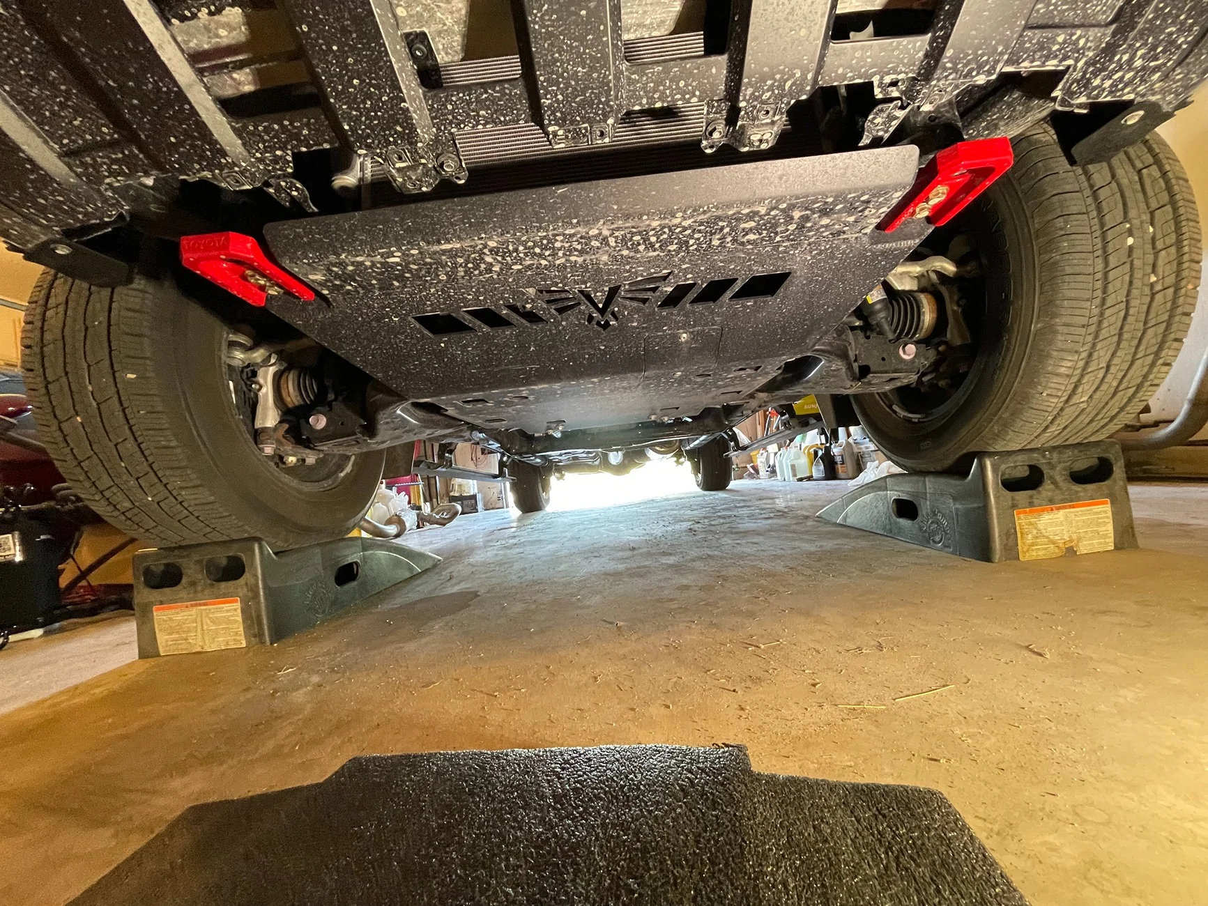

They do. However your skid plate looks different, mine is recessed at the front hooks.
