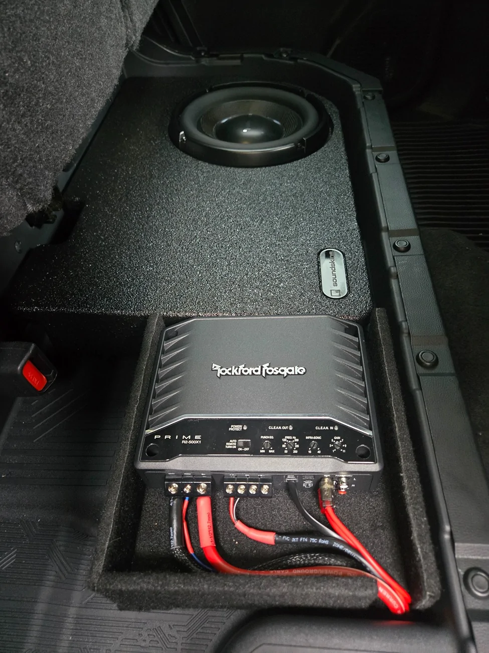

I 2nd this and did the same. Sounds way better with the Beatsonic. Maybe it took 15min to install the Beatsonic
The Beatsonic even allowed to add an amp and sub.
How is the sound quality in your truck now with the new added amp and sub? Can you share a link on where you brought all of the added amp, subs, and accessories to go along with it?
