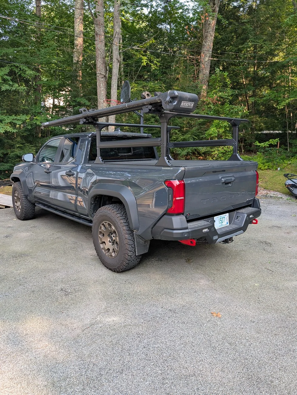

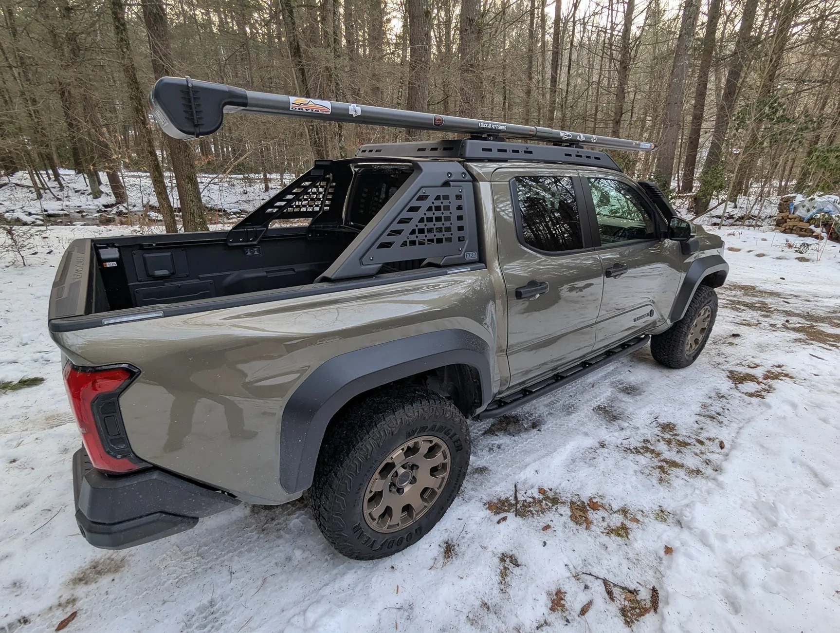

I had a Retrax Pro XR and Yakima HD on my 3rd gen, but didn't want to lose space in my bed to a retractable cover on my Trailhunter. And the Yakima HD bars didn't fit on the X4TS hard rollup I ended up with, so I went with the Elevate rack. Works great for my River Quiver and I occasionally put my Flycraft up there too, though usually that just goes in the bed (much easier!). Tight lines!
Awesome, thanks for the pics too, you're inspiring! I've got the 4-banger euro, and it's the length of the crosstrek i'm upgrading from lol....
Yeah, I hear you, it does seem like those retractable ones take up space, and are probably a lot harder to take off if you want to fill the bed for firewood or something. How is that one, do you like it? Easy on/off? Secure? Any recommendations on source so I can price it?

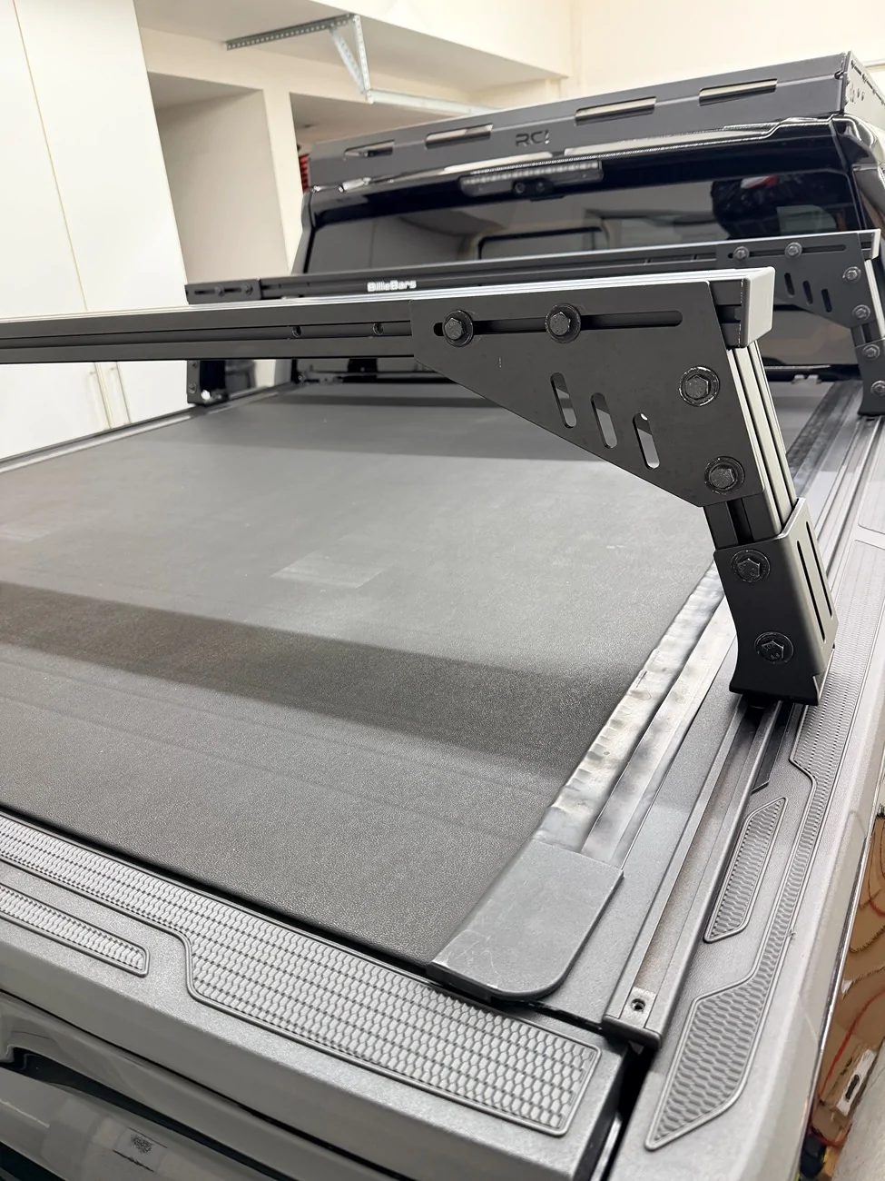

2024 Tacoma List of Covers and Racks that are compatible together? IMG_0187
Bak Revolver X4TS with Billie Bars tslot adapter

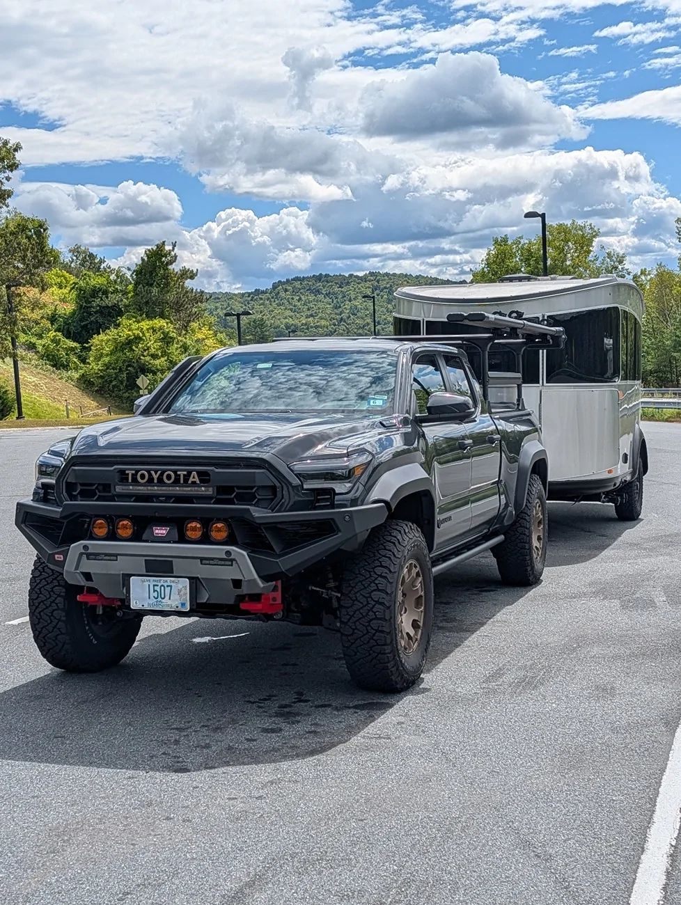

I went with Fas-Top who makes a compatible bed mounted rack, but traditional cross bars on roof. The points to know regarding Fas-Top are 1) the tonneau and topper all in one and 2) compatible rack with much adjustability. The pic here illustrates the fit when tonneau is rolled and topper is up.
Why the traditional cross bars are a few reasons. Cross bars over the cab mean I don't have items hanging over back of the vehicle most of the time. They're easily removable. My 70 inch Yakima bars carry two boats easily, a boat and more.
I have associates with the overlander style roof racks and bed racks. The bed mount racks can get in the way for work and are not as quick release. The overlander style are dirt, snow, and ice collectors same time they're noise makers that not great for quick and easy carry of a lot of stuff.

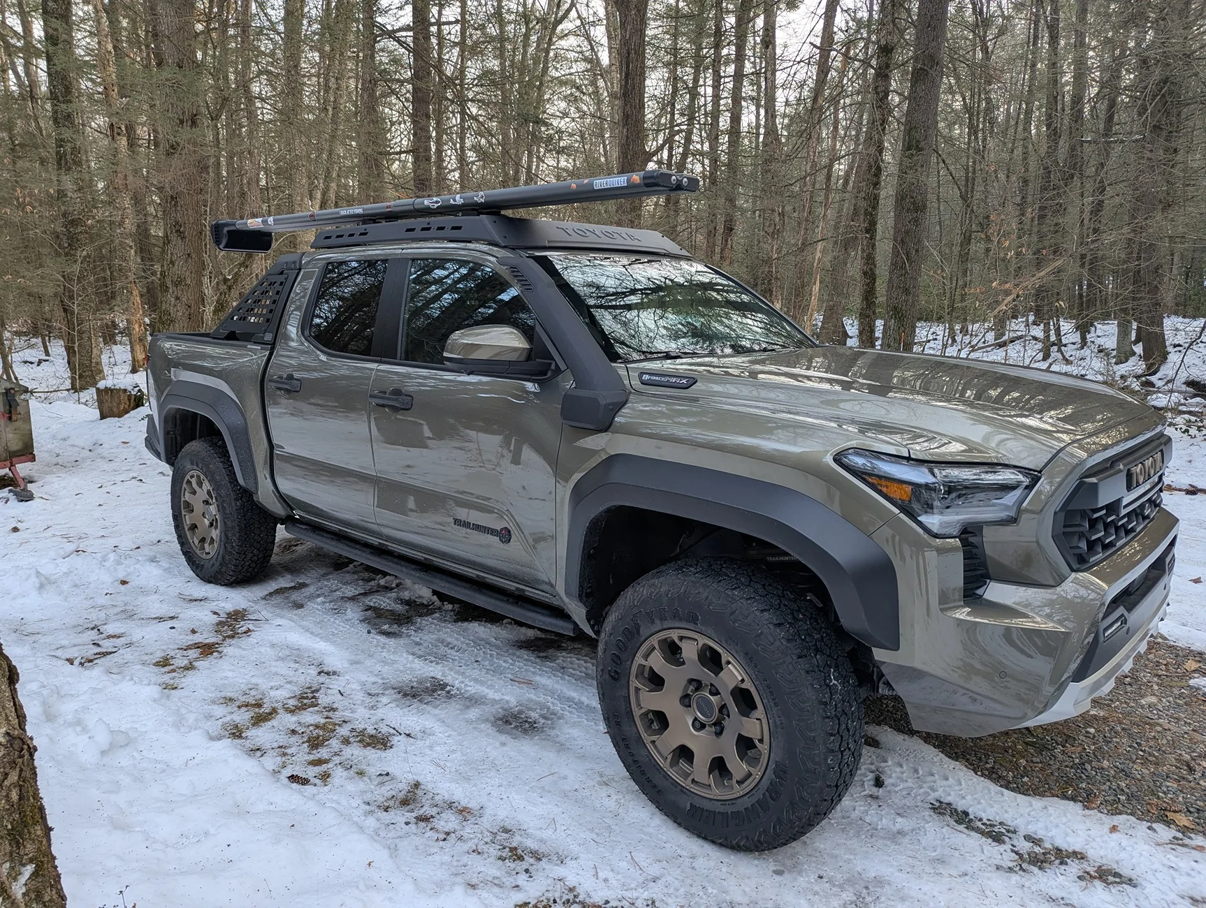

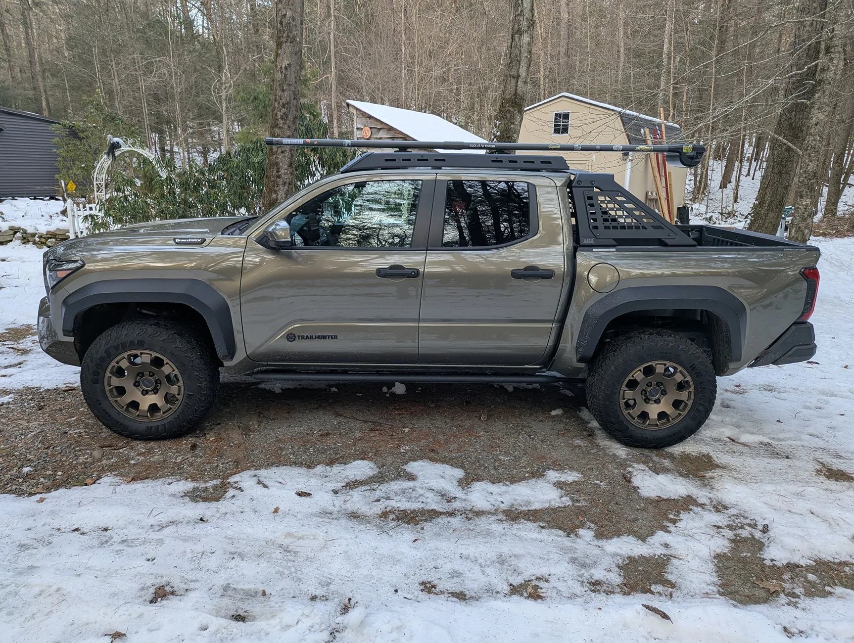

Alright, so I got the Riverquiver on, and I think it works a lot better than I was expecting.... It's the Euro, so the longest, and I've got it slightly back from center over the OEM roof rack. The OEM rack has 3 cross bars, and pretty wide spacing, so this thing locked on solid with the quick mounts. With said quick mounts, it mounts as low as possible, and I can actually still reach it comfortably from the ground without the tailgate open. It sits about a foot in from the taillight.
2024 Tacoma List of Covers and Racks that are compatible together? PXL_20251208_203835126
2024 Tacoma List of Covers and Racks that are compatible together? PXL_20251208_203640038
2024 Tacoma List of Covers and Racks that are compatible together? PXL_20251208_203700447
I had a Crosstrek Wilderness before this, and it was the whole length of the car lol....
With the way it is now, I'm really not seeing the need for the bed rack, as it only adds cost, not necessity at this point. Still need the cover, for sure. But after having it a few days now and flipping through these glamour shots, the back bar is kinda growing on me. It fits the truck. I might do the mod another user posted, to cut the bracket flush to the deck and mount it to the t-slots of the cover.
Whaddaya think?
