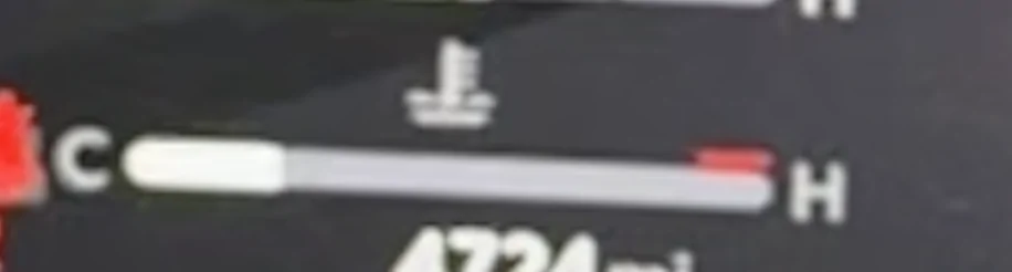

FWIW, same exact thing as far as the delay. Never on an absolute cold start. I took a picture of the engine temp because this was a more reliable way to know when I'd start hearing it (more or less when it sits at that first ~1/5 mark, is when the noise is the loudest).

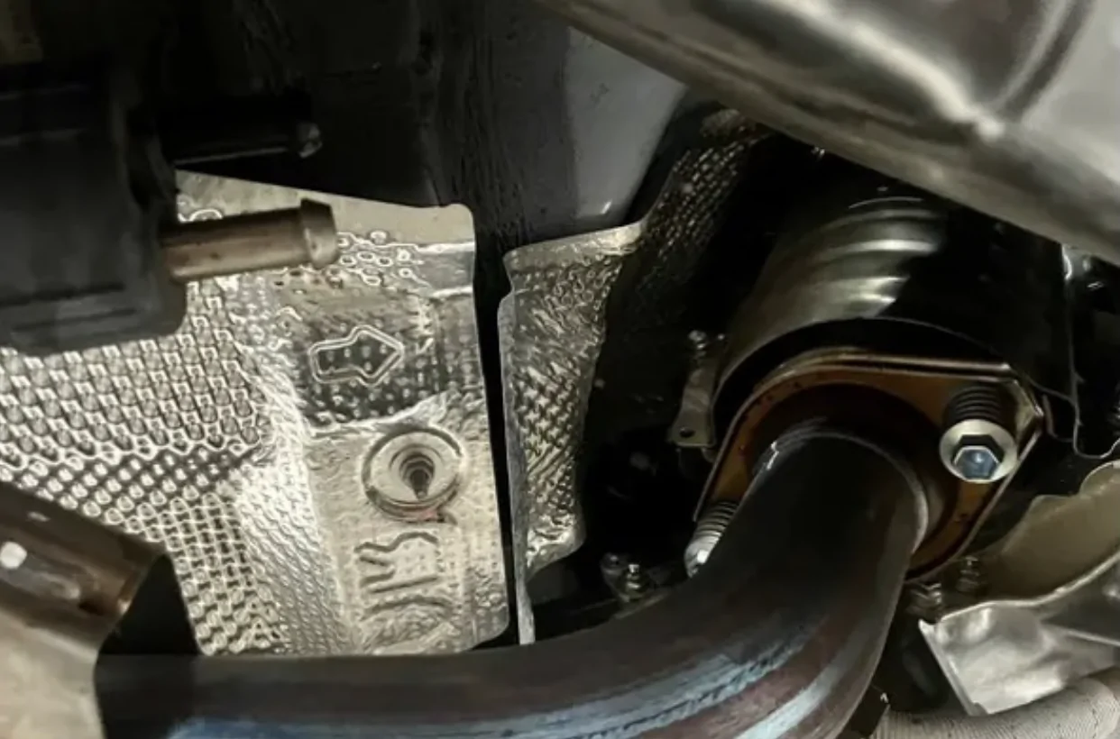

I did some searching in other places, and someone had posted this picture of his heat shield that he said was near the cat - and that those two heat shields were smacking each other rather than being loose. (the photo below is not my photo, that's the photo he posted). Unfortunately that's also under my cat shield so I can't poke at it myself, but given that the truck has to hit temp to start making it, I'd want to avoid poking around hot metal!

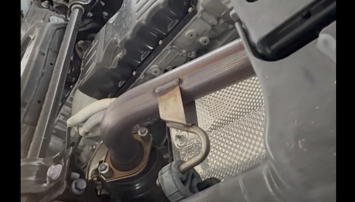

From your video -
Different angle - but the you can see the stamped arrow right near the exhaust hook. The lip of the other shield is facing the camera directly. But given the video angle, can also see they aren't really touching.

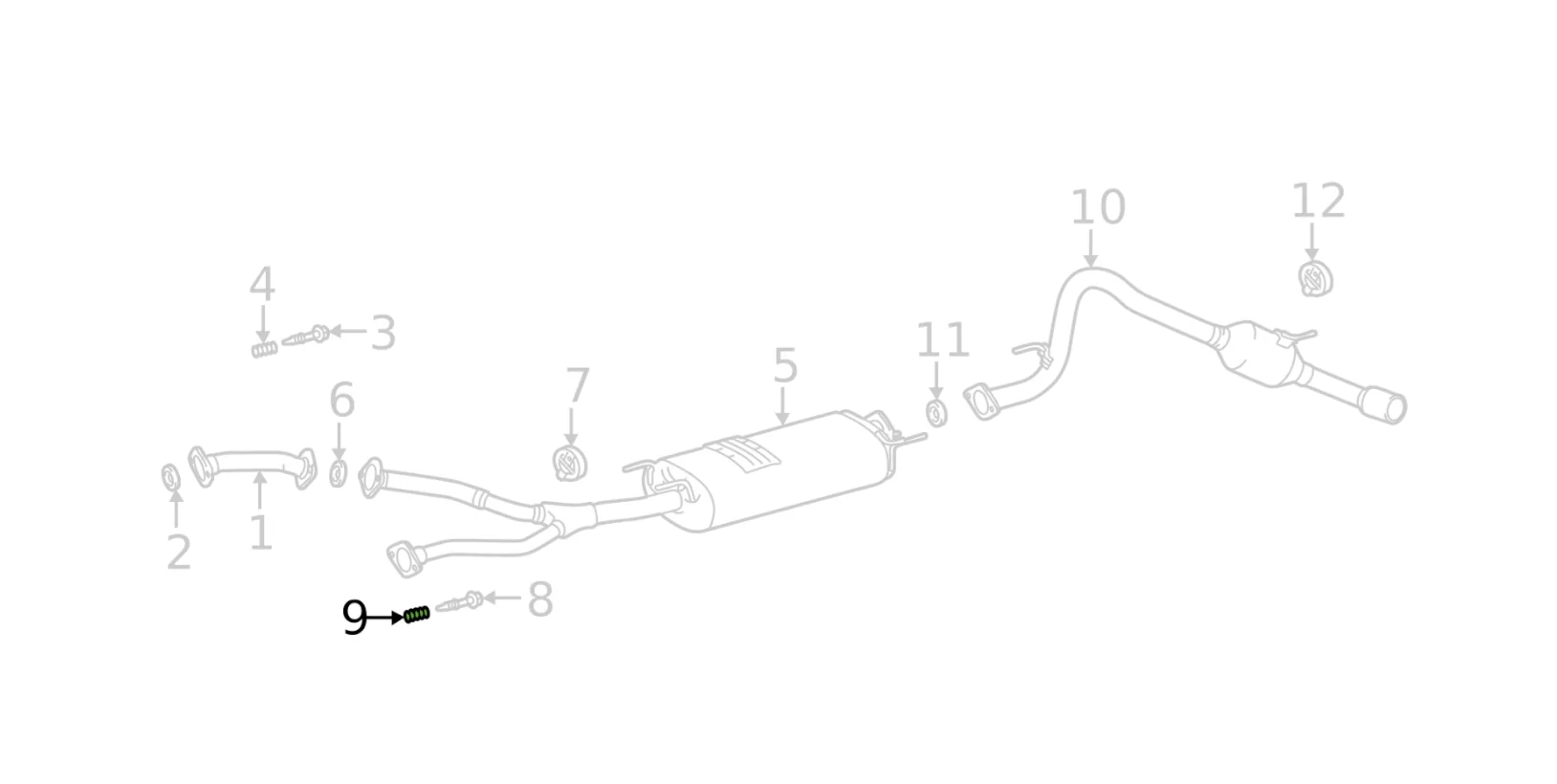

Alrighty, I think it's fixed. After my above post, it started up again. So I stuck a go-pro underneath and sat with my poker.
@Delta1Seven I pressed where you pointed out and like a magic trick, the sound went away. As soon as I let off, sound came back. Pressed, away, etc.. Photo attached.
The dealer ended up ordering the following
* 17451-0D140 GASKET, EXHAUST P
* 90501-A0005 SPRING, COMPRESSI
* 90109-A0064
I believe in my above photo, that is the spring coil to the immediate right of where I'm pressing with my poker.
