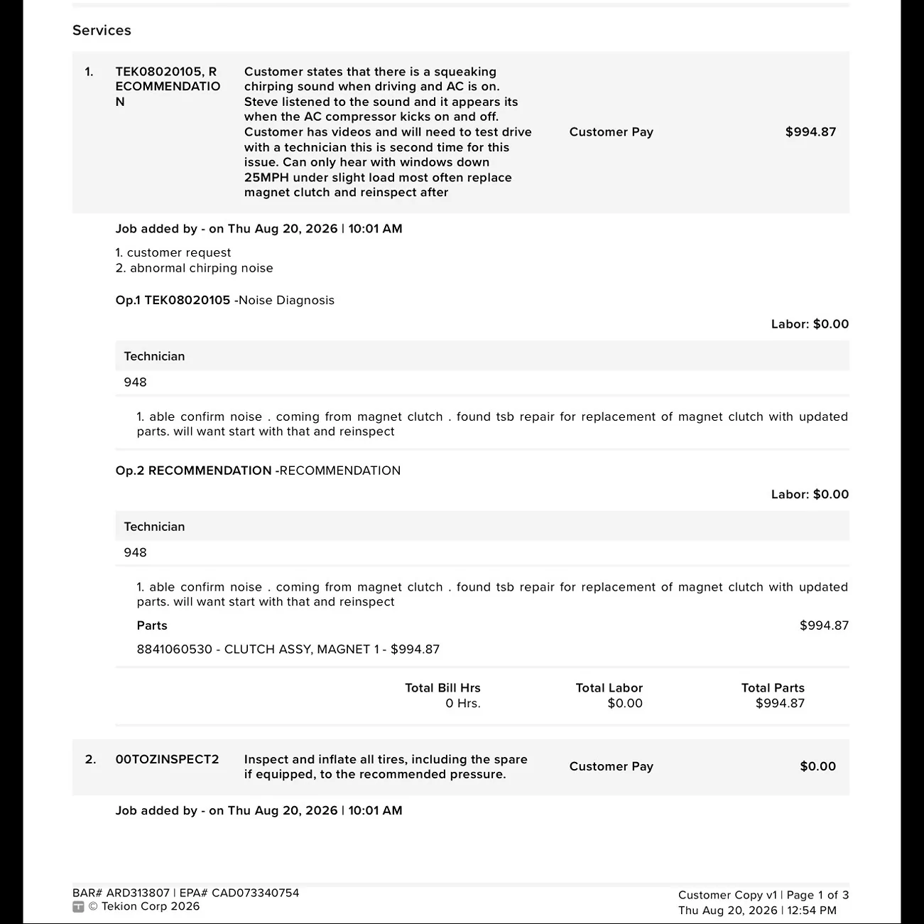

Got mine replaced today $1075! Thankfully I did get the 5yr 100k warranty ($895)
T-SB-0016-26 February 26
Part number T,8841060530 CLUTCH ASSY, M
Labor $308.31
Parts $766.79
Strange but I think my MPG’s are better by about 1-2?! Could a bad AC clutch cause extra drag on the engine šŸ¤”
No more chirps and squirrel cage sounds šŸ˜Ž if the noises come back I’ll be sure to report here.
