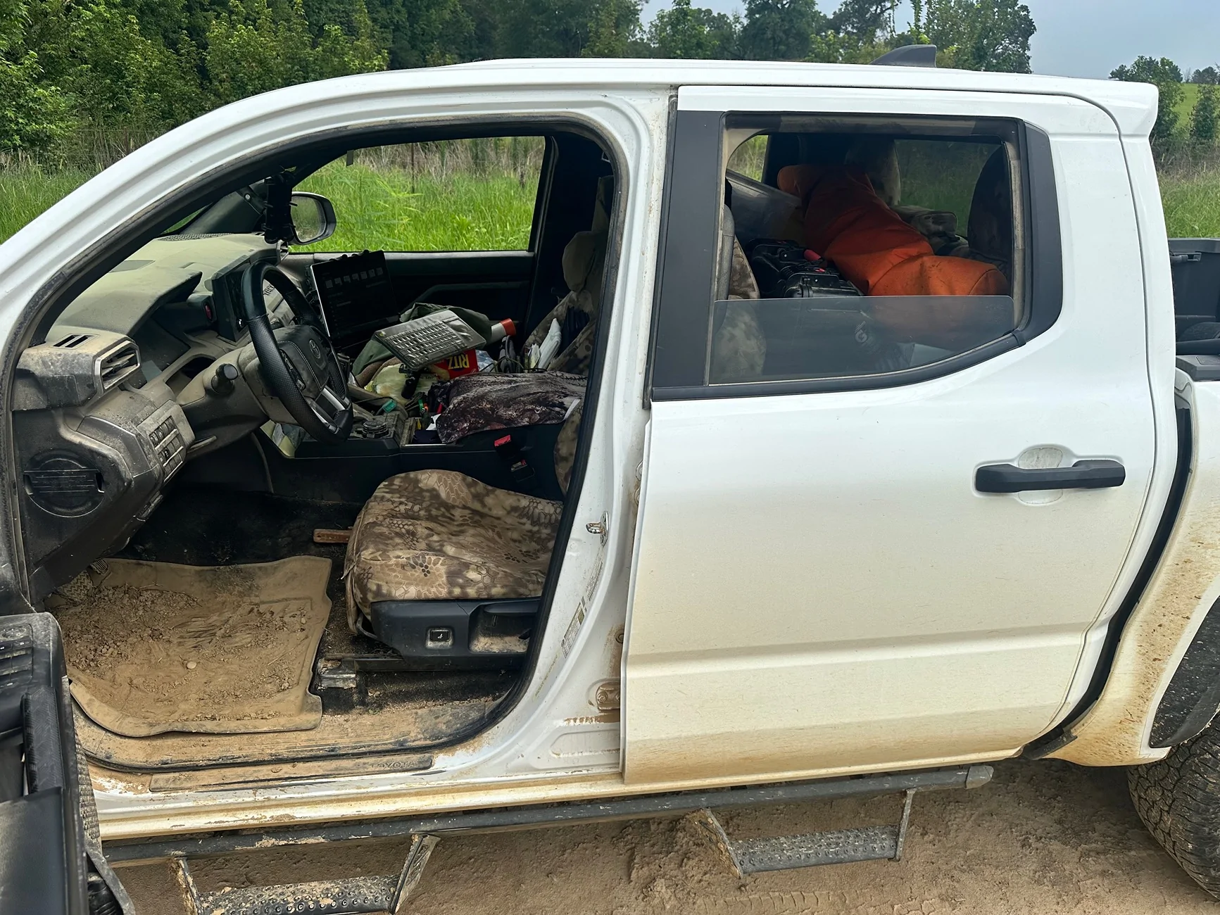

Mine gets terrible from time to time. Driver rear door much worse than others, driver door no.2, hardly an issue with the other 2.
I keep dry lube in aerosol with me always, I work in very dusty environment, no grease or oil on anything. (Tailgate latch is worse than the Gen 2 and Gen 3). I spray the retainer bar, sound goes away for a few days, comes back.
How would tightening the door hinges help?
The 10mm (I believe that's the size) hinge bolts come loose and the door will make that exact sound. Common issue. Tighten the bolts. If they aren't loose and it doesn't fix it then try lubricating the retainer bar.
I didn’t spray for 3 days to show what mine is like.

24 Tacoma TRD OR, 14 FJC
There is no way you could see my rear seats to know their condition. Ha
