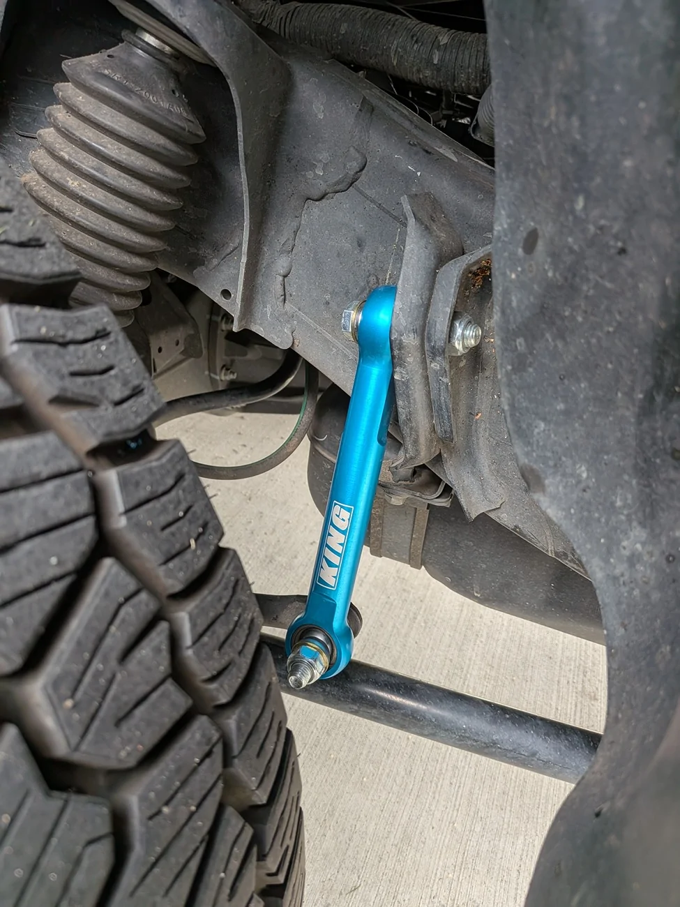

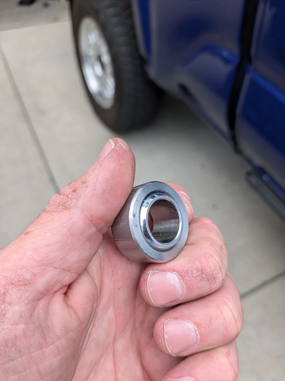

Got some King extended end links because they are highly regarded, but within 1500 miles a com10 bearing went out and it was insanely creaky.
2024 Tacoma Long term solutions for noisy aftermarket suspension components ? 3613
Replaced that and the creaking is gone, but I do get a lot of squeaks with suspension movement from the end links.
When I was getting a bearing through the warranty process one of the many comments from King was "Buy race parts, get race noises." So this leads me to believe it's par for the course with these types of components. I've read on some other forums that folks end up replacing these bearings fairly regularly on their aftermarket shocks and struts as well.
I've tried graphite lube and it works, but not for long. Any other solutions ? Or is this just how it is with these types of suspension components ? What's your experience been ?
