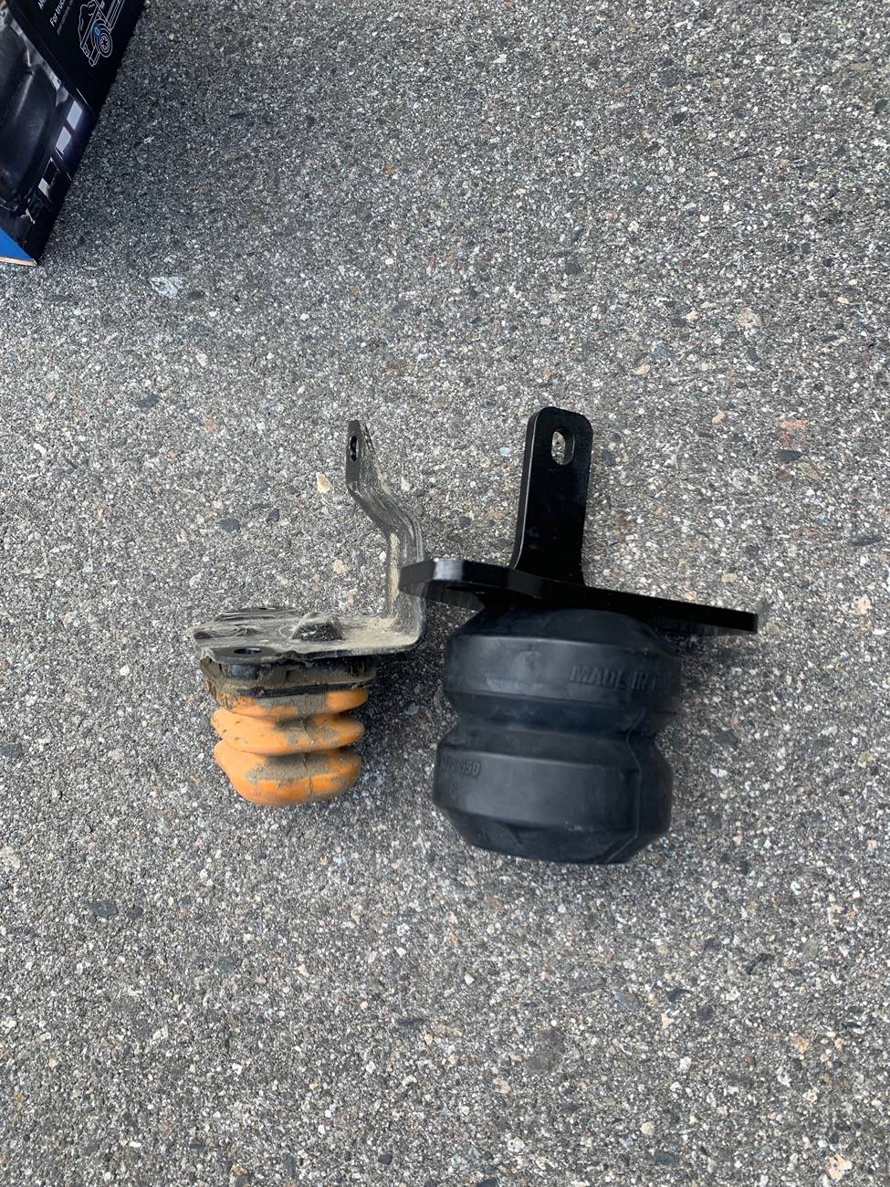

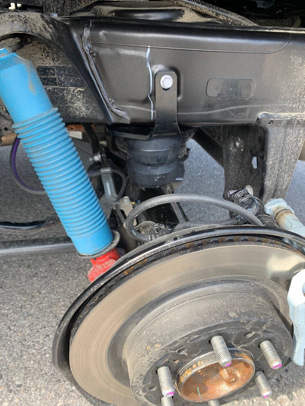

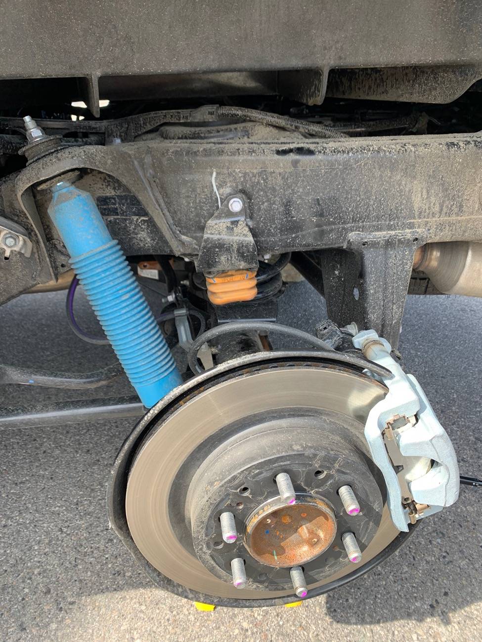

installed the Timbren rear bump stops today. Fairly easy install, need to jack up on the axle and remove wheel to access and replace OEM bump stops, using the same bolts
How much space between the Timbren and axle ?

I towed 5200 lb with 500 on the tongue and still had 1.75 inch before the Timbens contacted the axle.
I did not use the metal spacers that came with the Timbrens which lengthen them but shorten the suspension travel. They came with 2x 3/8 spaces for each side.

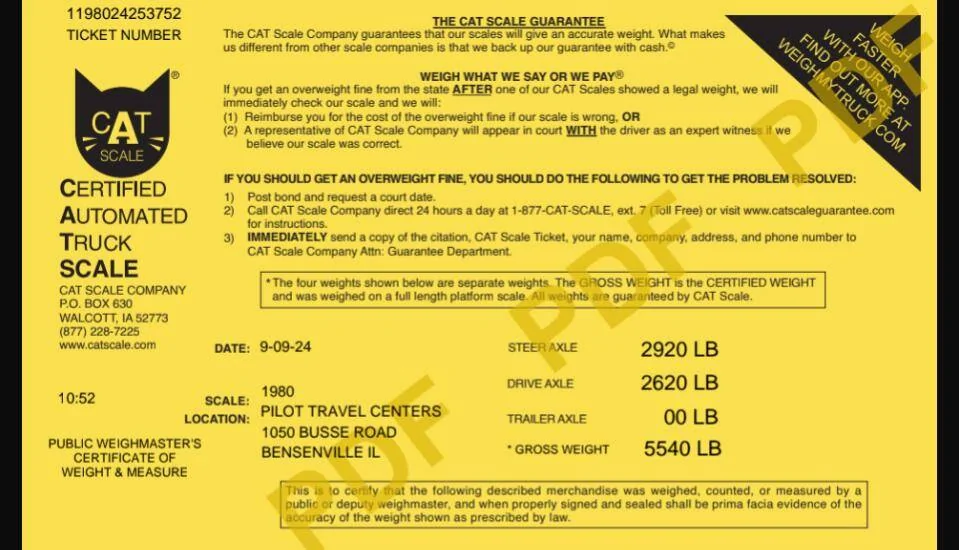

With the truck loaded with gear, it sits with about .25-.5" of clearance. That was with approximately 825lbs of cargo, gear, myself, & aftermarket stuff. Decided to run it on the scale just to verify everything as I'll be adding another 500lbs of tongue weight, 120lb passenger, and 80lbs of WDH. That'll put me at around 6240 GVW, about 65lbs short of GVWR. Little closer than I'd like, but still under with the added protection of the Timbren setup.
Should give these Timbrens a pretty good run for their money. My guess is with the tongue weight on the truck the Timbrens will ride the frame the whole 2600 mile trip from Chicago to Utah.
2024 Tacoma Upgraded Suspension for excess load Screenshot_20240909-171525
All loaded with gear. Normally wouldn't carry this much on the truck itself, but we have about 6 family members that opted to fly rather than drive, and were the ones stuck hauling their stuff.
