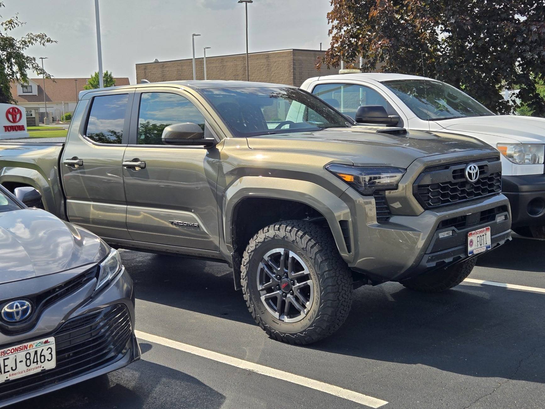

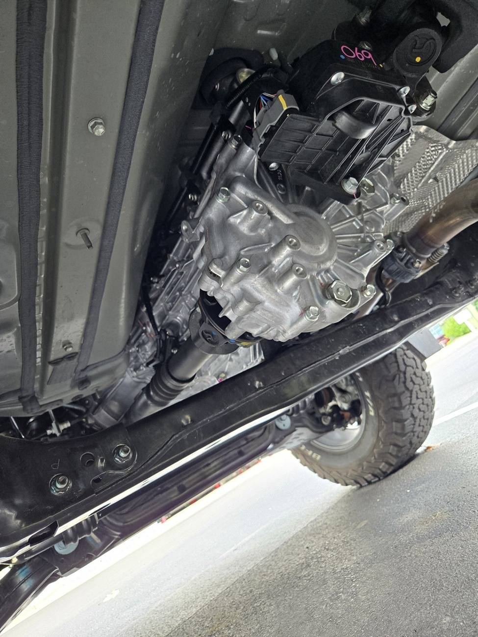

My truck has been dropped off at the dealer. It took him about a minute to verify the condition. They will order a new manual gearbox Friday.
Good news it is the same Master Tech that worked on my 05 X-Runner back in the day. He is the top rated (longest tenured and most trained) Master Tech in the Chicago Region.
He was looking forward to working on my truck because this dealer has not seen the manual gearbox Tacoma. In other words, I can rest knowing it will be done properly.
