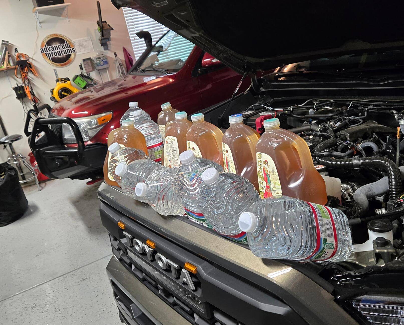

I ran a little experiment. Not 100% accurate because the weight would be at the end of the frame rails which would apply more down force
8 gallons of water and 6 gallons of Tea (Ran out of water). Assume each is 8.3 lbs = 116 lbs
The droop in the front was about .25"
This simulates a bumper and winch minus the crash bar
Pike Bumper (81 lbs) + Warn VR EVO 10-S Winch (70lbs)- Bumper Removal (40 lbs)= 111 lbs net weight gain - weights from RCI website for bumper and winch
The Badlands 12K winch is 67lbs per Harbor freights web site
Bumper removal is crash bar, the dodad ?? in front of it and the bottom plastic peice. I guessed 30-40 lbs and using 35 until I have a better number
Edit: Toyotimothy confirmed 40 lbs from his crash bar.
Note that I have the AllDogs springs which are supposed to be slightly stiffer than stock (Verbal from AllDogs)
This was one of my concerns with adding a winch having just upgraded my springs. This rough test is sufficient for me to show a winch on the heaviest bumper I am considering isnt an issue. Lighter bumper would be even less.

Now you just need to take those jugs for a ride to see how the front end handling is affected. LOL ? What could go wrong!
Pike Bumper (81 lbs) + Warn VR EVO 10-S Winch (70lbs)- Bumper Removal (35lbs??)= 116 lbs net weight gain - weights from RCI website for bumper and winch
I weighed the crash bar that I took off mine. Approximately 40 lbs give or take a little. So good guess. My pike 81 lbs and x bull winch approximately 59 lbs 140 total? I guess I didn’t think about the weight from the crash bar. I ended up only adding about a hundred pounds. I ordered Dobinson c59-822 front coil springs for a 2” lift but I was basing it on the 140 lbs. Do you think I should have taken a different route? I don’t want a stiff ride.
