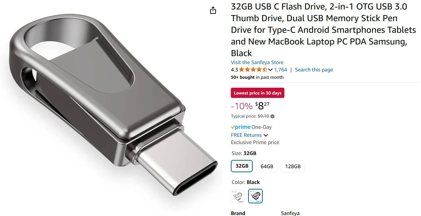

I bought a couple of different USB flash drives over a few weeks. None worked. Large capacity, small capacity, high speed, etc . . .
Finally, I just bought an assortment of cheap thumb drives and tried them. They all effin worked, sheesh. I don't think that there is a way to predict which will work, and which won't.

FWIW, I bought a batch of little right angle USB-C to USB adapters so that I could use a "regular" USB thumb drive (much cheaper and easier to find) with the added benefit of it hanging down the side of the display rather than sticking out of the side.
