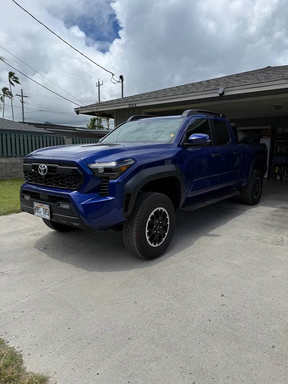

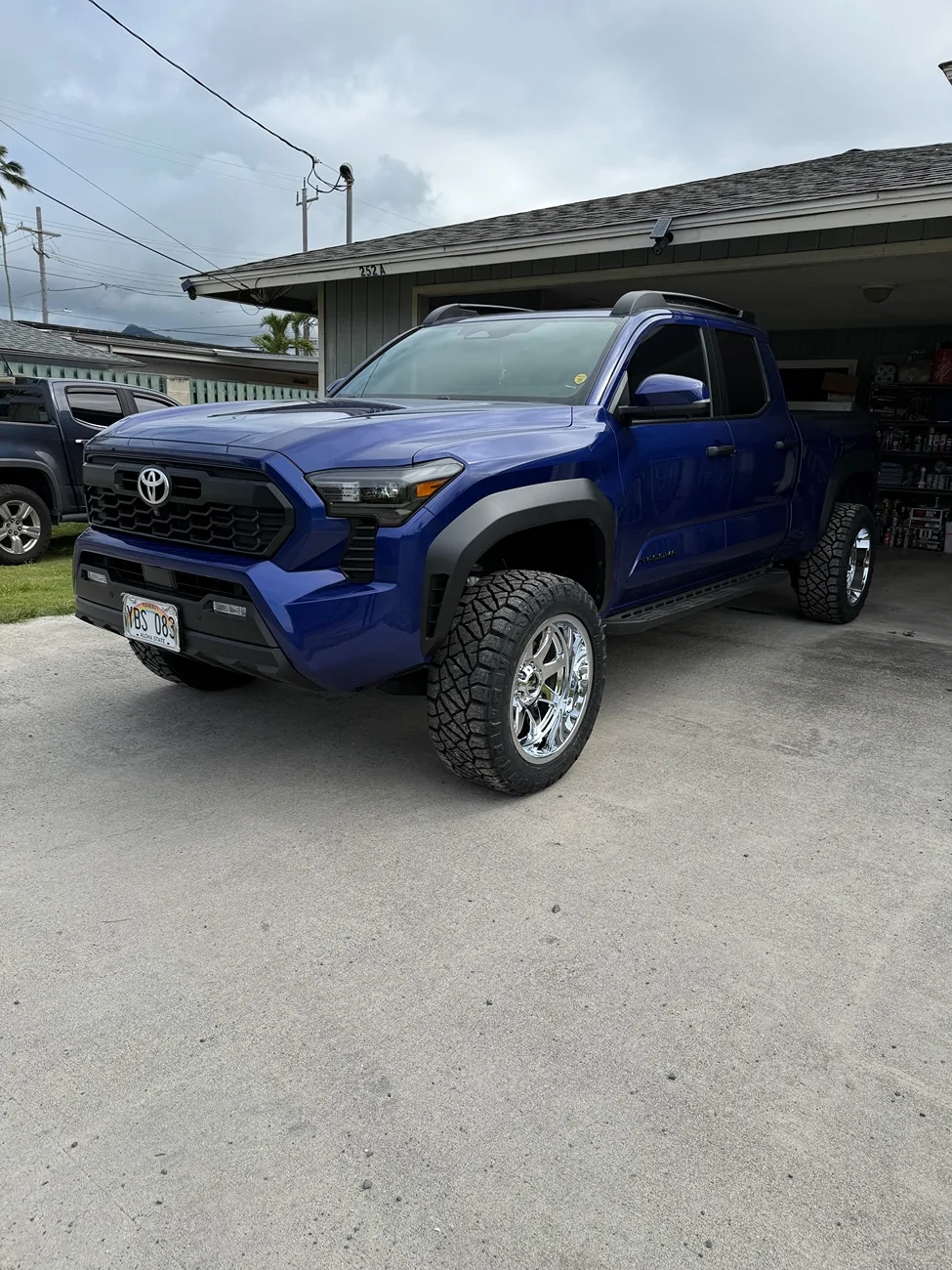

I may have went a different route than most people. For suspension I went with the Eibach Stage 2R with the Eibach HD rear springs. I currently have it adjusted so that the there is still a slight rake. Now for the wheels and tires I went with 20x10 -18mm Fuel Hammers in Chrome with LT275/55R20 Nitto Ridge Grapplers. For the most part there is no rubbing unless I’m in reverse at full crank while the wheels are articulated. I didn’t trim anything or remove the front crash bracket so with how little it rubs, I’ll live with that. In terms of ride and how quiet it drives, I find that the Eibachs seem the ride smoother than the stock Bilsteins and no longer does it feel like it bottoms out everytime I go over a speed bump, plus I no longer have to worry about the front shock bump stop issue some people were having. The tires I find to be fairly quiet for how aggressive they are and ride very smooth on the road while having better traction in the mud compared to the stock BFGoodrich’s. Funny enough with how wide the wheels are I don’t seem to feel any difference in the turning radius and don’t seem to be getting anymore rock chips than I was getting with the stock wheels.
