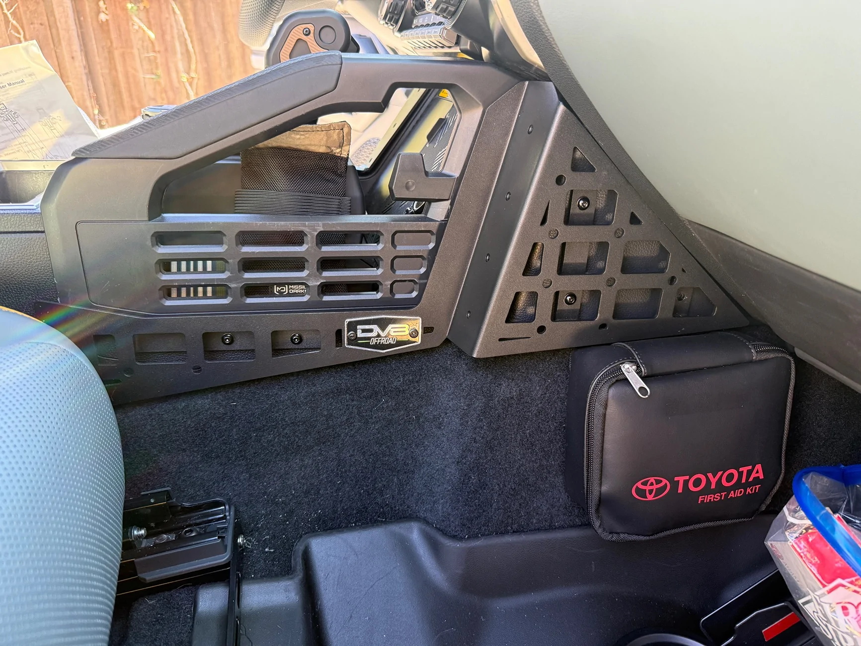

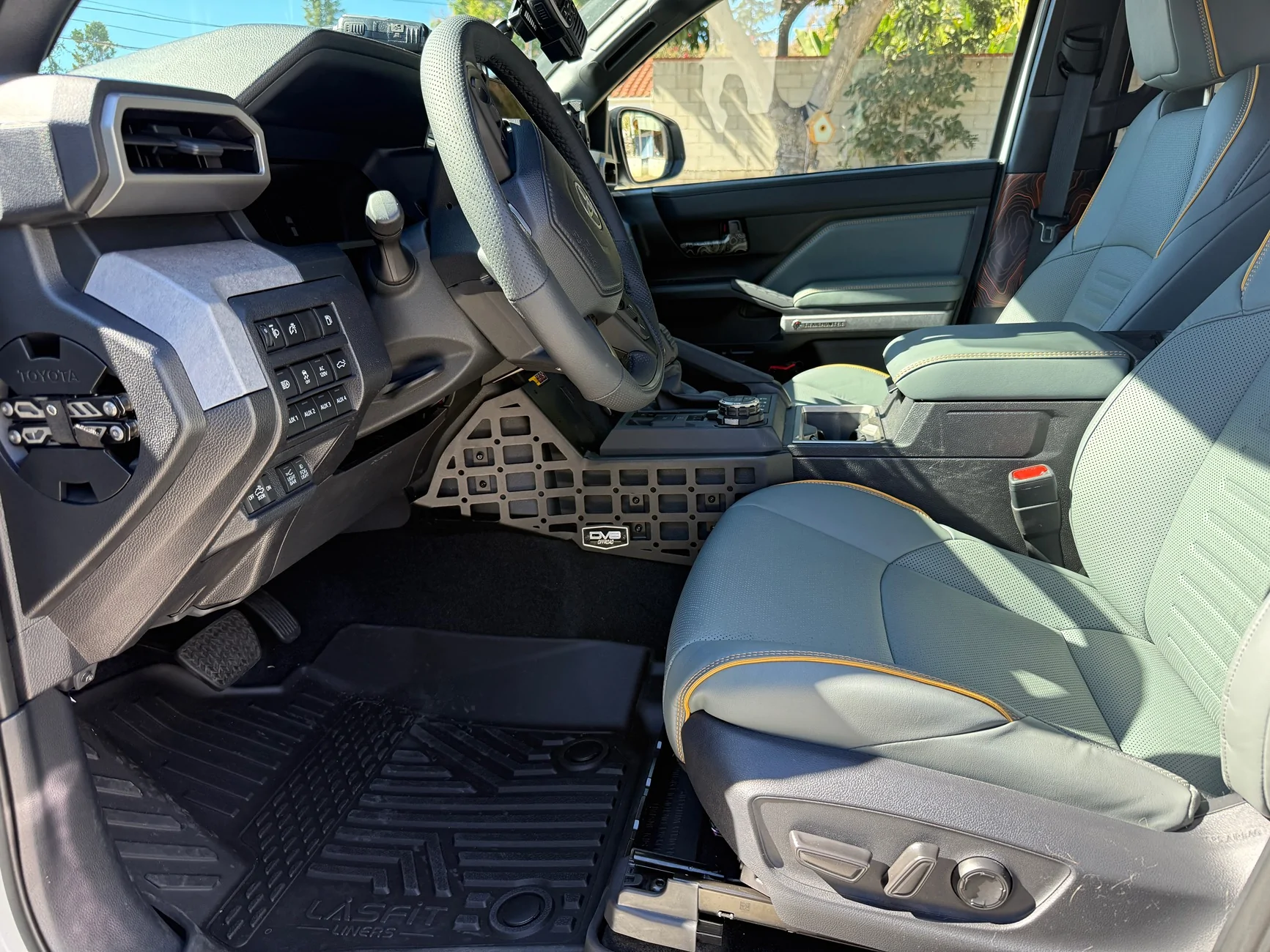

One of the first things ordered for the truck were molle panels that install along the center console, made by DV8 Offroad.

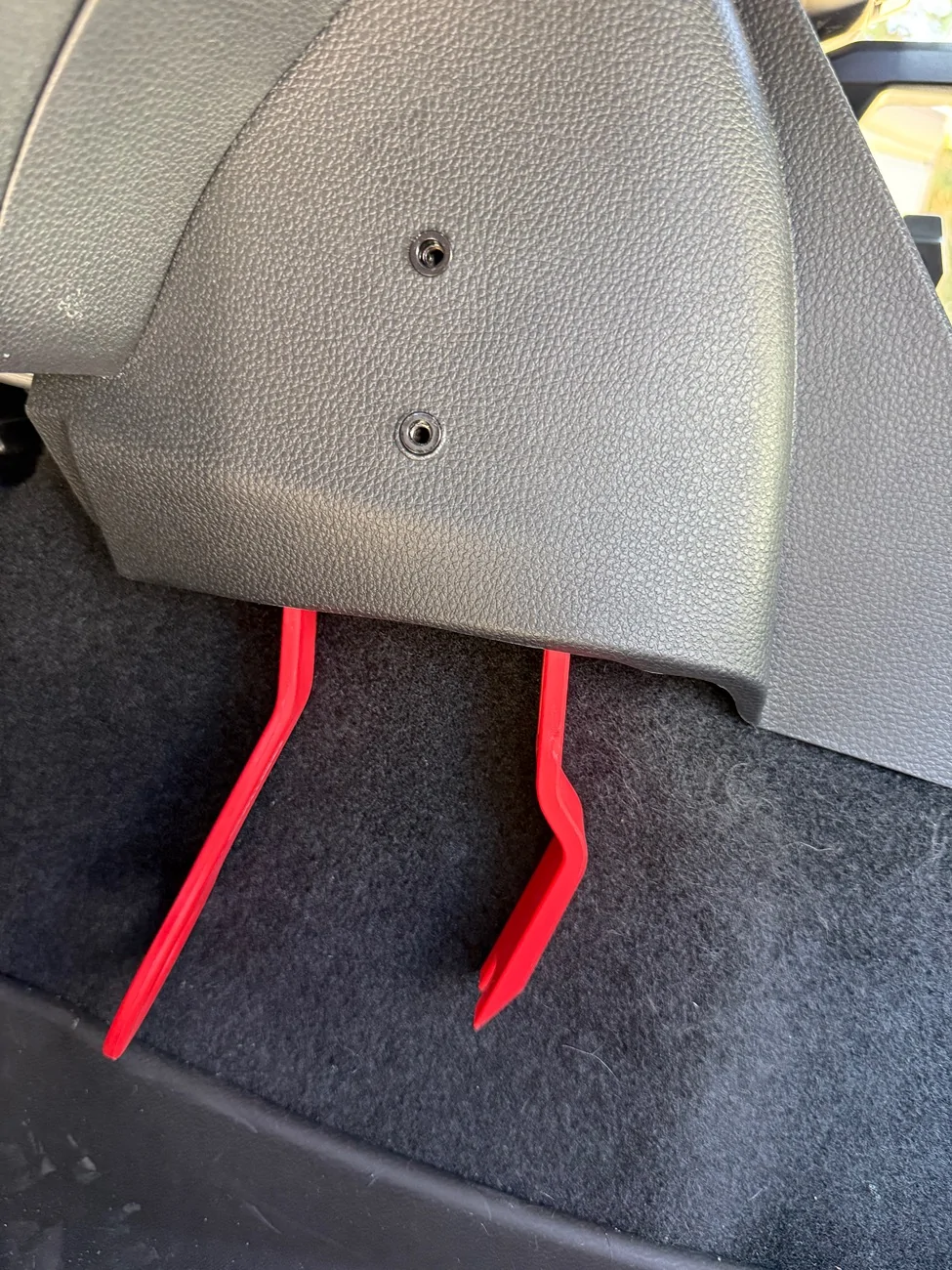

I’d rate my installation as partially successful. Two forward mount points on the driver side are too shallow for the M5 rivet sleeves to sink in fully. I tried to fix the problem by getting underneath the console plastic and using trim tools as temporary spacers. It worked on the lower hole. Glad we had a rivnut toolset, used on another project.
There are more mount points on the top of the console on each side, but I’m hesitant to drill there. I’ll see if we get some rattling if so, I will still try to figure out a way to shore things up without more drilling. The install requires 1/4” holes to seat the M5 rivets.
Here’s a few shots of the progress….hope everyone is having a good afternoon.
