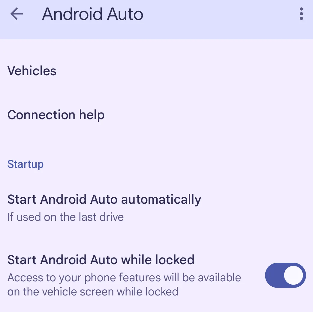

Is this option enabled? I have no problems connecting........
Yes! It is.
I'm not sure what the issue is, but have heard a lot of folks complain about connectivity issues with Android Auto/ carplay.
I could try resetting everything I suppose

Roger that, BTW, I'm on a P10 as well. How about this setting on the BT, seems counterintuitive, but I seem to recall it helped.
Thanks dude! All of those are turned on as well.
I'll try to clear the profiles and pairings and repair. Maybe that will do it. Would be really nice if it just paired right up Everytime. Nice to hear yours does without unlocking the screen. And here I thought I was saving the android world with my old man trick of unlocking the screen 😂

Ok. 100% solved now.
Went in, deleted pairing from Toyota, forgot pairing from phone, repaired, added it as preferred decide on my Toyota profile, checked the settings you sent, now it works locked!
Just thought I was gonna have to live that way with the manual pairing every single drive 😂 Guess I aged at some point
