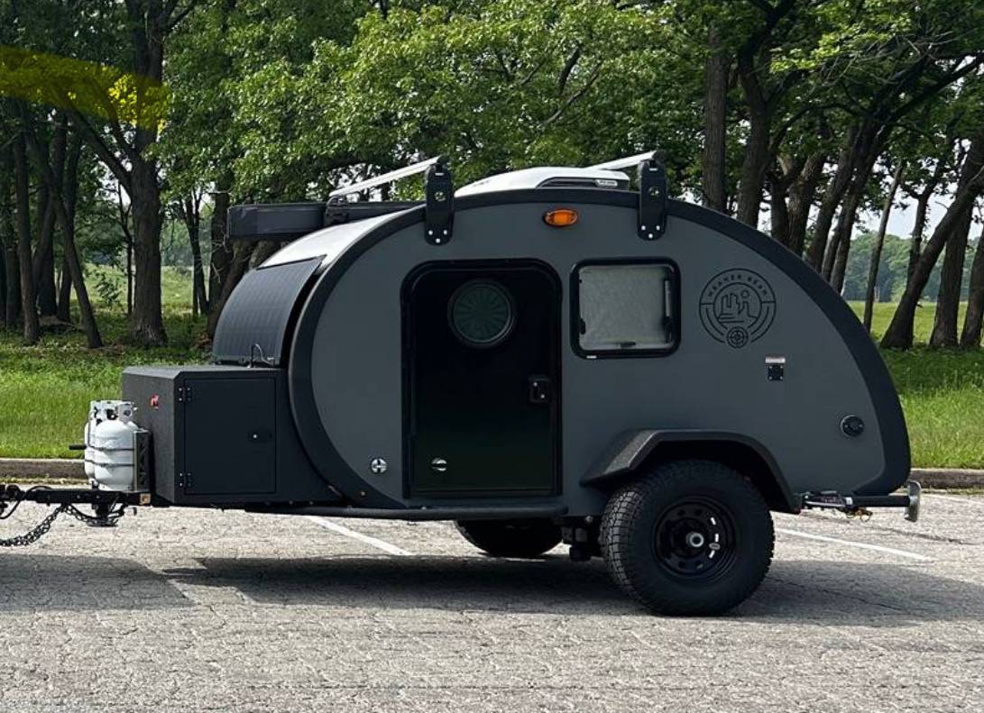

I need advice on how to best fix the squat. Thank you!

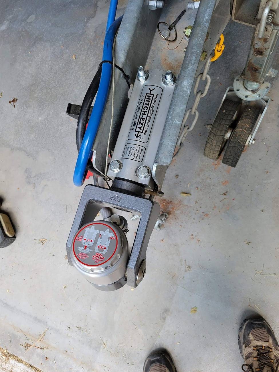

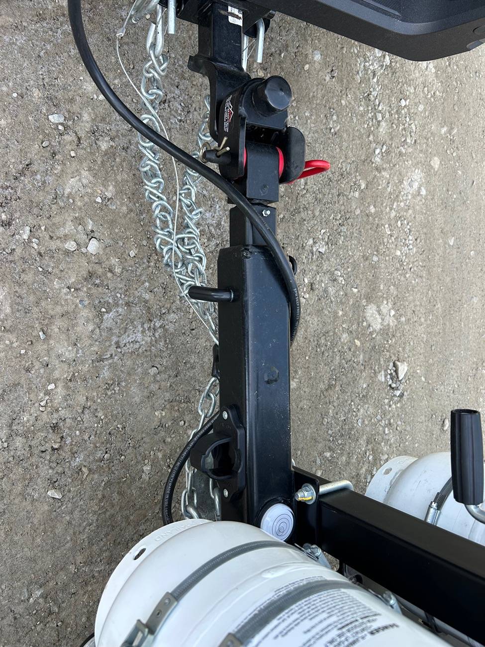

I would rather go with the air bags due to my articulating hitch…see pic. What air bags due you recommend? I was looking at the system from rough country.

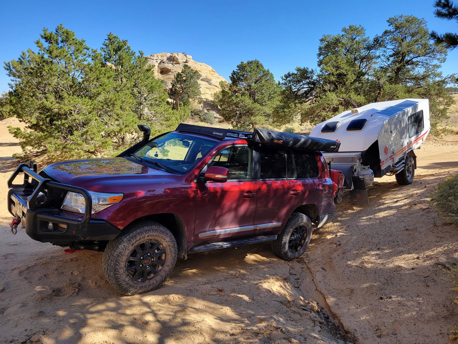

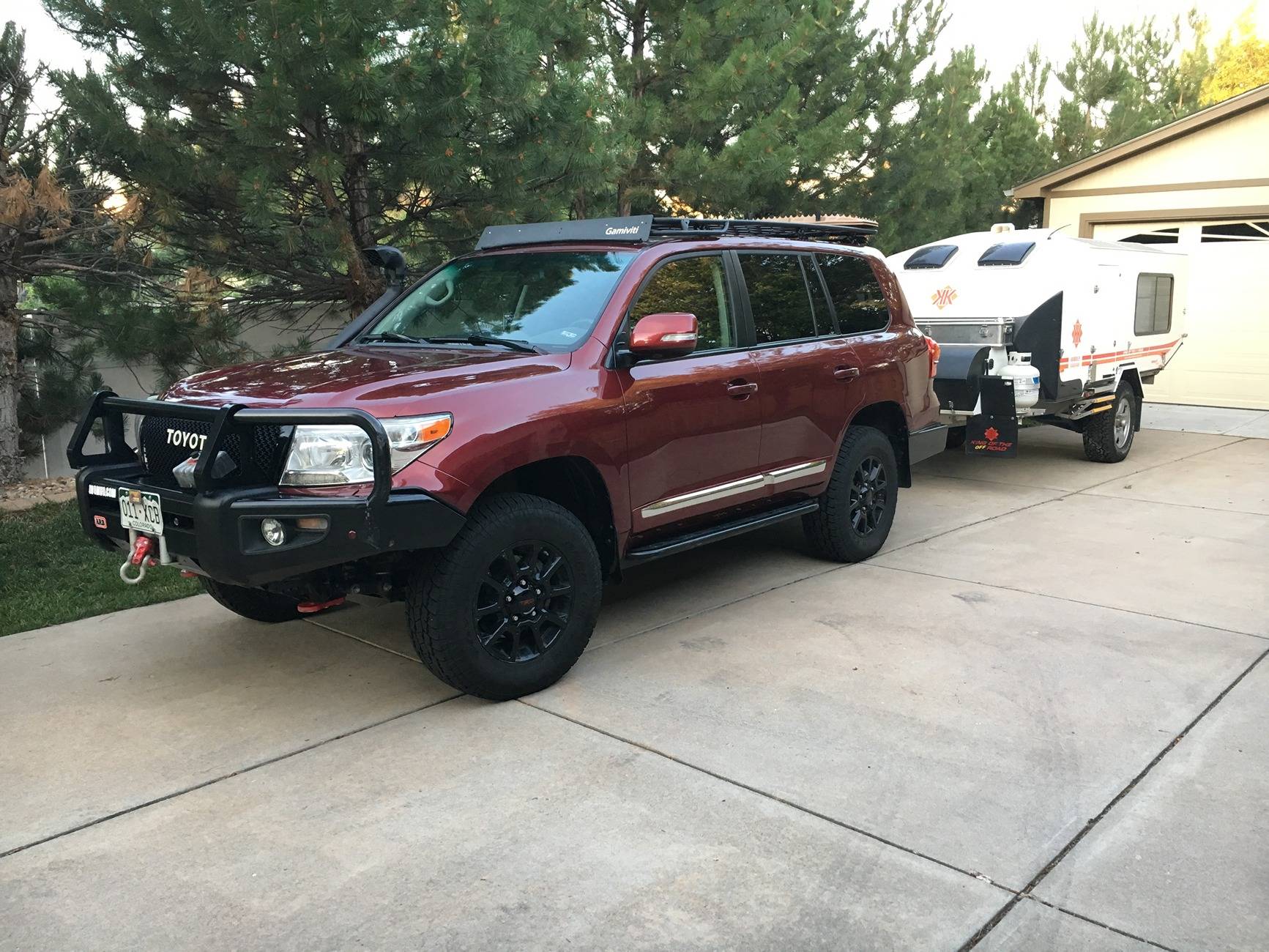

when I had that on my Land Cruiser, I went to different springs on the rear. I think that is easier than airbags. My camper is about 4800 pounds fully loaded
I have an articulating off road hitch that wont allow the use of the weight distribution hitch

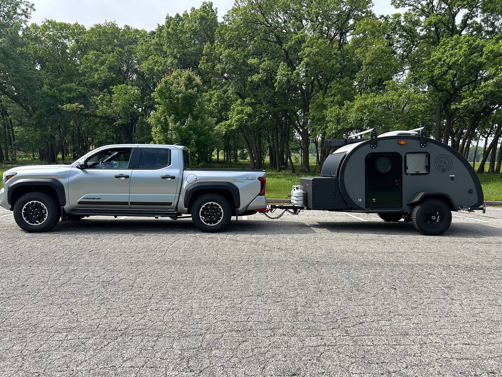

Man, that sags worse than my 4Runner, and I have a trailer very similar to your Bean. That’s the nature of coil springs, though.
Yes! My truck bed has items in there too. So, between that weight and the tongue weight there is a lot of sag and bottoming out on my trip. I knew there would be some due to the nature of the cool springs, but not this much.
