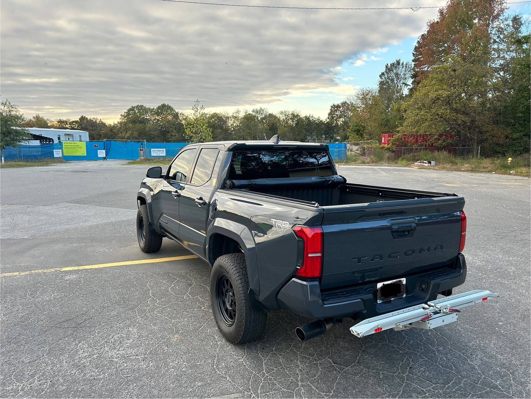

The trail terrain is a great tire for most people. It’s light, quiet, soft and rides better than AT tires. I don’t do any off-roading but I’ve had it down a few muddy dirt roads where it did fine.

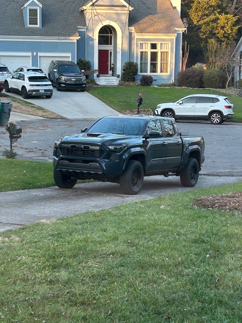

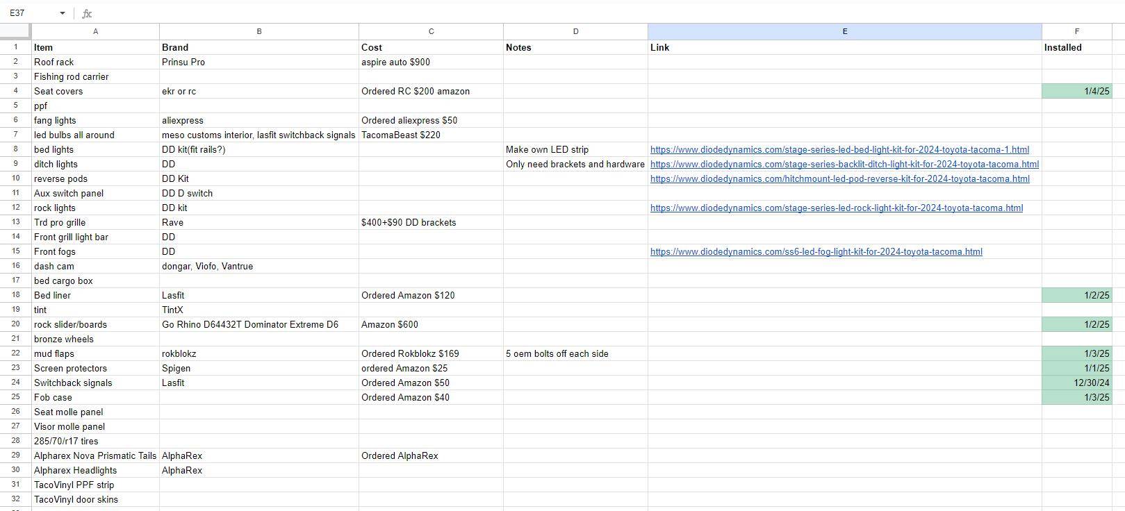

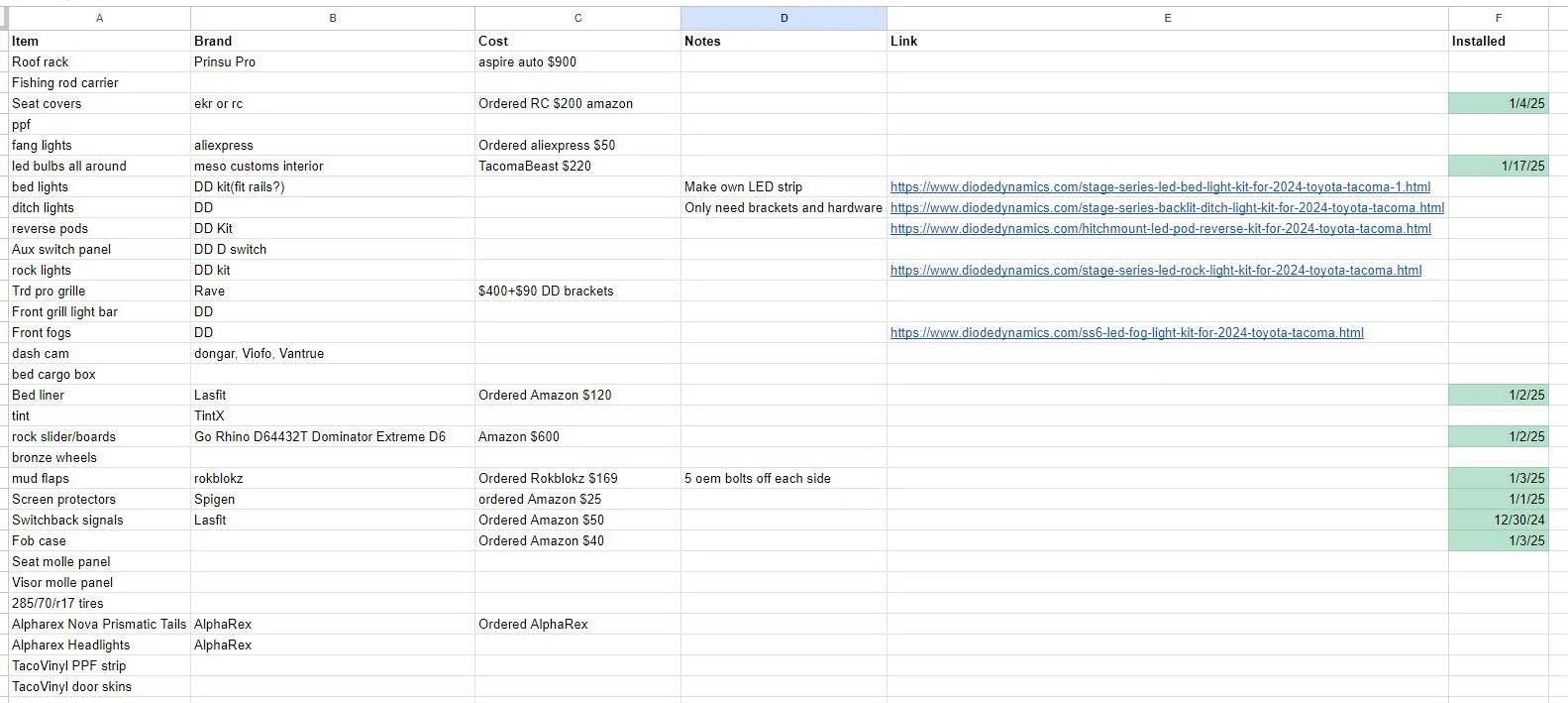

Trust me, wheels and tires is no where near my first thing ive changed. Its been 3 weeks of ownership and im about 8 modifications in, just now finally getting to wanting to change the appearance with the wheels and tire combo.
I took them out for the first time in our snow we just had of about 5 inches. They seemed to behave fine for what they are. However just from feel, my bridgestone blizzaks on the Explorer felt 1000x better then these did on this vehicle. One thing I dont like about the trail terrains though is they are truely not a snow\3 peak rated tire. Not the OEM ones that come on the truck anyway as they are purposely missing a chunk of the rubber compared to the retail versions that are 3 peak rated. If im getting different wheels anyway, I figured I might as well get a bit more aggressive looking set of rubber that also should perform "better" in these conditions. As of now im leaning towards Falken Wildpeak AT4Ws. I watched a Tire rack video that was recently posted where they went over like 10 tires and did a bunch of tests, rating them all. Interesting watch if not seen already.
