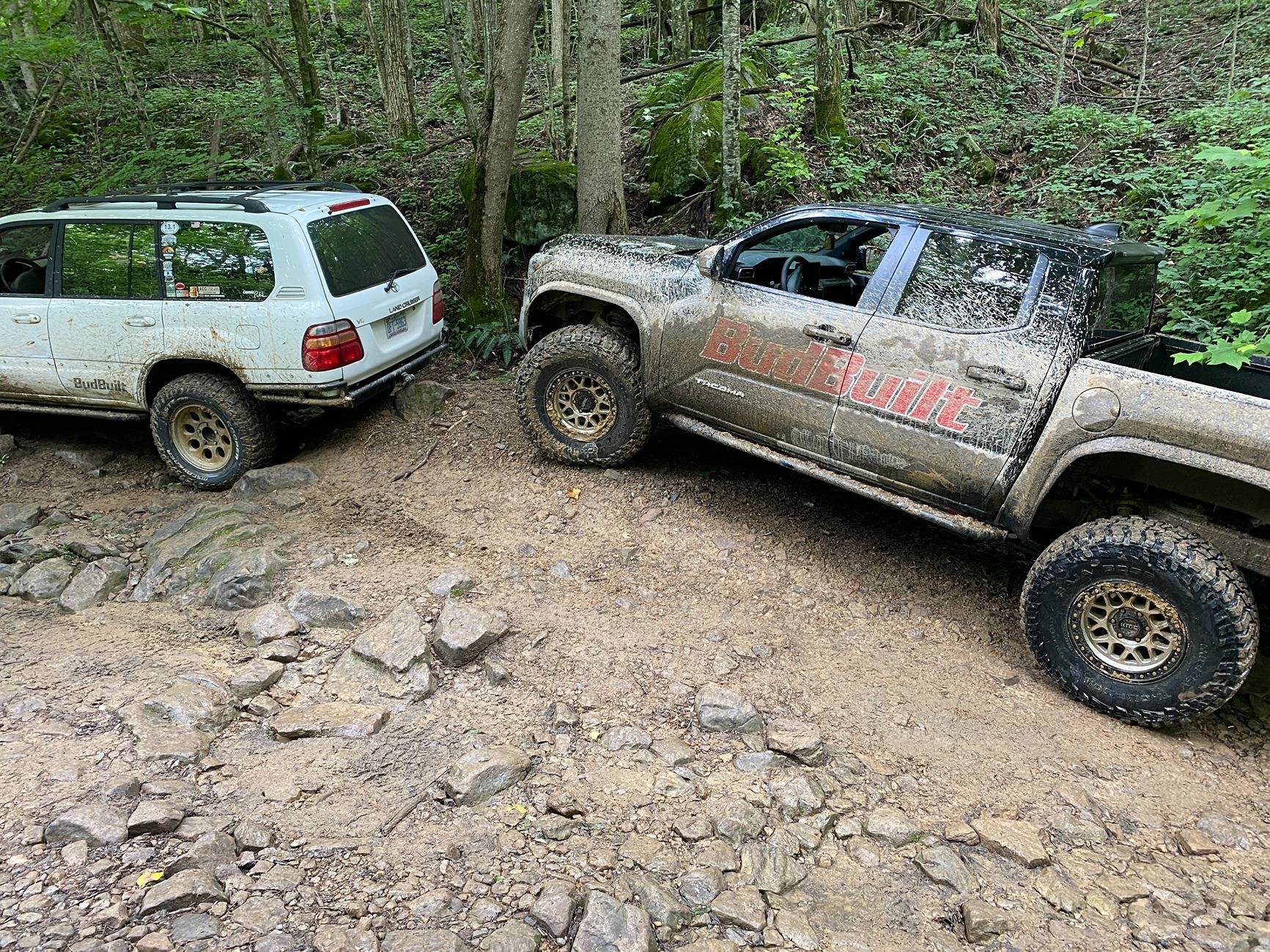

We did ours. I bought the kit to remove the needle bearing and used a socket to install it.
We have Dobinson 2" springs and 37" tires. Works great!
