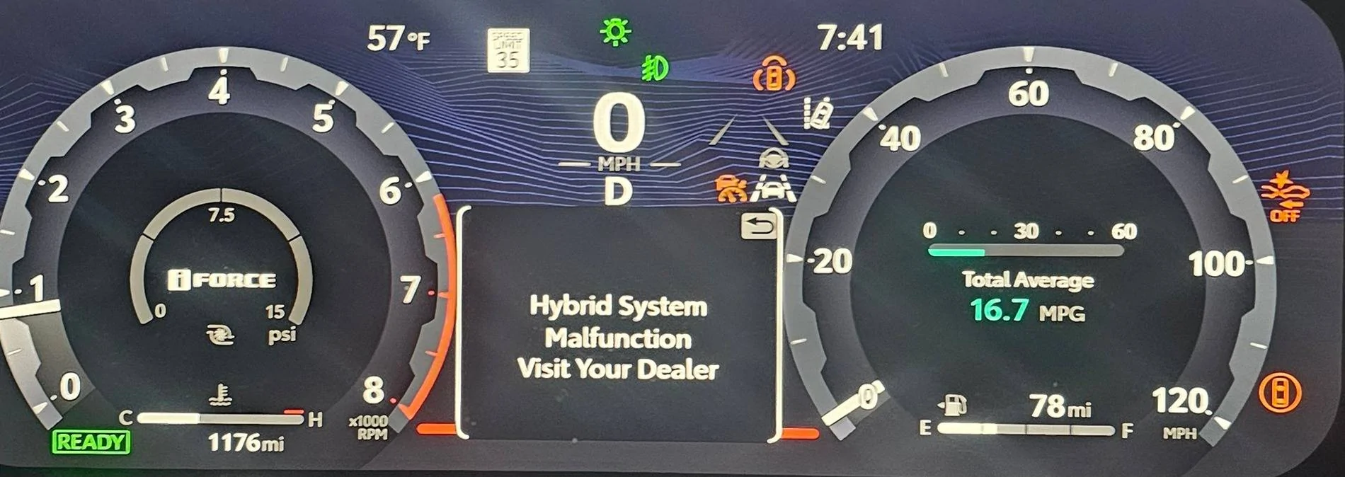

After a couple of visits to the dealership when "Hybrid System Malfunction visit your dealer" popped up on my dash, it looks like I hit the trifecta. Transmission assembly, torque converter and hybrid motor all need to be replaced on my 4 week old 1200 mile Trailhunter. And the cherry on top is the parts are on backorder. Oh - What - A - Feeling !

Dam.. you’re lucky in a way! At least yours failed right away. Were you having weird shifts what were your symptoms?

I really didn't notice any weird up shifts. When I would come to a redlight or stop sign the tranmission sometimes kick down alittle abruptly, but as I was new to the truck I thought it might be was normal.
Other than this recall, the truck has absolutely exceeded my expectations on performance, handling and ride quality. Hopefully Toyota can iron out the kinks in the new Tacoma because they did a fantastic job on the redesign IMO. My dealer has been fantastic, they offered me a loaner until the parts come in and truck is fixed. I declined the loaner as the truck drives fine, other than the occasional pop up message. Plus I own a Bronco Raptor as my other vehicle, which I would prefer to drive over the Rav 4 they had available, lol.

Interesting, so your trans wasn’t even acting up that bad and it through an engine light. Mines been shifting goofy for a while now with 2400 miles and it still has yet to throw a code, makes me think there’s more to this issue that we’re not being told

My truck is just under 700 miles and behaving like yours, including the lower than expected fuel mileage. I think that is another sign that the transmission is on its way out. Yesterday I had that abrupt downshift when stopping and my top fuel mileage so far is 17.3. Like you, I love my truck, but I no longer trust it at all. I just keep hoping I get that message while it is still driveable.
Be aware that even if it is working now, it may stop at any time and any place. Several people have stopped for a red light and when the light changed the truck was dead. So driving your other vehicle is a good call.

Don’t you find it odd that some of these trucks are throwing codes for shift solenoid issues but shift good overall…. Yet some of us are driving trucks that have been acting up pretty bad for 1-3k miles and no codes are thrown ??
