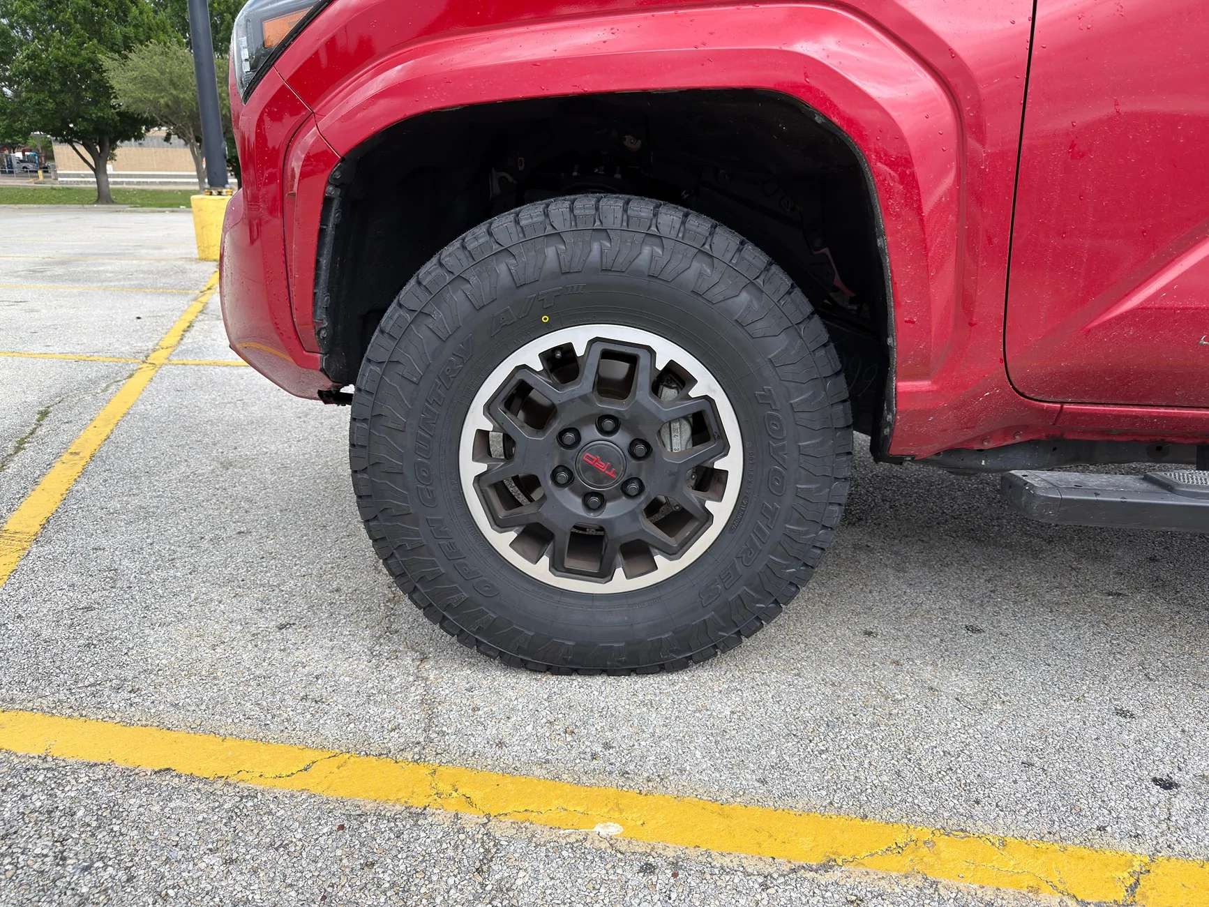

Just wanted to share for anyone looking. While 265/70R17 is a popular tire size, it sure doesn't seem like many buy the c-load Toyos in that size. Most opt for the SLs or the E-loads. I felt like the c-load was a good happy medium between being tougher than stock, good aggressive sidewalls, and taller tread for longer tread life, but without being too harsh of ride quality.
I had the SR/SR5 premium alloy wheels and wasn't a huge fan, so I picked up a set of the 17" TRD OR wheels, and had the LT265/70R17 Toyo ATIIIs mounted and installed this afternoon. Rides and looks great. It actually even makes the work truck base model black bumper caps look good. I thought about going up to LT285/70R17 , but didn't want to hurt my gas mileage too much and also wanted to stay narrower to help with rock chips and such. I'm happy with the decision.

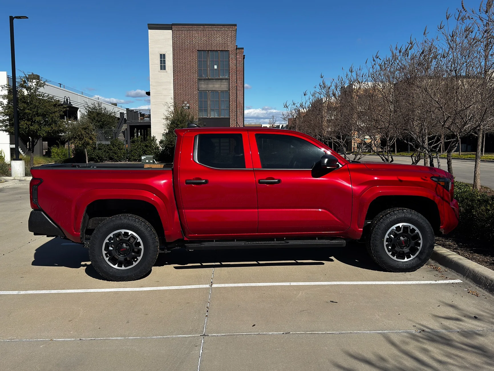

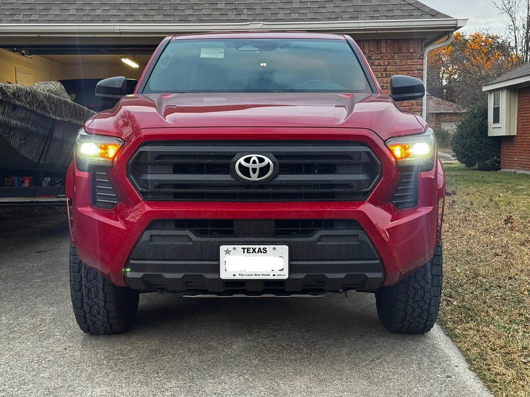

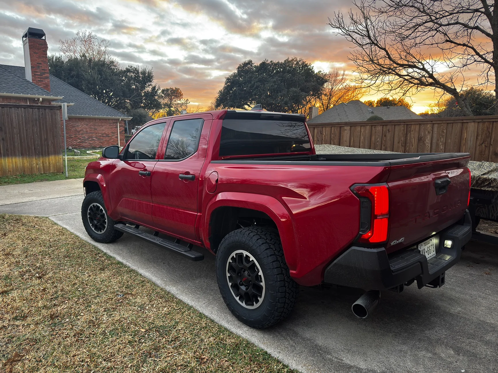

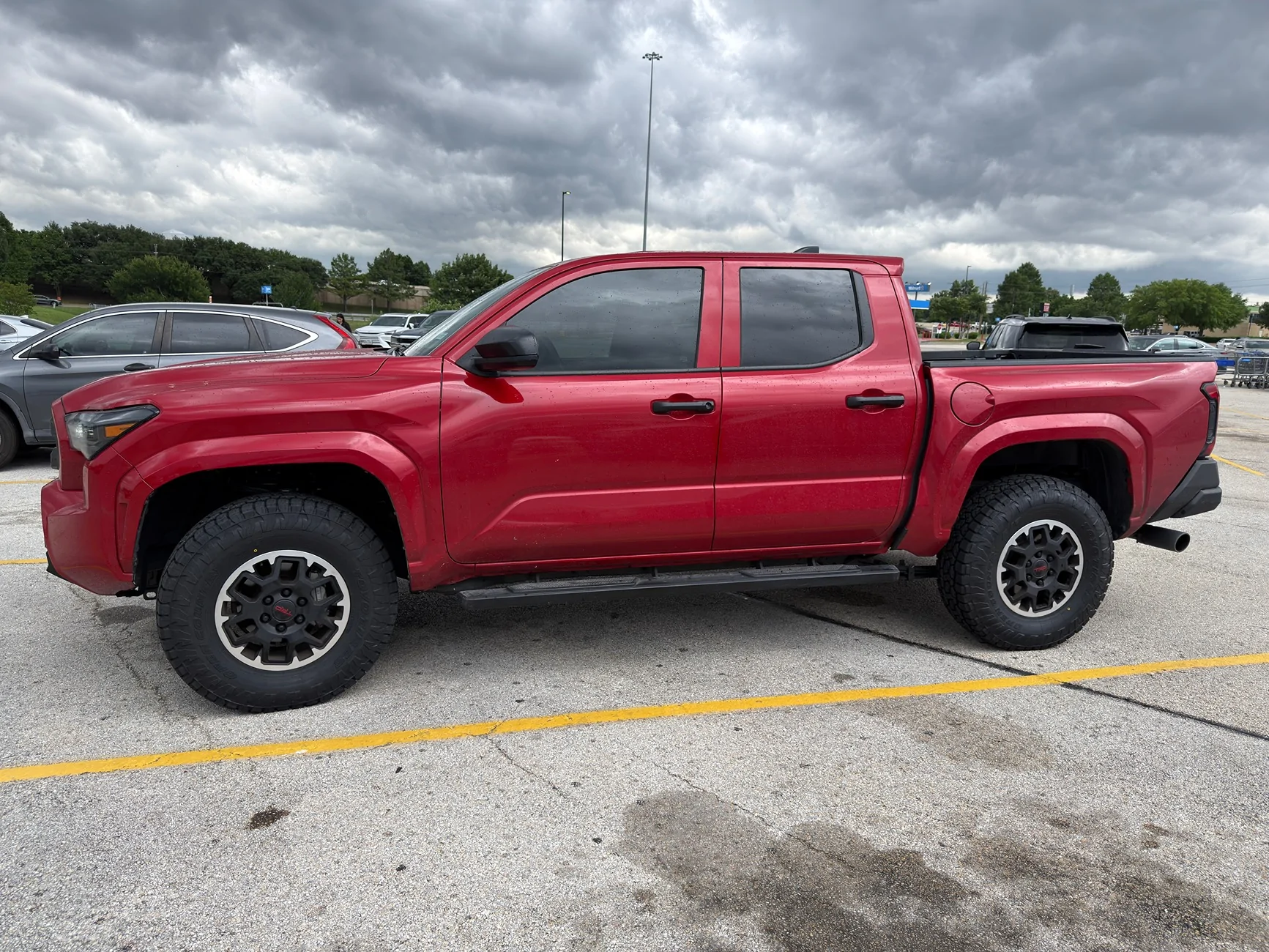

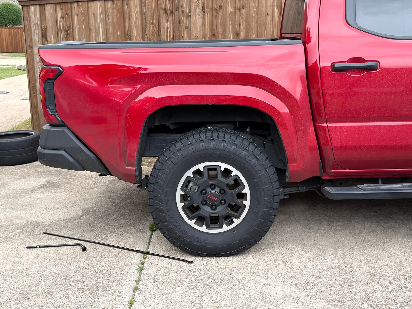

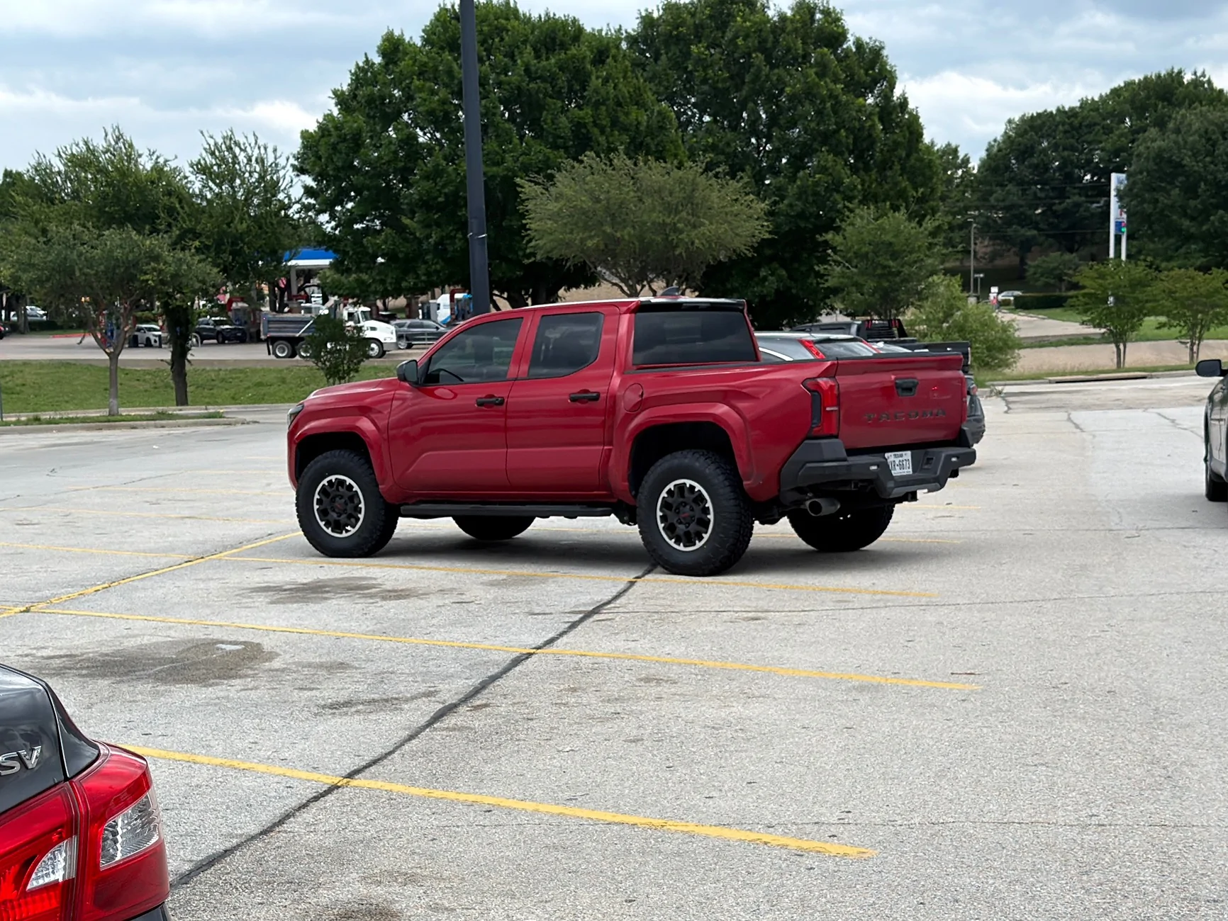

Well, the 34’s are installed. They don’t look that different, but it’s a nice subtle change. Really fills out the wheel wells nicely comparatively. On the truck, the tires don’t even look big, which is crazy to me.
It’s too early to say much about the tires but I do like them off my initial impressions. They handle very nice. Definitely took hits in both the acceleration and ride firmness categories but it’s not too terrible. My eventual 5.29 regear will bring a lot of that back I think. Time will tell on mpg.
Fitment wise, I don’t think there’s a tire out there that fits the truck better than these.
34X10.50R17 on the truck:

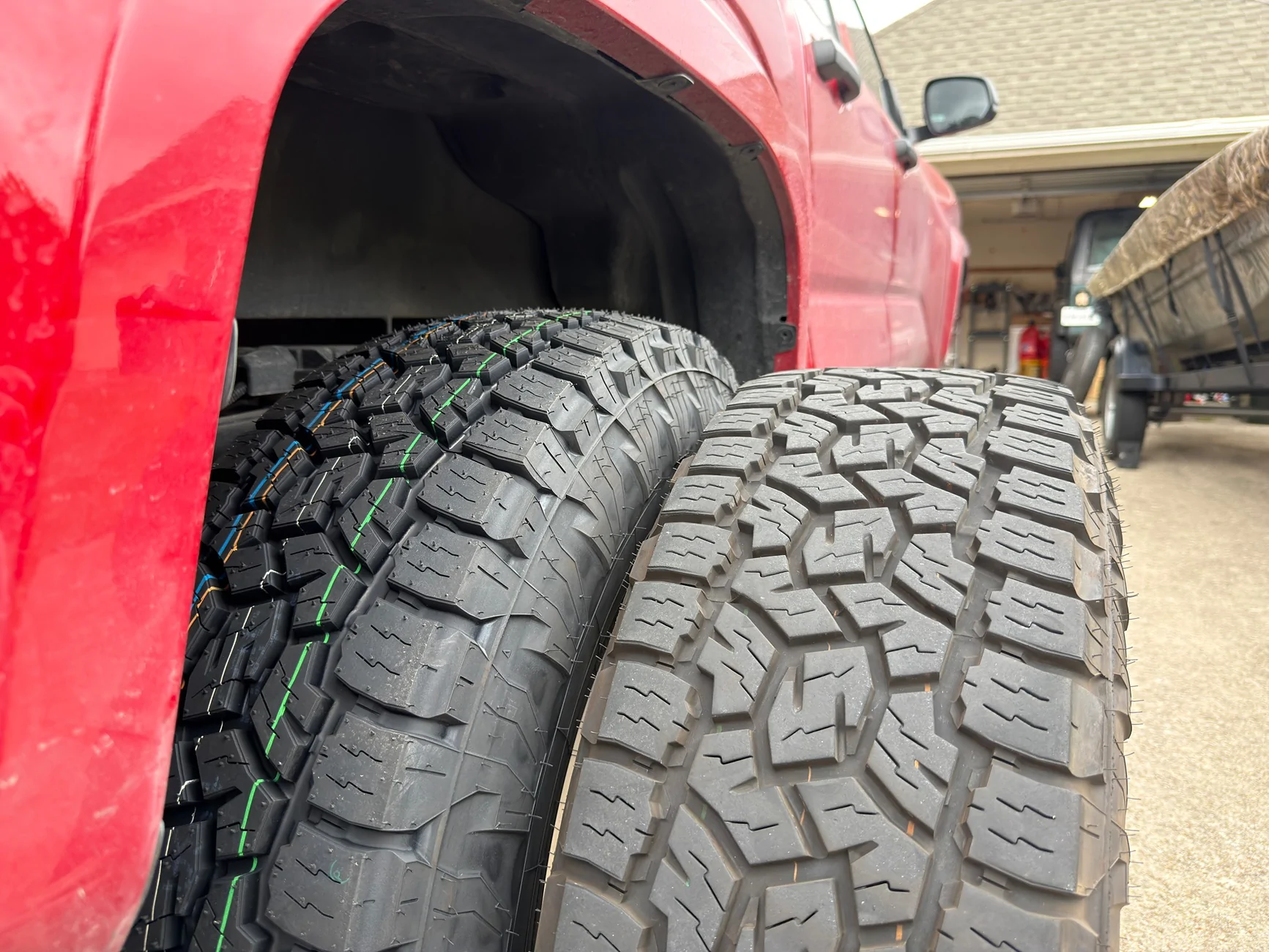

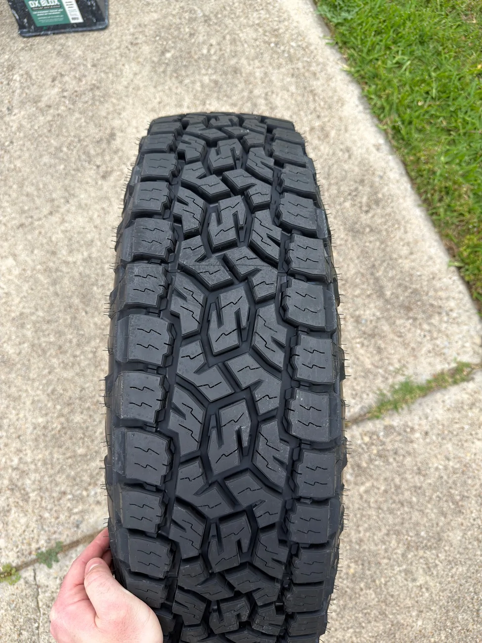

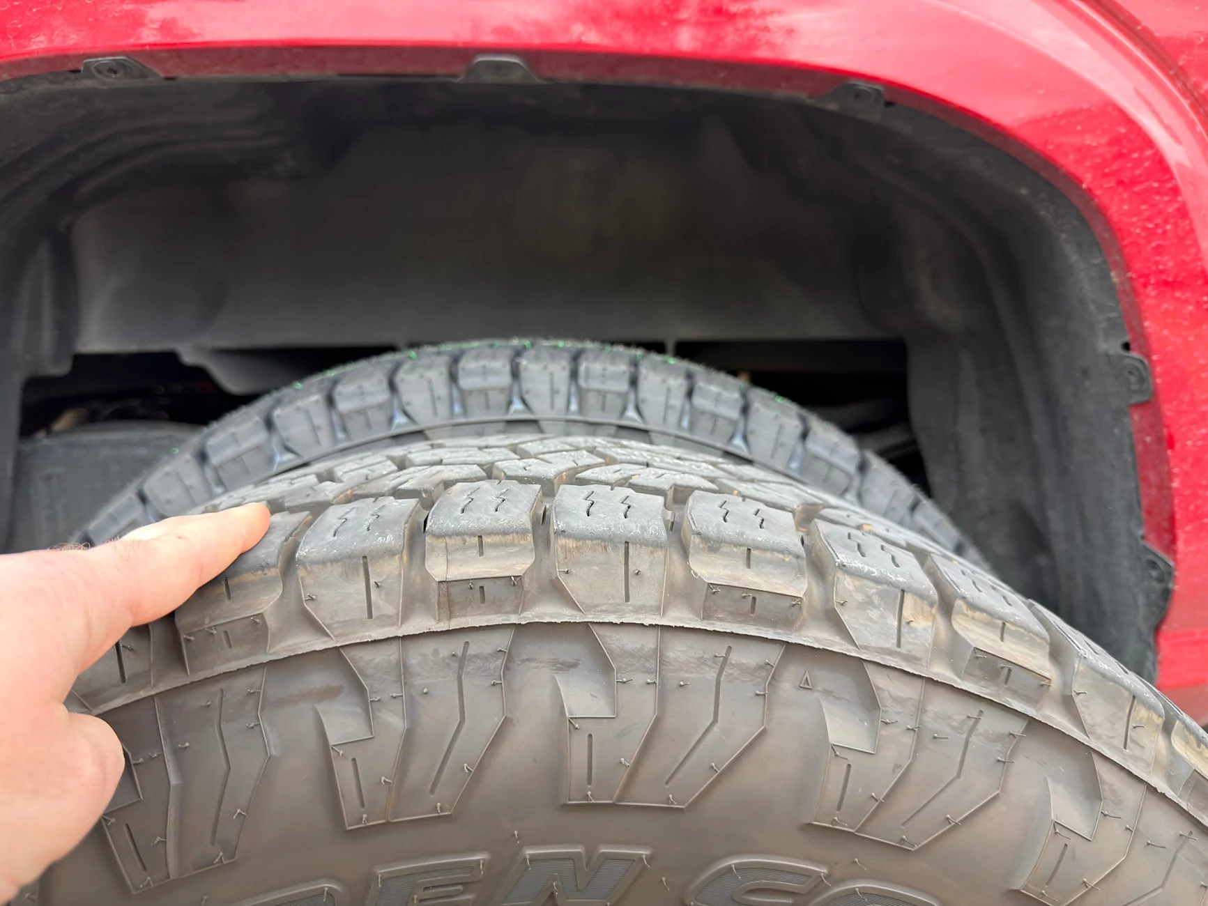

Comparing to the 265s. Keep in mind there is no weight on the 265s:

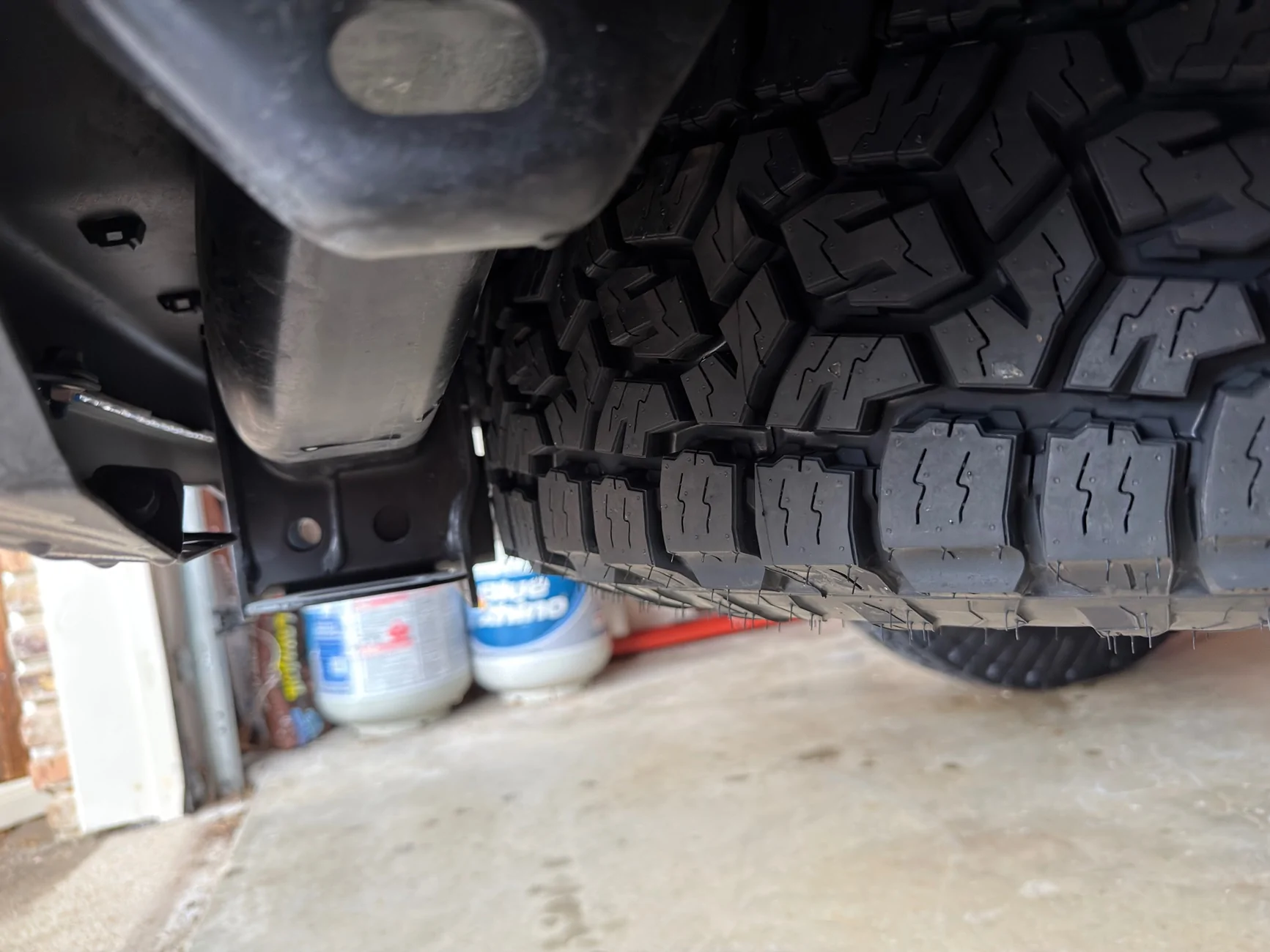

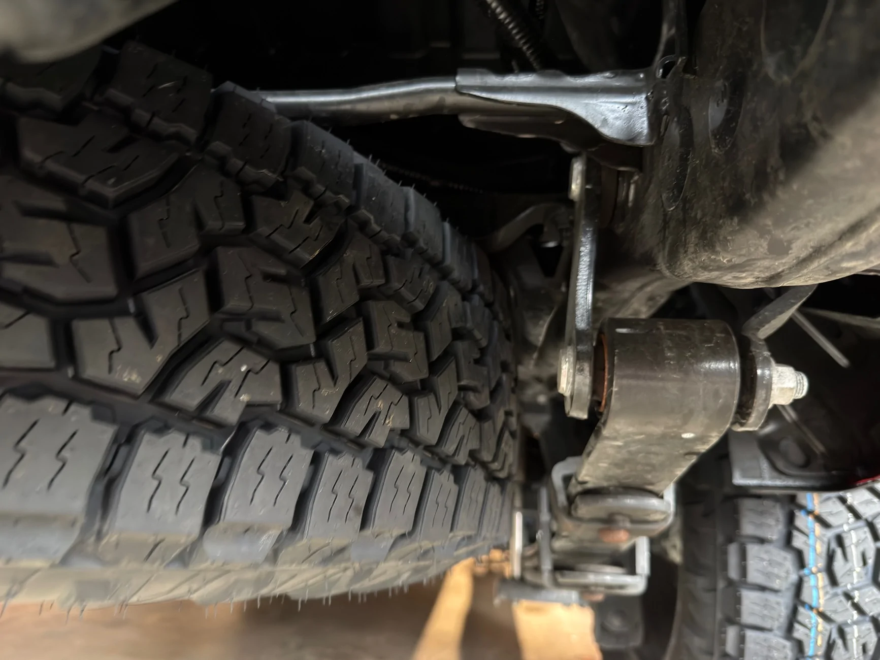

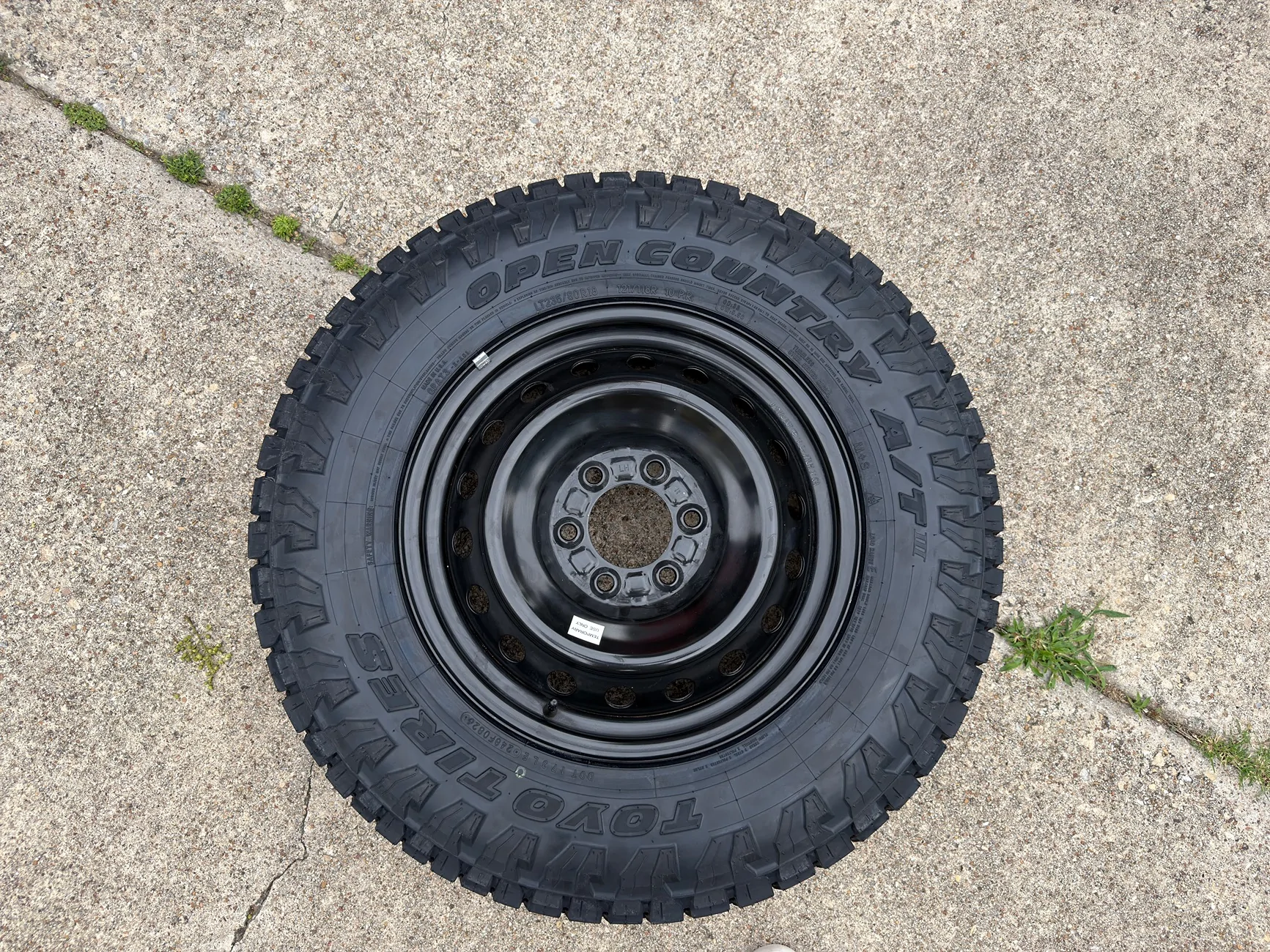

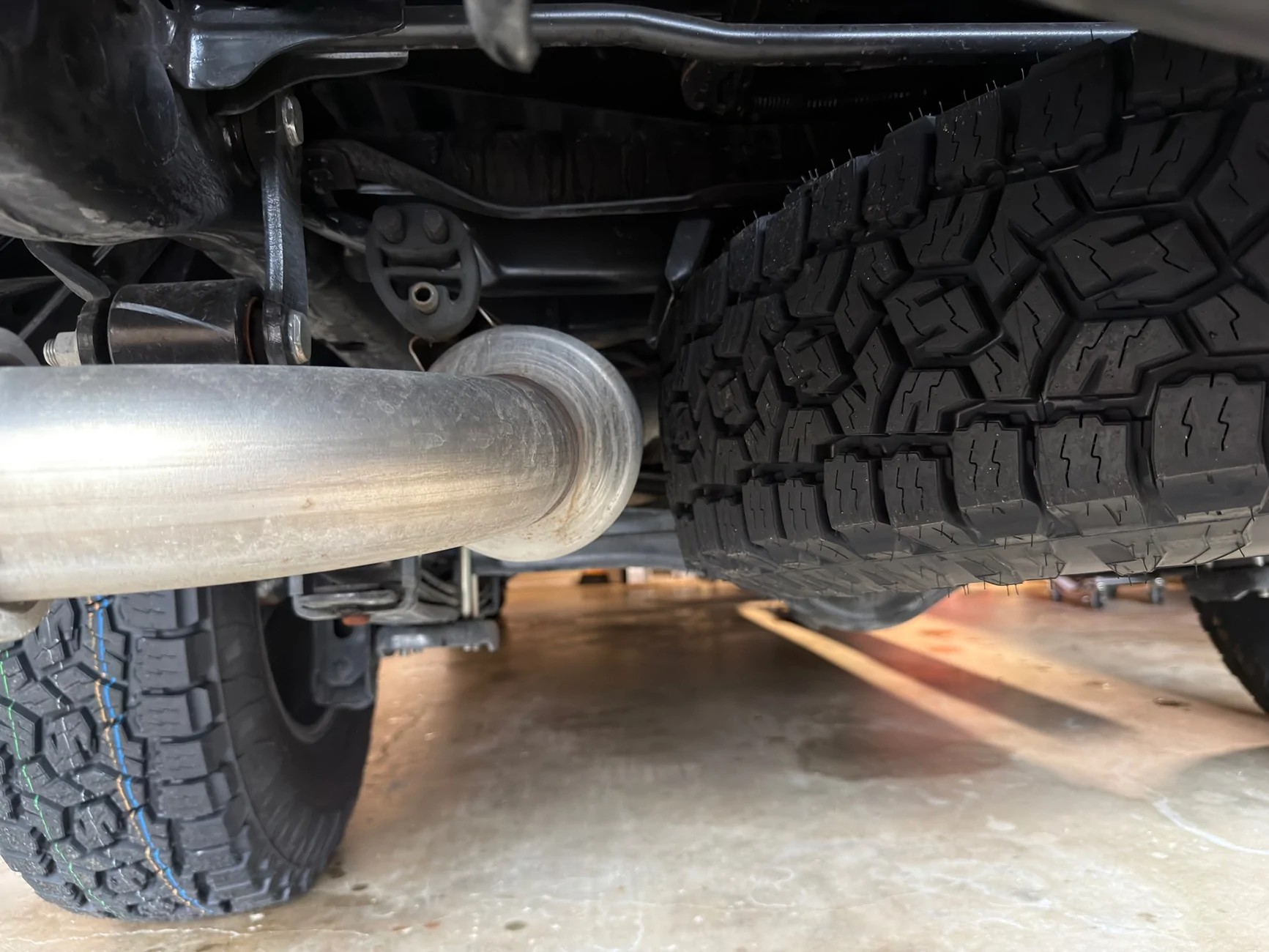

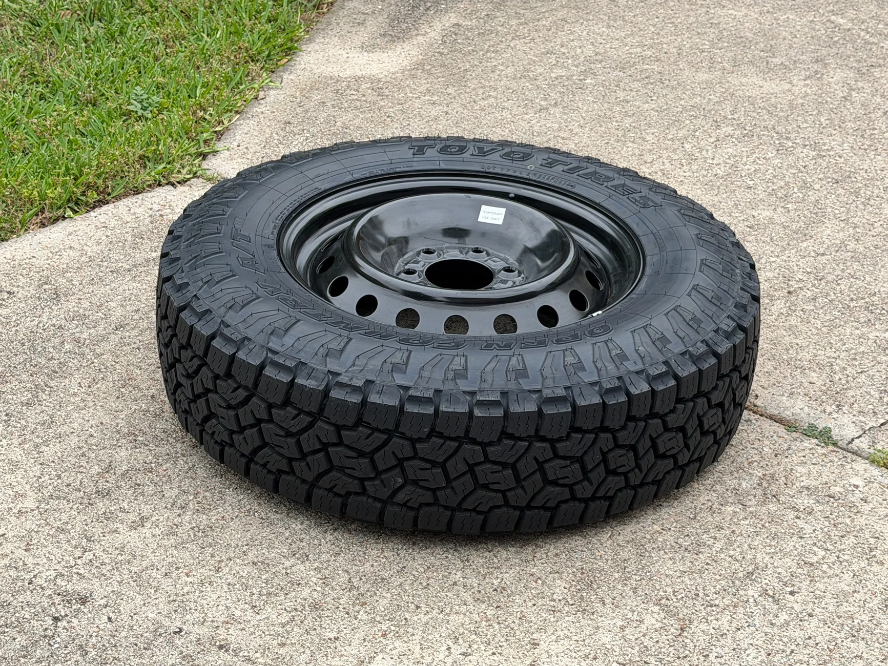

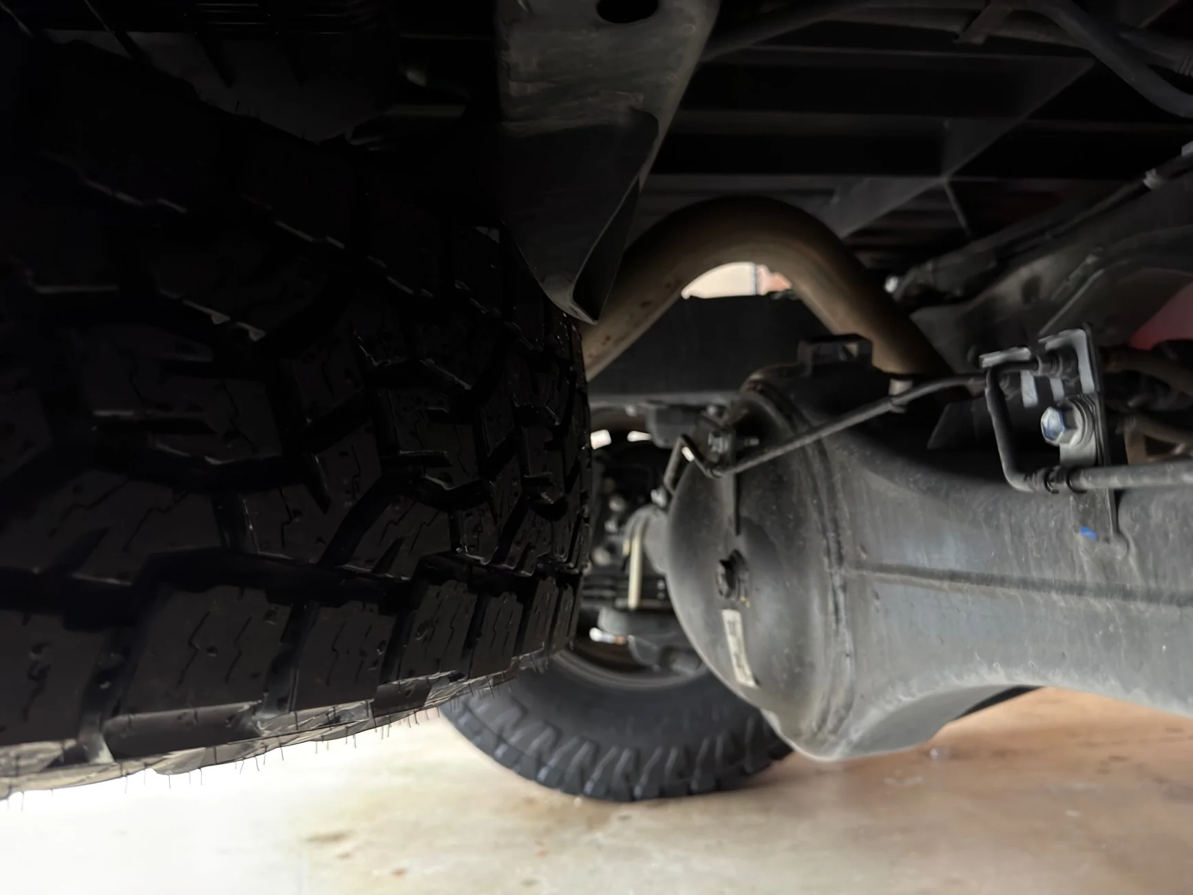

Spare tire photos and fitment - utilizing stock hybrid 18X7 steel spare. LR235/80R18 Toyo. Purchased from eBay. The tire is very close to the same diameter, about 0.7” off. It is pretty skinny which is great for this location since all the wider tires hang down so far.

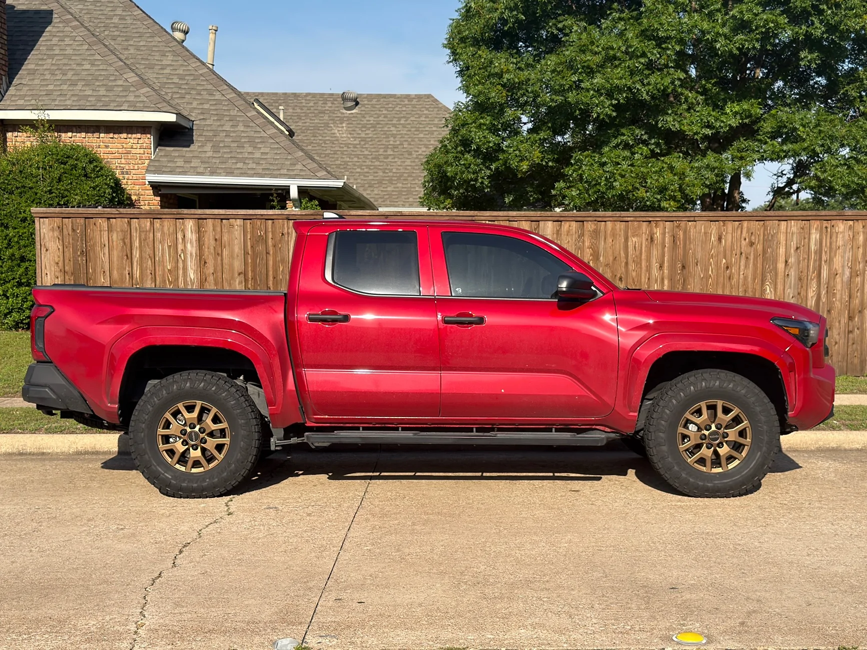

Good looking truck. I did the same exact thing on my first 24 Tacoma. SR5 Longbed 4x4.

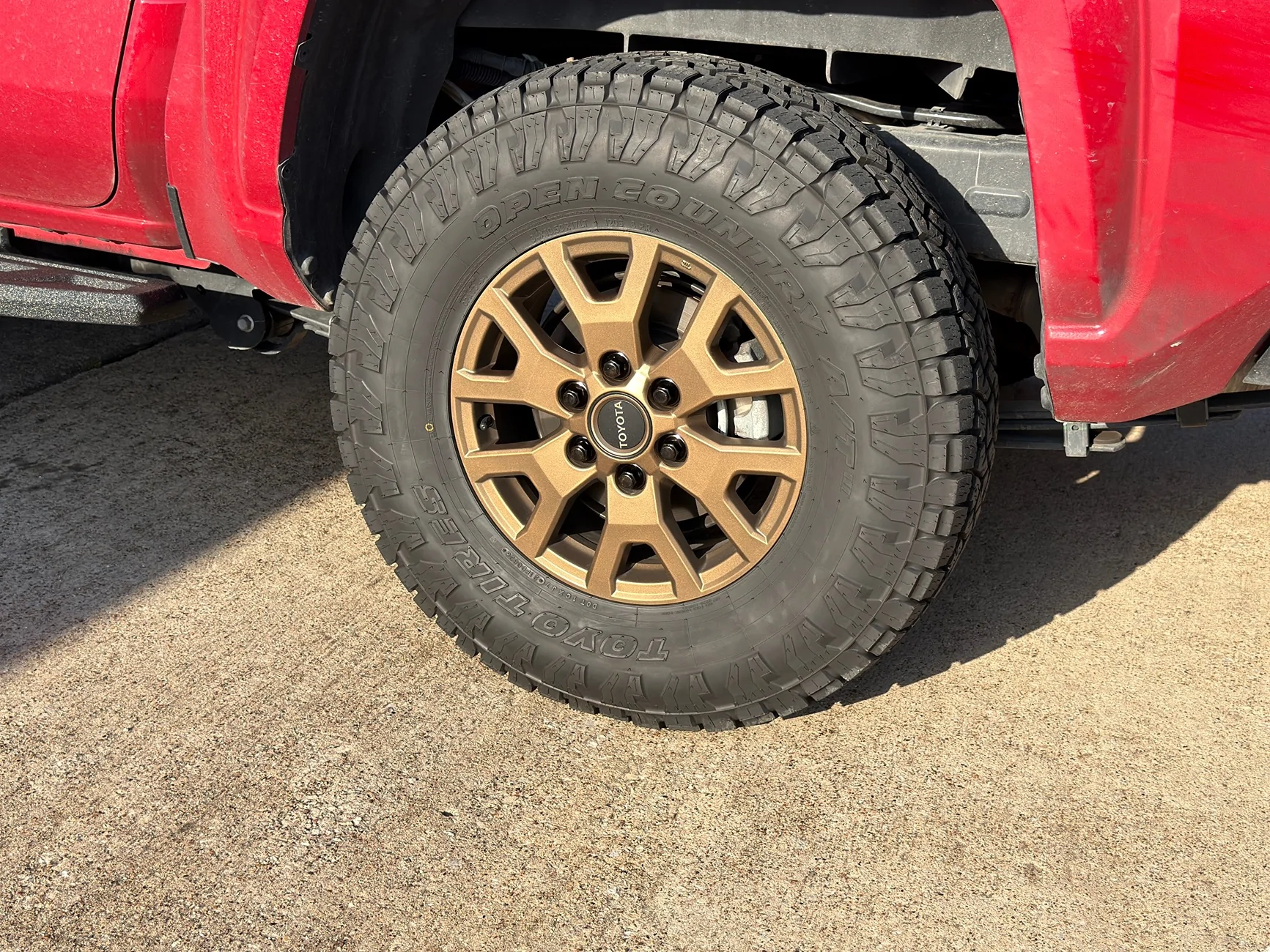

Thanks. I guess now that people are reviving this thread, I should post an update that I don’t even have the wheels in the thread anymore. I got my originals done in bronze powder coat and am running the OEM bronze center caps…with the 34” Toyos from post 7.
