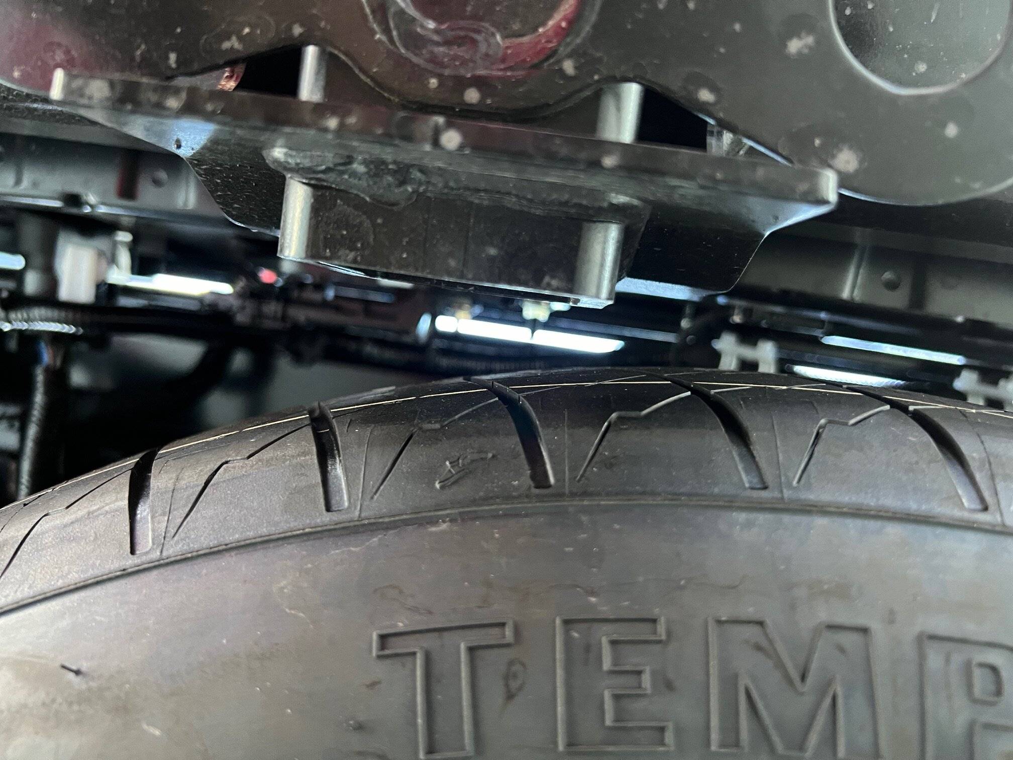

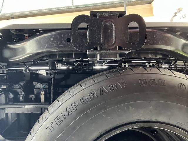

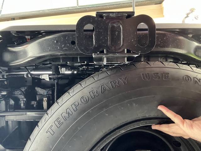

The Off Road with a temporary spare doesn't have much room for those thinking of replacing it with a taller tire. The trailer hitch is in the way. I haven't tried dropping the spare to see if it will move back off center enough to mount a larger spare up there.

Was looking the other day and was concerned about a 285/70/17 fitting in the stock spare tire location as I plan on getting a used 285/70/17 to put back there.
Took a digital caliper out and measured the distance from the inner hitch assembly (pictured above) to the 245/75/17 spare tire.
This inner hitch assembly is the only major clearance spot for the tires I plan on running for now.
There is approximately 37.04 mm of clearance ( tread to hitch)
A 245/75/17 is 799.3 mm in diameter
A 285/70/17 is 830.8 mm in diameter
799.3 mm + 37.04 = 836.34 mm of clearance
A 285/70/17 should fit with a little less than a quarter inch of clearance. With that said I’ll probably grind some relief off the inner hitch to allow a little more room, or as OP stated try to move the spare off center to allow room.
In the future i will be getting a rear bumper with swing outs and spare carrier, so will have to evaluate if the juice is worth the squeeze.
I’m sure the folks already running the 285/70/17 probably can chime in if they replaced there spare.

What's the clearance like at the front of the spare tire?

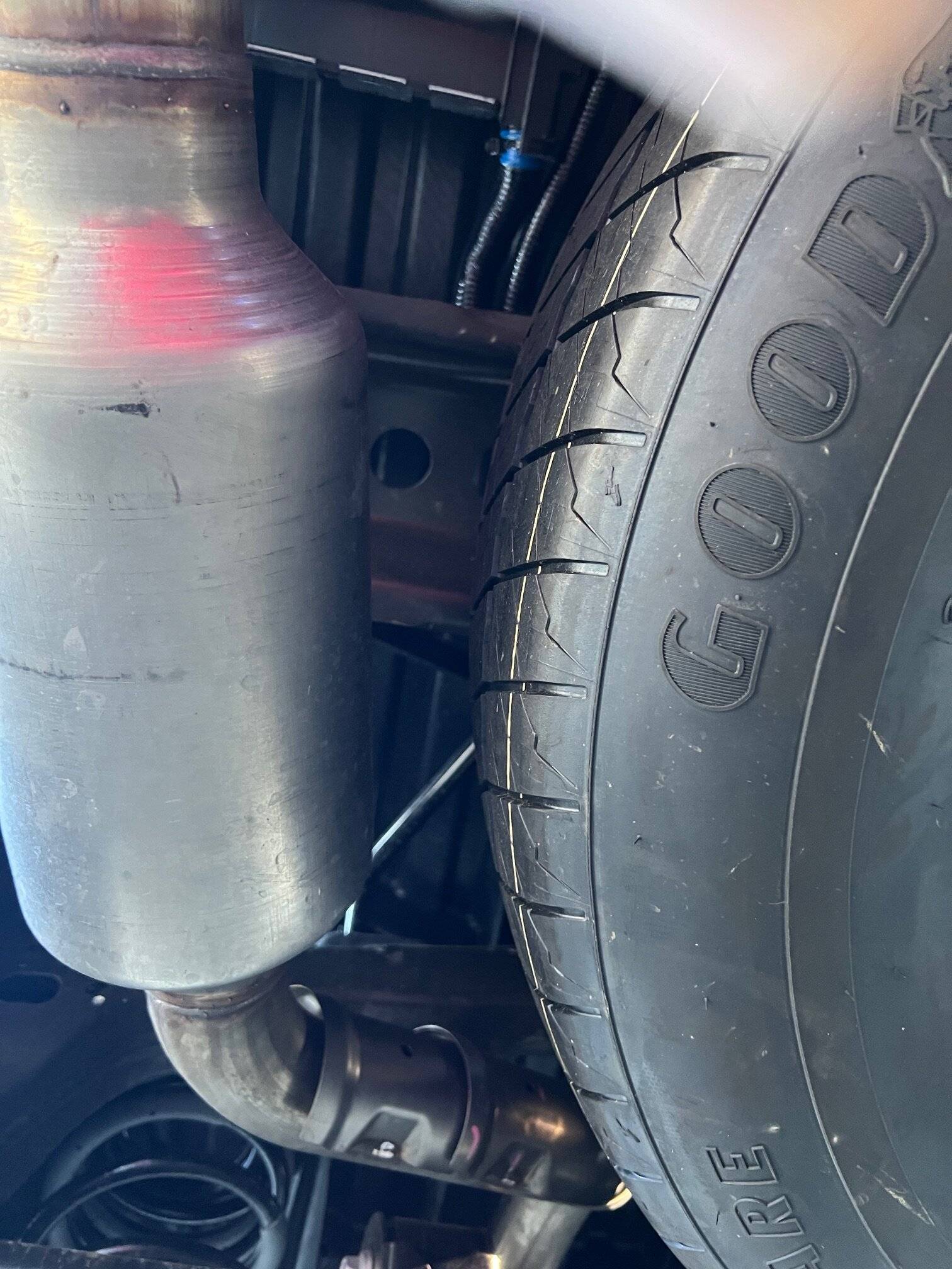

I'd be more inclined to cut/modify the exhaust than grind anything by the hitch. The trailhunter's dump before the rear axle seems like the easiest way to gain extra clearance.

Thanks for the idea i appreciate it! Pretty wide open up front. At this point I’ll see what it looks like once it gets mounted and go from there. As Steve mentions above maybe able to off center the spare a bit. Only need about 1.25 inches to get the clearance the truck shipped with.

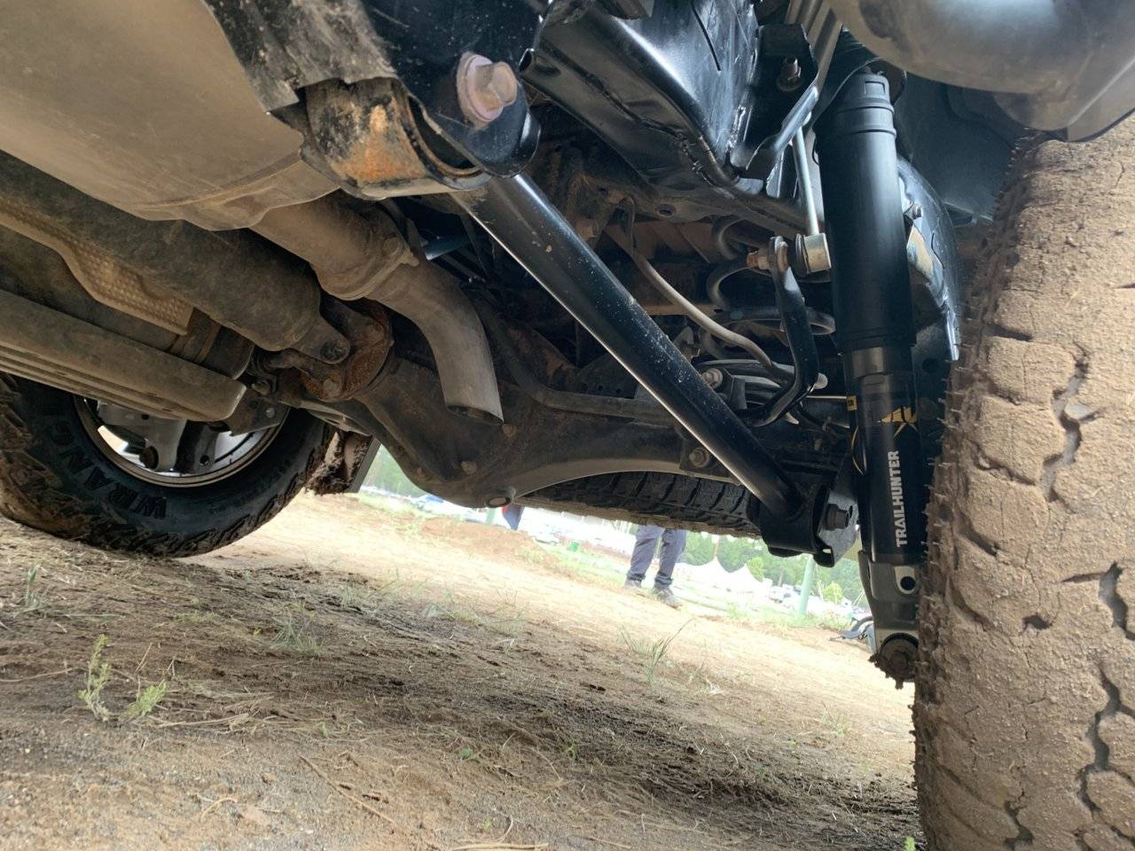

Trailhunter, namely the 6' bed...full size spare equipped according to the test mules. For all the shade thrown on 6' taco beds, remember they used to build them with an 8' bed option. The longer mid sized beds are legit badass IMO.

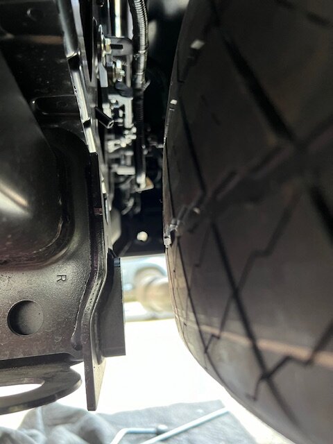

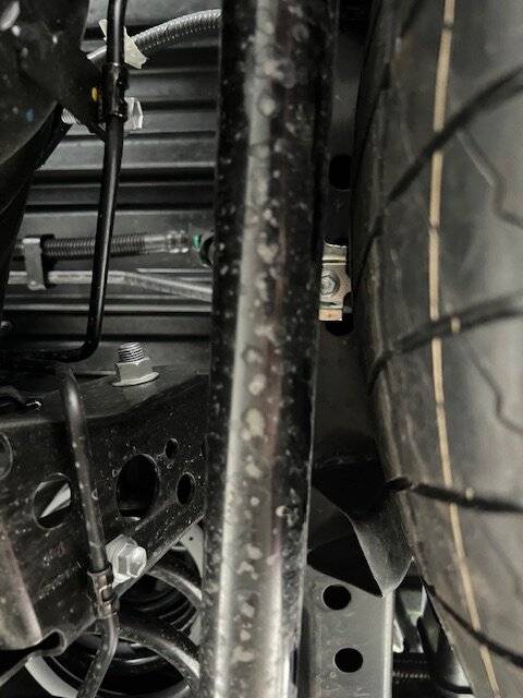

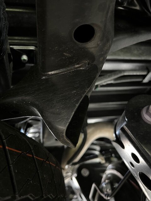

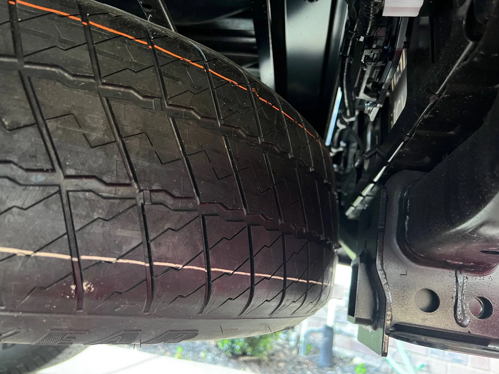

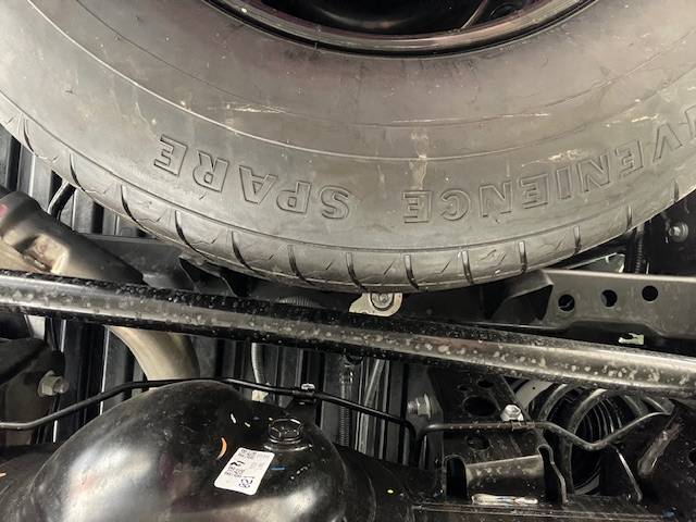

I took a look at the spare tire this afternoon and it's not looking too good for much bigger tires or pushing the wheel back a bit to get more room where the rear of the trailer hitch is. There's two hard stops, one of each side to keep the tire from rubbing the sway bar. You can see the two hard stops in a couple pictures. The last picture shows the maximum amount of room you can gain and that said, you should be able to fit a larger tire than the spare that comes on the Off Road, not sure what size temporary spares the other trucks come with. I also found out that the second hole in the trailer hitch receiver is blocked and doesn't go all the way through.
